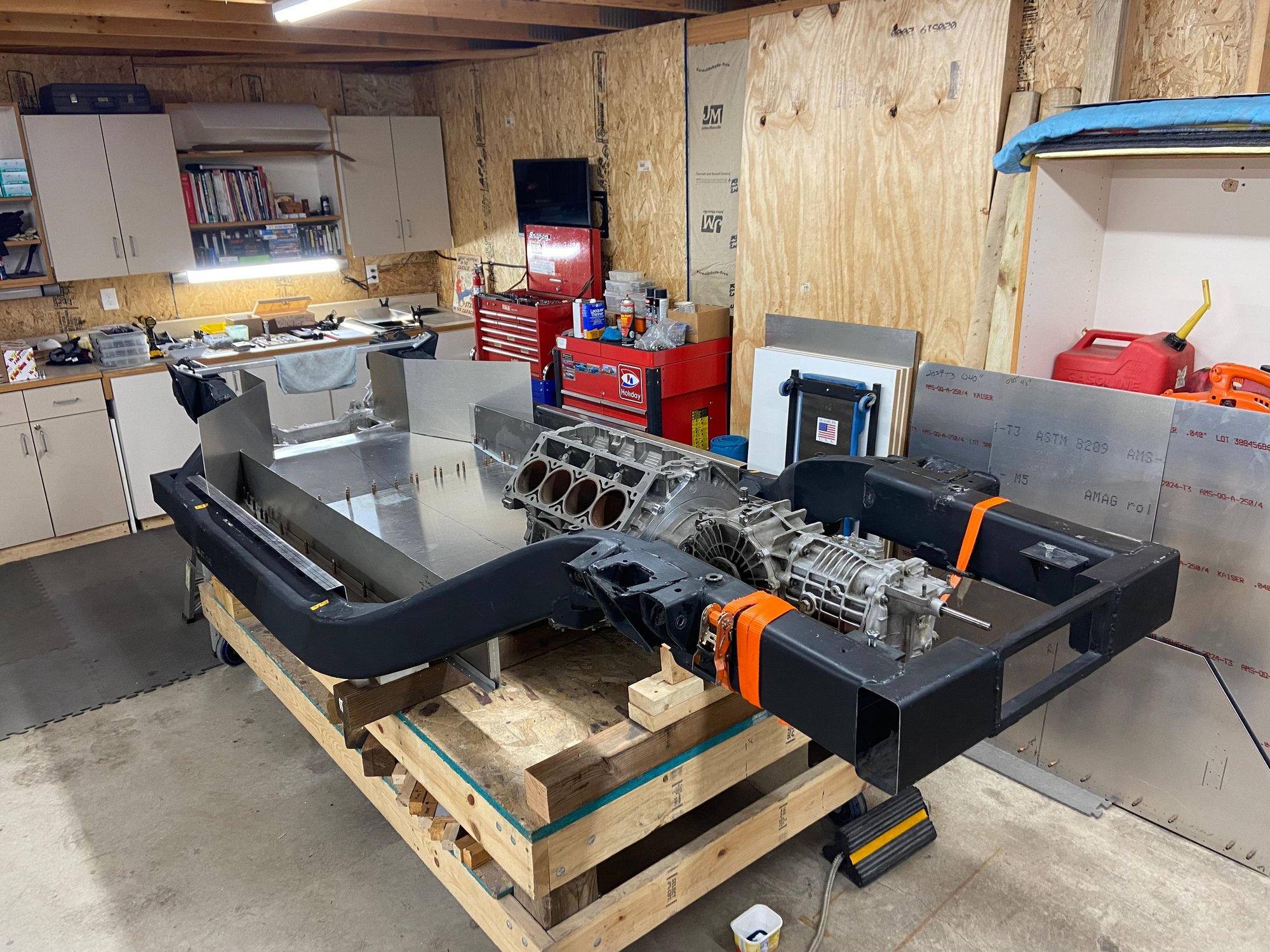

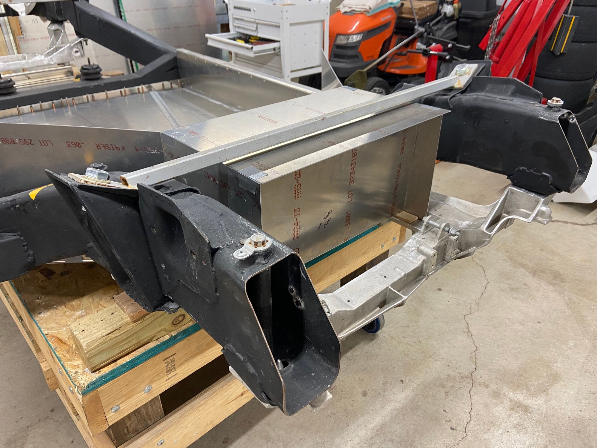

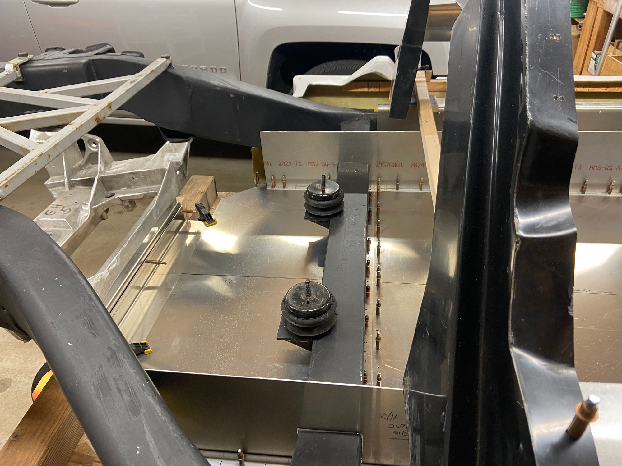

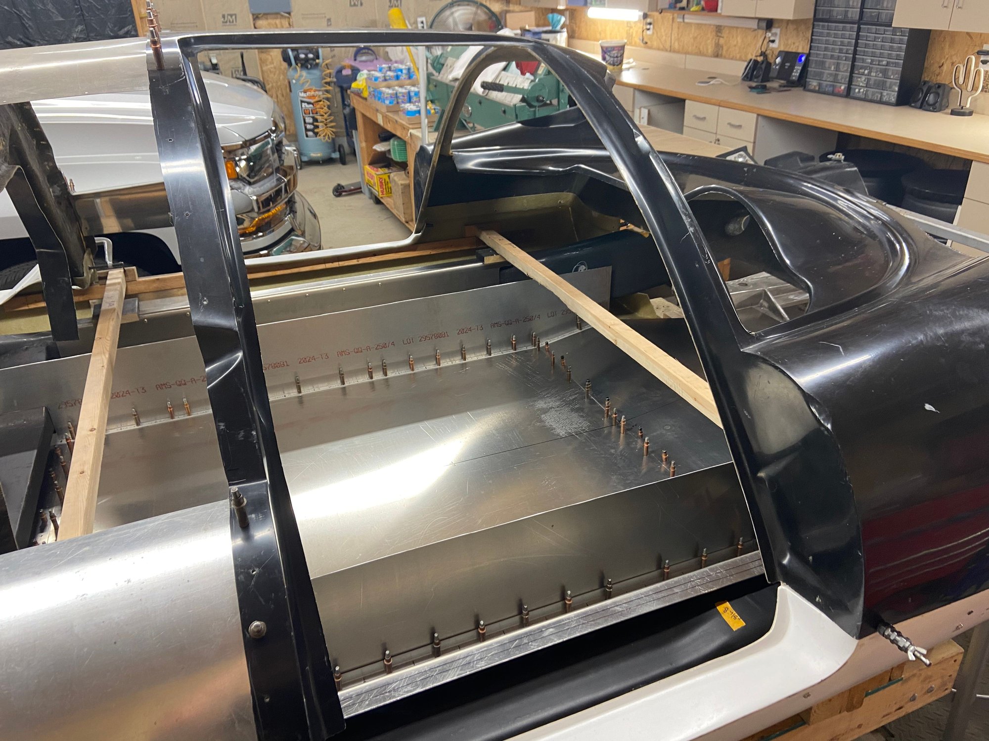

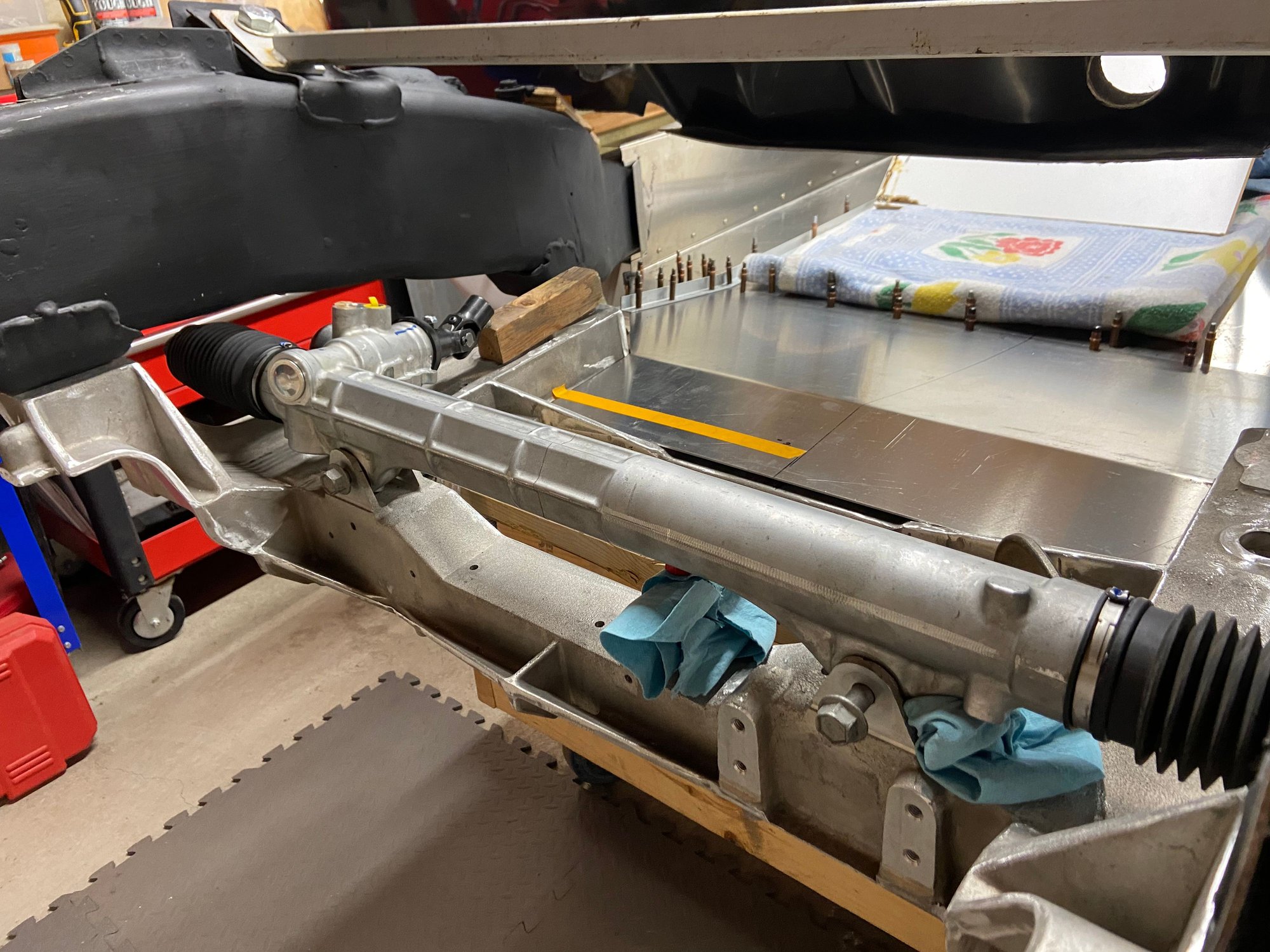

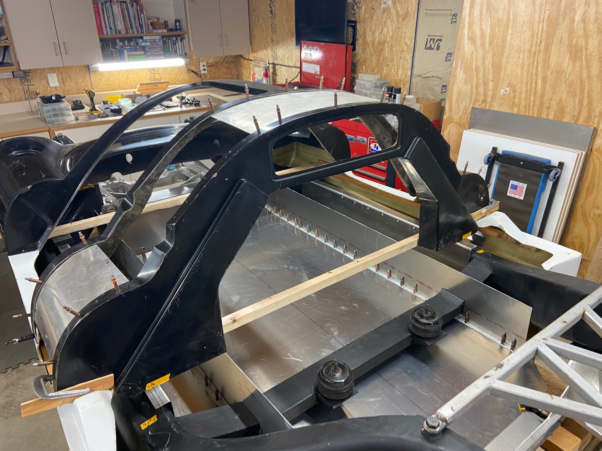

Main floor section is about completed.
Fabricating vertical pieces FOD the side-pods. I dropped the stock biscuits on to reference engine location.
Here you can begin to see the driver tunnel, each side is 19” wide like the original T70
I have the pedal location as far forward as possible here, I’ve had to fab another 080” joggle for cradle clearance. I have the front of the pedal box 4” aft of the rack.
Upright pictures.
Pedal box will be more like an F1 can with your heels higher than you bottom. I can do anything about it using corvette pieces.
European right-Hand drive Cadillac steering rack, same internal length, ratio & it happens to just drop right on the mounts….

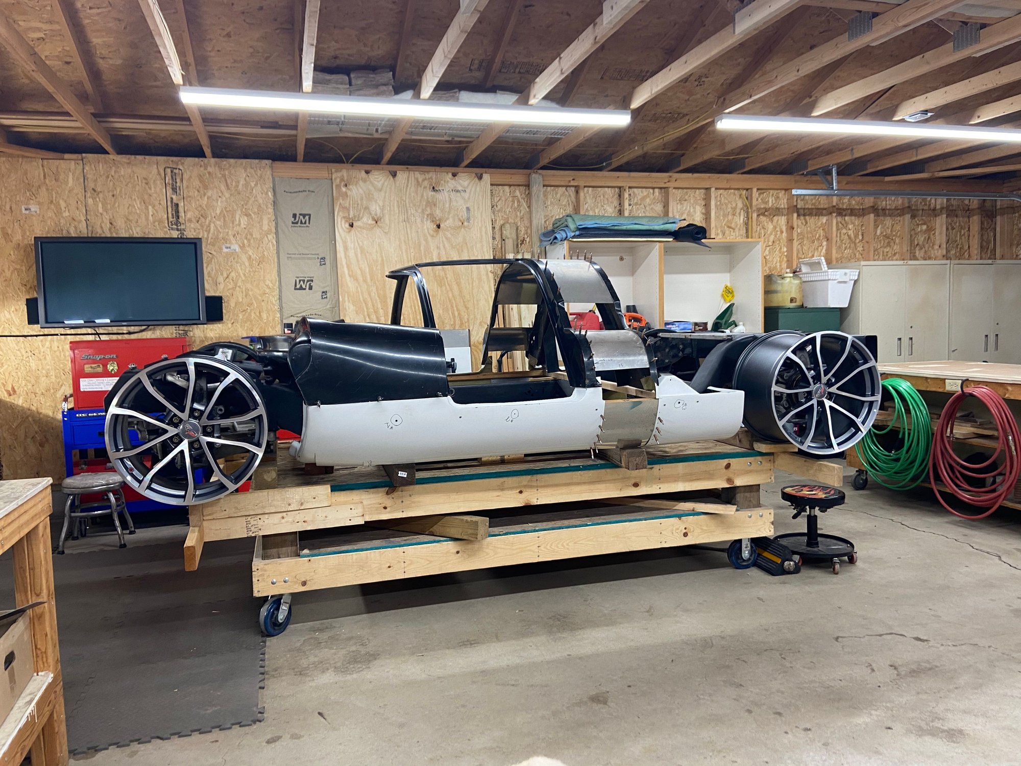

Old picture was with 18”/19” now I have 19”/20” to clear carbon/carbon brakes…..man, this is a slippery slope….

I hate seeing old stuff cast-off for junk, this chassis was a proto for something else & cast off. I said, you know…maybe I can take this,…and that,….and maybe that over there & put it all together?…..I’ve build a few cars over the years & wanted something different….
it will be a little rude, crude, and maybe socially unacceptable but it will spark a conversation.
2000lbs, 625hp 422” LS3, it should go okay.

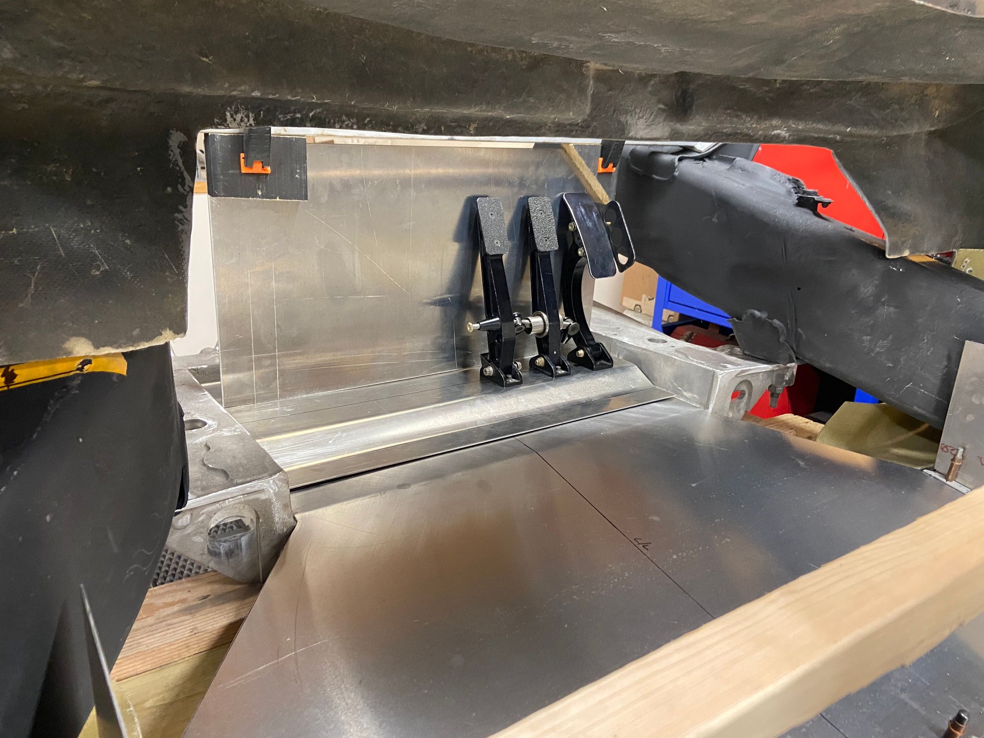

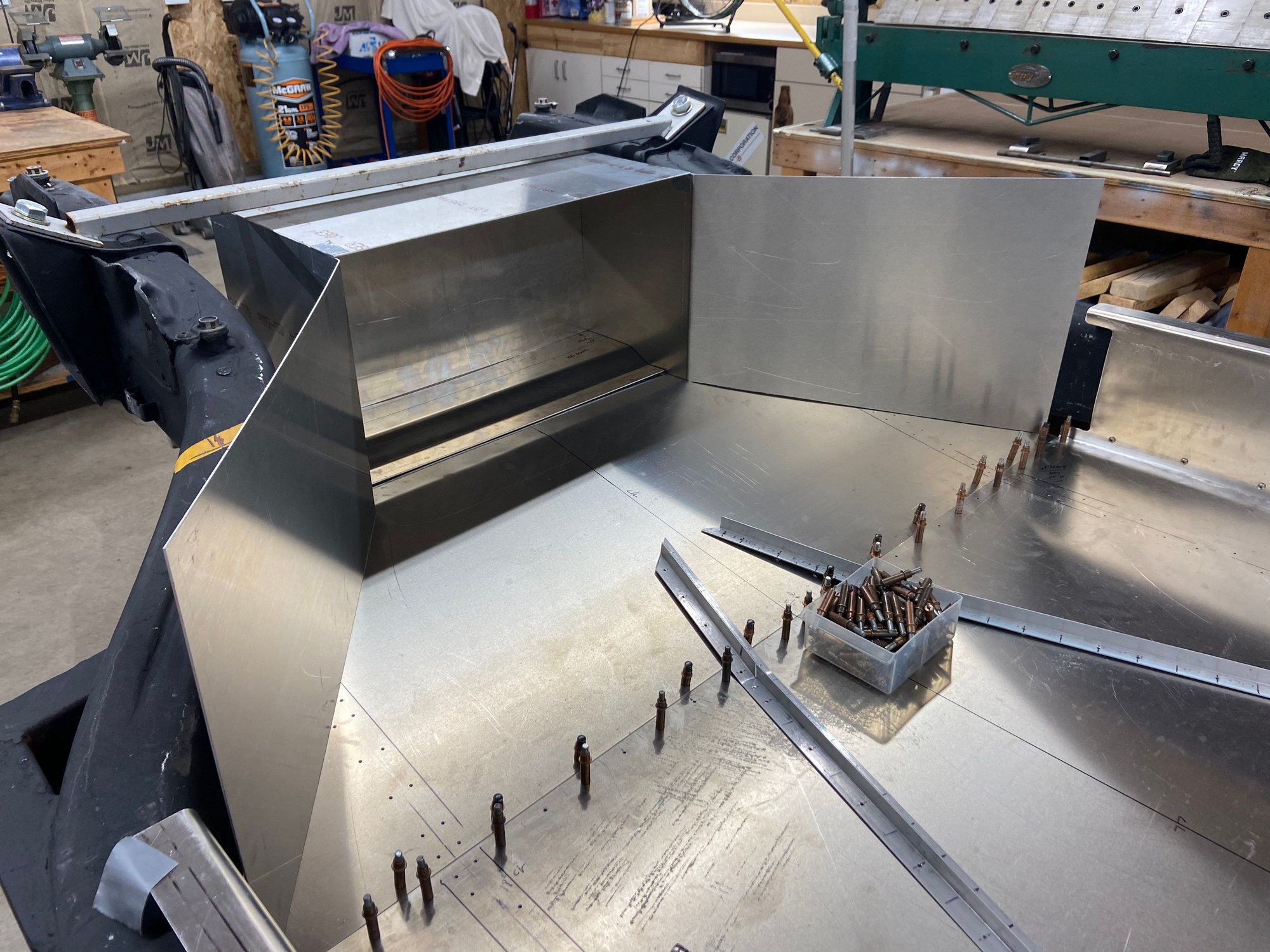

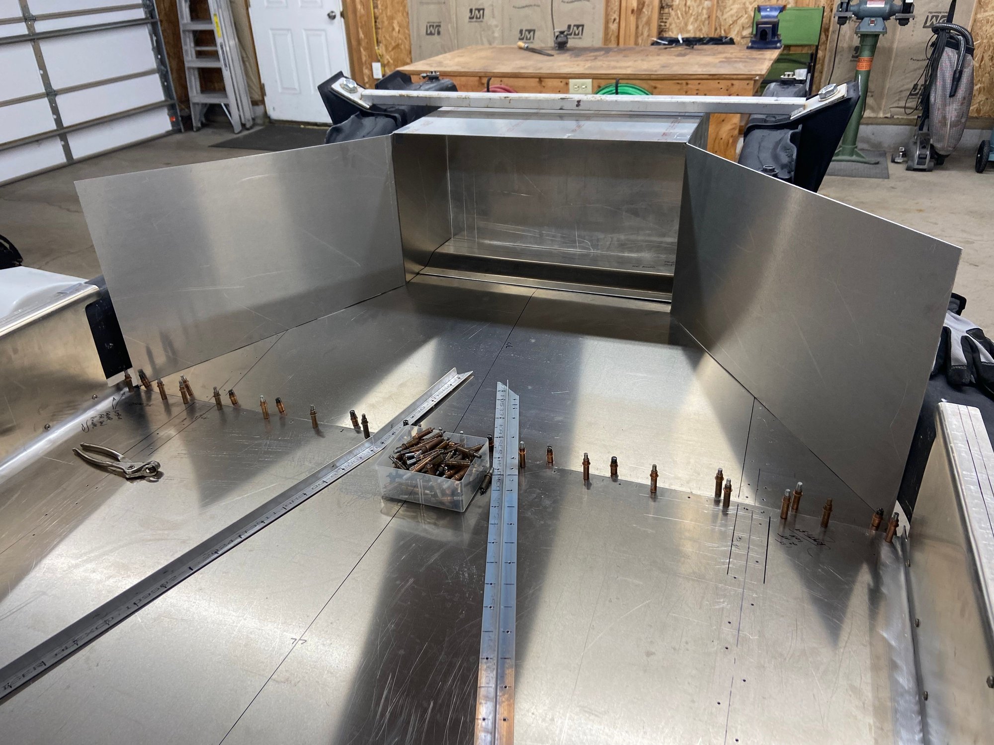

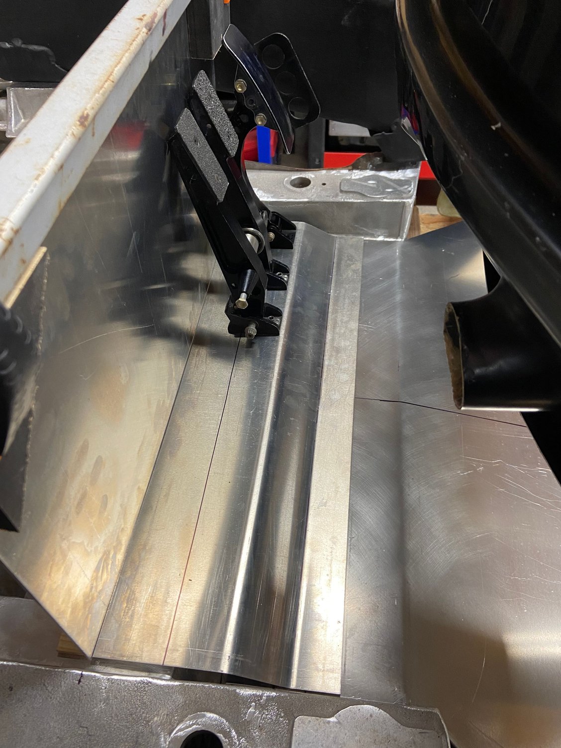

Today’s a new day, let’s do the pedal box.
Wa-La, roughed in.
Floor is 080”, sides & top are 063”, front is .100” I’ll mount the master cylinders right on it….

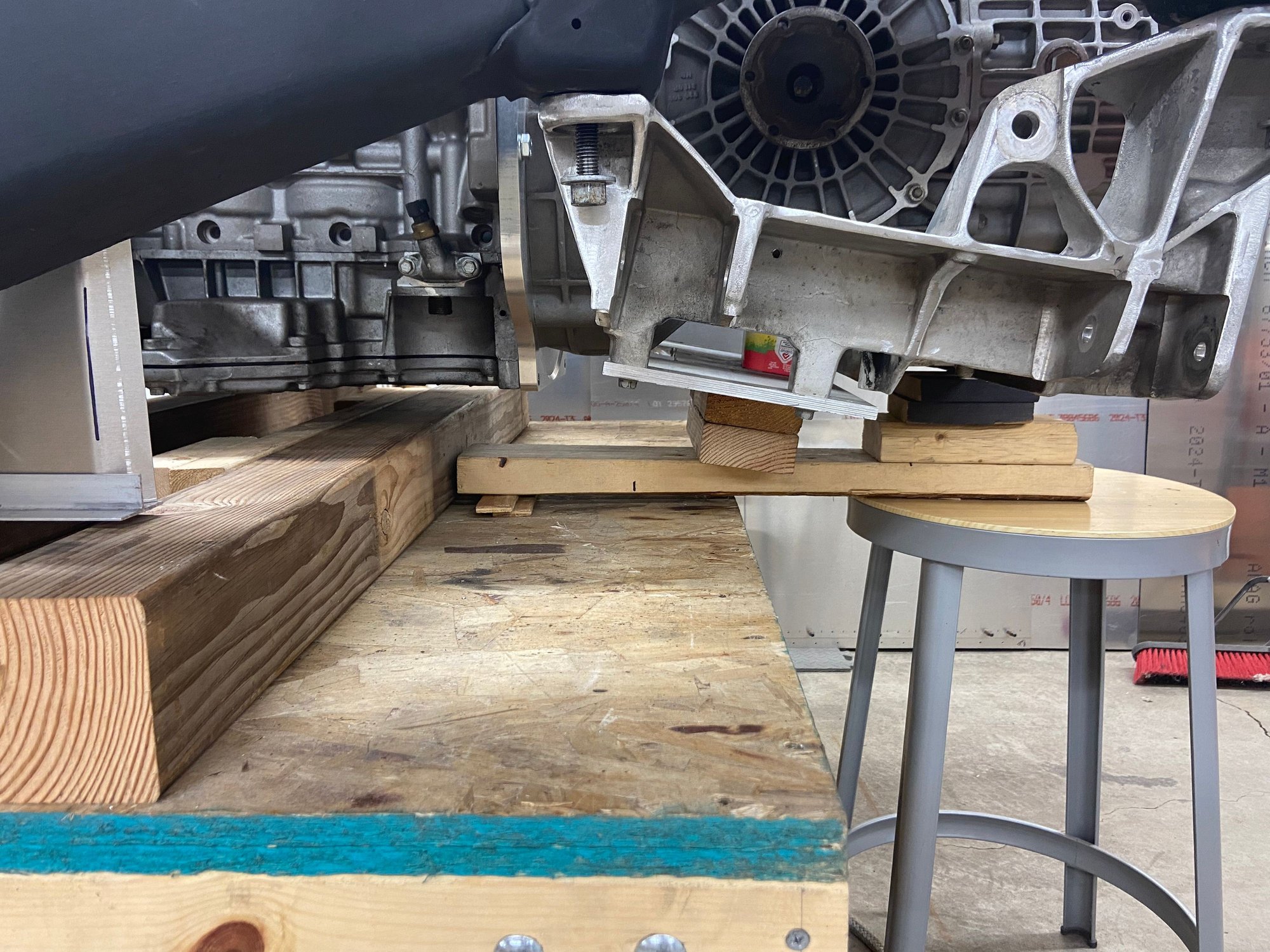

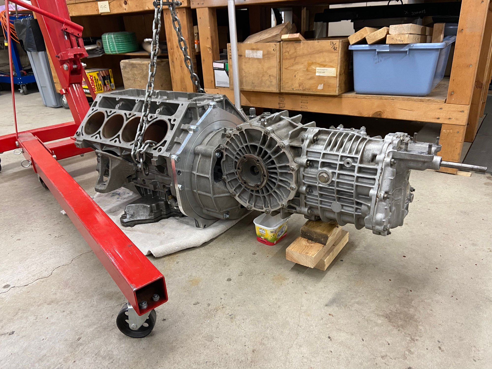

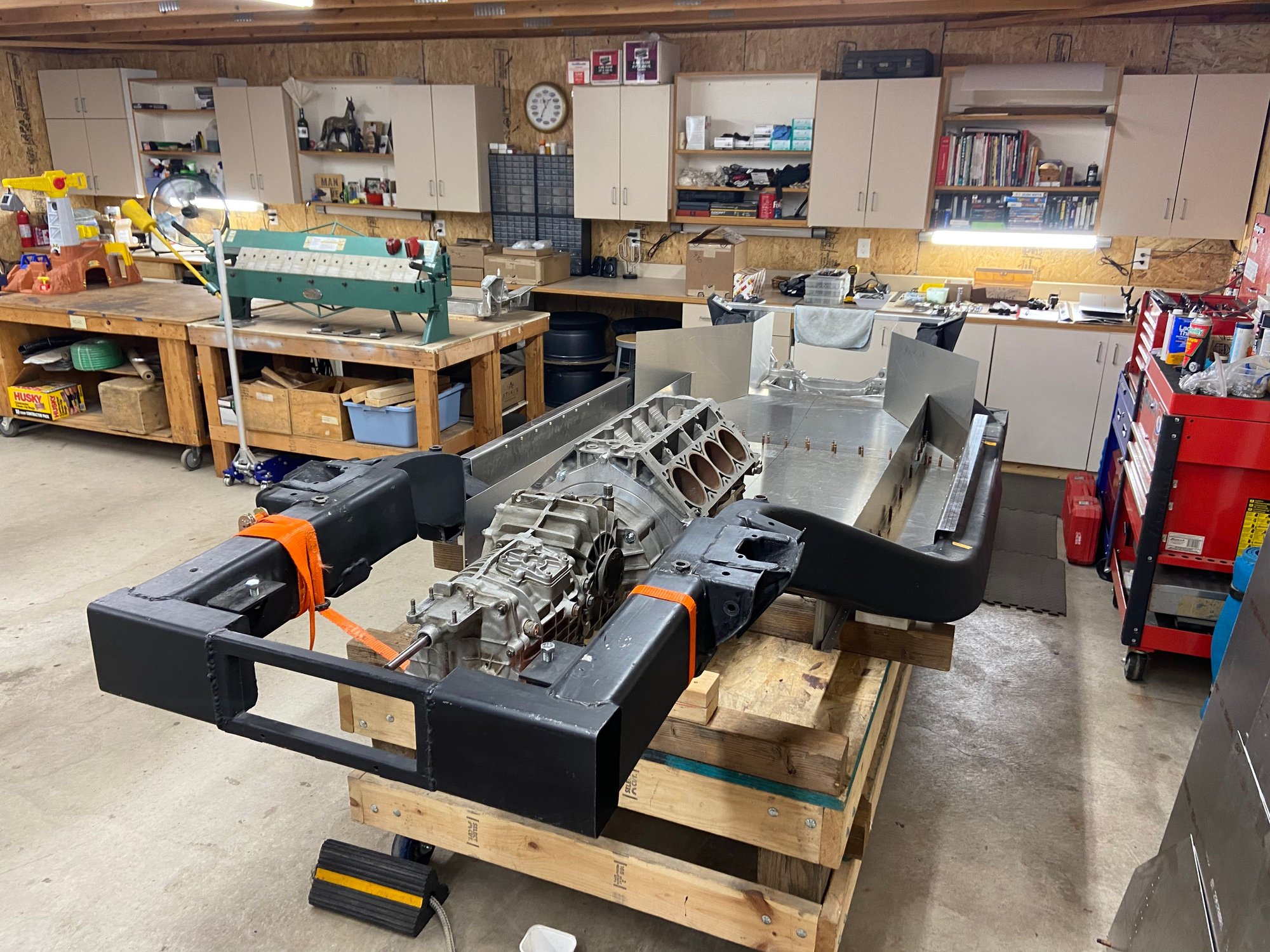

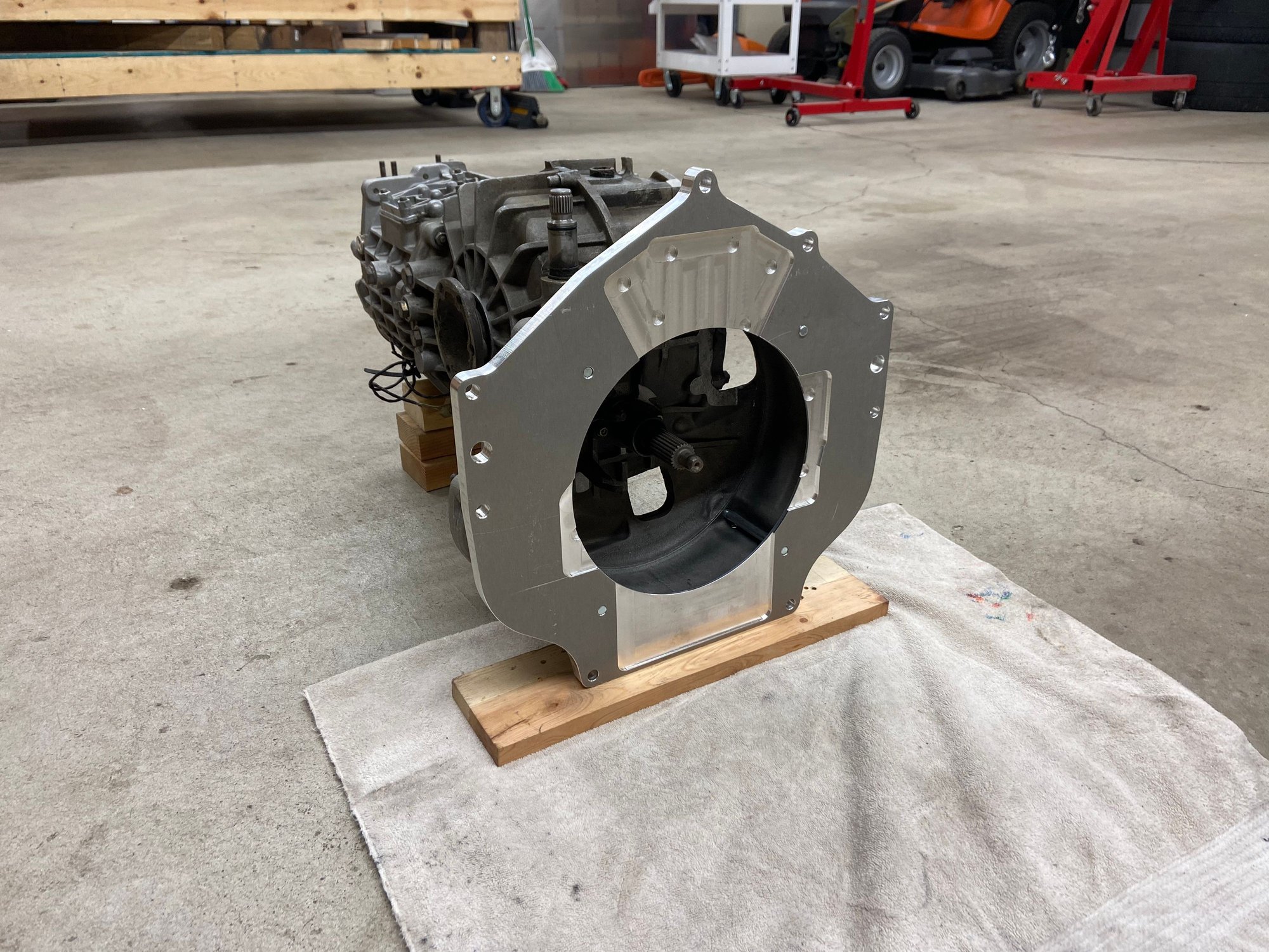

Busted out the Kennedy adapter & hardware for everything.
Here’s some of the initial views
Buddy dropped off a bare block for me to use for mock-ups.
Better look at the first step….

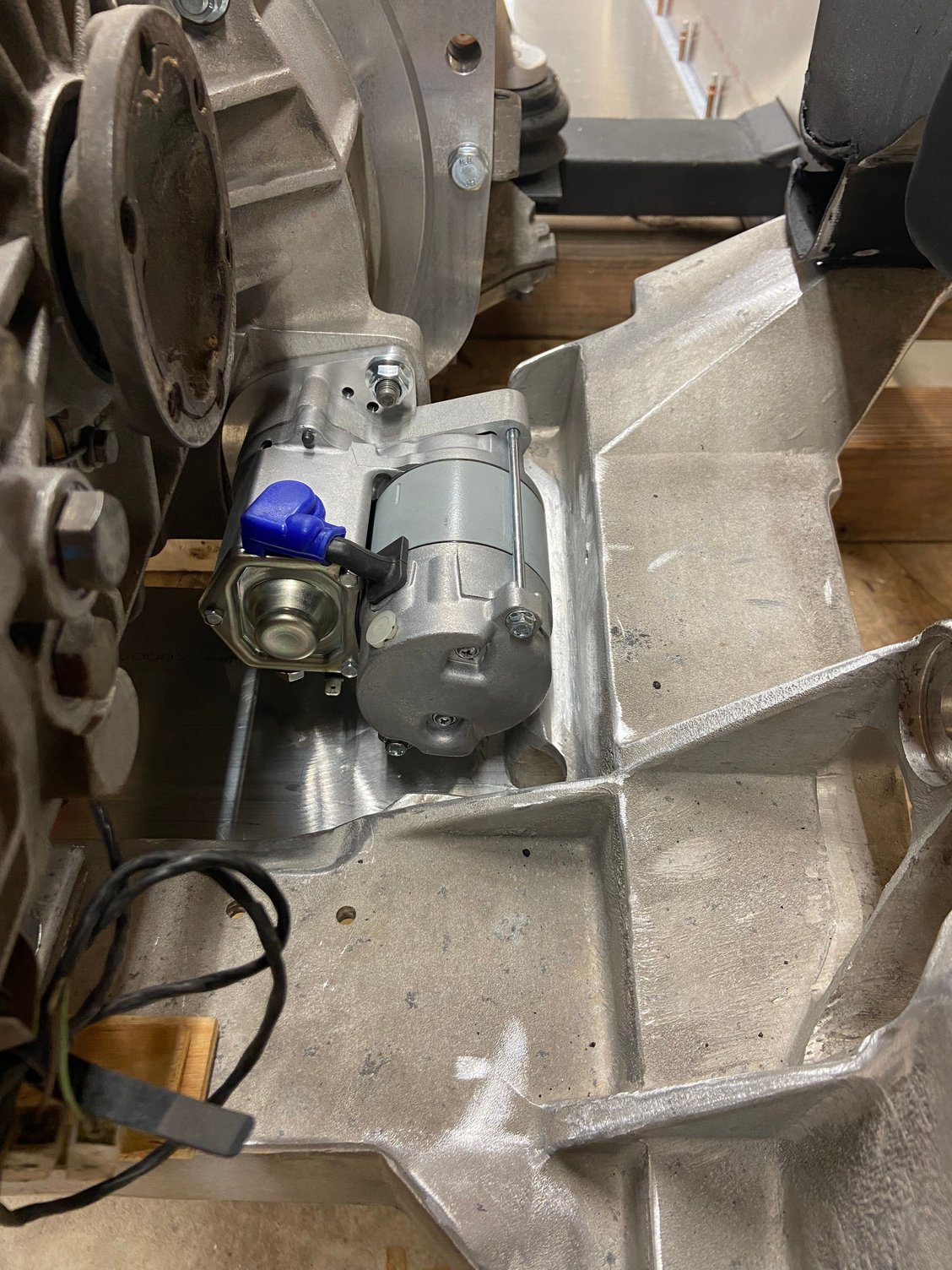

3-solid days of heavy lower cradle modifications including drilling up a .375” 6061 aluminum plate to tie cradle sides together after modifications.
Heavily modified area around starter location…
