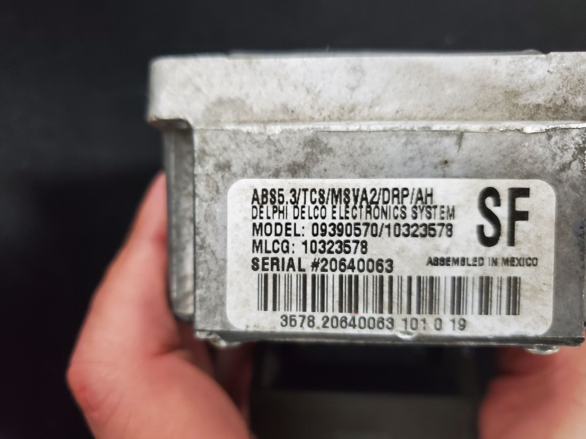

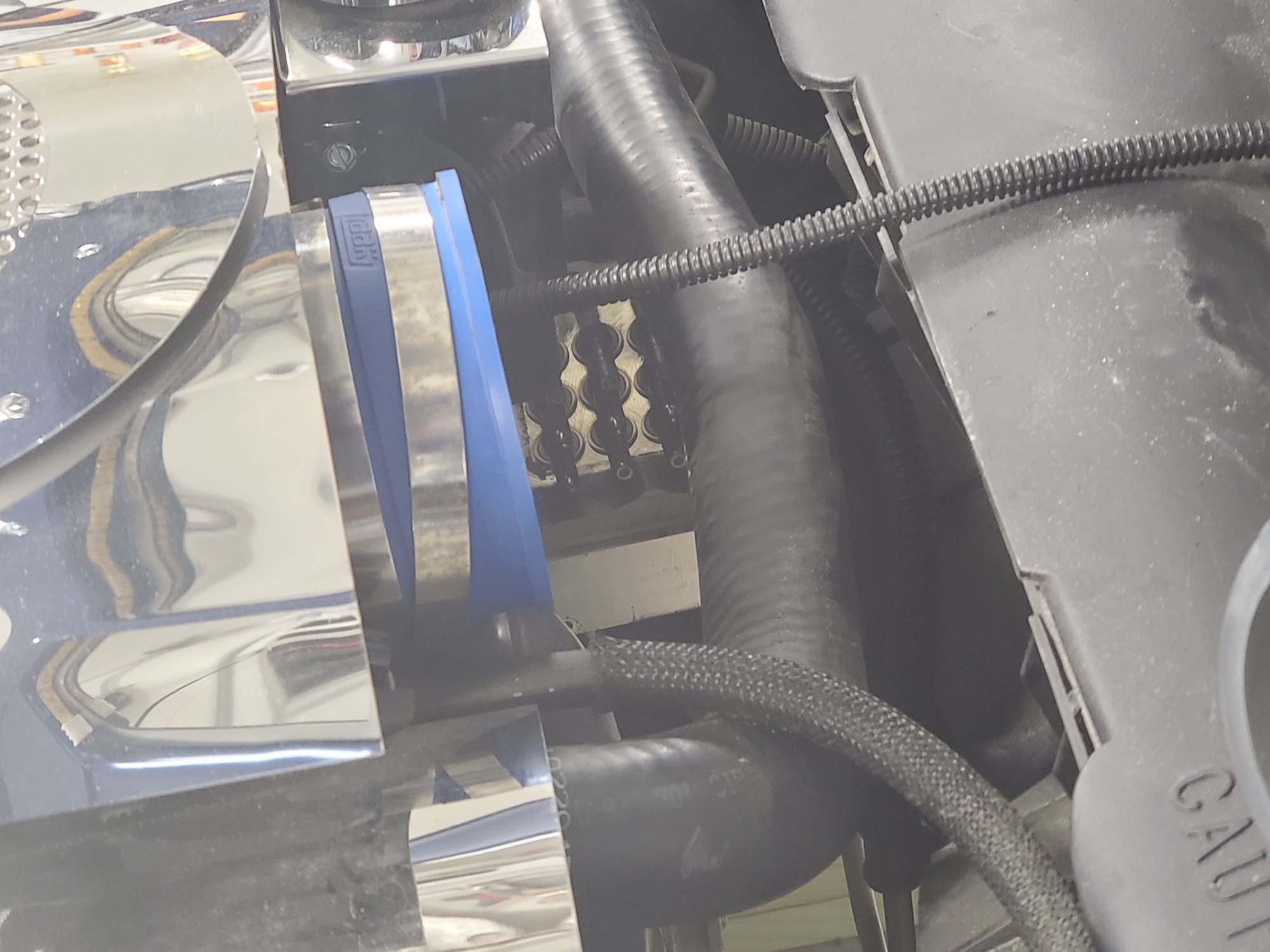

The best way is to get the part # off your current EBCM. I can't remember if it's on the top or bottom of the EBCM. It is under the hood in front of the engine, you'll see quite a few brake lines going to attaching module.
This is out of my 02.
The is the module the EBCM attaches to.

Think 99 is underneath behind the reared

I own two 99s and both are in the engine bay

Nope. That was a 97 to mid-year 98 thing. MY 98 moving forward was in the engine bay below the drivers side cylinder head just in front of the motor.
