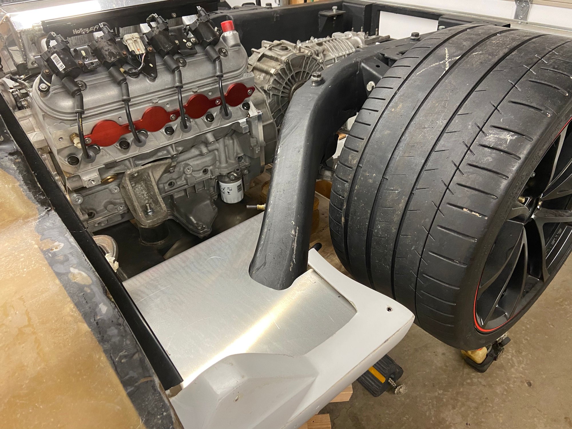

Default Mid engine C5 T70 7/18

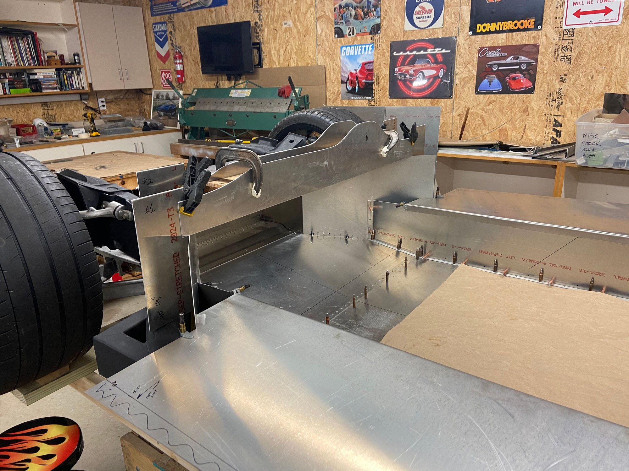

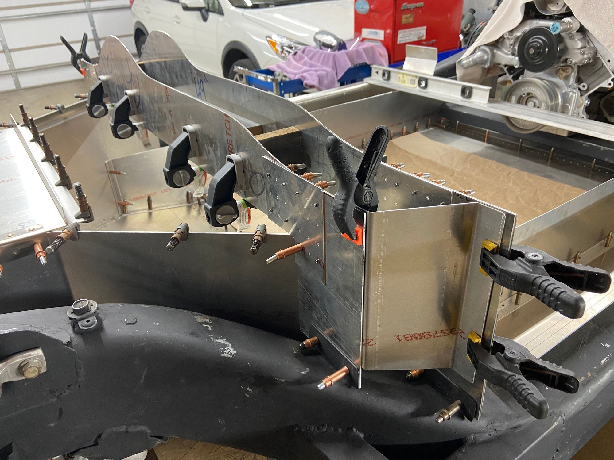

Uprights are cut & clamped for trimming.
Another view shows the general layout. I’ll fab the close out panels once I have all the spacing correct.

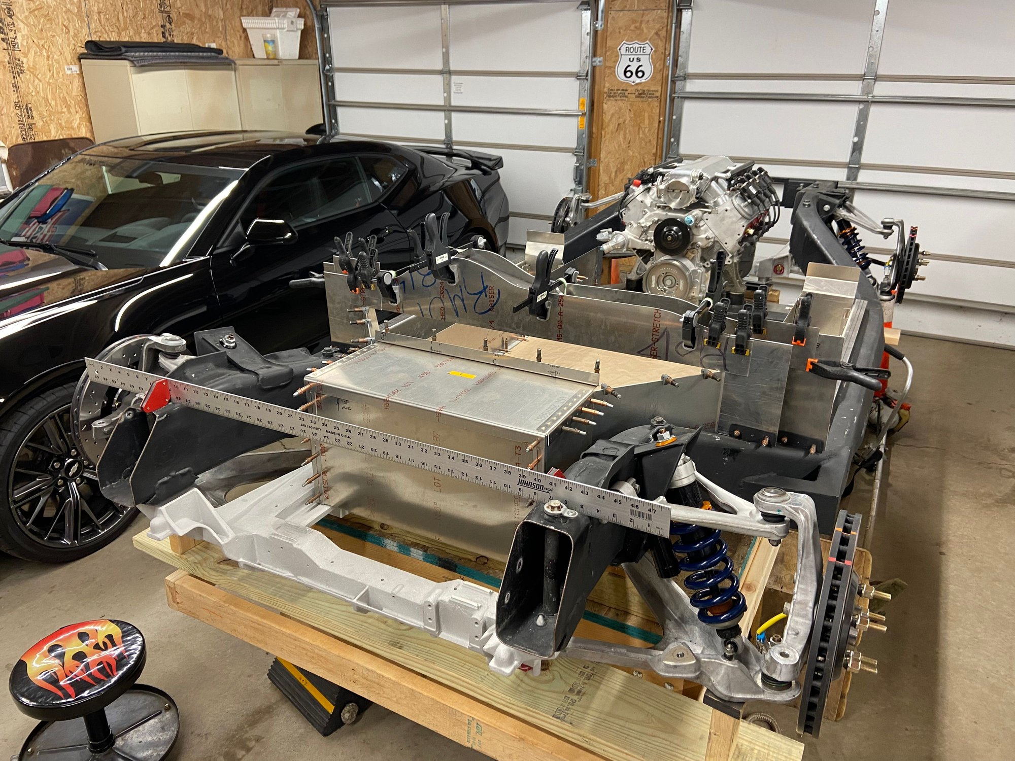

Default Mid engine C5 T70 7/28
Trimmed panel-twins for fit.
Finally finished edge trimming for sidepod close outs.
Now that I have the panel close I’ll drill up the uprights and start boxing the panel twins together. Then I’ll drill steering shaft setup.

Default Mid engine C5 T70 8/2

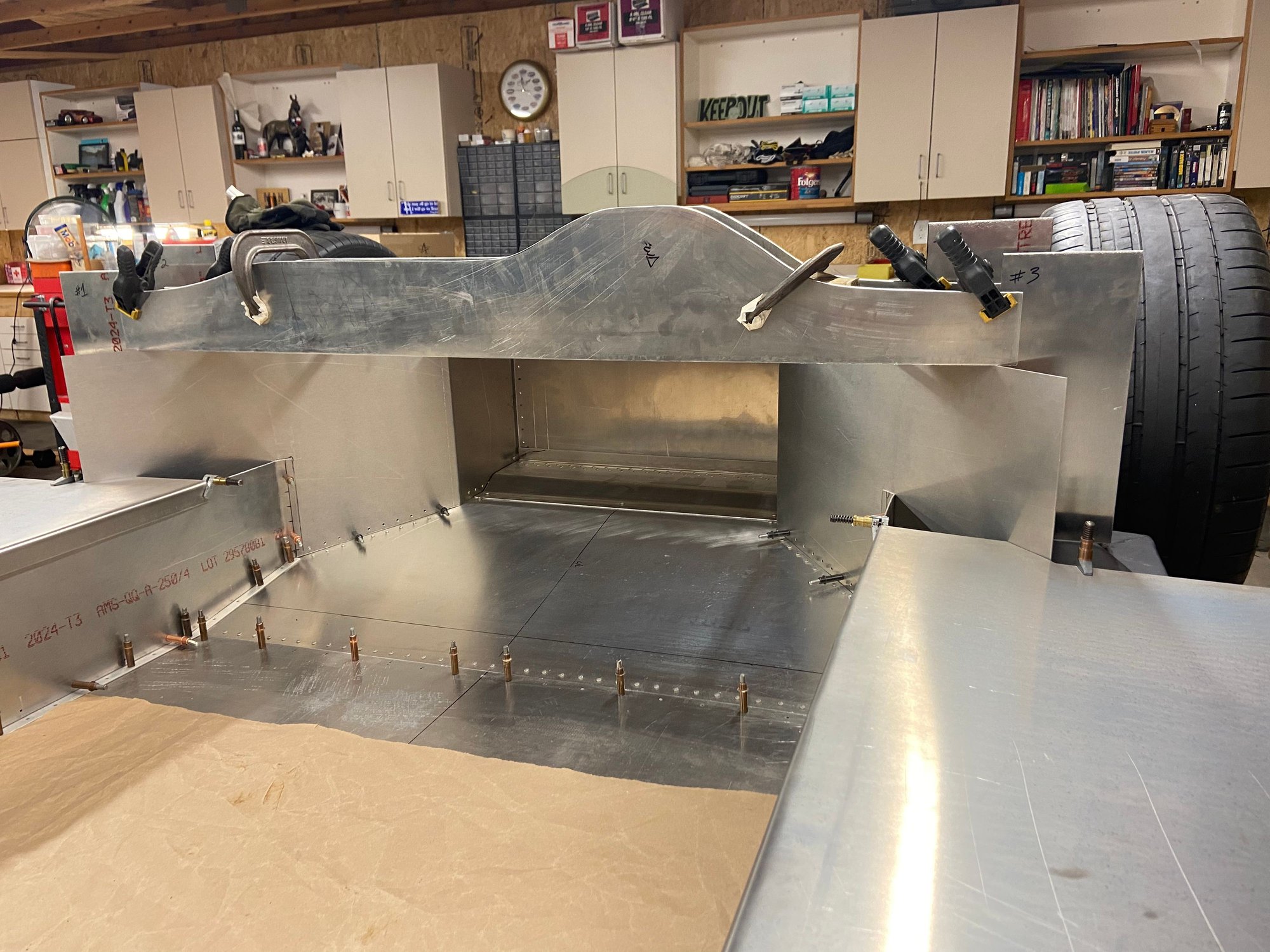

Right side-pod top cut and trimmed.
Left side-pod top is cut and trimmed.
Better look.
Same for this side.

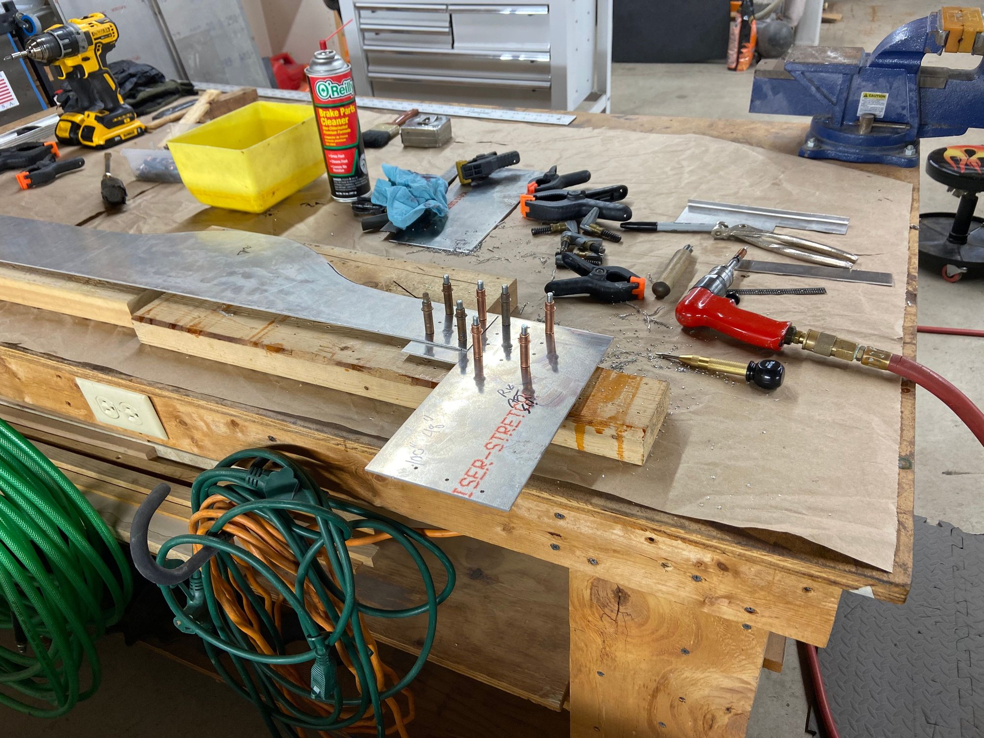

Default Mid engine C5 T70 8/31 updates

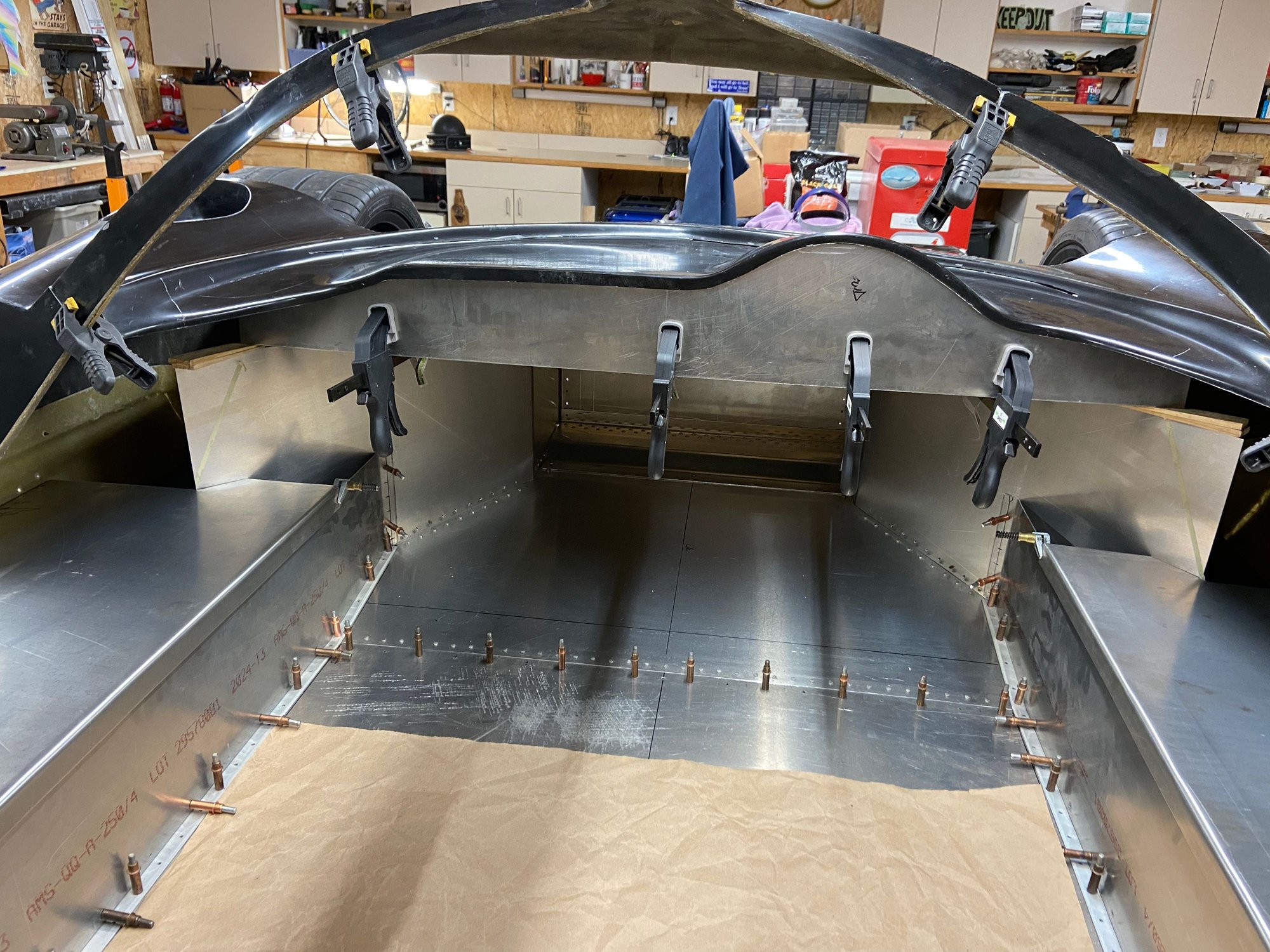

Drilling up panel uprights and getting all the doublers cut, drilled, countersinked and ready to shoot.
Suspension is back on for good this time, hopefully the project is coming off table here this fall…

Rearranged my shop this evening so I can finally get back to it….
Started drilling up the panels this evening, playin army men..

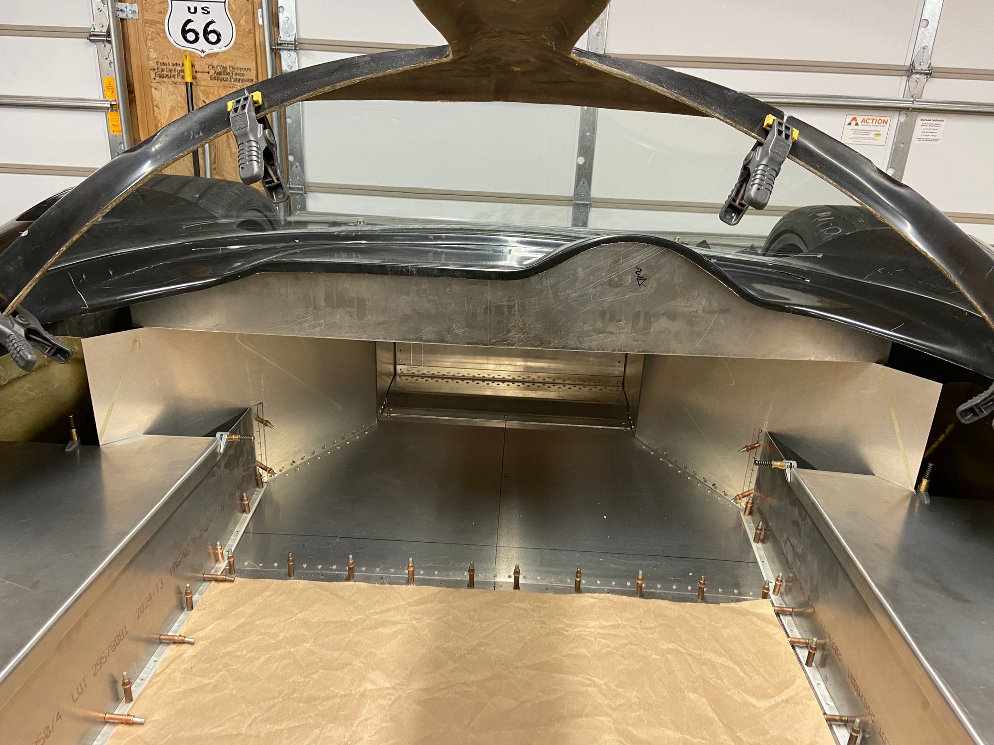

Bent-up the outboard close outs out .063”.
Bent-up the shear-ties for both forward and aft uprights to tie vertical footwell panels to panel support…..
Now I’ve decided to fabricate a new panel and remove the original T70 panel hump. I’m moving everything about 2-inches inboard to better align pedals & steering column. The C5 has much longer A-arms so the footbox I’ve fabricated is narrower.

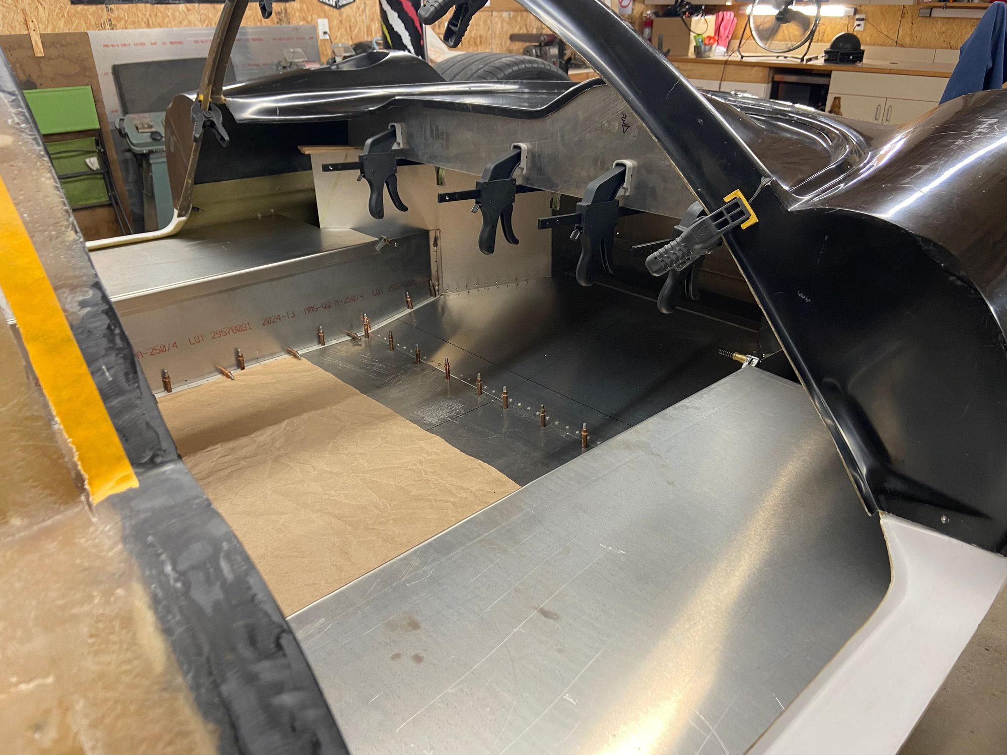

finished the garage over winter so I can back to my project.
I have tub and bodywork in the location that I want it now. The contour of the sidepods is still wrong but nothing the old highspeed and some fiberglass won’t fix.
