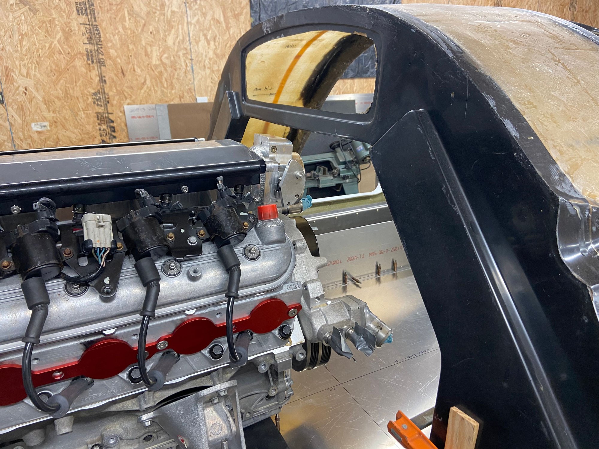

Worked fiberglass all day.
Cut, trim, cut, trim…..
Intake clears the bodywork, that’s a good sign.
Bodywork still about an 1” to low but I’m shimming and adjusting until I have it right then I’ll start picking up mounting holes.

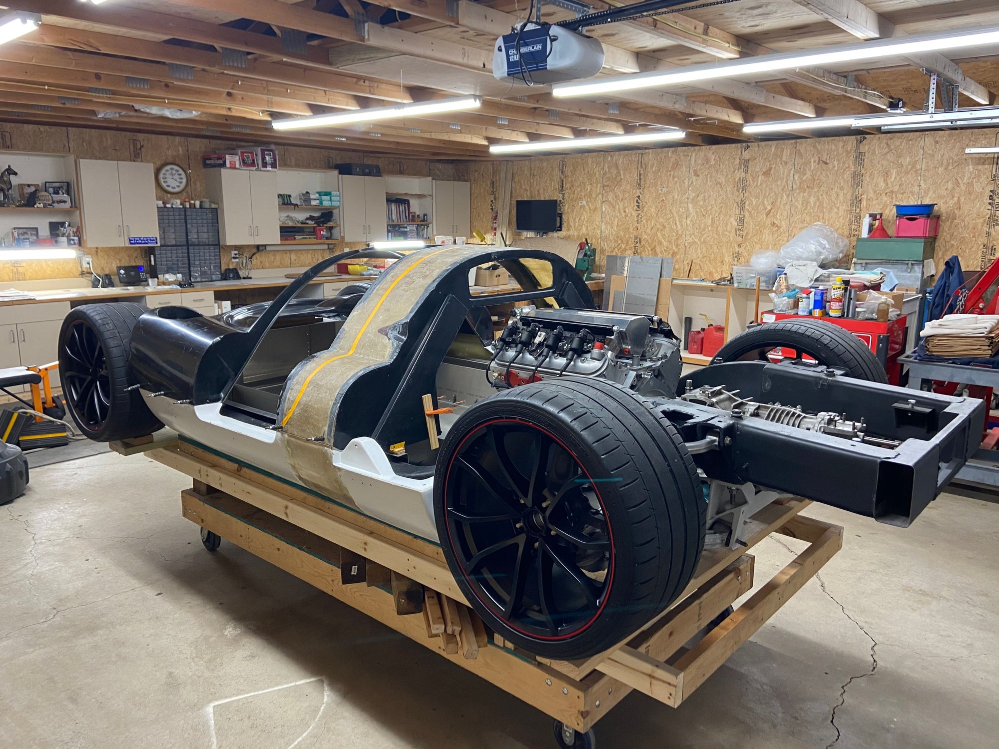

Default Mid engine C5 T70 6/15

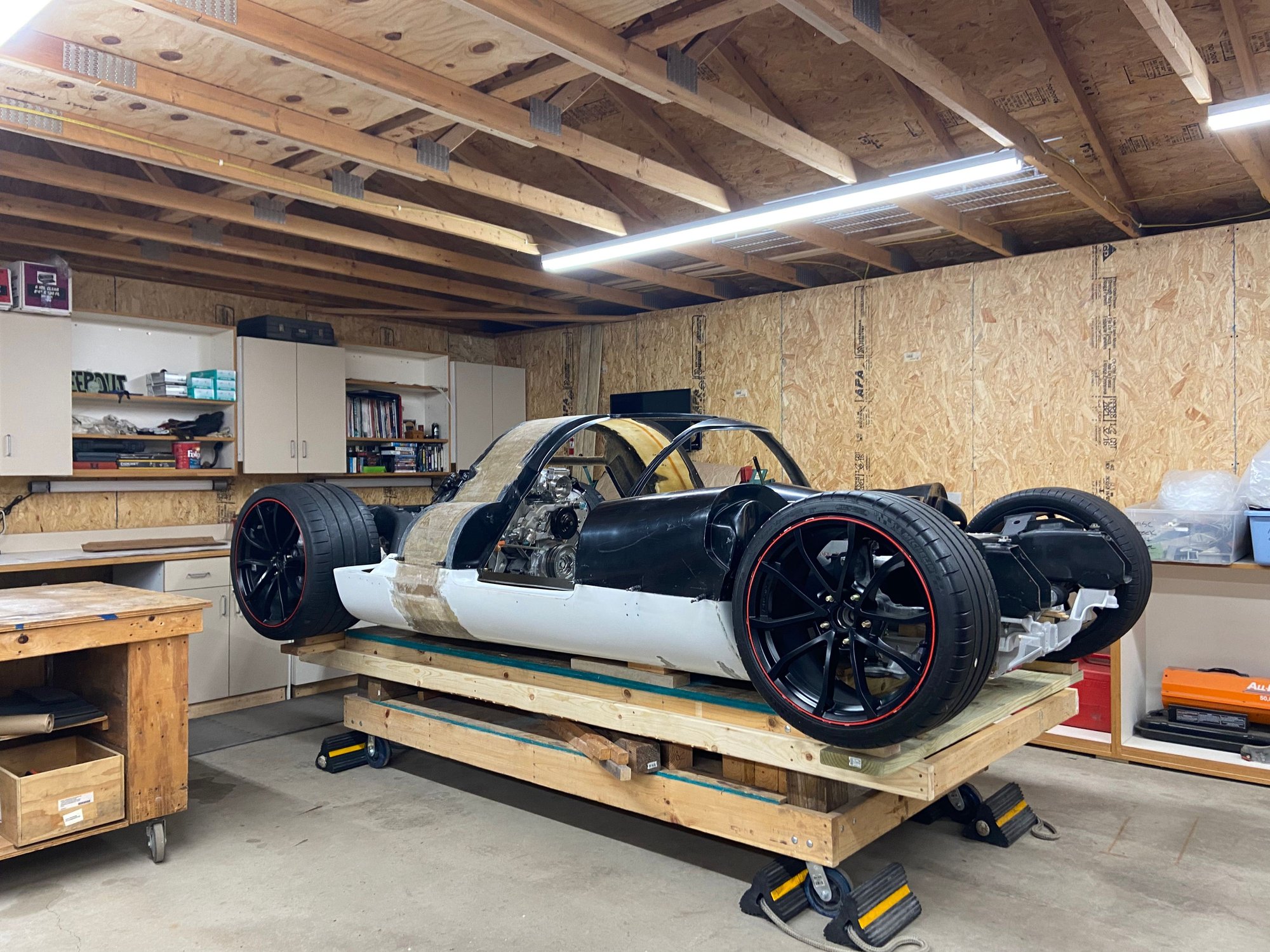

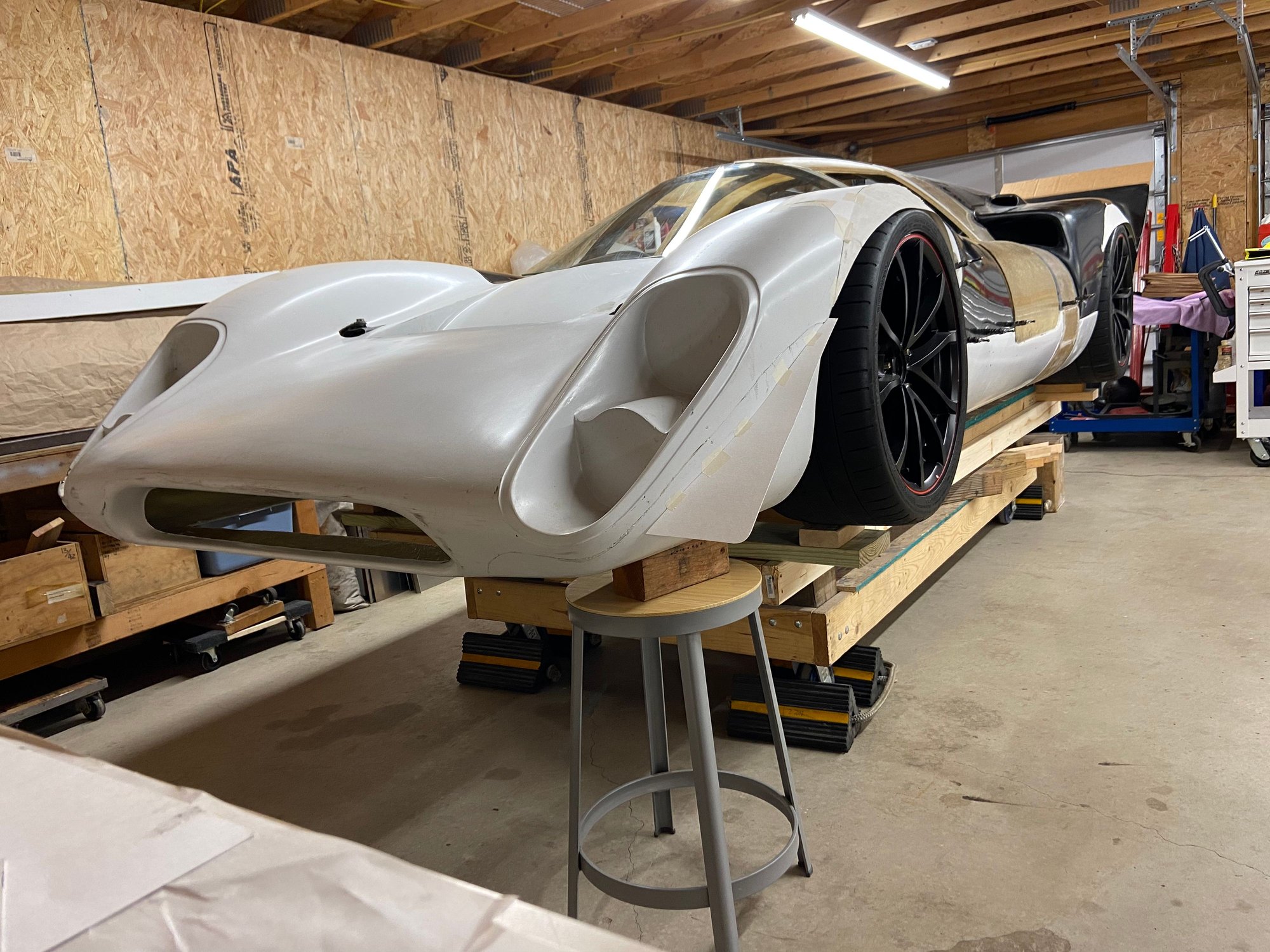

Refitting bodywork again for sidepod alignment check and to see how windshield alignment is.
Designed some port windows behind the doors to flow with style of bodywork.

If you have the time could you measure the top of the rear corner of the intake manifold to the ground and about how far forward it is from the rear axle centerline?
Old Jun 19, 2022 | 06:49 PM
  #88
RSILVR1's Avatar
RSILVR1
Joined: Jun 2015
Posts: 256
Likes: 341
22” & 10” as of the static setting on the table.

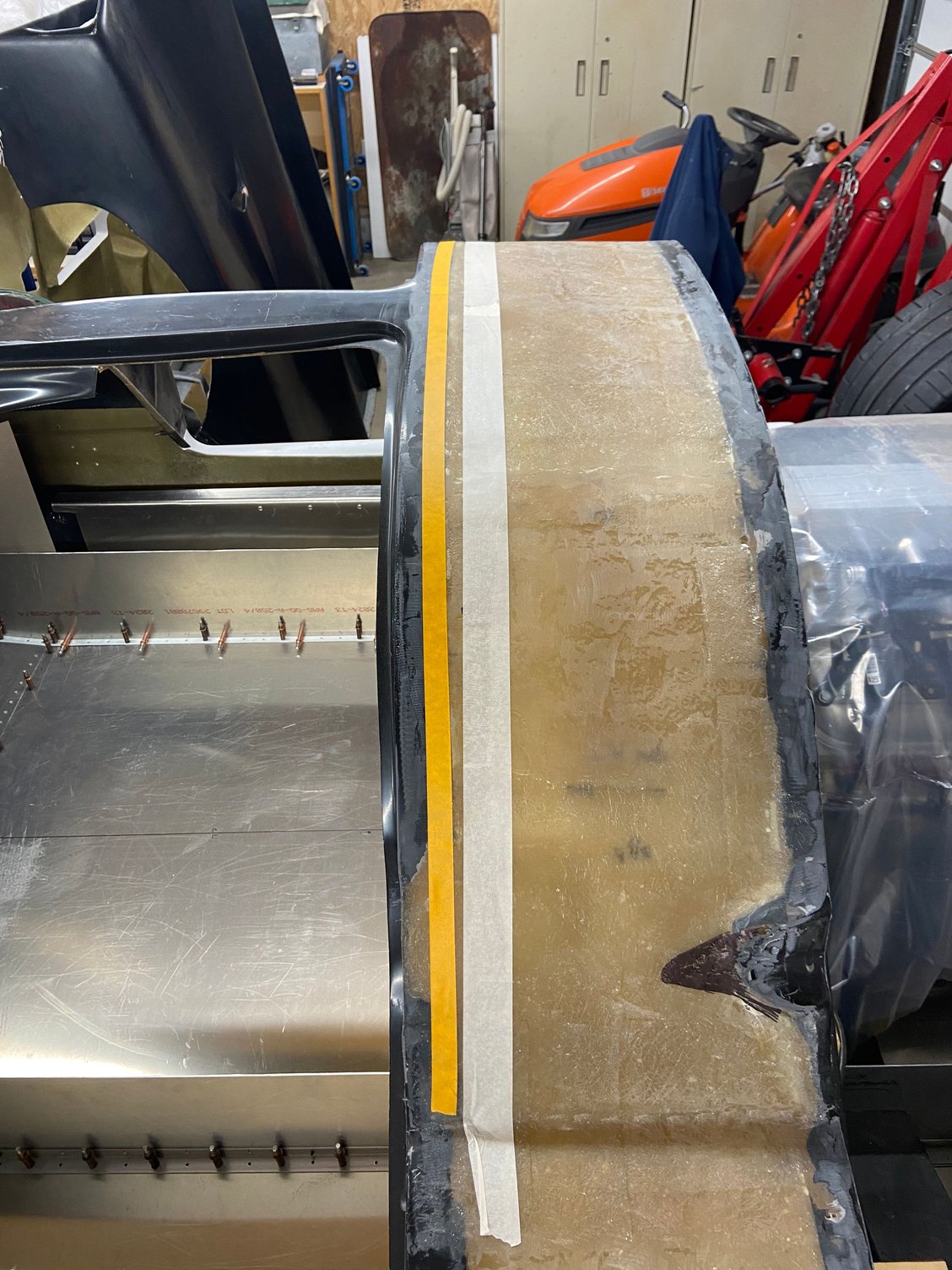

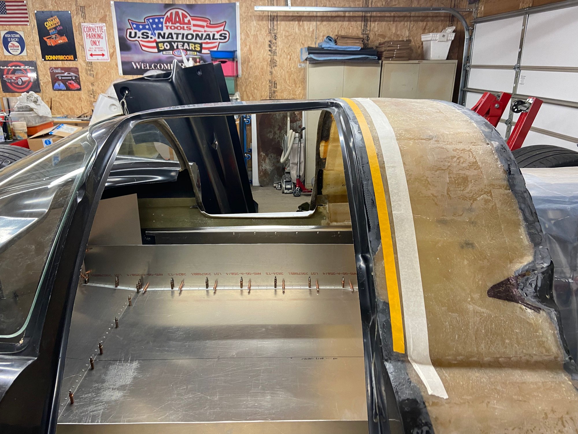

Default Mid engine C5 T70 6/22
Oops, sorry about that. Streetcar pic got in there…my bad.
Well crap, with all my big-brain engineering I didn’t take into account the .500” less material required at the crown for the windshield to lay correctly in the frame….one step forward, two steps back..damm….
I’m slicing a 1/2” strip out of crown now to pull cab upper section aft for correct alignment. Deep breaths…

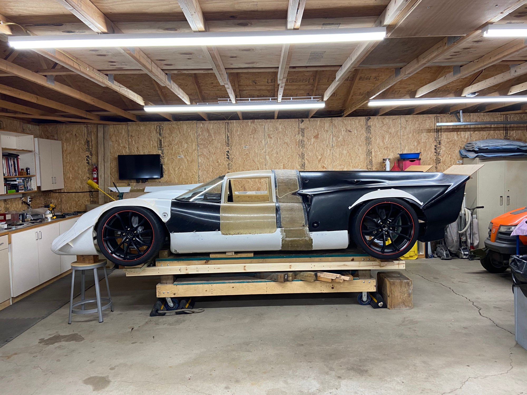

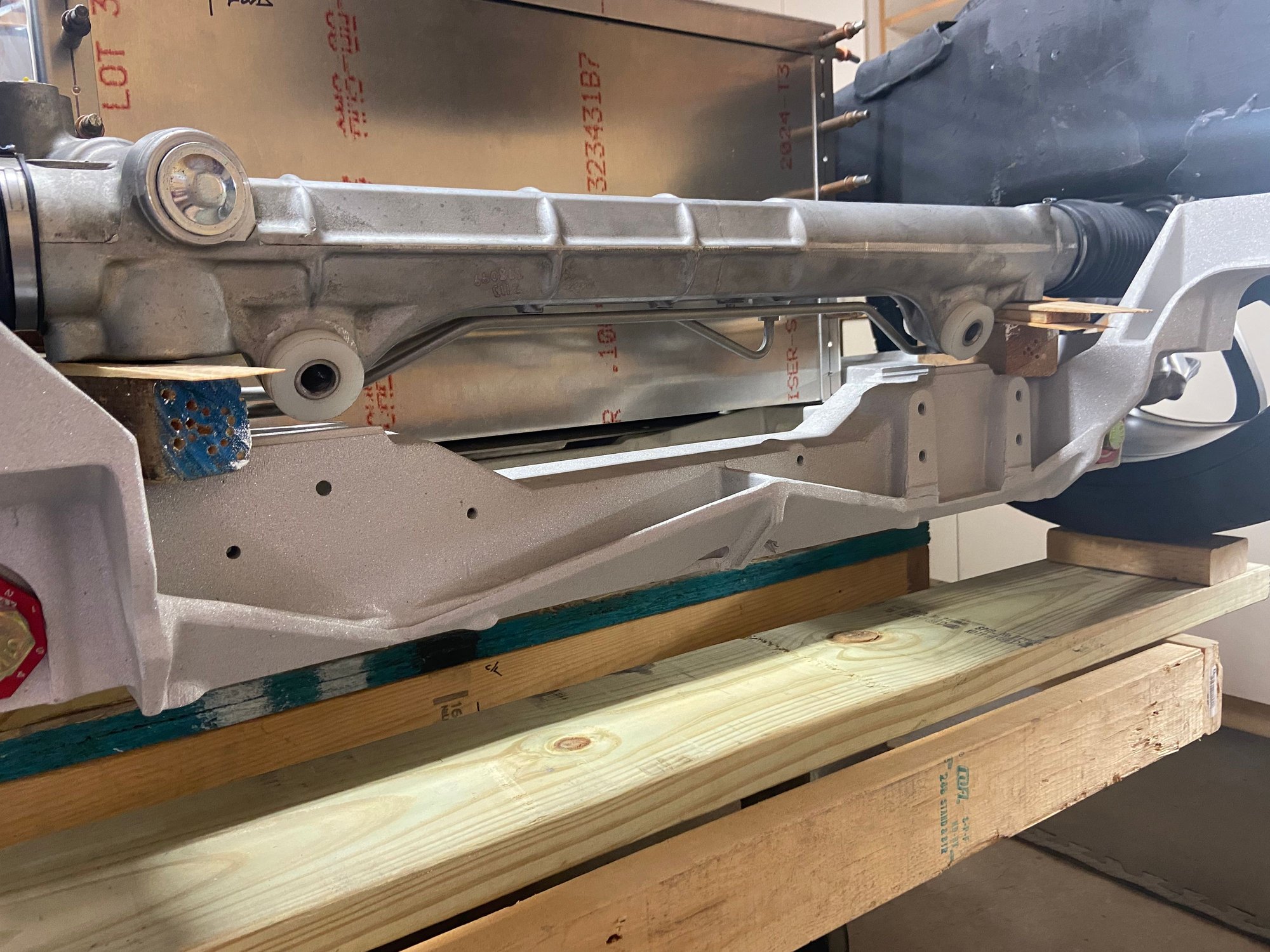

Default 6/26 updates, C5 T70
Machinist friend fabricated my Rack bushings and they fit perfectly. I’ll work on the mounting plates hopefully this week.
Surgery went as well as can be expected, windshield fit is way better but still not to my liking…I’m going to be cutting/fiberglassing a number of time to get everything right. Pulled all the bodywork & cleaned the chassis & shop up from the big-*** mess. Worked on sidepod close outs and some transaxle alignment items.

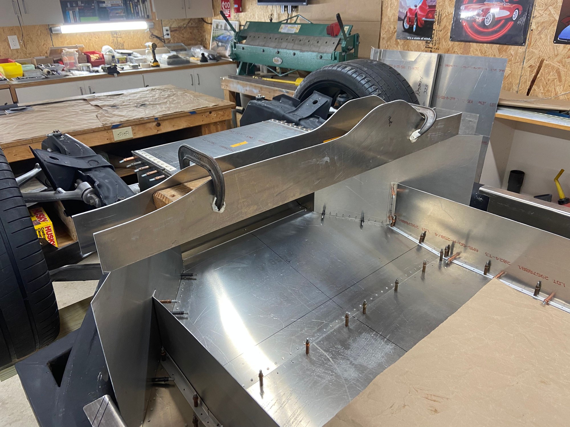

Default C5 Mid engine T70 7/17 updates

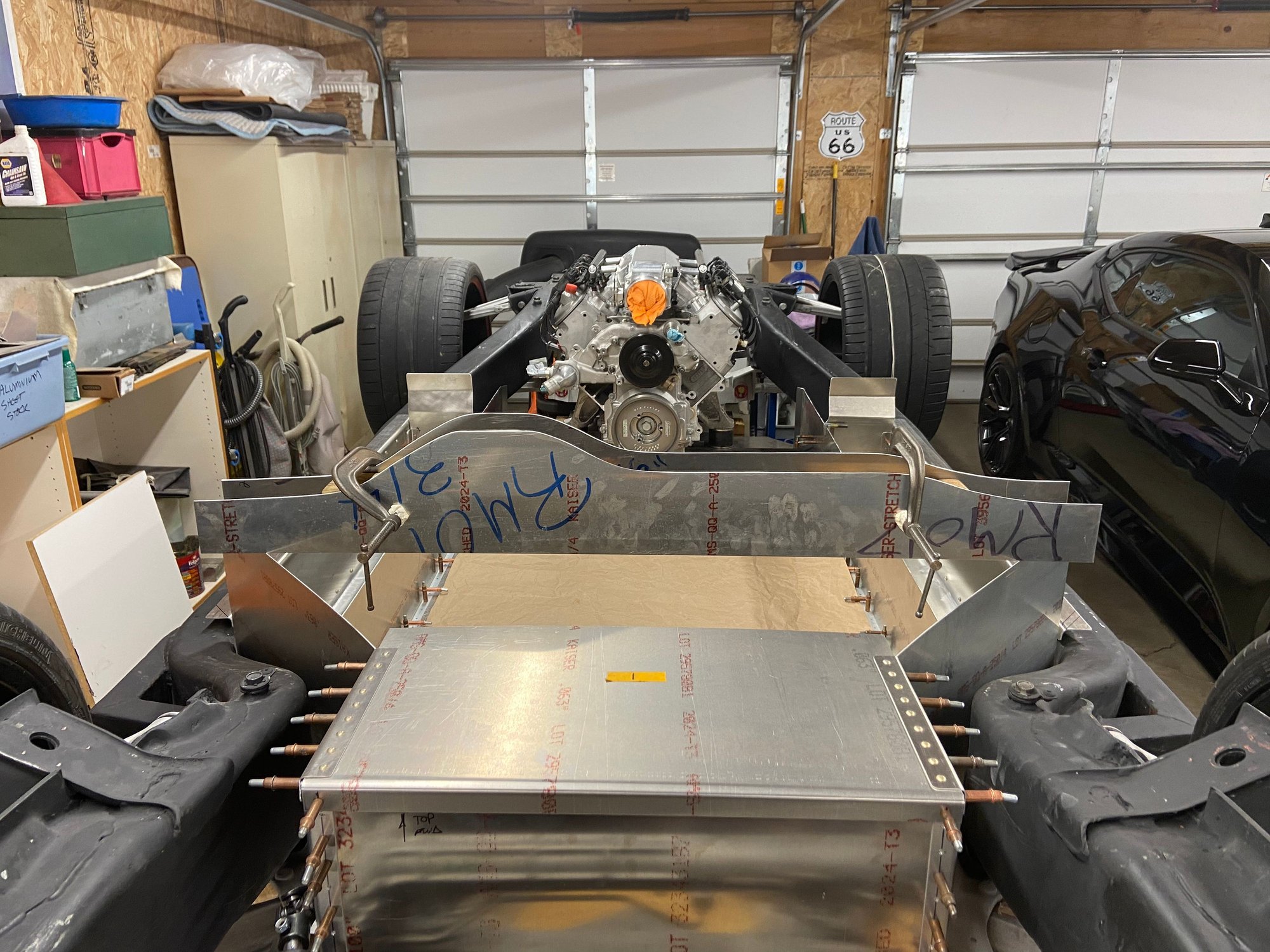

Cutout the dual panel patterned today
I have the panel just sitting on the side close outs and it’s actually only about .200” on the left side. I’m very happy with the results
I’ll start welding on the frame tabs then cutout the upright’s here shortly.

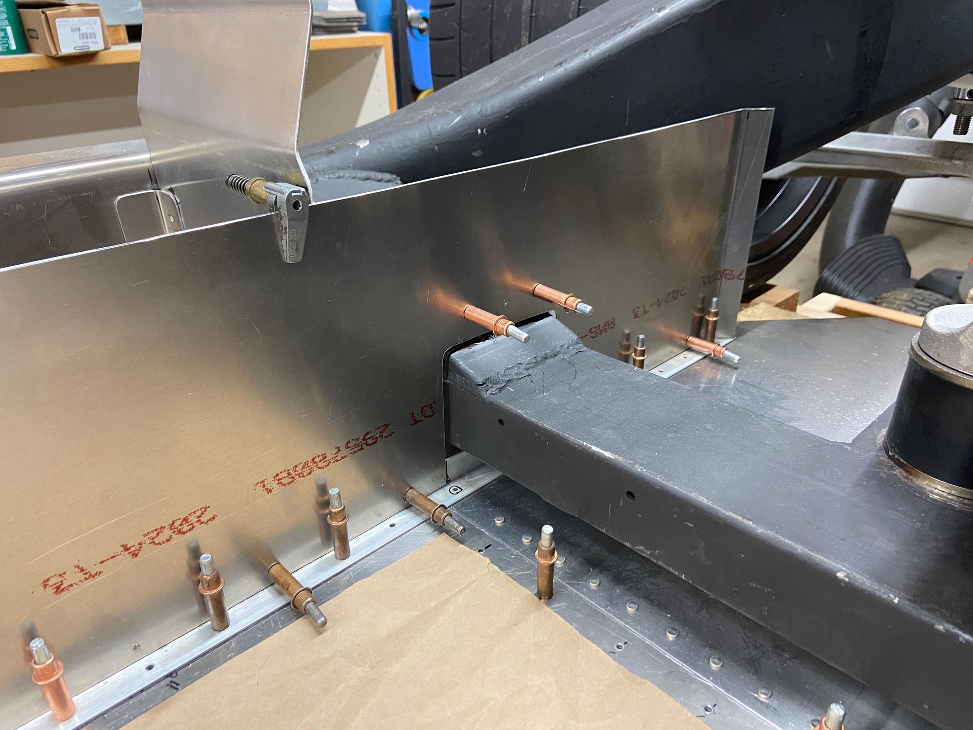

Default More updates

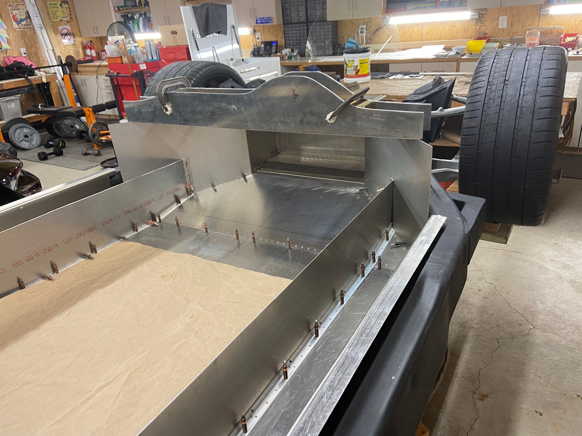

Located pilot holes for uprights.
I have a lot of little material removed from the frame. Fab’ed up some tabs that work great for this support.
