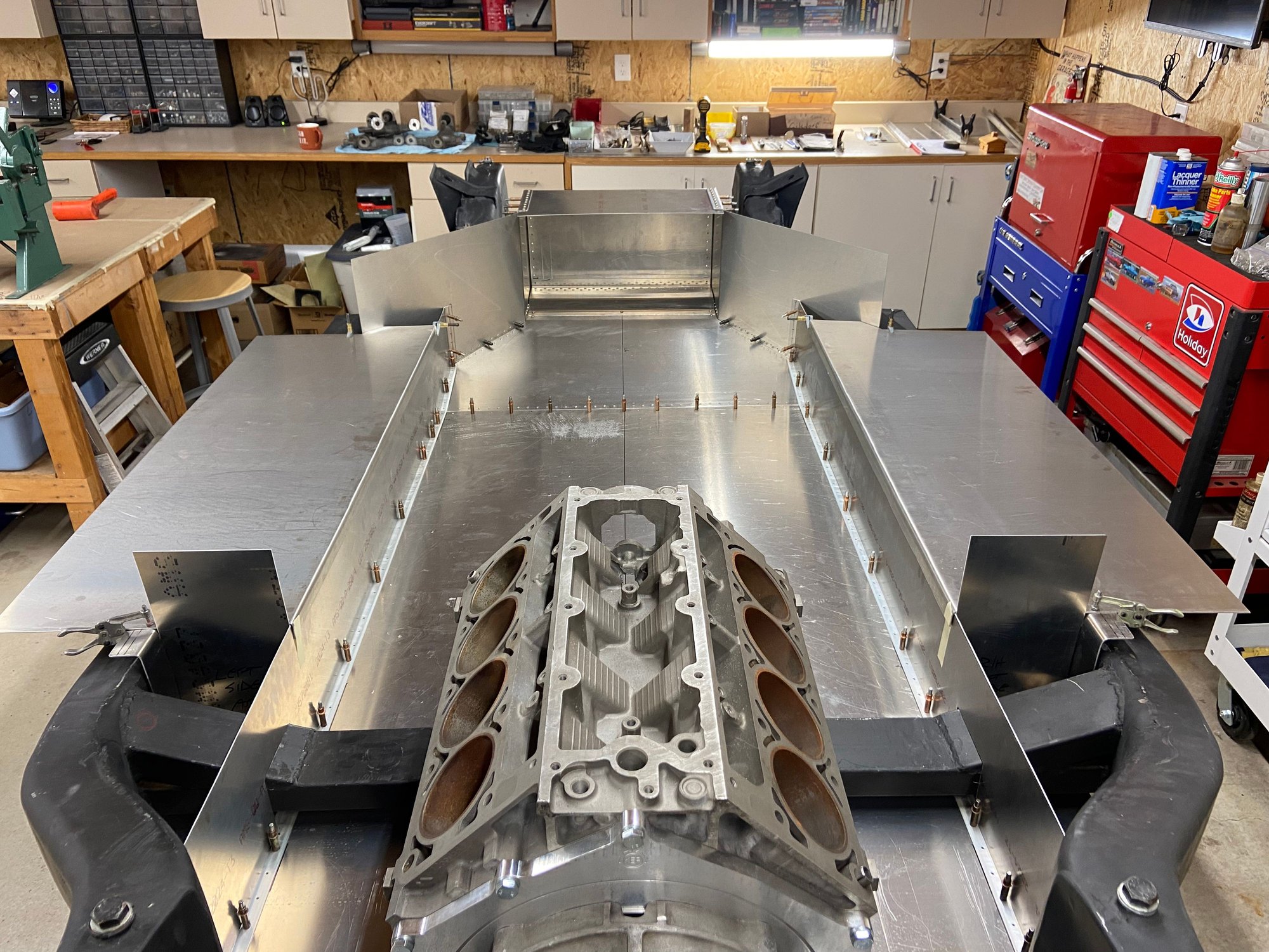

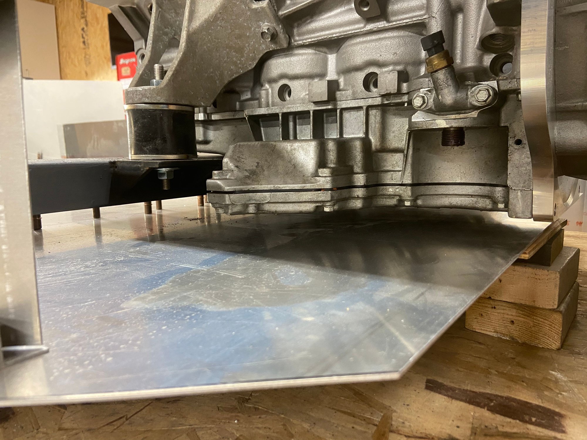

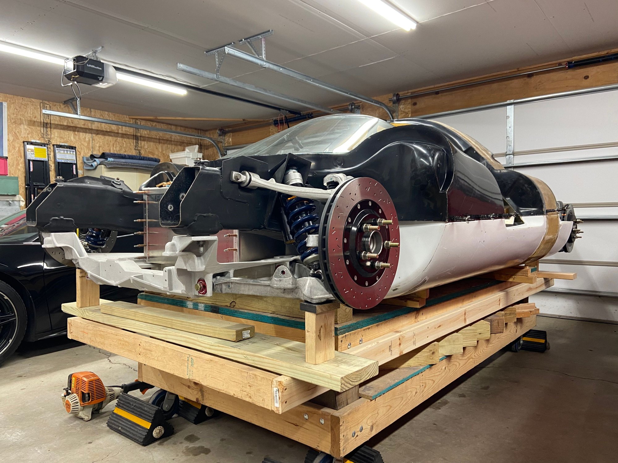

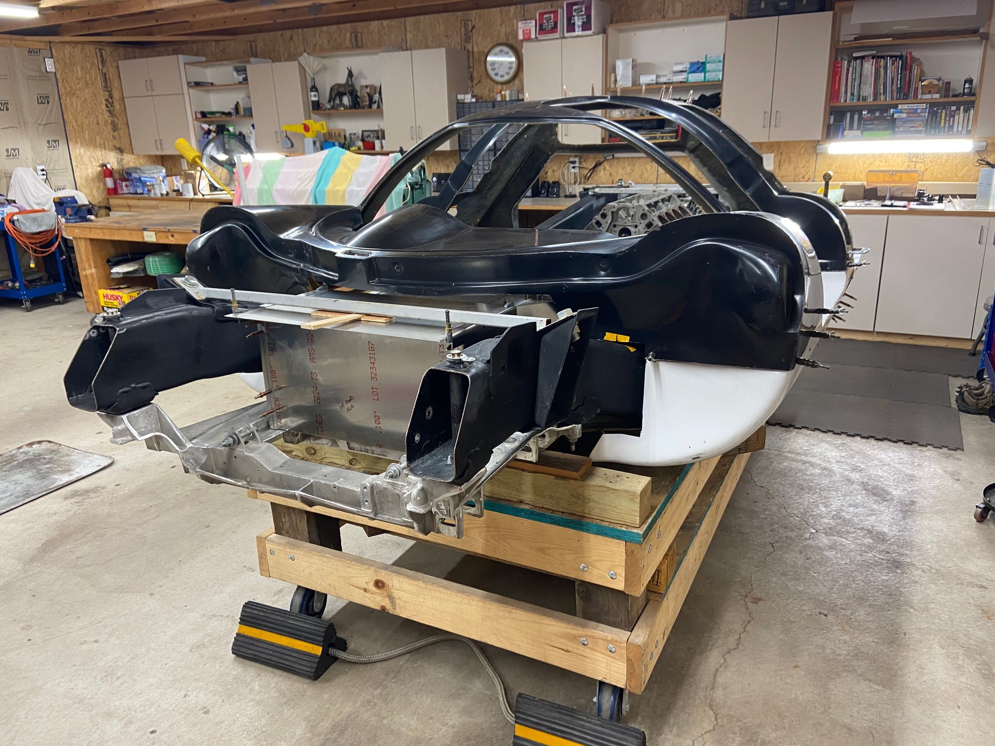

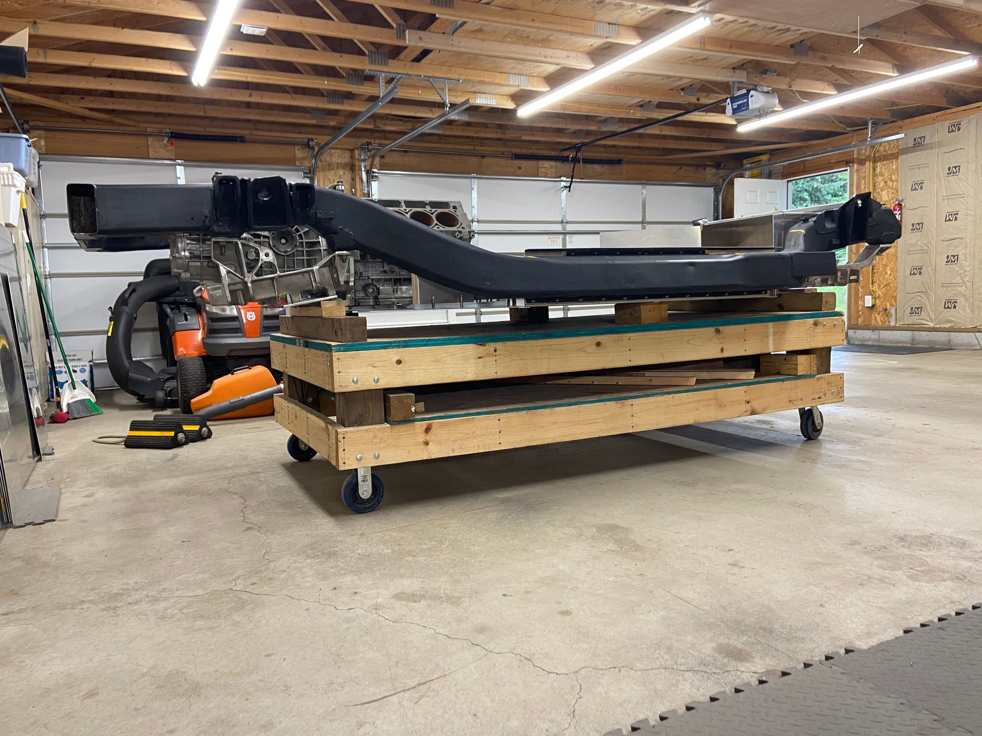

Hinson short motor mounts showed up today, pan is now about as low as you can go with a stock bat-wing. Bell housing has 5” ground clearance now.
belly pan has 3.75” ground clearance behind front tires, about 4.5” ground clearance forward of rear wheels.
Foot-box taking shape
Should have this laid-out & pilot drilled pretty quickly. I’m trying to set forward toe-board location now. I’m starting with 4” between rack & toe-board for master-cylinder clearance.

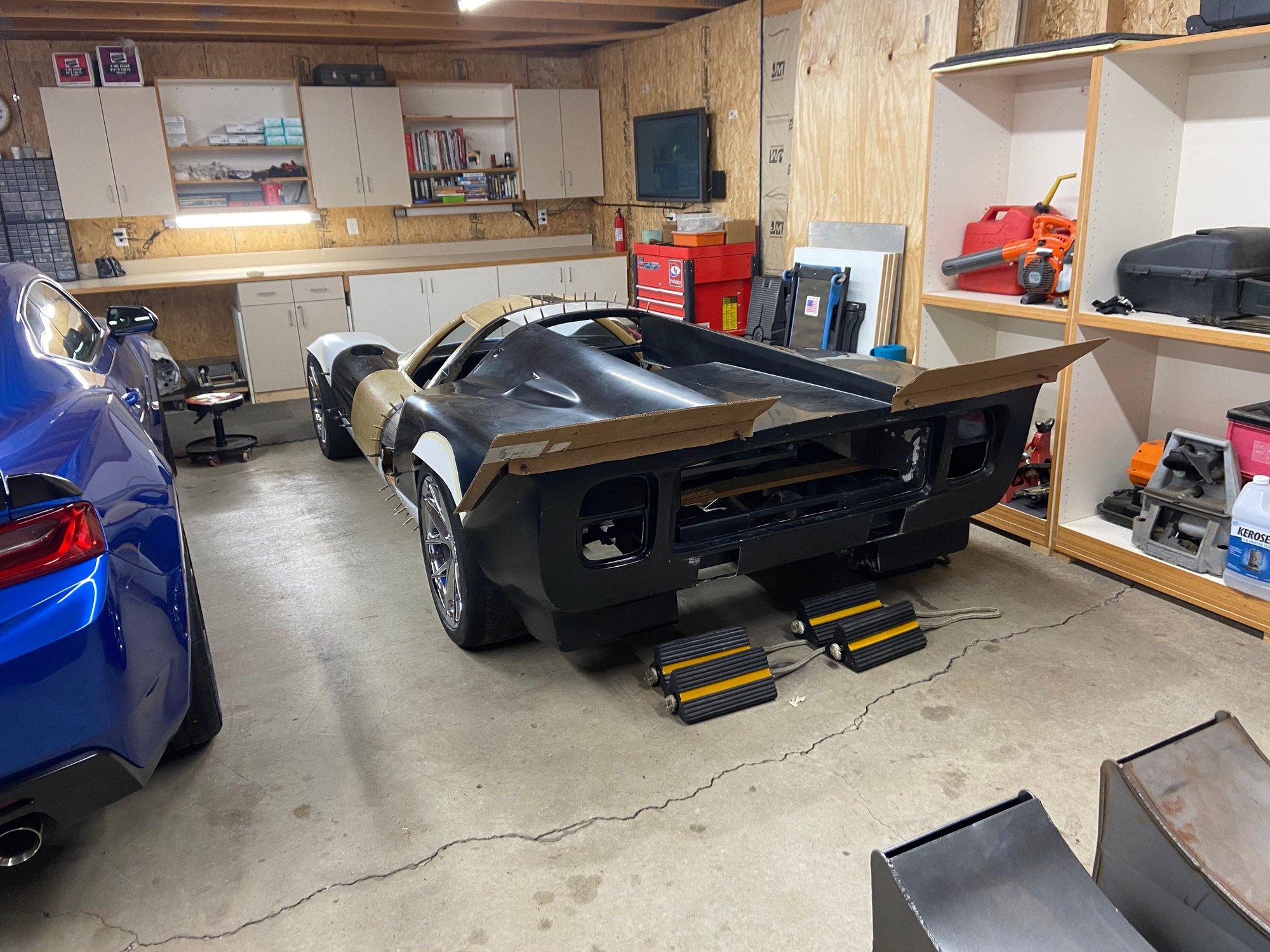

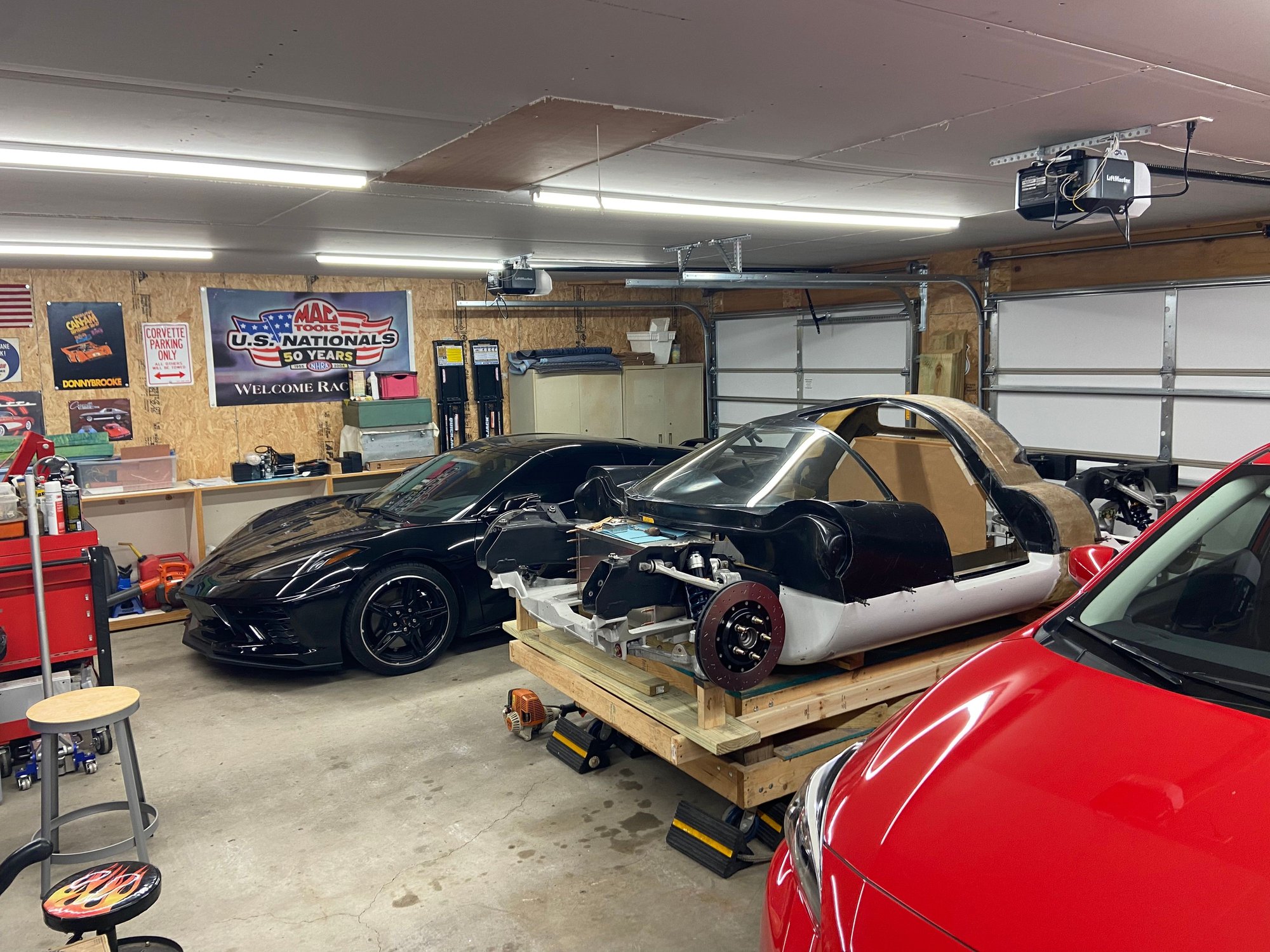

I have tub and bodywork in the location that I want it now. The contour of the sidepods is still wrong but nothing the old highspeed and some fiberglass won’t fix.

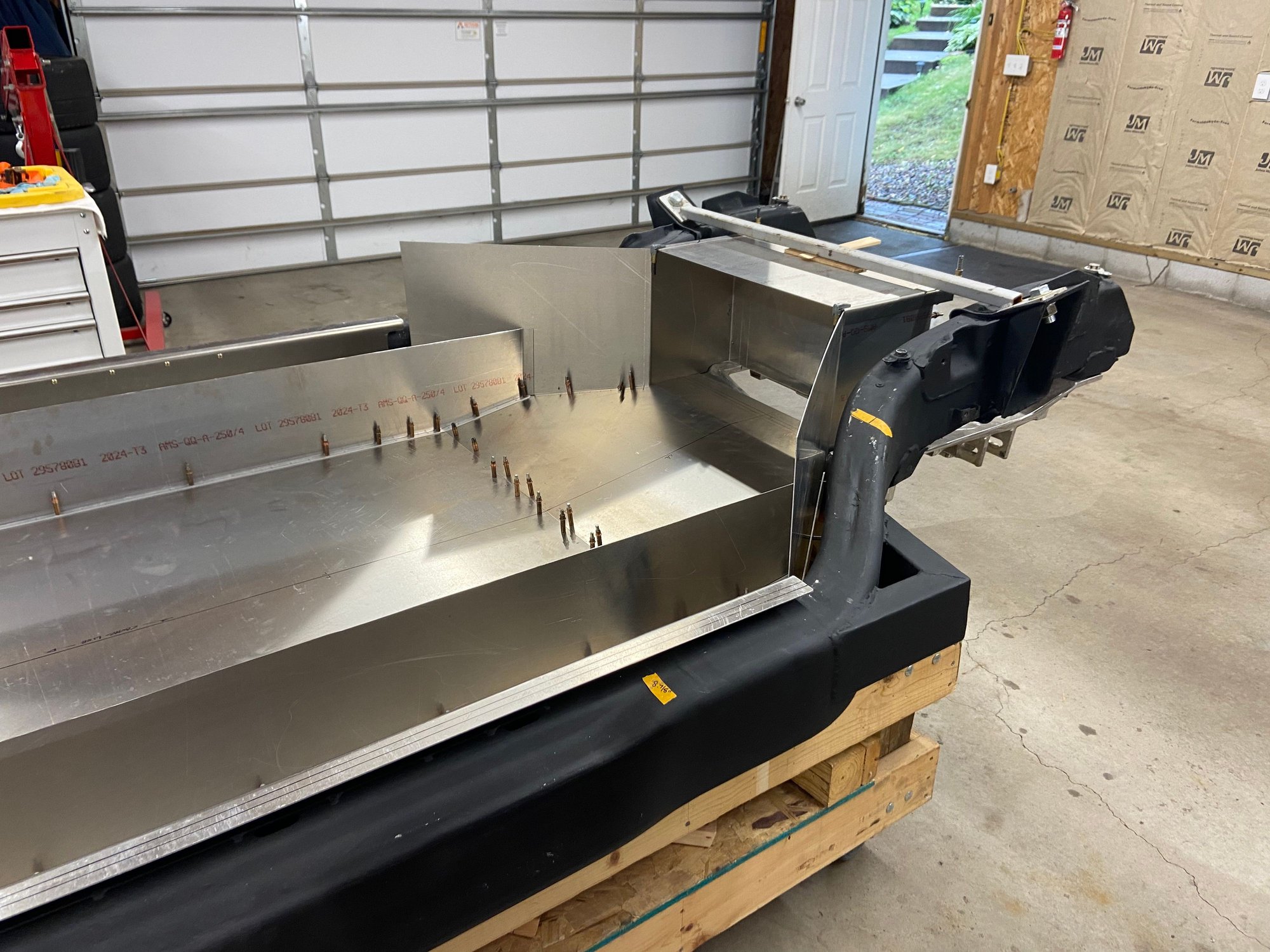

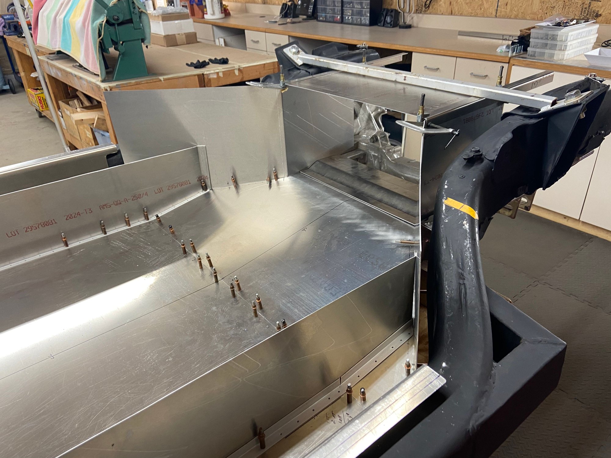

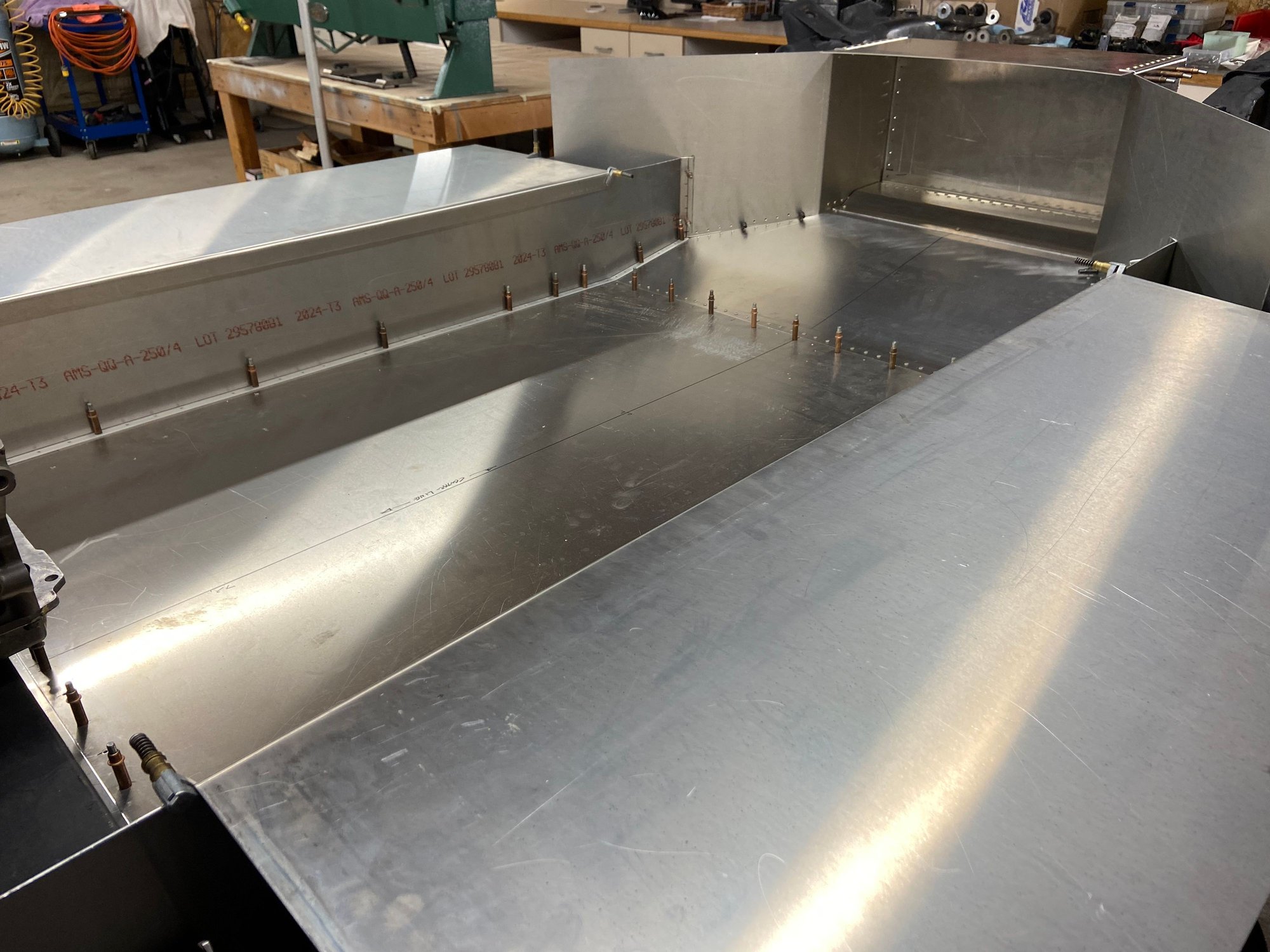

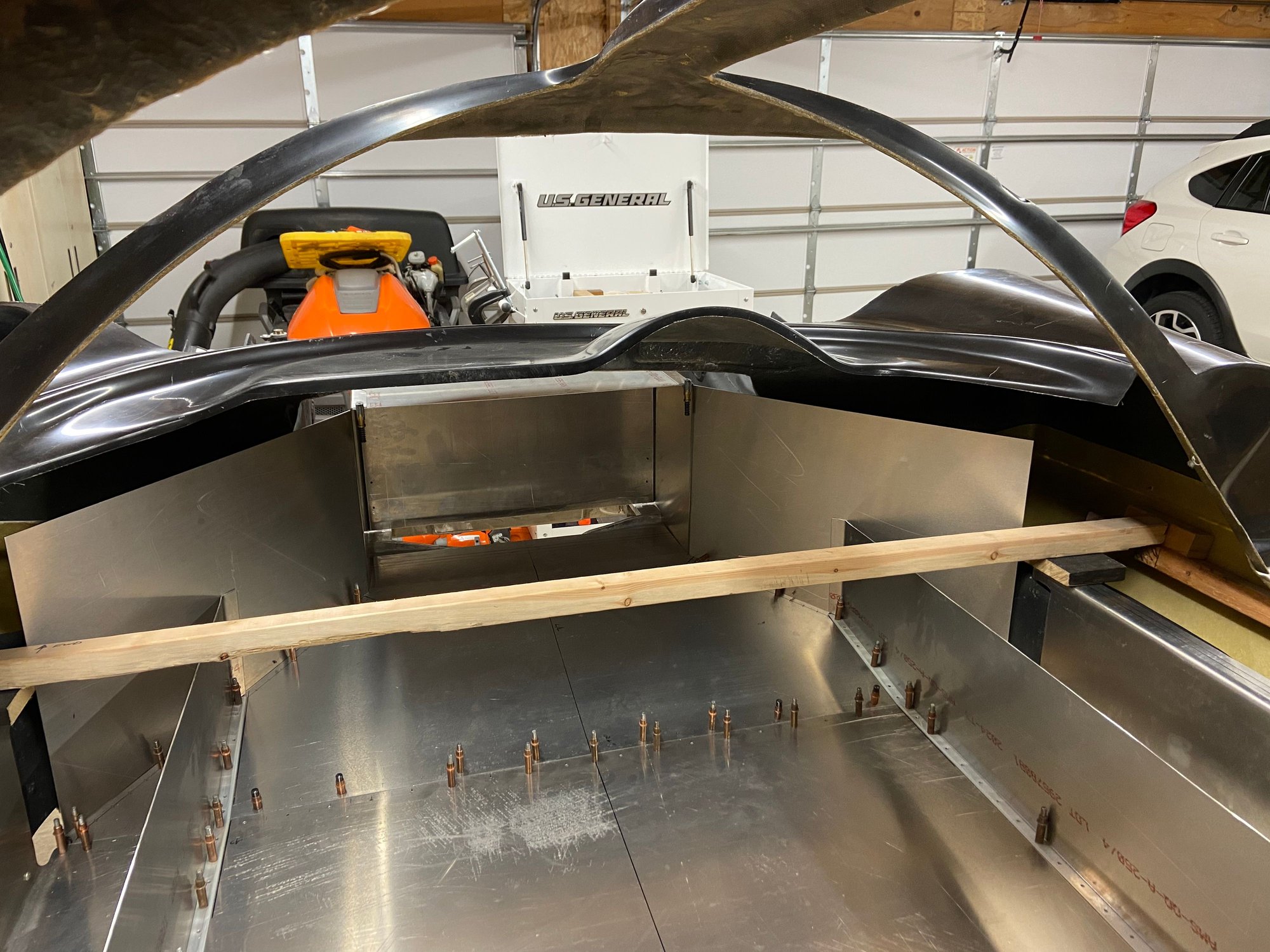

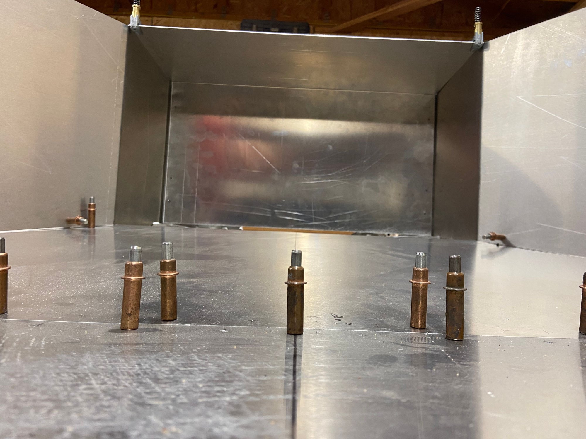

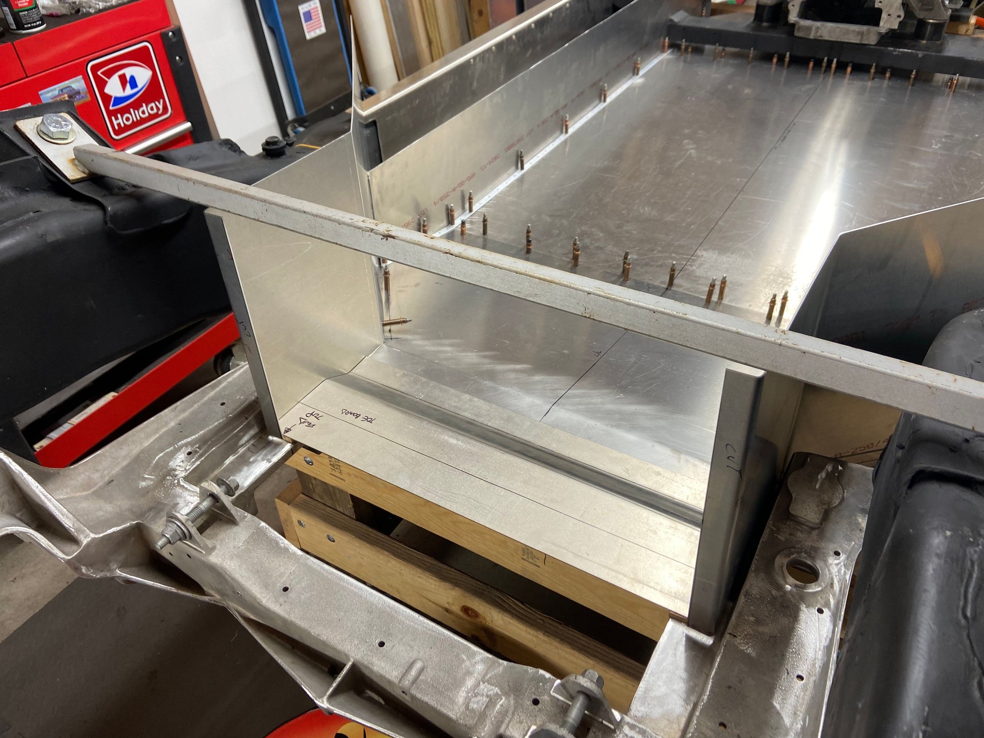

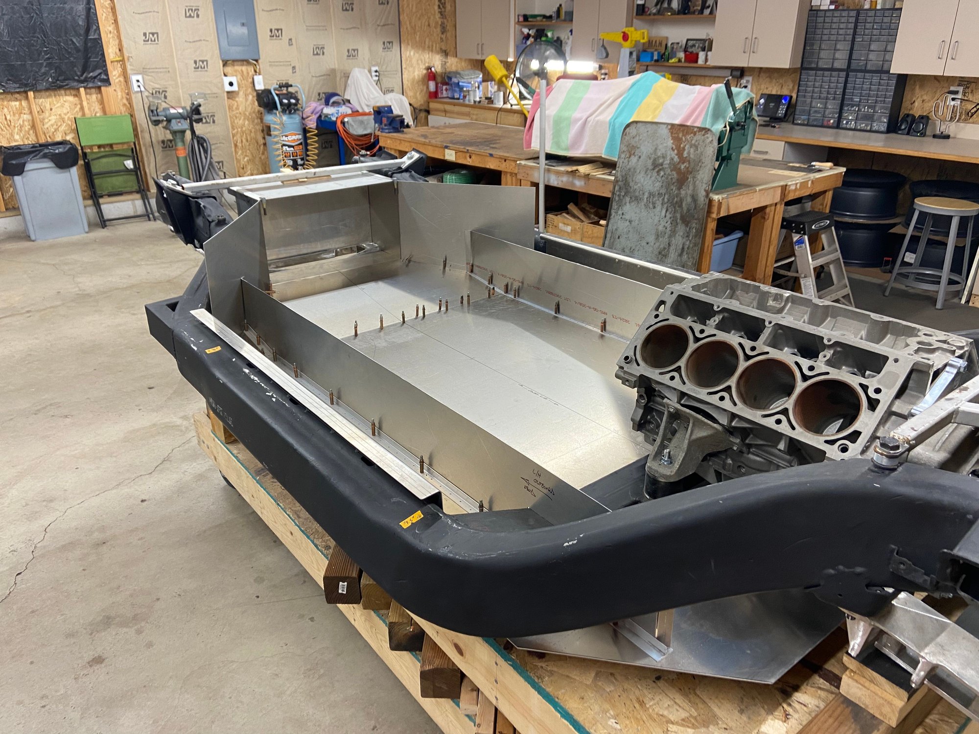

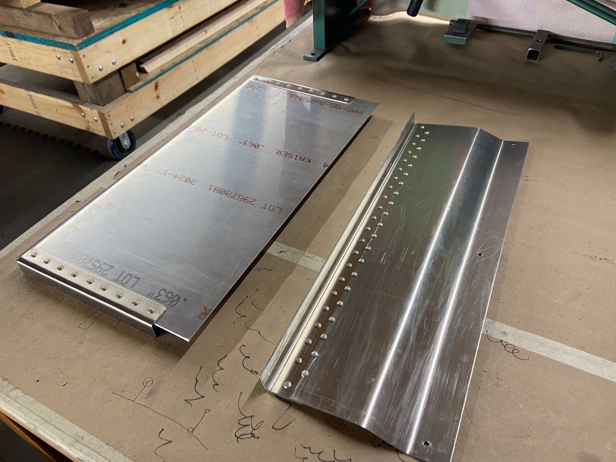

Finished trimming & bent-up side panels.
Drilled up angles & forward toe-board, piloted everything #30’s
Toe-box is square & tight! I’m pretty happy with the outcome.

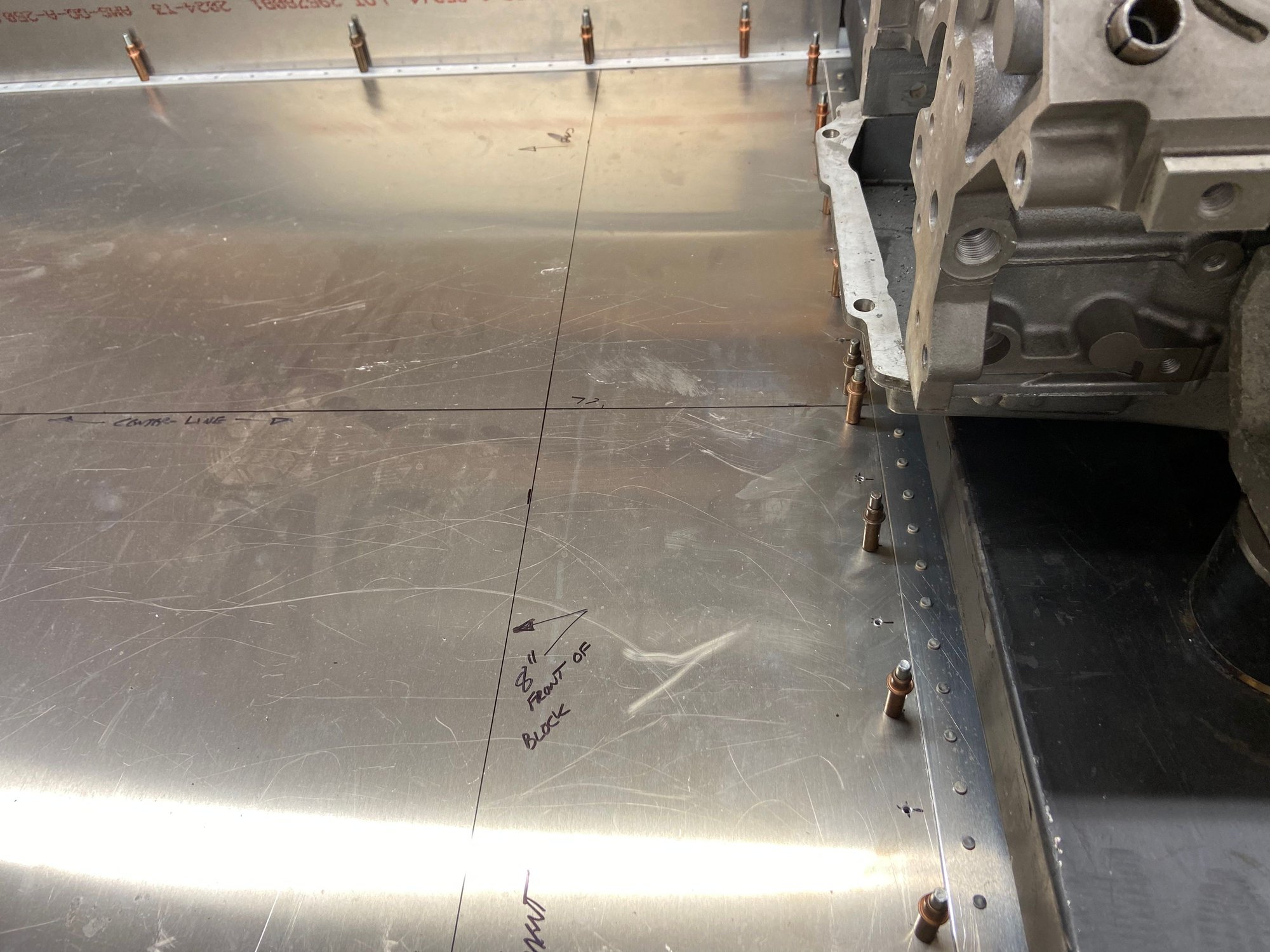

Main floor is mostly completed now, from pedal-box all the way to rear crossmember.
Little better shot of forward area.
With the cab & sidepods reinstalled, you can get an idea of the interior.
Cab sits about an inch above foot-box. Forward panel is 4” aft of the steering rack.

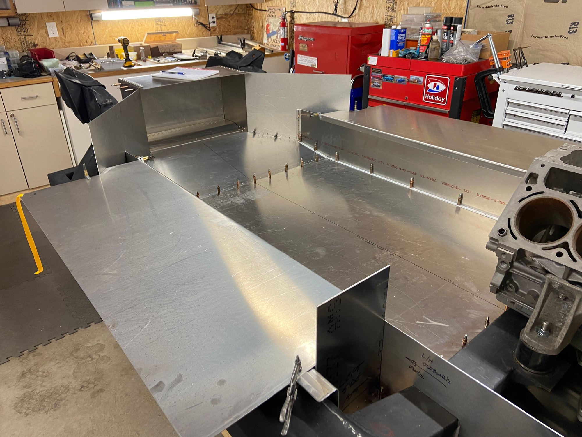

Better view of belly,

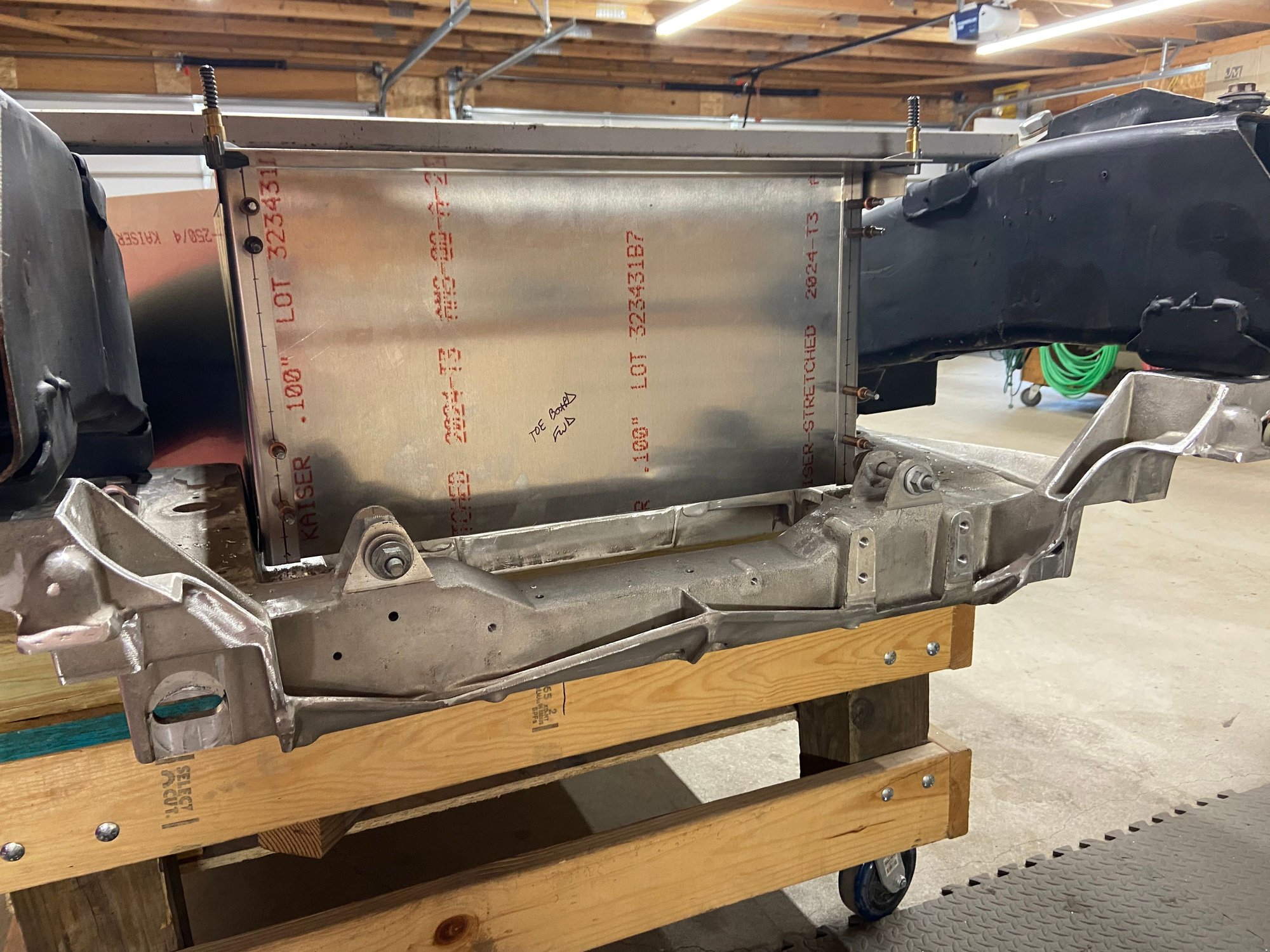

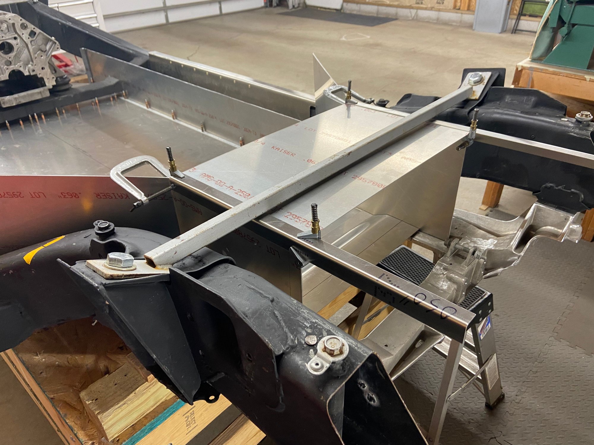

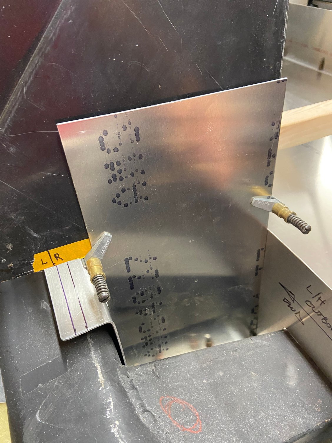

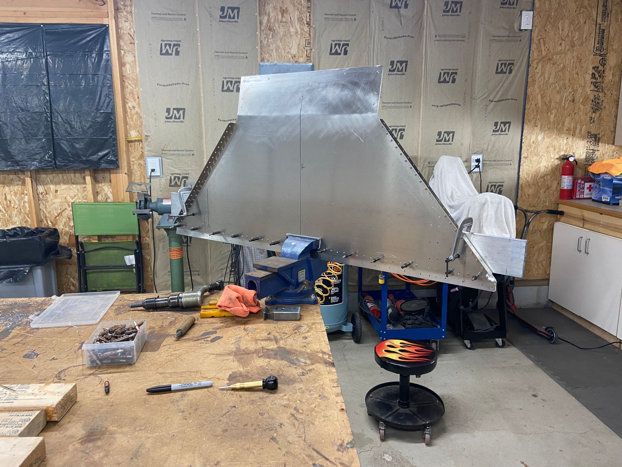

Moved on to fabricating Tombstone on each side of the sidepods.
Starting with 2024-T3 .080” like the floor. These will be rear-cab attach points along with the job of closing out engine compartment from the cab.

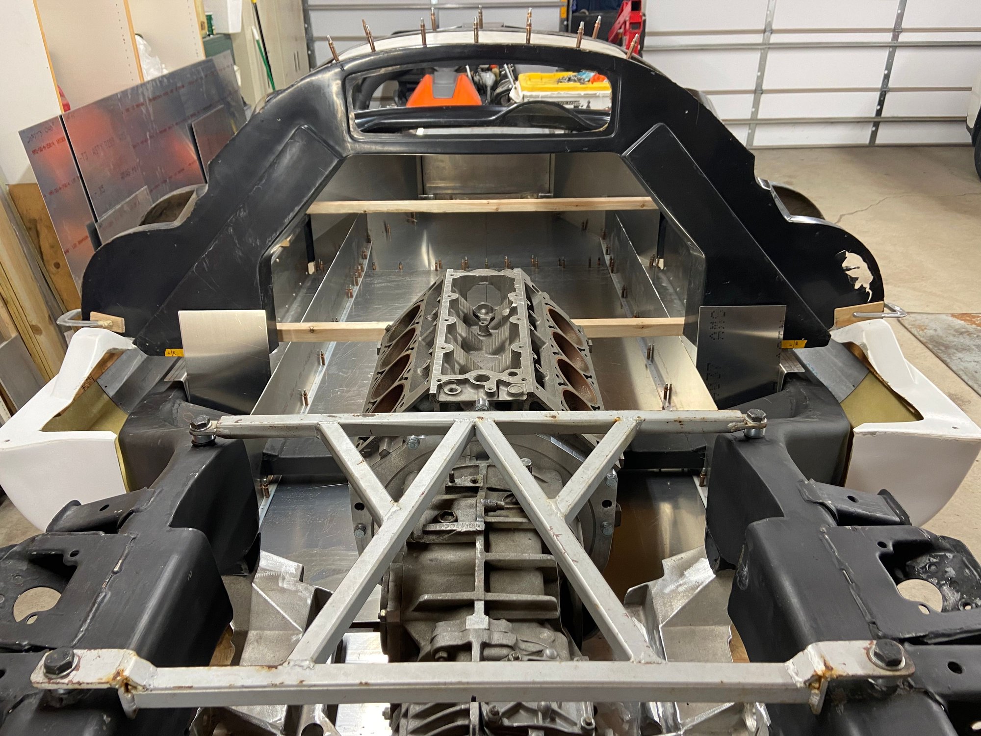

Fab’ed sidepod tops & located tombstones. Going to remount bodywork for sidepod trimming as needed. Starting to locate firewall location measurement.

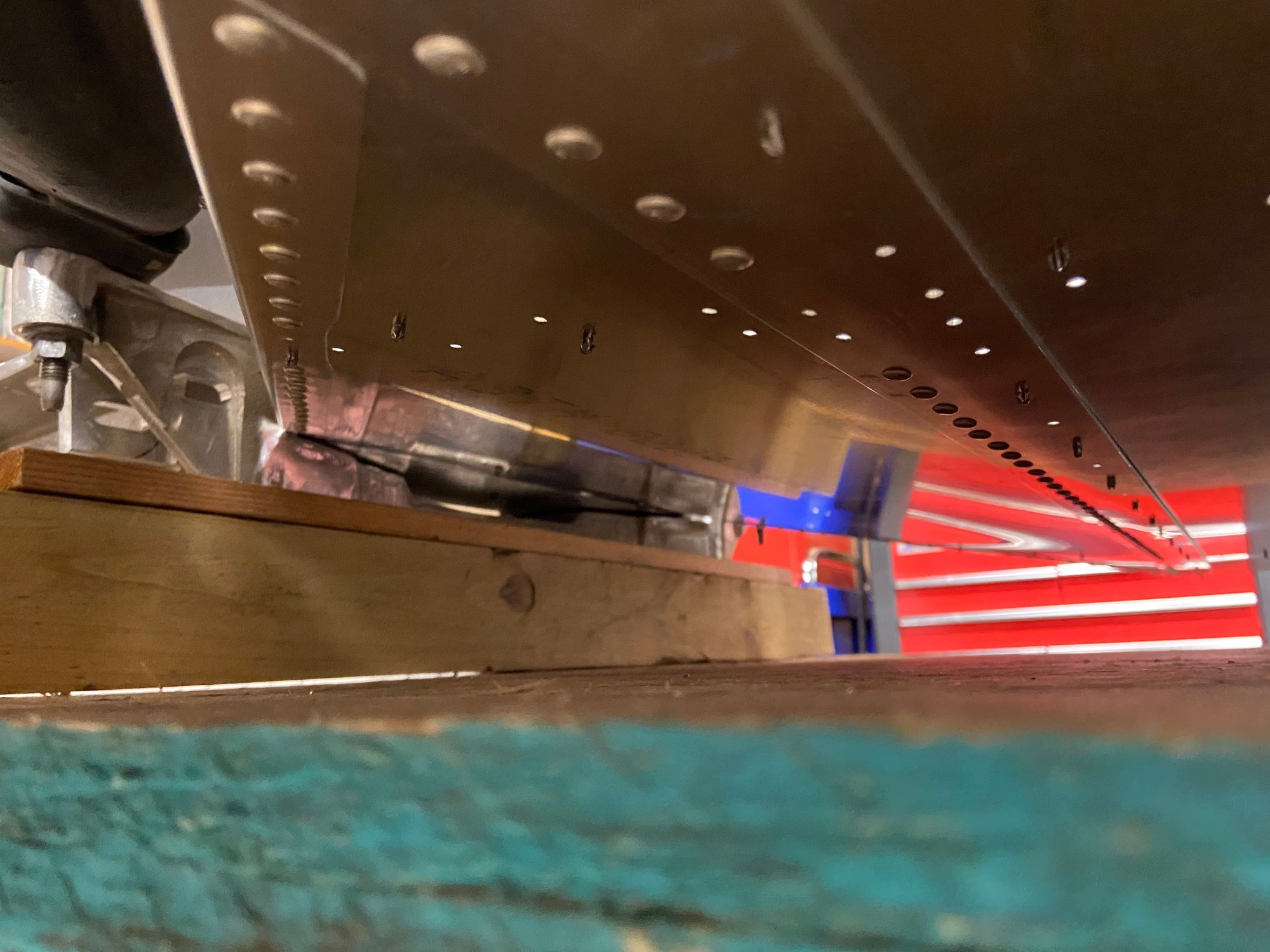

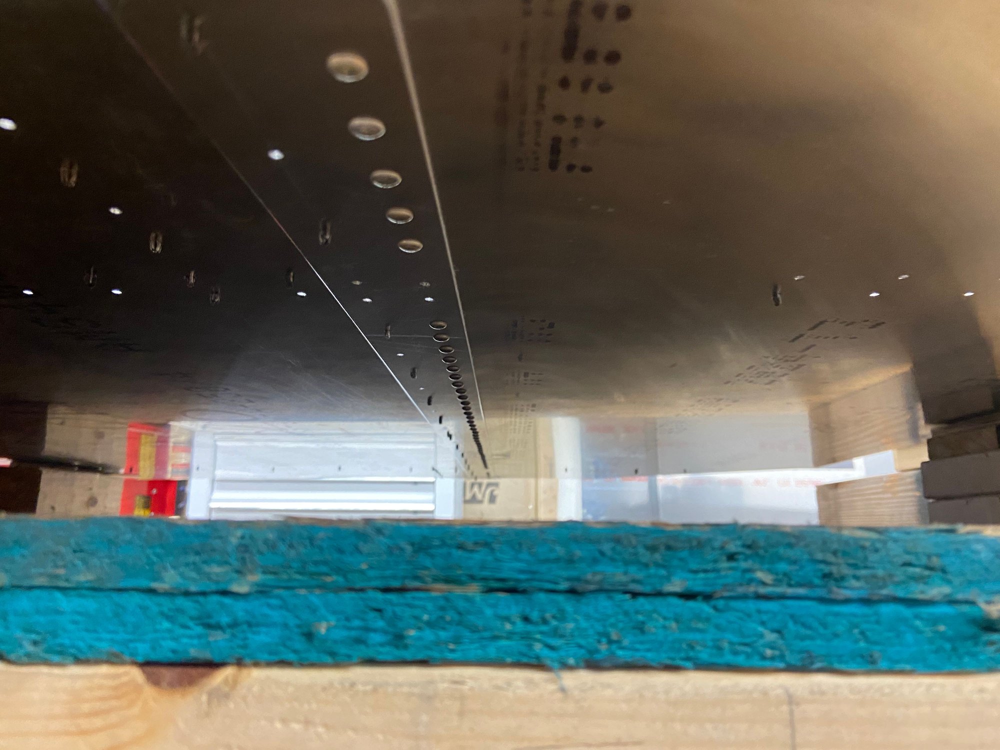

Finally started shooting rivets.
Pedal box riveting.
Aft seam look from bottow.
Forward seam looking towards front cradle.

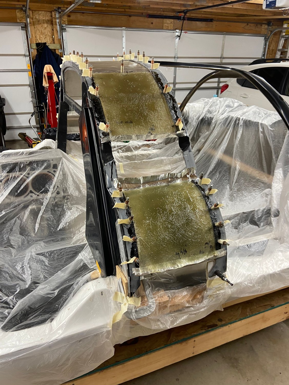

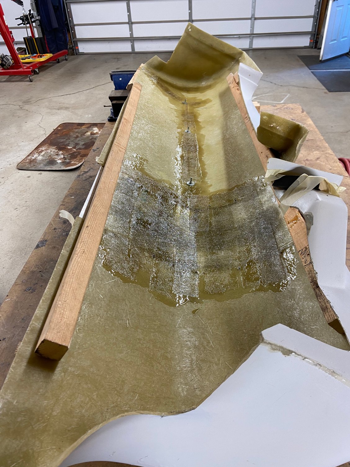

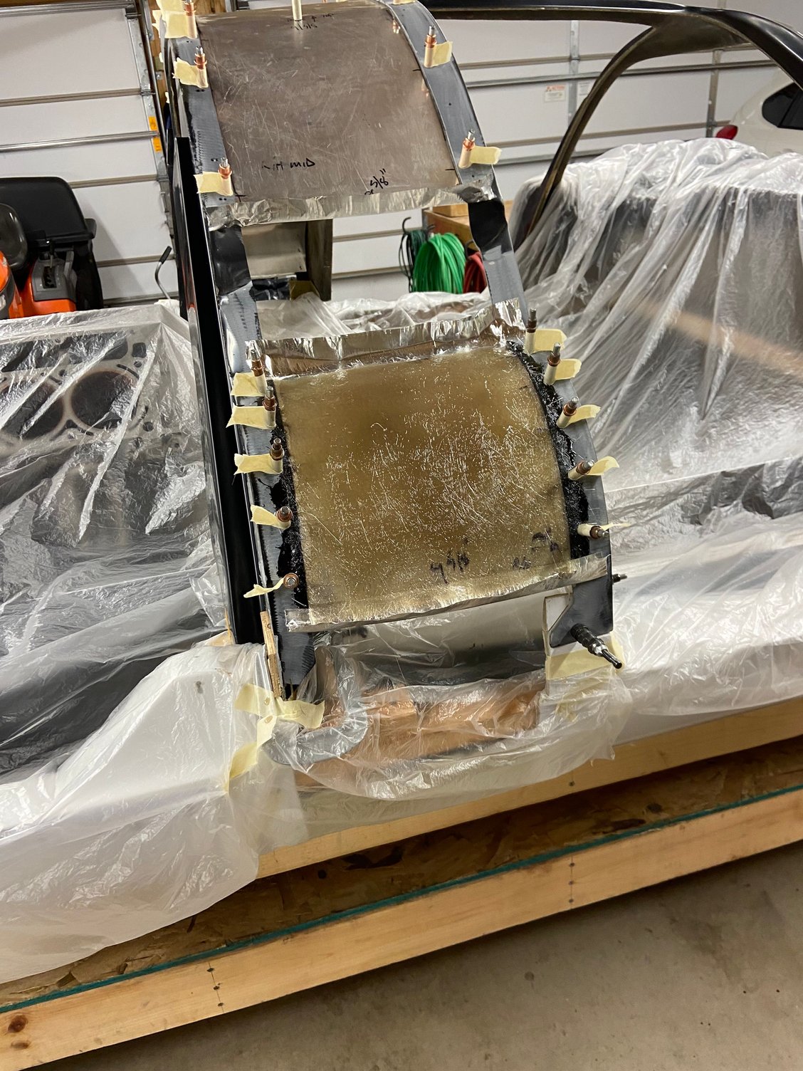

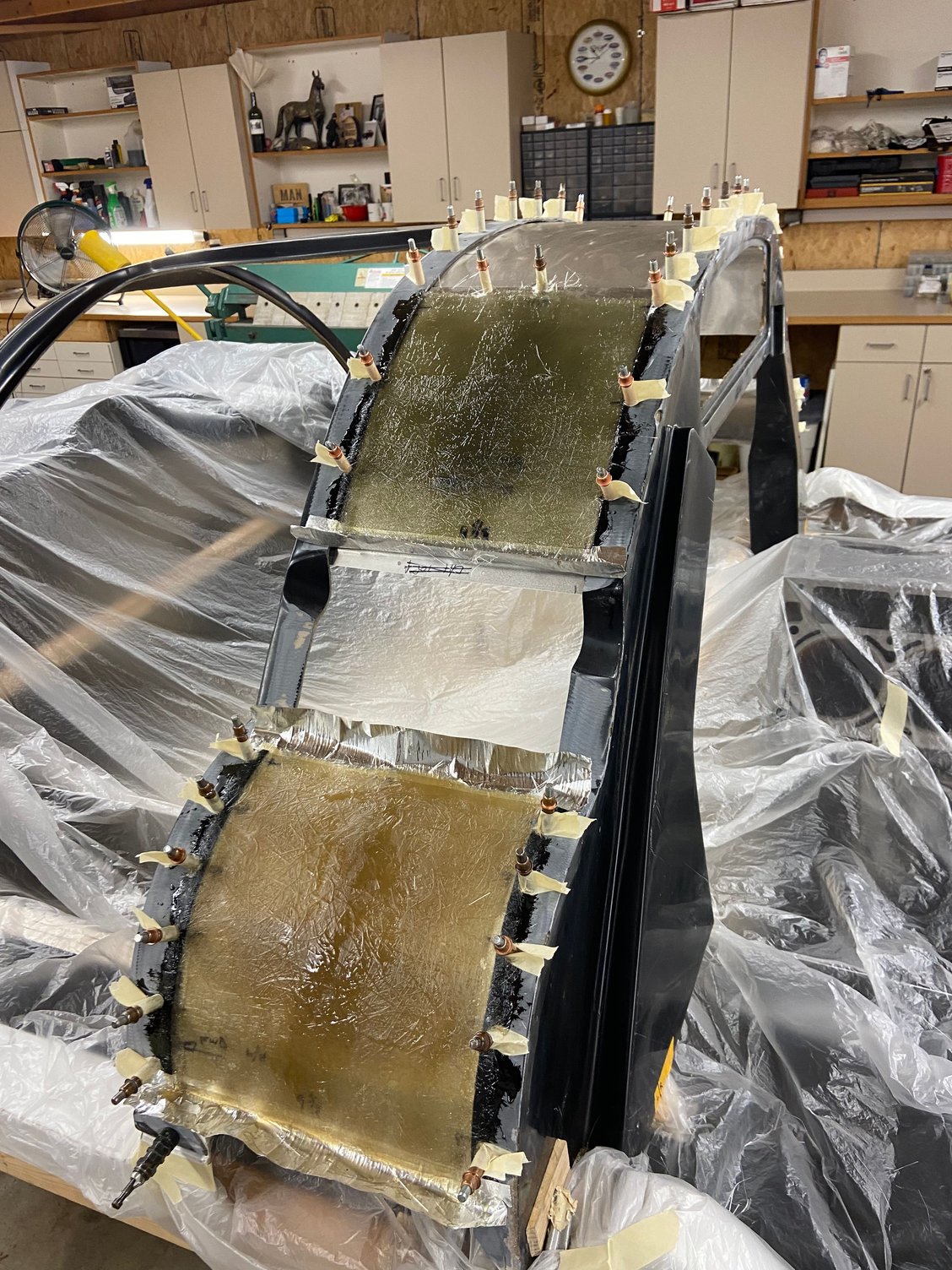

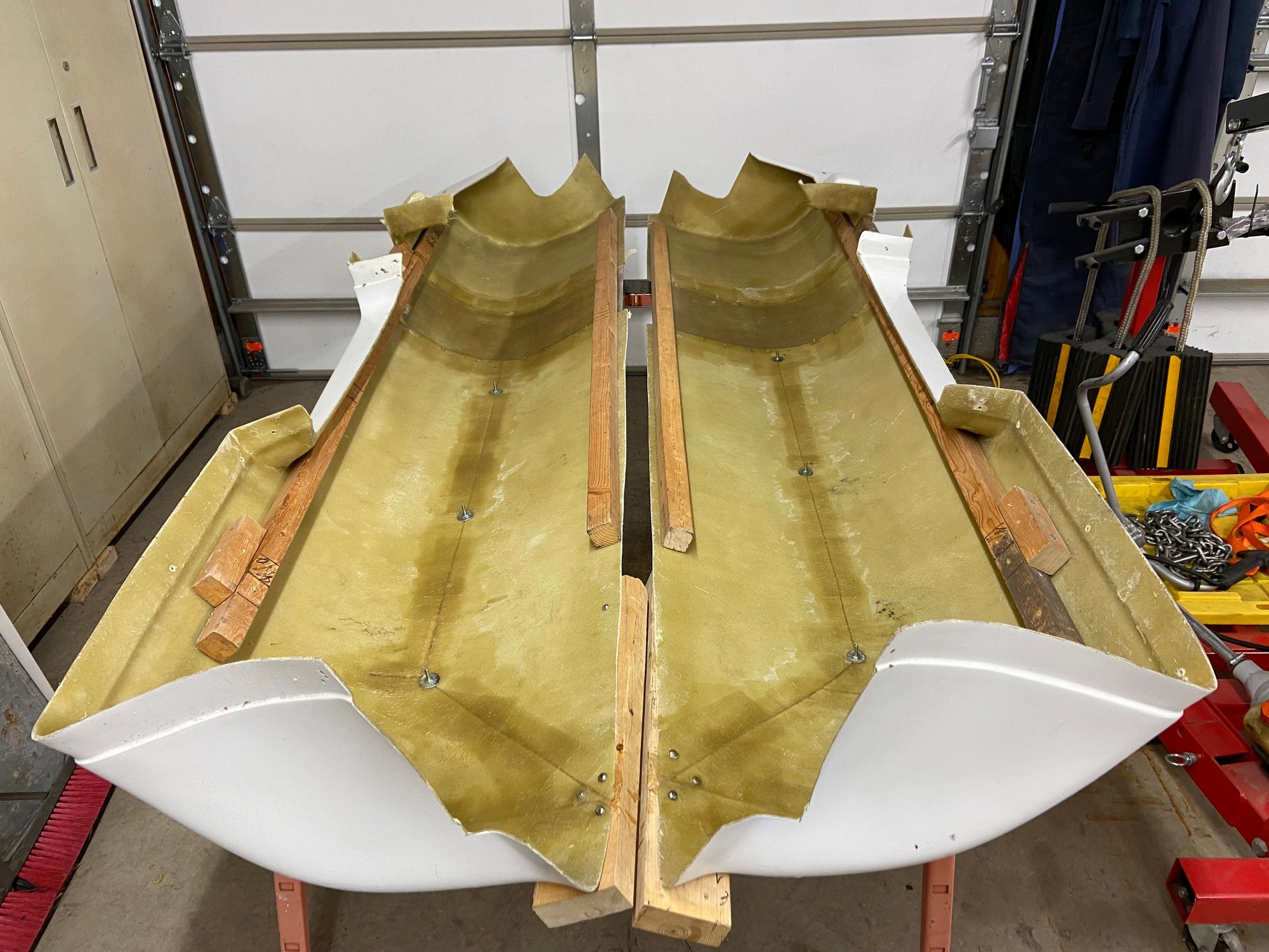

Time for some glass’n….
4-layers going on.
First round done, ready to rough trim.

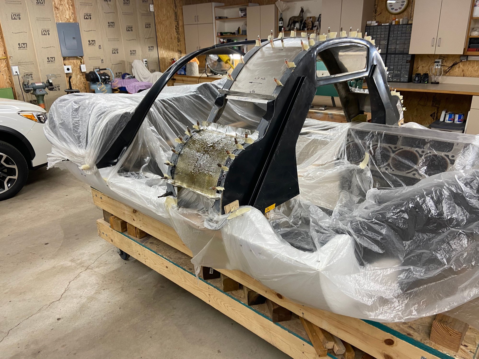

Sidepods trimmed & reinstalled along with cab. Time to glass cab
Sanded, prepped, tape border installed. Release agent down & we’re ready to dance.

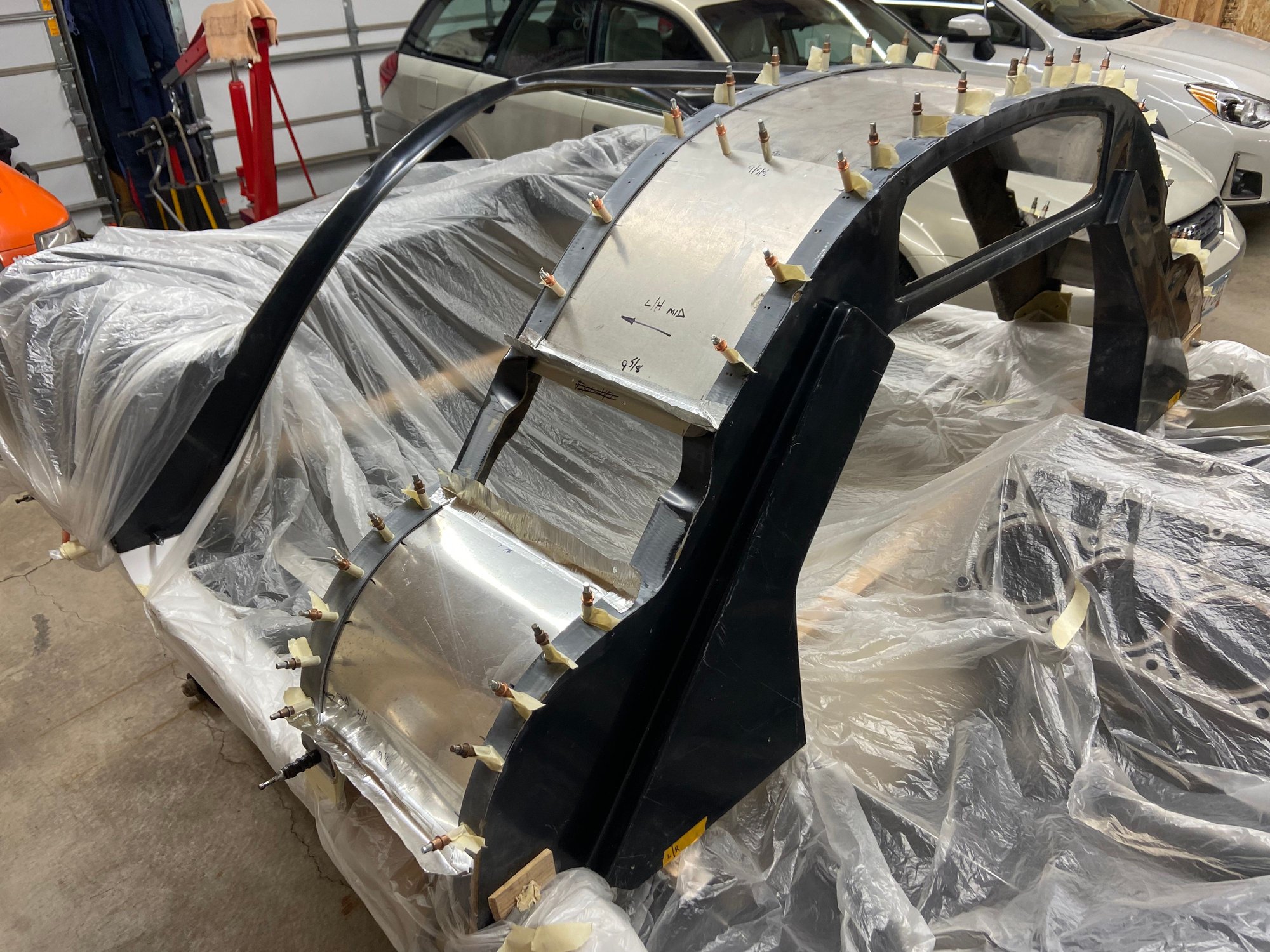

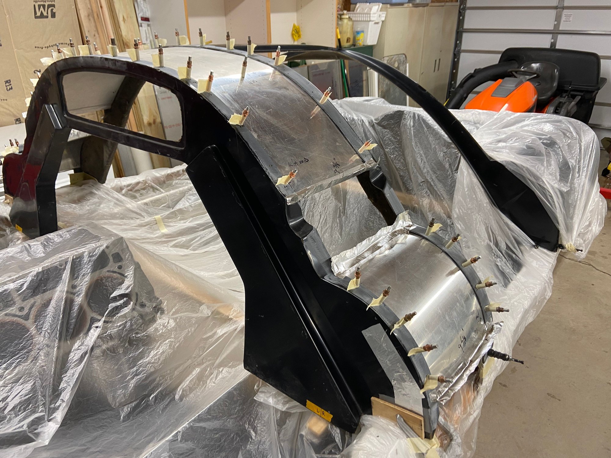

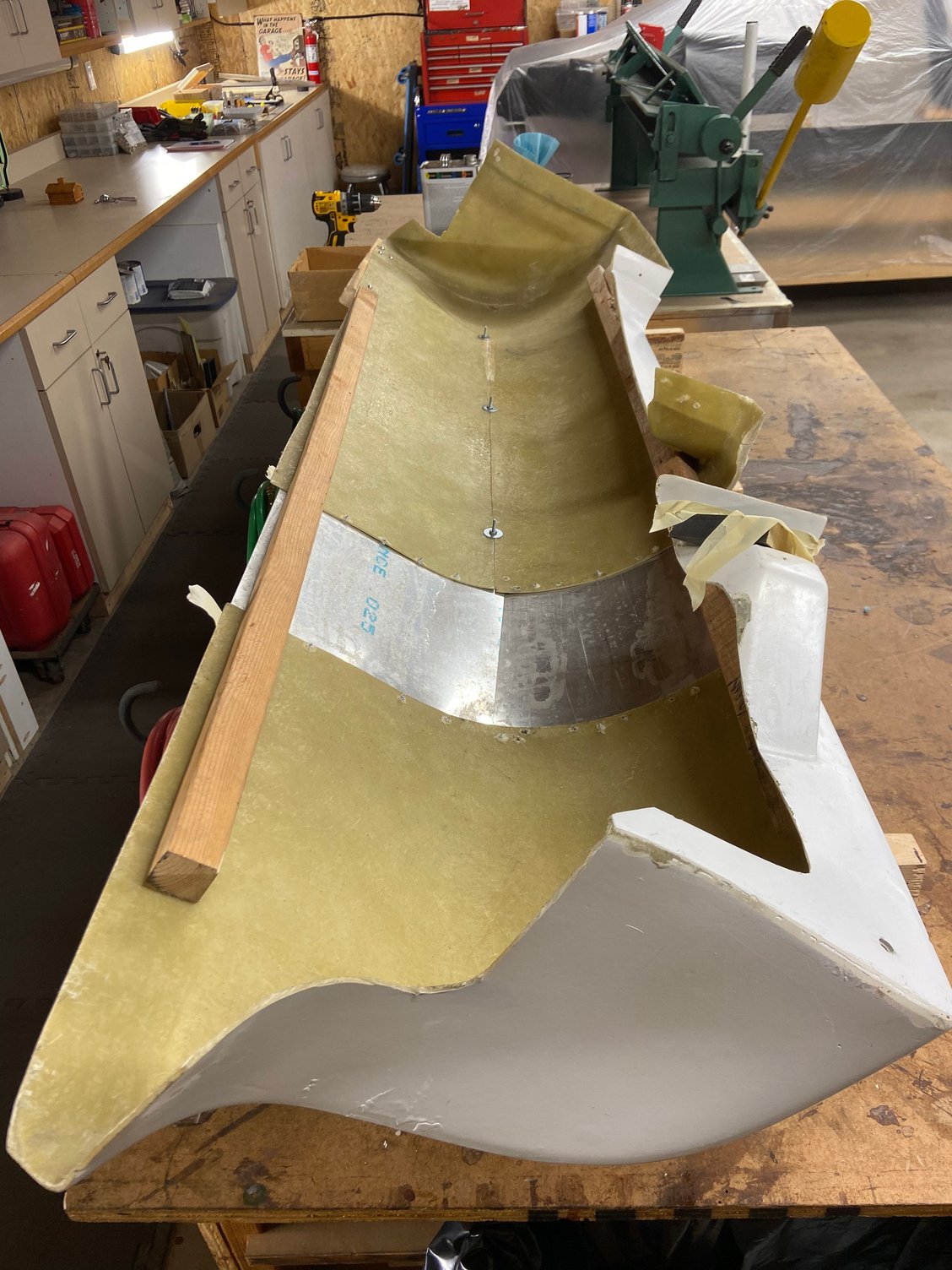

Here we go…
Laying down good.
Left & Right lowers & mid’s 4-layers,
Laid down smooth. I’ll finish crown tomorrow hopefully.
