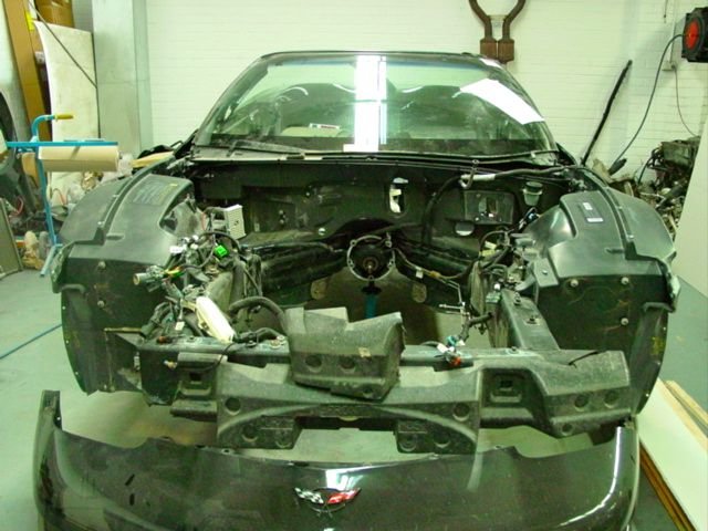

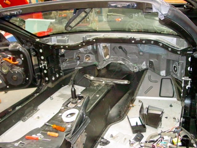

Okay a few more pics, and yes conversion was completed many years ago, I'm just showing what we have to go through here in Australia
A bit of gutting the car out
Sad day
Don't try this at home

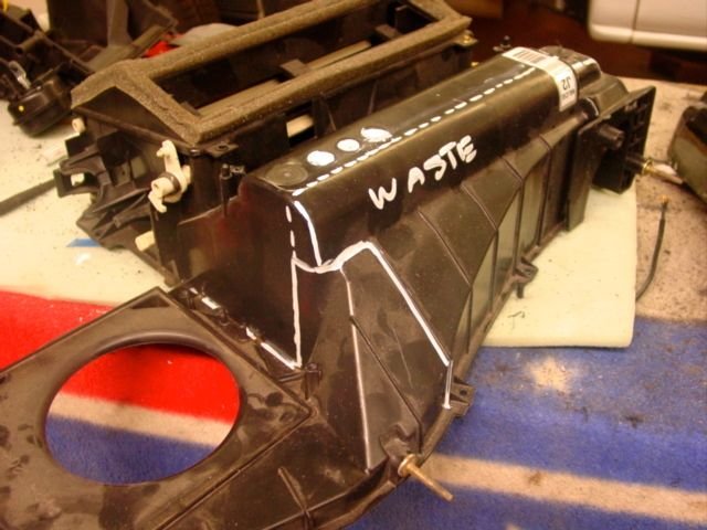

Even the heater box has to be reversed to operate as original
Imagine this mirror reversed
New Dash and door trims
Hand made dash support bar and HUD support in cast Aluminium
Booster is now on right side
Cast brackets for AC compressor

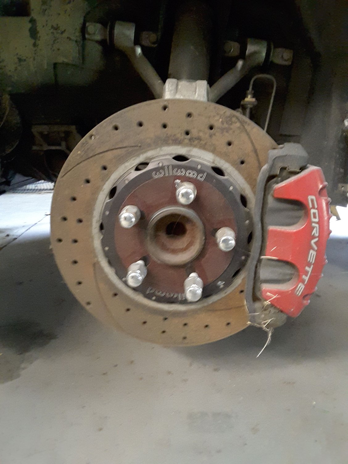

Wilwood brake rotors fitted front & rear, don't take note of surface rust, these have been in use for years and are about to be changed out.

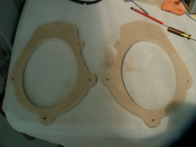

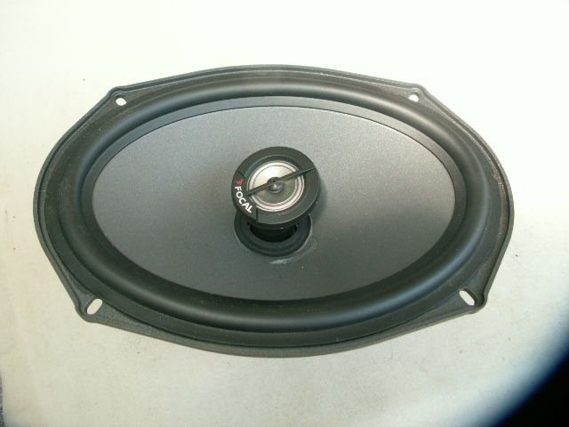

Okay never liked the Radio and speakers so I completely removed the bose setup, rewired the whole thing and installed 3 way focal speakers in the doors and in the Back, the doors I had to make custom mounts out of MDF, yes I had to trim a bit of the door to make them fit.
Before you go into shock this and all C5 vettes in Oz have been converted to RHD so there not original so we can do anything we like it doesn't change their value, a bone stock RHD vette here is work A$60K + because of the import, shipping and conversion cost, I paid US$30K when I brought this in 2003.
The Original
Cardboard template
Cut out in MDF
Speaker cut out
Focal 3 way speaker
Paint up
You can see with surround fitted what needs triming, not much.
Speaker fitted
Gutted centre console
Pioneer double din fitted, the sound is so much better

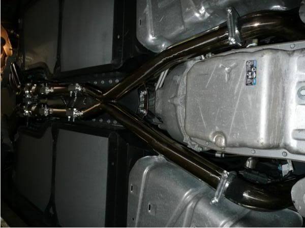

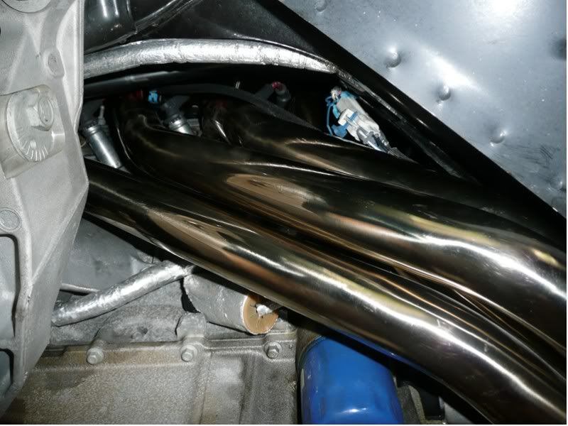

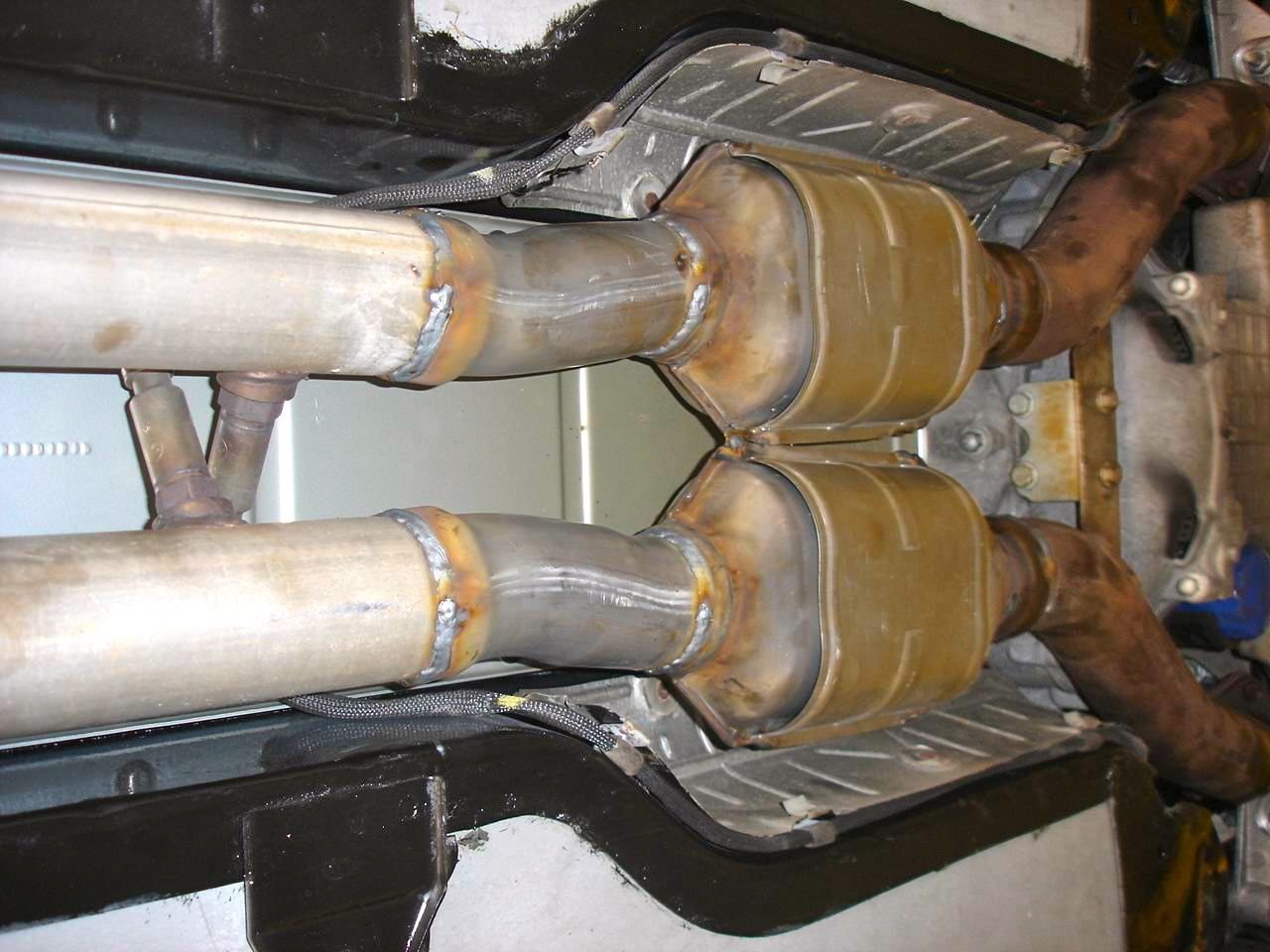

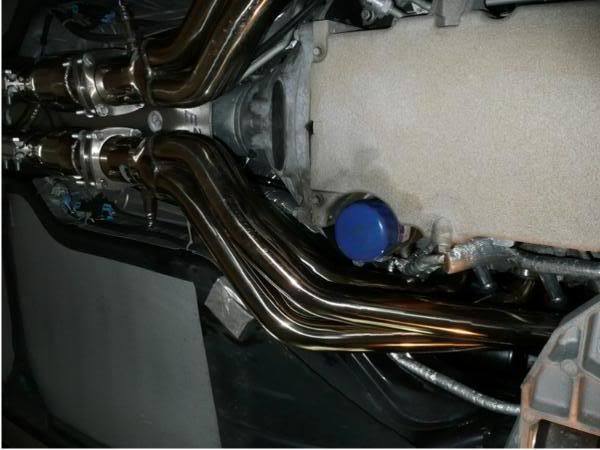

Billie Boat exhaust fitted, it was so load I put up with it for a couple of years then changed it out, I went with OBX Headers and mid pipes with cross over, mufflers are GHL and tips, yes its darn loud but doesn't drone as the Billies did. A lot of guys here will only use made in the USA this set up fitted perfectly and was 1/3 the cost. I intend to cut the Billie tips at the mufflers off and fit them up as they look better.
Front cats now gone
OBX stainless
Cleared perfect
02's
02's clear well
no issues
very neat
neat
Crossovers are not OBX

You even flipped the HVAC control *****.
Lots of work, but you did an excellent job.

looks like only the labels, since the right side is only a "hotter/colder" adjustment compared to the left side.

yes its the labels that changed on the controls but its the complete heater box that was mirror reversed as is everything else
