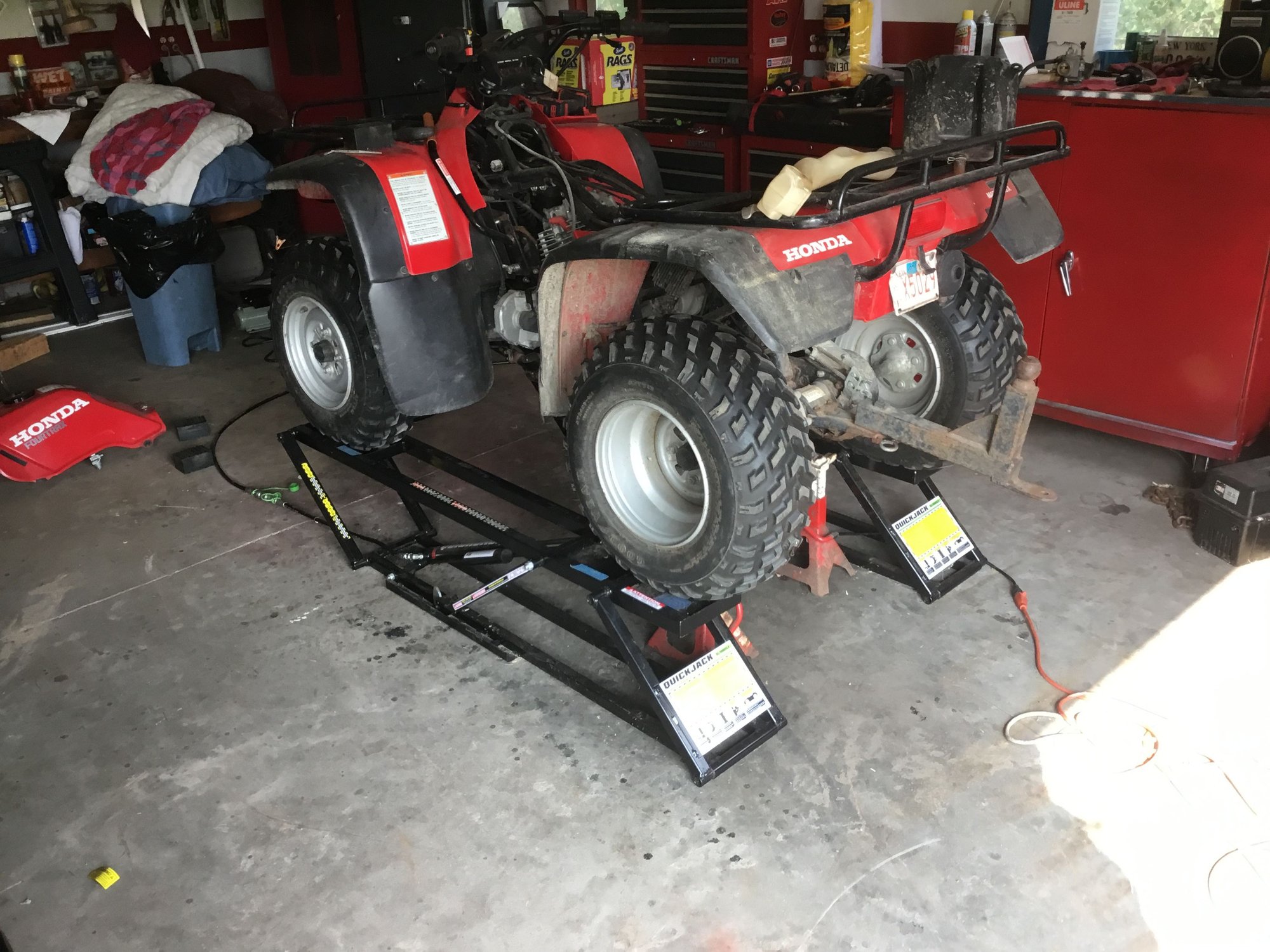

Other uses also….

Haven't got one of those yet...

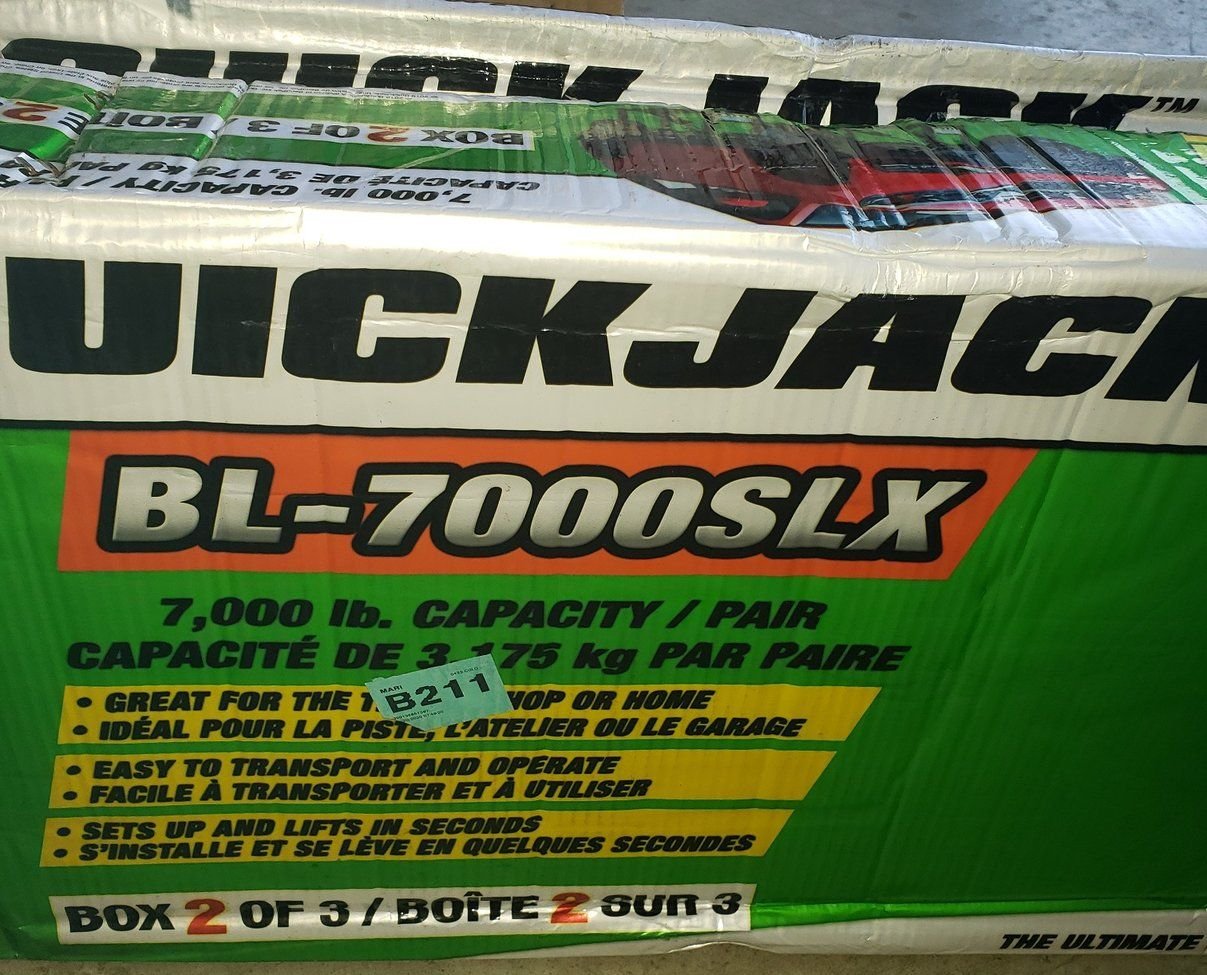

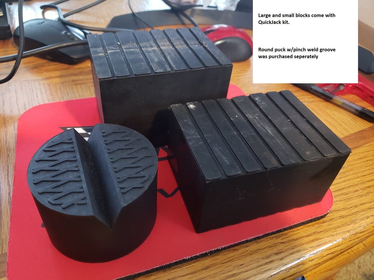

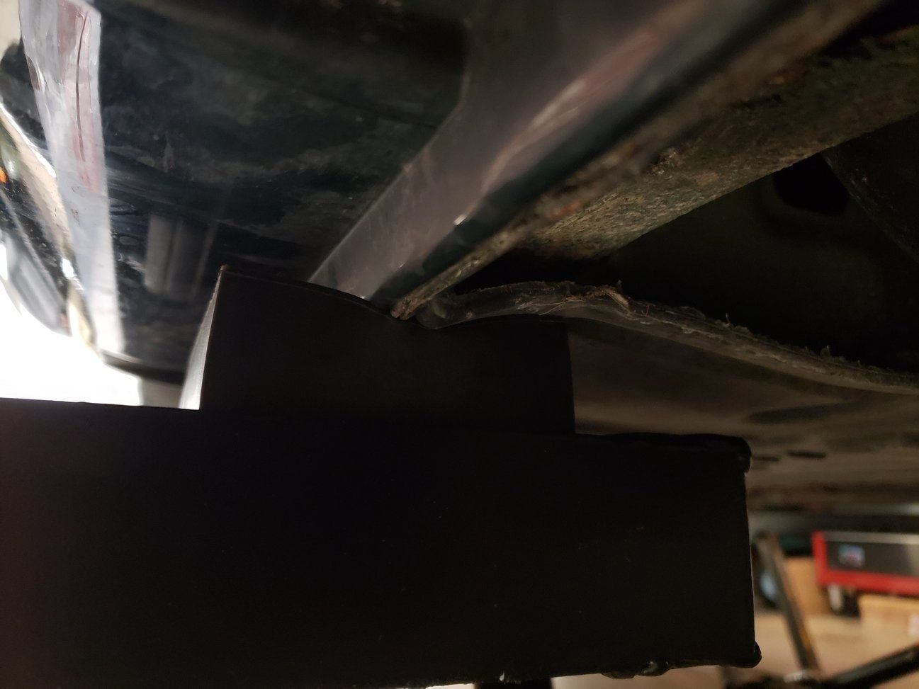

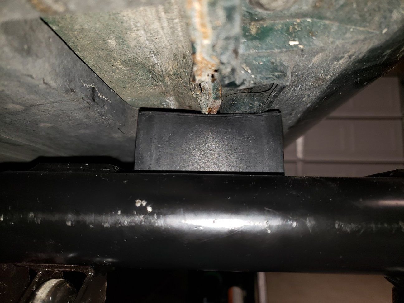

I bought a BL-7000 SLX Quickjack and used it to change the oil and do a complete brake job on my 03 Jaguar S-Type. I've only used it once on my 04 Z06. Worked about the same on the C5 except I had to physically lift the front of the car to slide it under. Not a bit deal and can be done by hand.
Having lifted five vehicles so far here are my thoughts (Acura RSX, Jeep Liberty, C5, Jag S-Type, Honda HR-V):
- It takes time to set up and position the lifts, pump, and hoses. (longer than using a normal floor jack)
- Lifting my Z06 or S-type is easy using the large blocks that come w/the kit.
- As a rule I also keep jack stands under the car in case it were to slide sideways. (only as a secondary safety)
- The S-type was sitting on the jacks for 1.5 weeks. No degradation in stability was observed (sitting on the polymer blocks)
- Sitting on the polymer blocks is NOT as firm feeling as if the car is sitting on floor jacks. The car does have a small amount of give if you push/pull.
- I feel that if I pushed as hard as I could, the car would not come off the blocks.

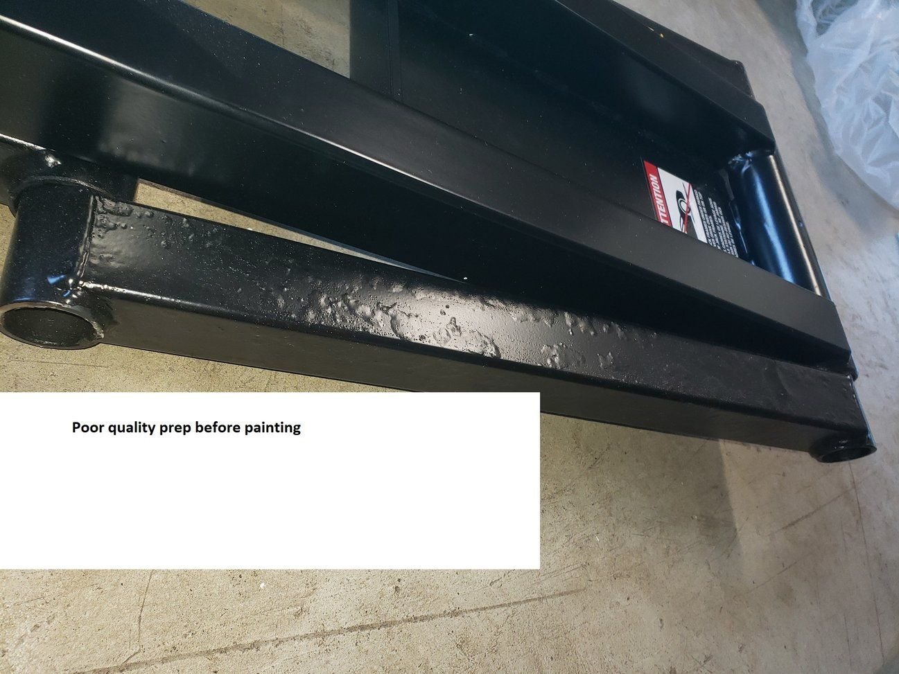

- The (metal) lifts are rated at 7000 Lbs and are way overkill for a C5. (I bought the heavy ones so I could work on any car or truck. Also... the 7000 units have a wider footprint. So I know they will offer more stability)
- I see no weakness in the metal lifts. Once locked they don't rely on hydraulics and its rock firm.
My only concerns:

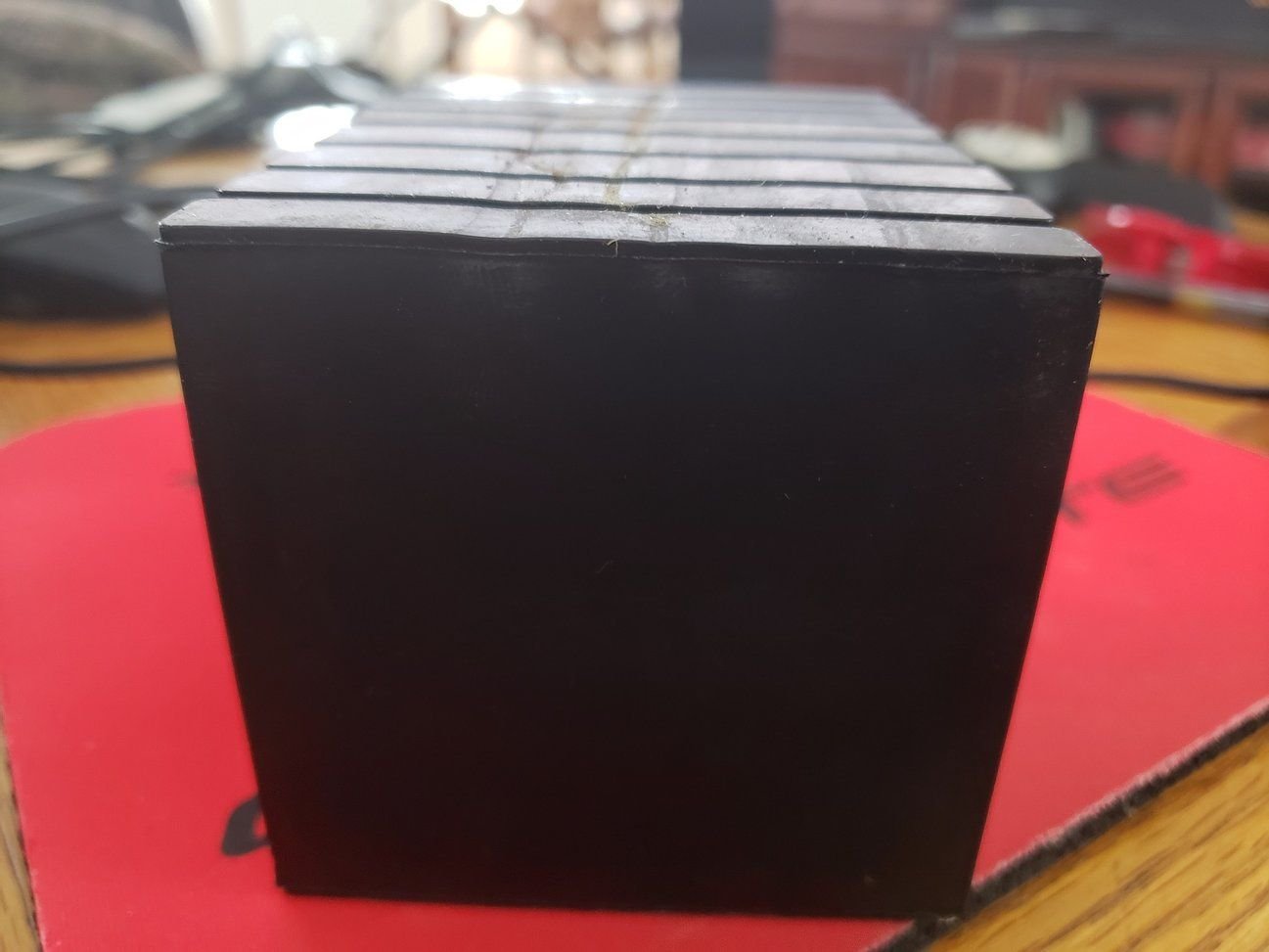

- On another car (Jeep Liberty) I had to double stack the blocks. That was not firm at all! I actually had the car slide sideways because the blocks conformed to each other and the cars front blocks allowed about a 75mm (3") shift! The car was stopped by the jacks frame so no harm no foul. But.... double stacking blocks is a no-no IMO.
- On another car (Honda HR-V) I had a bit of trouble getting them properly aligned in parallel. Now I use a tape measure to insure they are aligned to each other instead of using the side of the car to judge by.

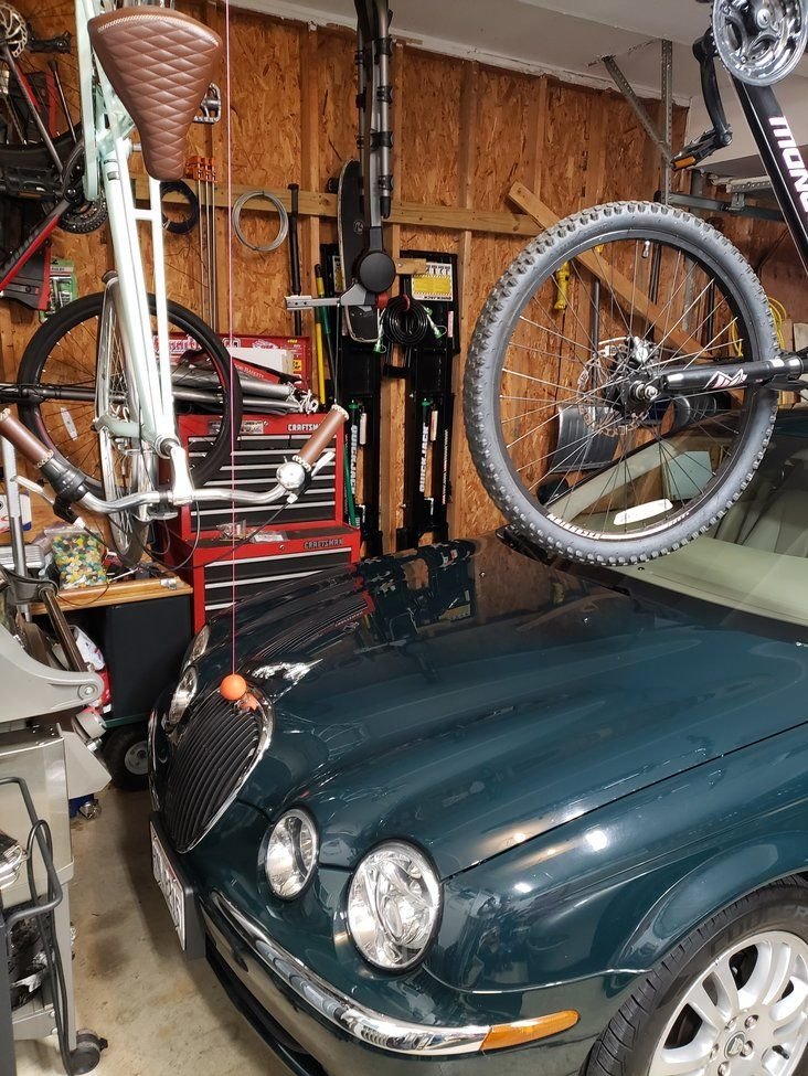

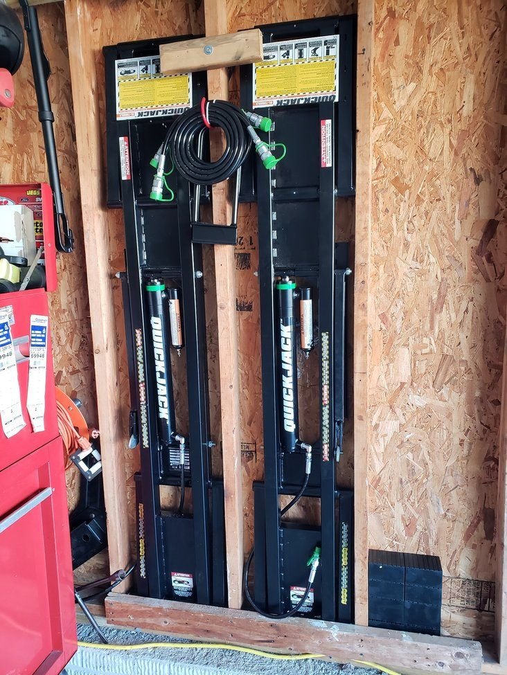

Here are some pics of what its like to lift an S-Type and how I stow them in my suburbia 2 car garage.

Yeah the 19.5" would apply to any car as measured from the ground to the touch points. **Be very cautious if double stacking the blocks**. TWICE I've had the blocks slide off and the car move sideways. I highly recommend folks DON'T do that. (and yes I was very careful to have the racks aligned so as to not introduce a preload)
Since buying the QJ I've purchased an additional set of blocks. And when possible I put two blocks in the trays. That has made the Jag far more stable as the pinch welds sits on them. The C5 though has the lift pucks so its the same. But the addition blocks give added security should the car shift.

Regarding the blocks, the ones that came with my 7000SLX (purchased in July of this year), lock into each other like big Lego pieces, so they will not slide off when double stacked.

1st hand experience here... if the car is heavy enough and you use the weld seams... they deform so much that they DON'T lock. I suspect thats why they offer the ones w/grooves for weld seams. So that the block doesn't deform and stays square enough to bite into the one below it.
For the three cars I lift the most 1 block works well.
