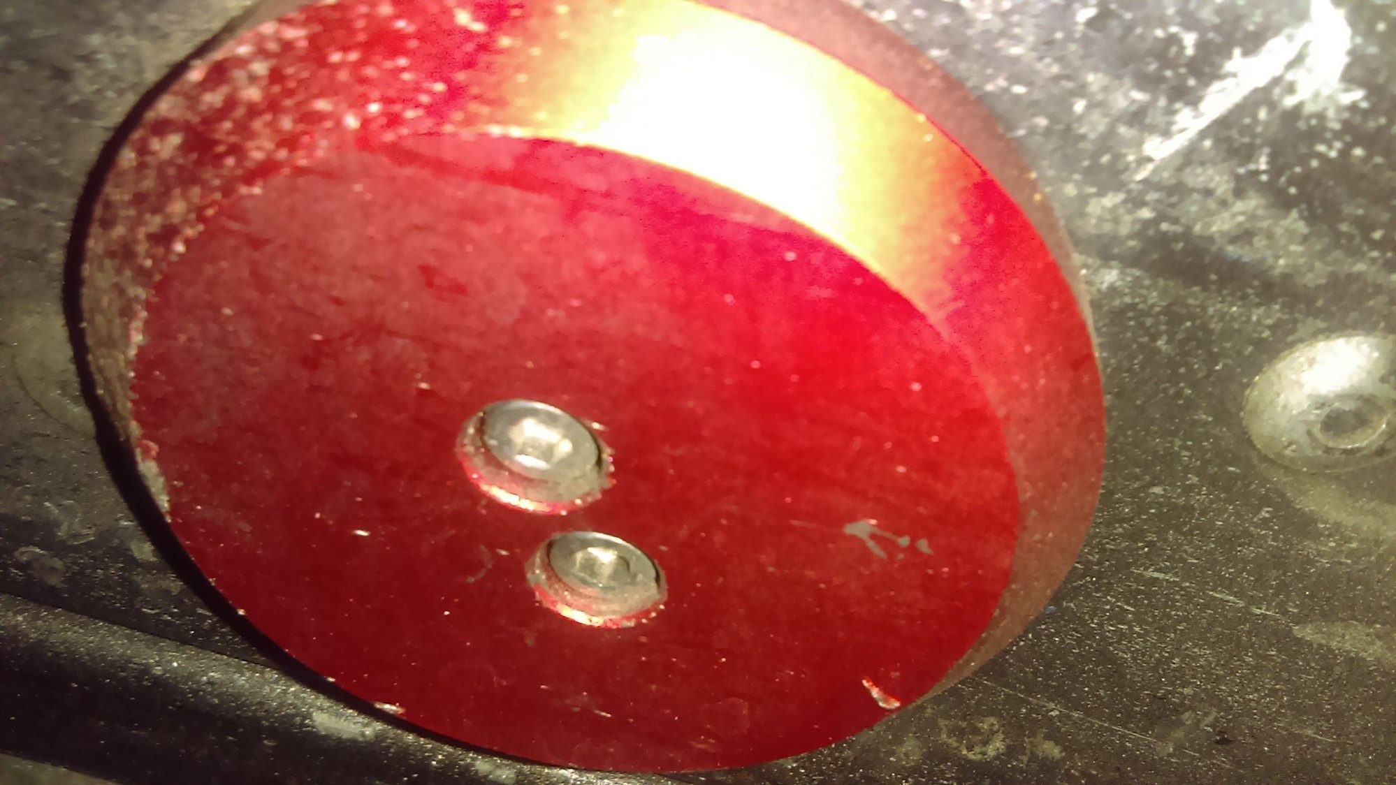

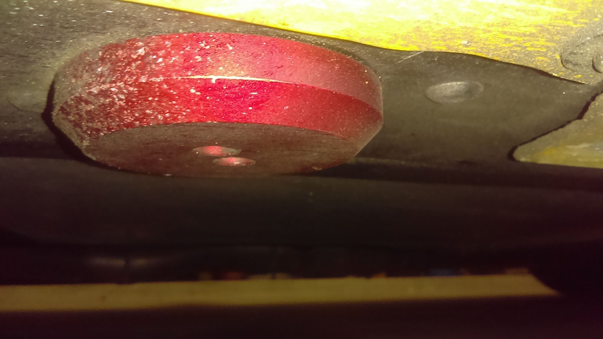

I bought mine from ZL1 Addons. Aluminum, screw on type. A dab of Blue Loctite on the screws. My car is a track toy so it's up on jacks often and these work GREAT. $70 for a set 'o four. Well worth it.
To jacking pucks
Really nice so you insert the rectangular piece with it loosely together turn it half way and tighten it up? Im looking for pucks you keep on the car. Let me get a picture of my jacking areas or where you would insert the pucks. They aren't perfectly straight from jacking or jack stands i believe.
