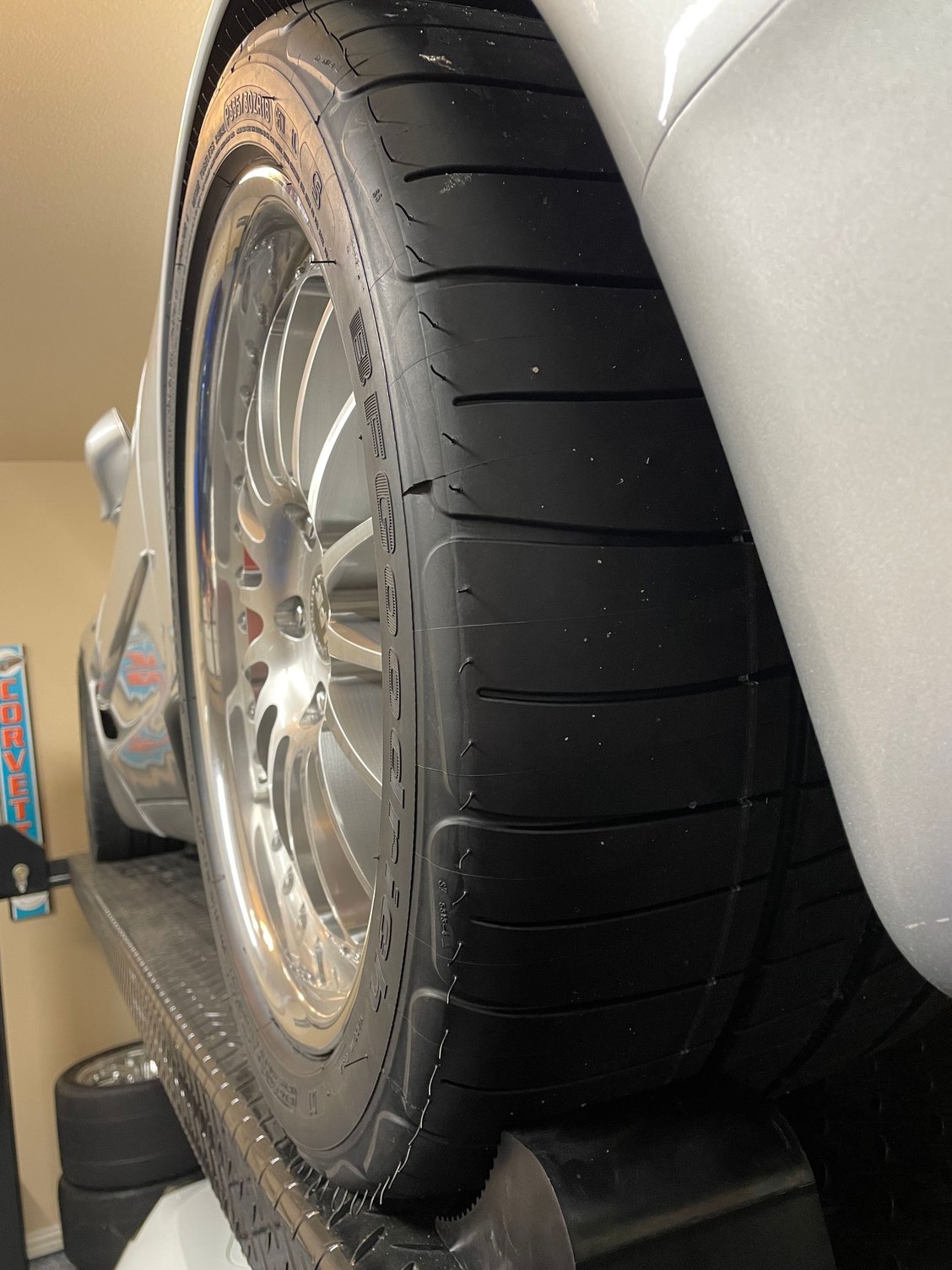

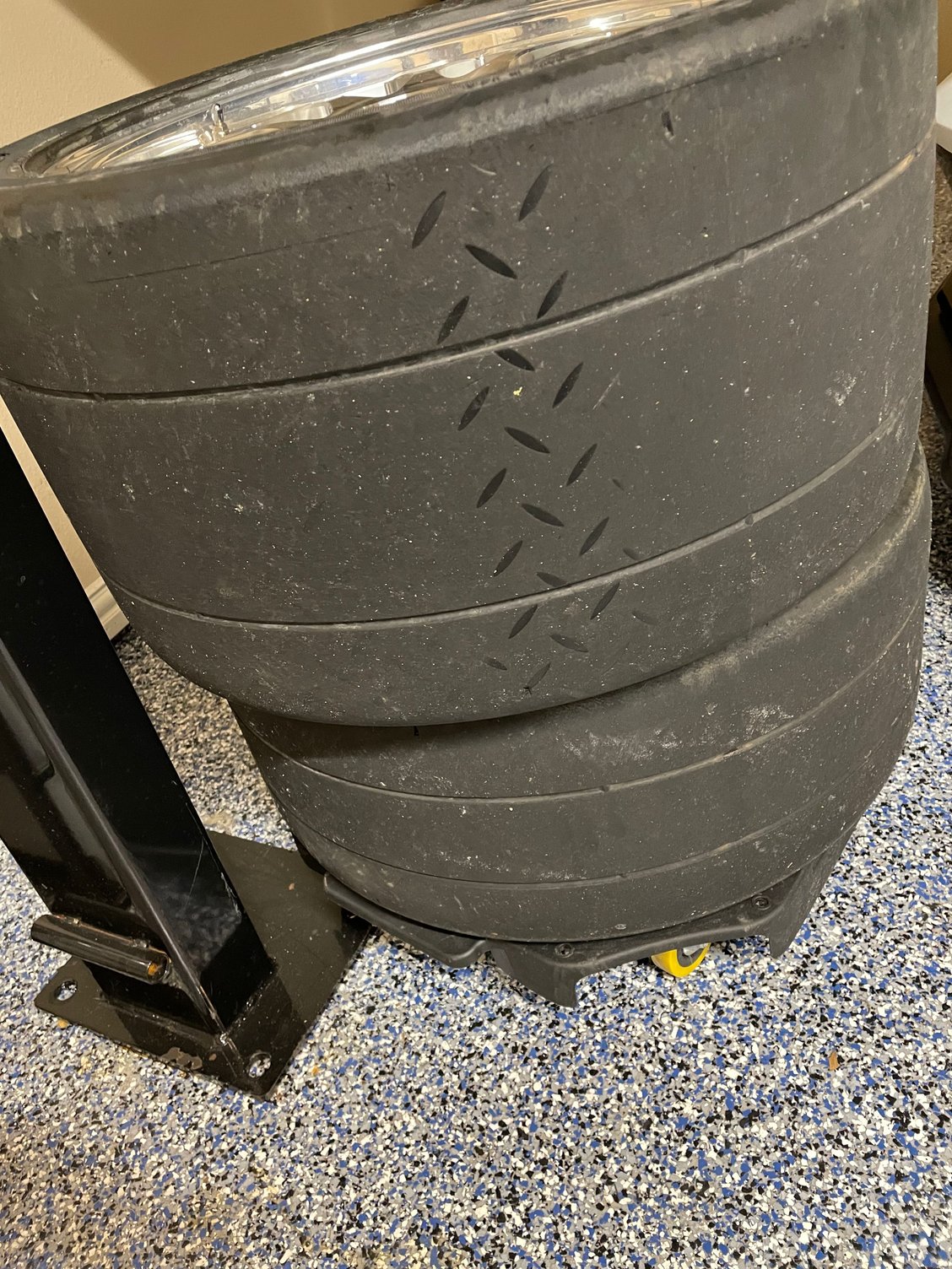

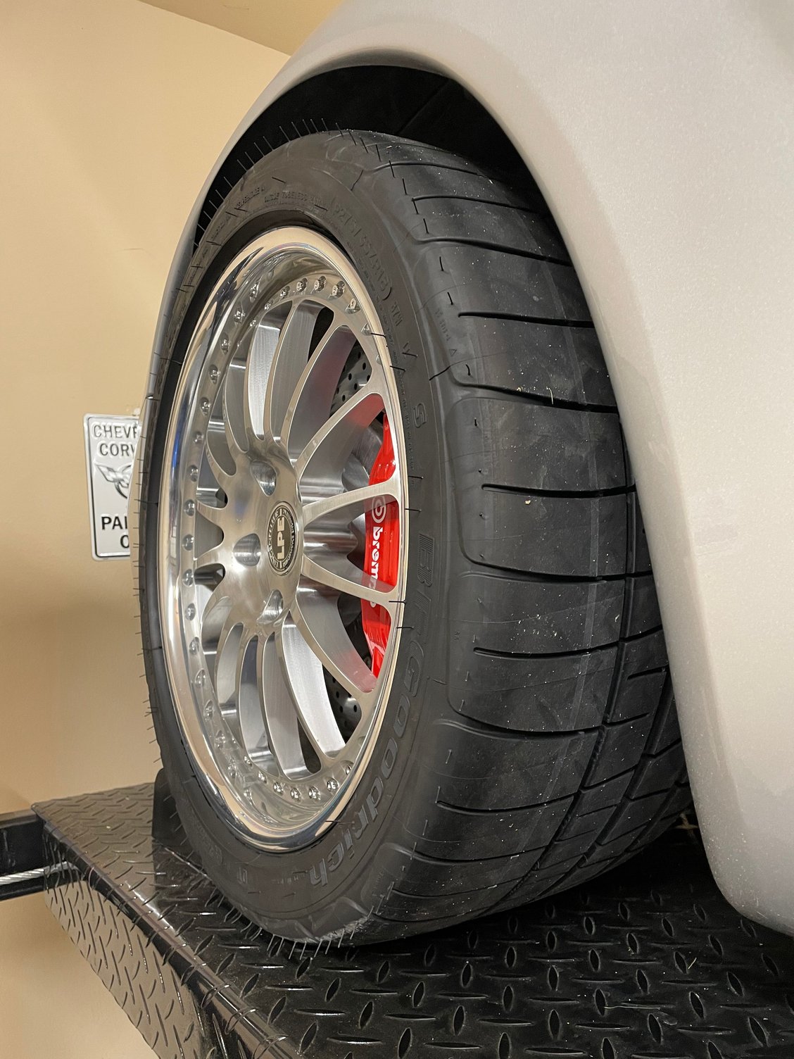

Default BFGs installed
Finally got the BFGs installed. They are about 1” taller than the Michelins and Hoosiers. I drove it briefly to check clearances. I had my Hoosiers on for about 1 week look at the picture and you can see the grid from the lift deck imprinted on the tire.
