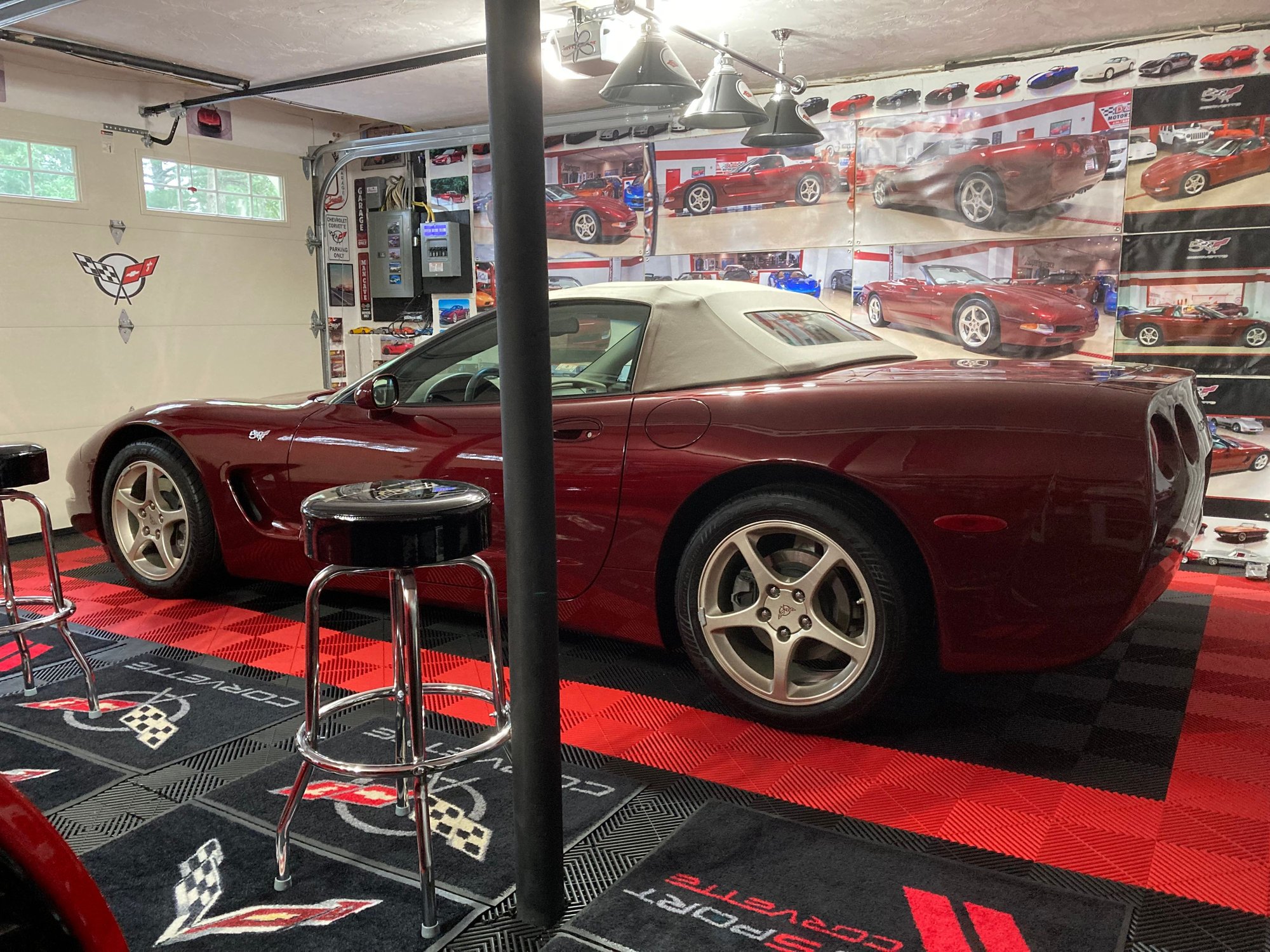

....your car away for the winter, what did you do to it? I truly enjoy taking days to put it away over Thanksgiving.
So far,
Clay bar, polish, wax, clean and polish wheels, clean and condition all black trim, vacuum, dress wheels, condition leather and vinyl interior, cleaned interior engine compartment and trunk, clean windows (inside & out) and acrylic roof. Tomorrow going chrome polish tail pipes, clean carpets and.......(need more ideas)
Thanks........

To all the others, thank you, Yes, fuel stabilizer put in on last 3/4 fill up Wednesday after oil change. Bought brand new Bounce dryer sheets, yesterday. Still have the irish spring I'll break up and also bought from Tractor supplier rodent repellent. Just finished baking the water out of the CC moisture absorbing pouches, I put in three in the car. I plug the exhaust pipes with socks. And the car sits on horse stall rubber mats to keep out the moisture. Yes, its a garage queen.
And during the winter I lift the hood of my DD after driving home from work to artificially heat the garage. I must have missed something????
PS Of course the battery tender was already on!
