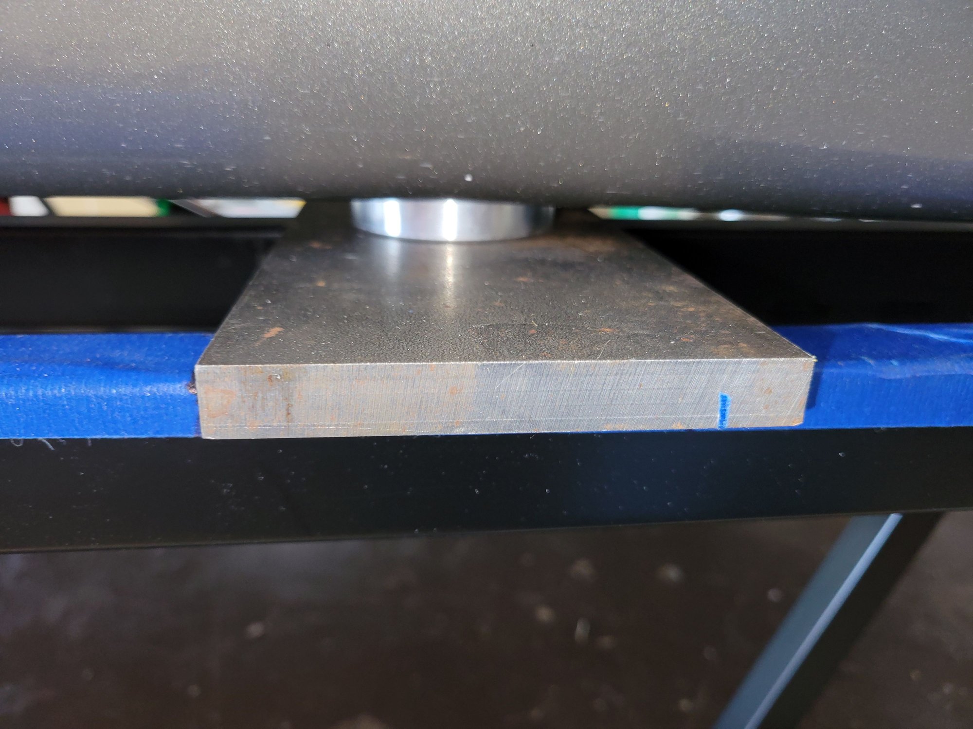

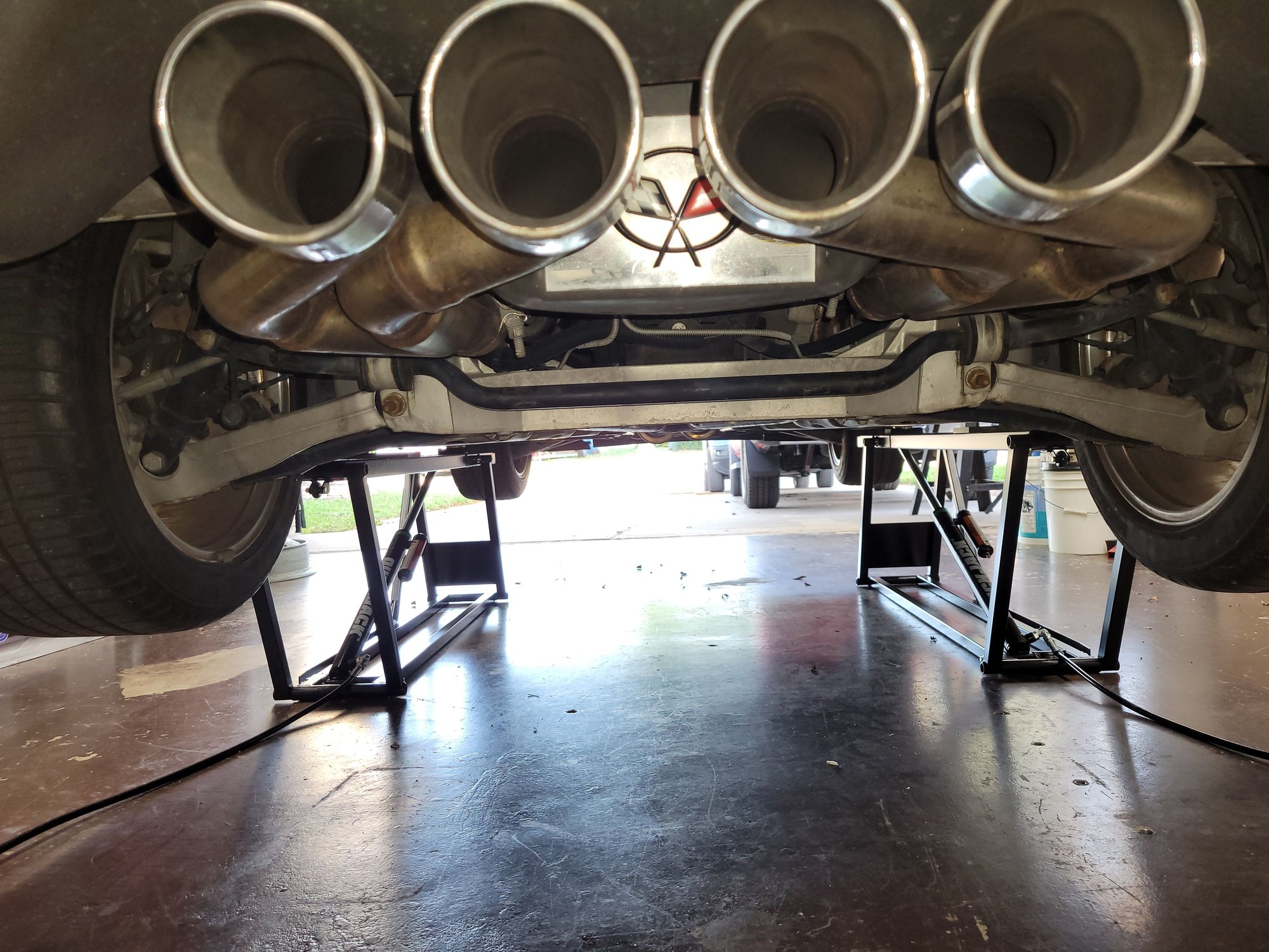

This is what I came up with to span the distance. 1/4" Steel Plate. Later I'll weld some 1/4 stock to the inside of the plate for guides and Power Coat the next time I drag the PC equipment out.
Rock solid on the QJ lift. 21" +/- front vs Rear.

Did you weld the steel plates to the QJ? Or are they free floating and the additional stock you intend to add will help keep the plate centered?
No not welded to the QJ. The stock is just to keep the plate centered. I want to be able to use the QJ on my other vehicles. No reason to make a permeant modification to the jack. The stock to keep the plate center is not really necessary as the weight of the vehicle will keep everything firmly together, I just have the stock and won't take anytime at all. Actually the welding of the stock is more to keep the plate on the QJ as I move it around on the floor. The QJ stores nicely underneath the C5 with several inches to spare so have not intentions to hang it on a wall or anything like that. I back into my garage to the QJ does not even have to move and no clearance issues. It will store centered underneath the vehicle, with both units together.

I had the same idea. For now, I have the car lifted with the QJ racks perpendicular to the car. Not ideal, but perfectly safe according to QJ.
