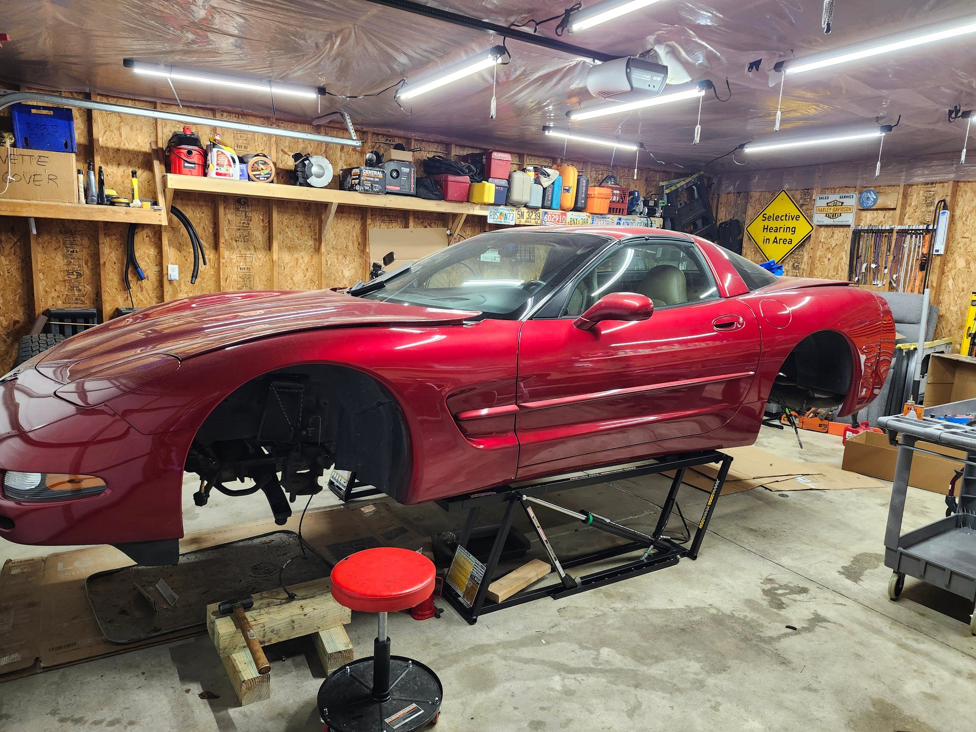

I modified some rubber blocks to lift my C5 with the 5000TL lifts. Very secure at max lift.

Any pictures of your modified blocks?

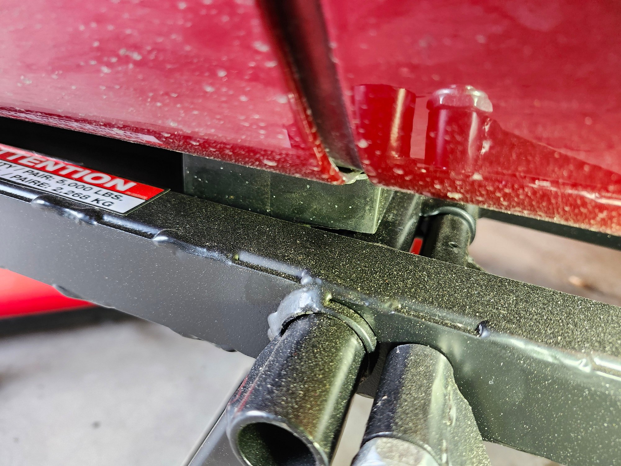

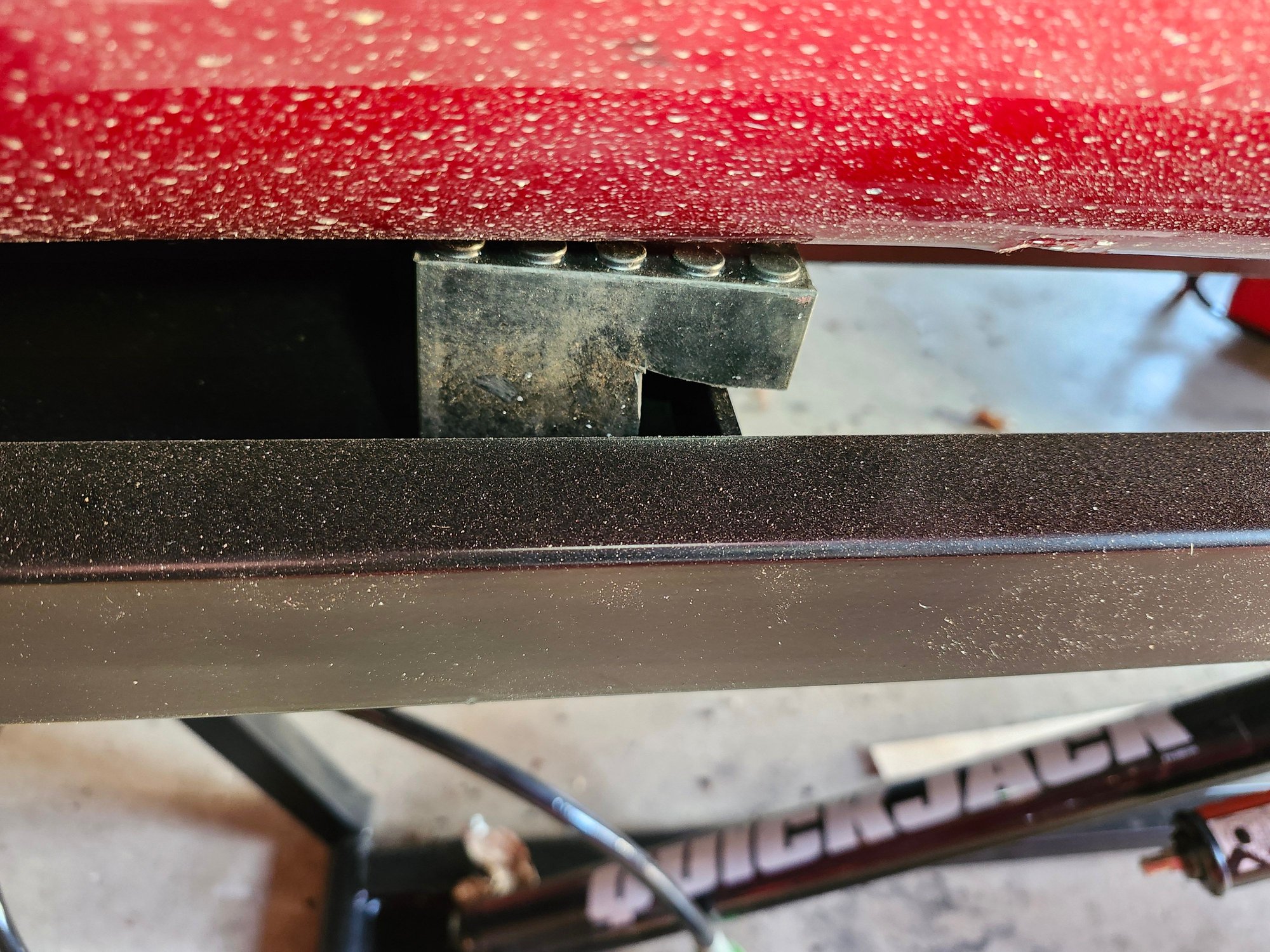

What I did was cut a square out of one side to fit over the bar that separates the tray blocks would fit in and the frame.
