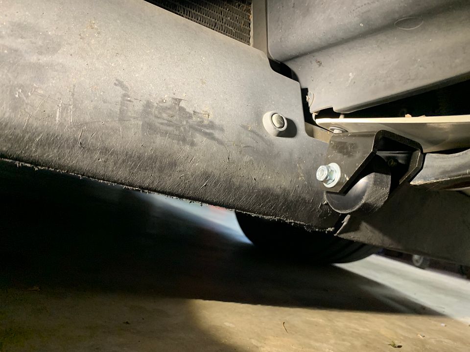

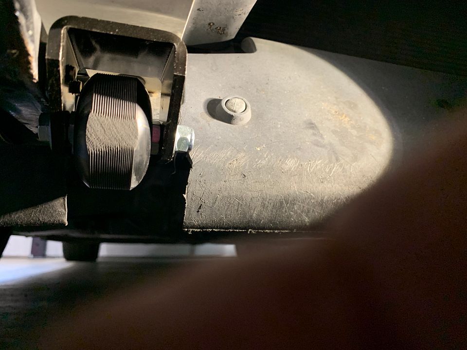

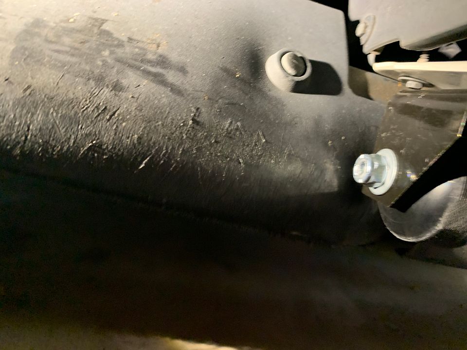

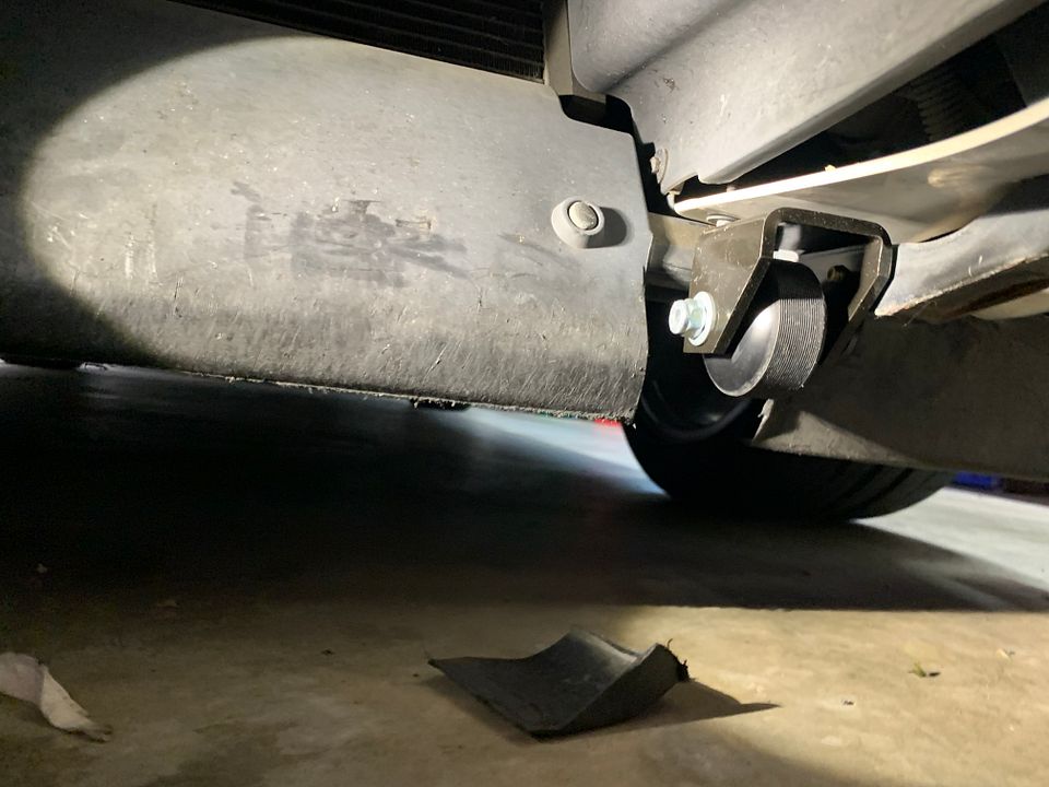

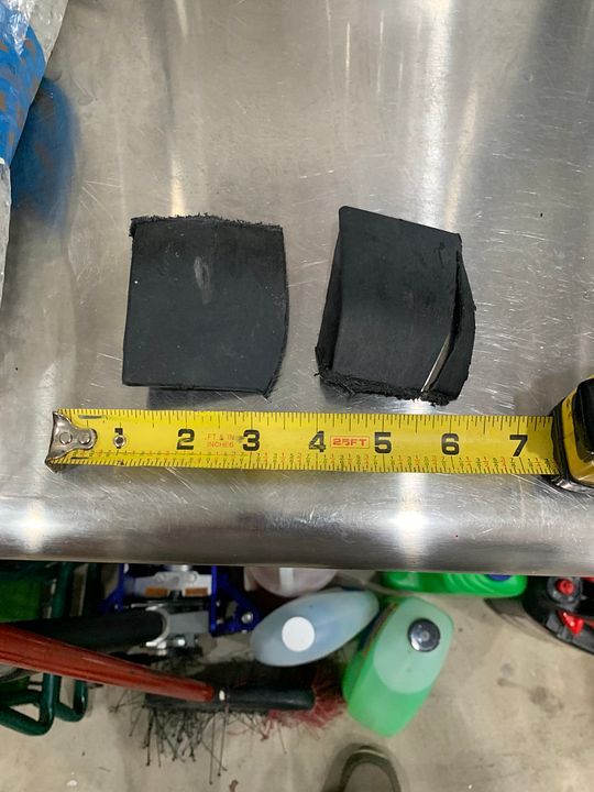

here we go, when its not 95* outside i will report back on if it fixed it.
hard to see but here is the front damn pulled forward binding on the wheel which stops it from rolling
heres the entire area
heres the soloution, look closely you can see the drag mark on the wheels

The car goes in and out of driveway very easily now, with no sign of wheels getting hung up instead of rolling, seems to be working .
