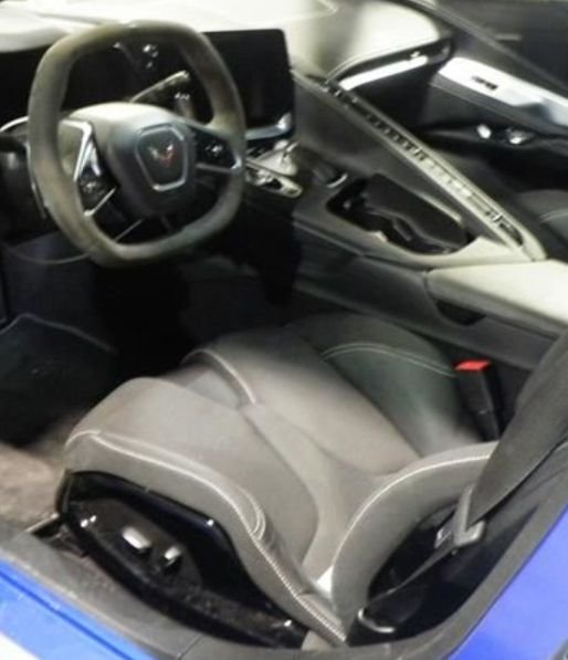

Well everyone. It's happening. I pulled the trigger. They were pricey for me at $2,600 and I have no money left for the seatbelts, but the seats are purchased and the first set of C8 seats are going into a C5. I'll include the only photo I have. Interior of the car is immaculate. The car had 4,000 miles. These seats are going to be practically new.

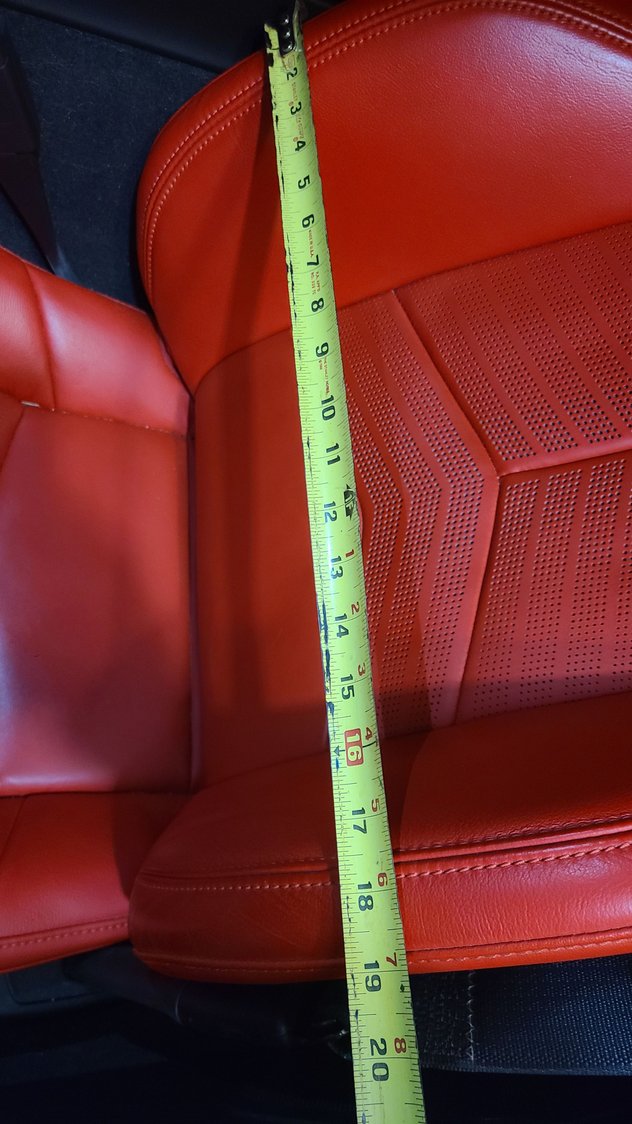

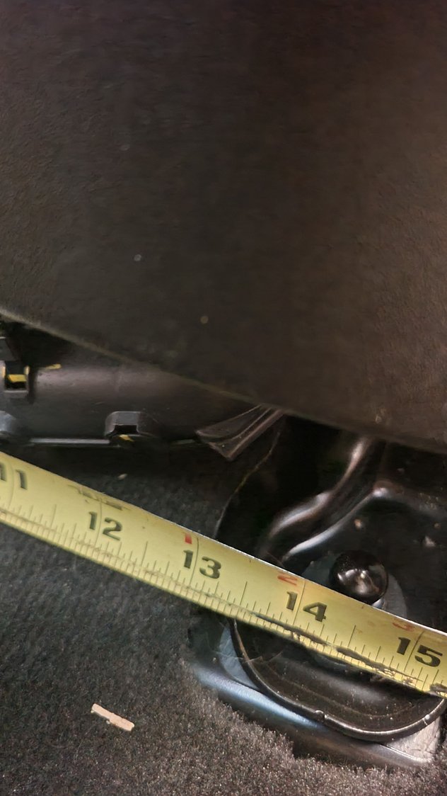

My C5 is buried right now(as I live in the Arctic) and I have stuff I have to move to get the measurements. Hopefully these help from the C8 end.
