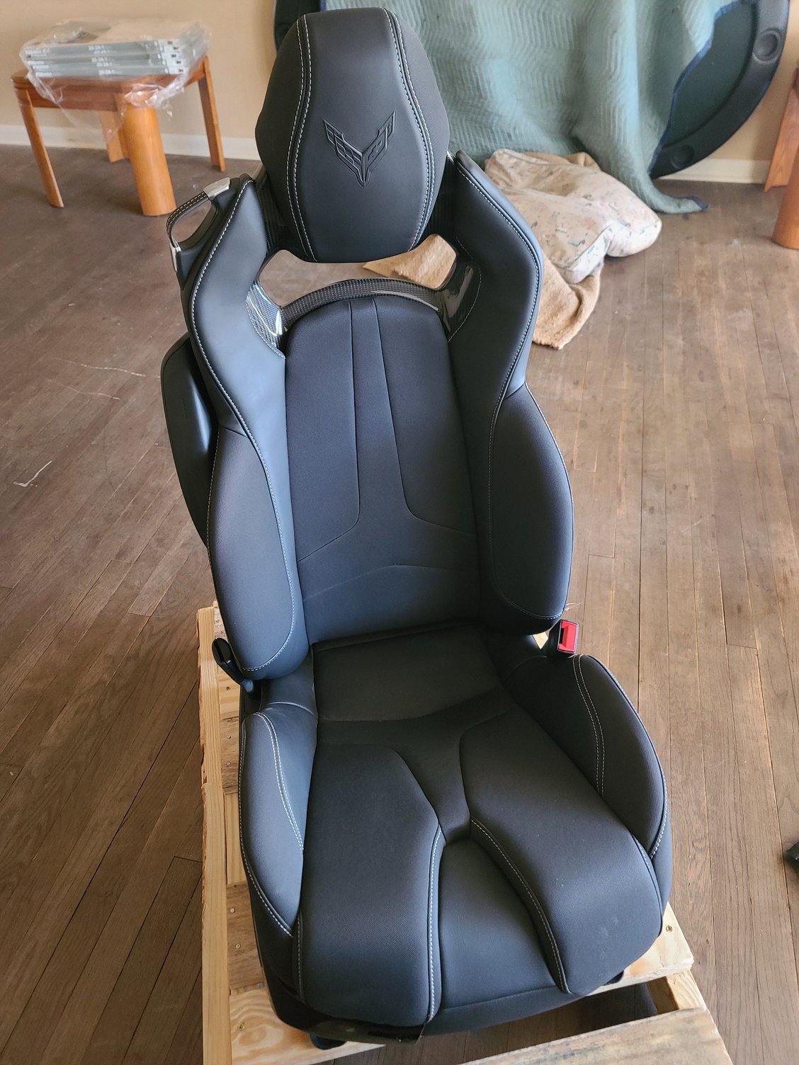

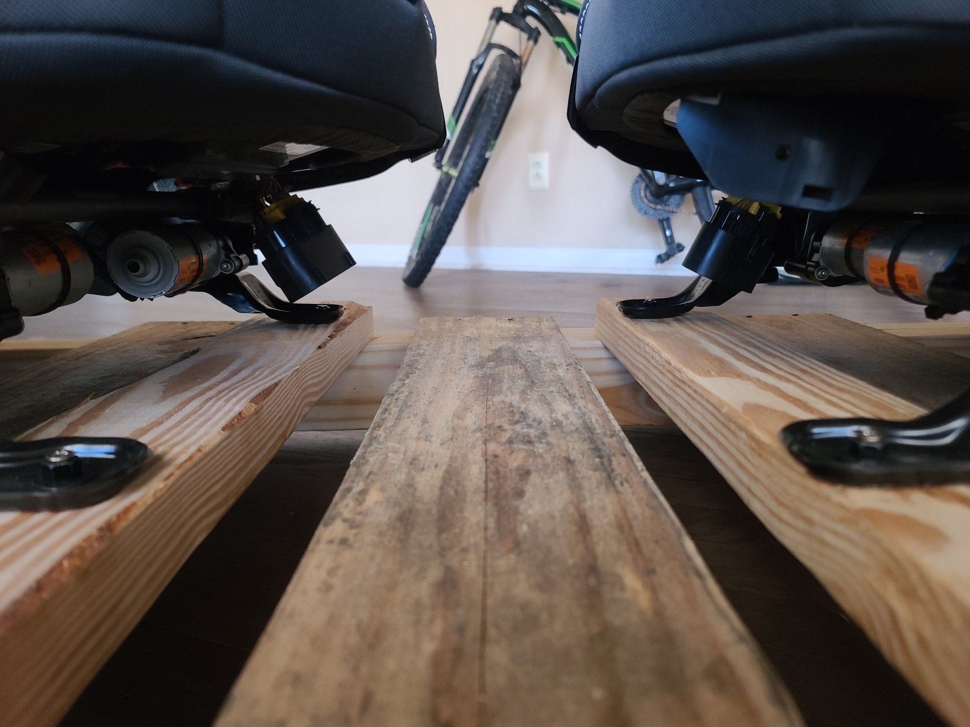

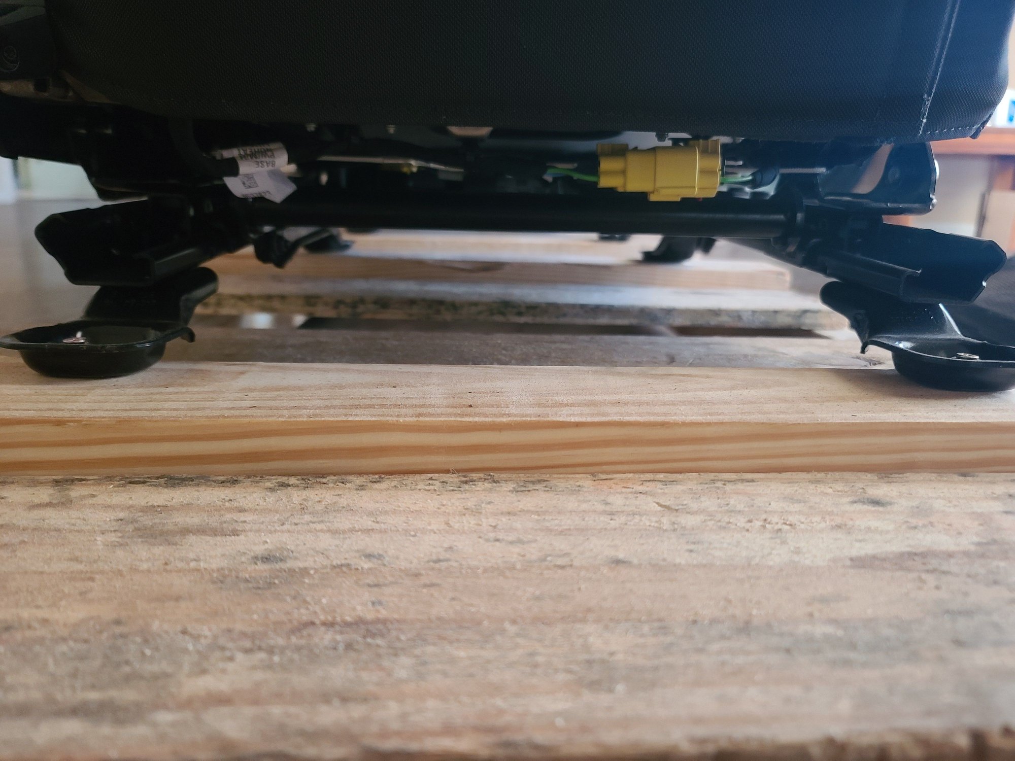

The seats just arrived and man these things are comfortable. I'll upload some photos of the seats themselves and the wiring underneath and the rails.

C5z is back in my hands! Right now I will likely test fit the passenger seat first. I may need to get help with the wiring on this one. I'll be getting a quote to see if their installation is cost prohibitive. One reason is I need them wired without damaging the seats if I want to resell them. But I will certainly test fit them first!

The c7 seats only use 3 wires for basic power so these should be similar. Telescopic steering function should come later with Gary's help.

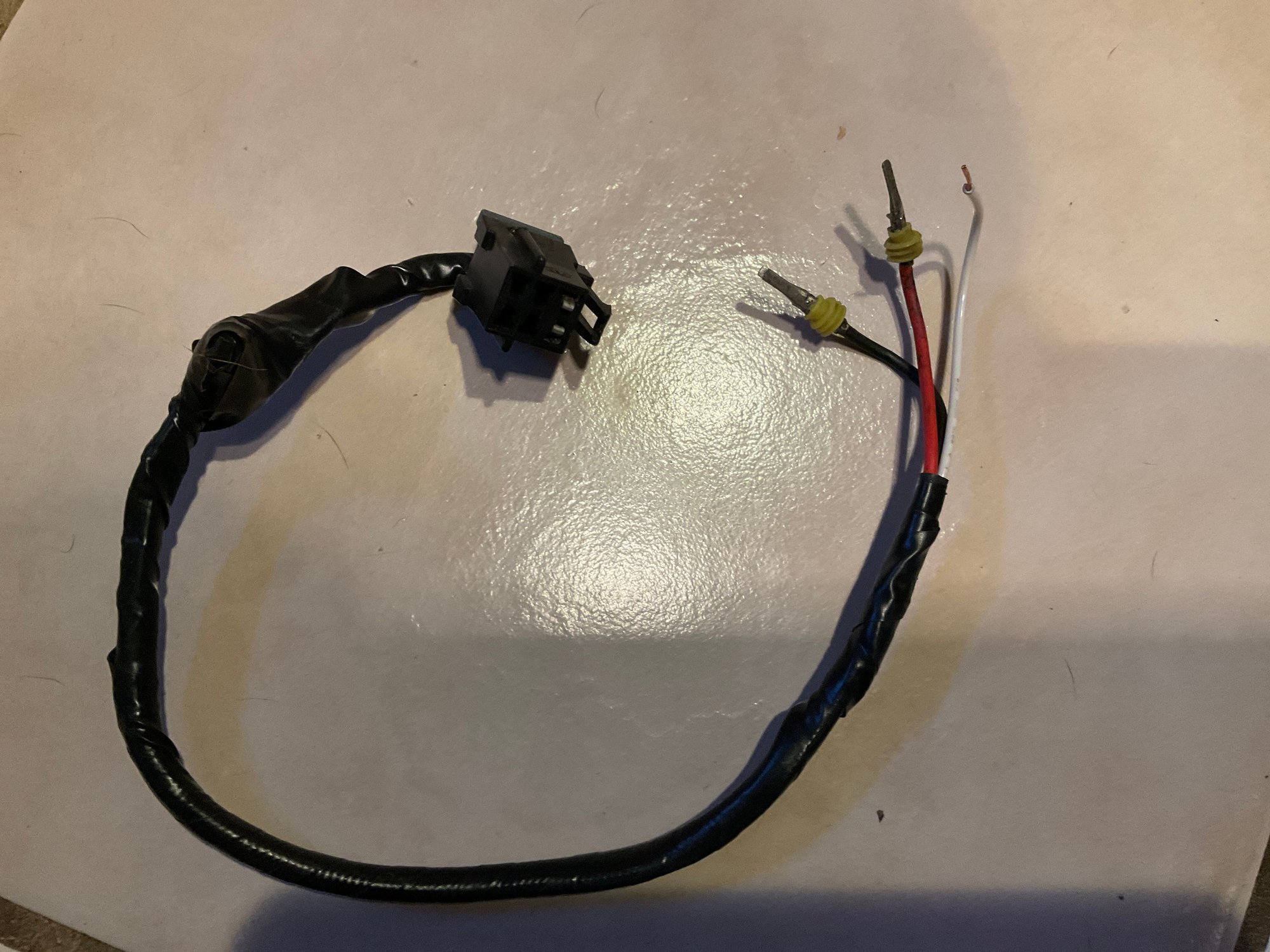

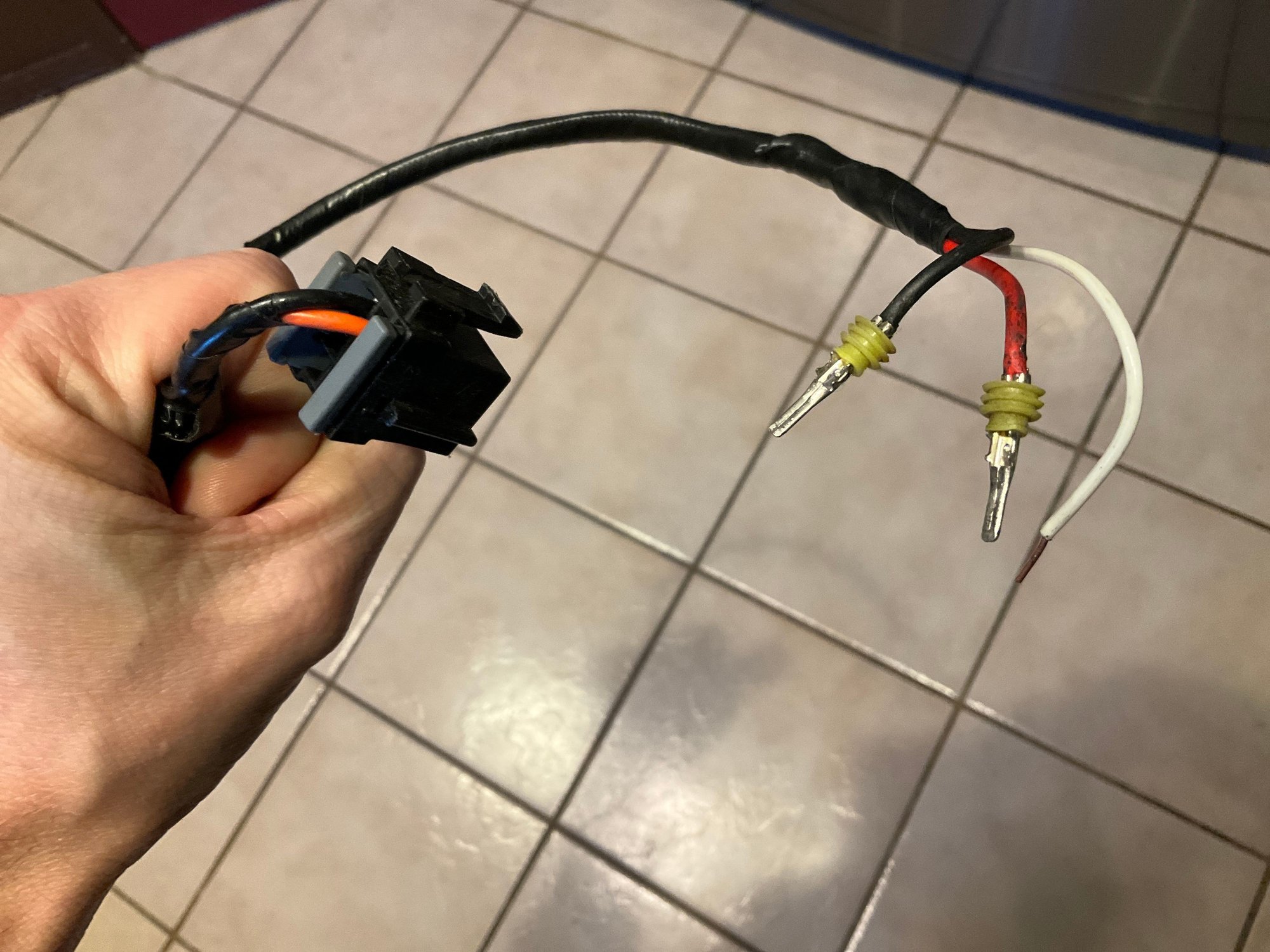

This is how the c5-c7 harness that I made looks:
C5 side:
2 wires into 3 wires. The white wire is spliced into the red so both are power.
C7 side: 3wires
Take a pic of the female c8 seat harness under the seat and post it here plz

Next time in home I'll snap a photo of the connector for you. I only need the power seats to work and then hopefully heated seats. I don't think these seats cool and I do not have telescopic steering. Thanks for the info on wiring. That will be my biggest challenge.
