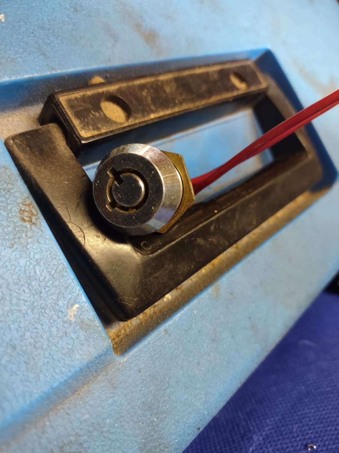

Three systems you can interrupt. Starter, ignition or fuel. A trip to the hardware store for a switch, some 14 or 16 GA wire and an afternoon of tinkering and you're on your way to successful theft deterrent. I made one for one of my vehicles and it worked as advertised. I wound up with a cut steering wheel (The Club removal method) broken ignition lock and a dented drivers door but the vehicle remained on my driveway! Still own it today.
