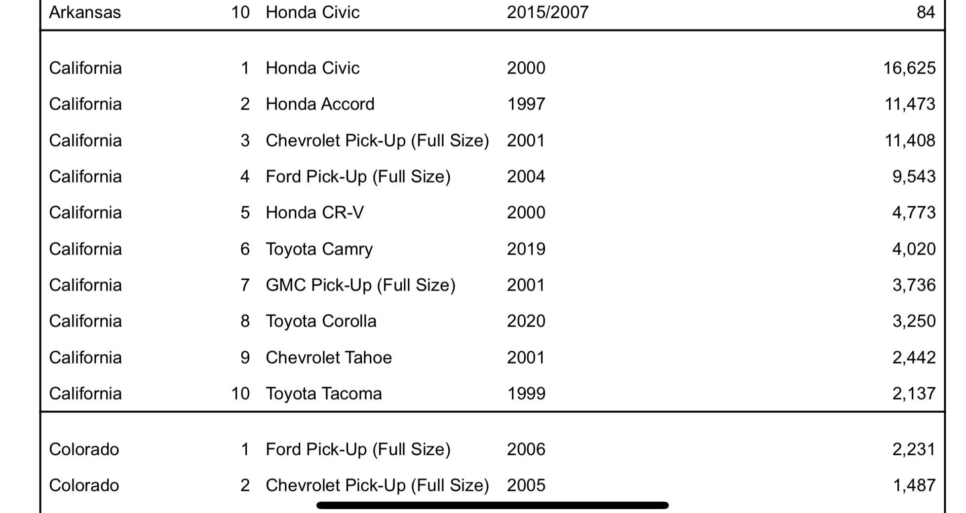

Originally Posted by snaitaz@aol.com
I would have to defer to this article in our own forum...https://www.corvetteforum.com/articl...ettes-by-year/
California has the most stolen vehicles simply we are a populous state and one of the favorite stolen vehicles aside of what you mentioned is our Vette.
Cheers!!!
Don’t see any Corvettes in the top 10 !!
Good Day Rob,
Not disagreeing with your stats but the stats I was refering to do show that from 1981 to 2011, 14002 Corvettes were stolen in Cali making it #2 on your list.
Eric...on that tracker unit I was mentioning, it has real tracking which you can track yourself on the web or your cell. Many of them also have notifications sent to your email, cell or whatever. Cost's me $25 a month and for me that's good insurance. Cheers!!!
No problem but you can’t compare a 30 year period (1981 to 2011) to a YEARLY number on my list…that’s all !!!

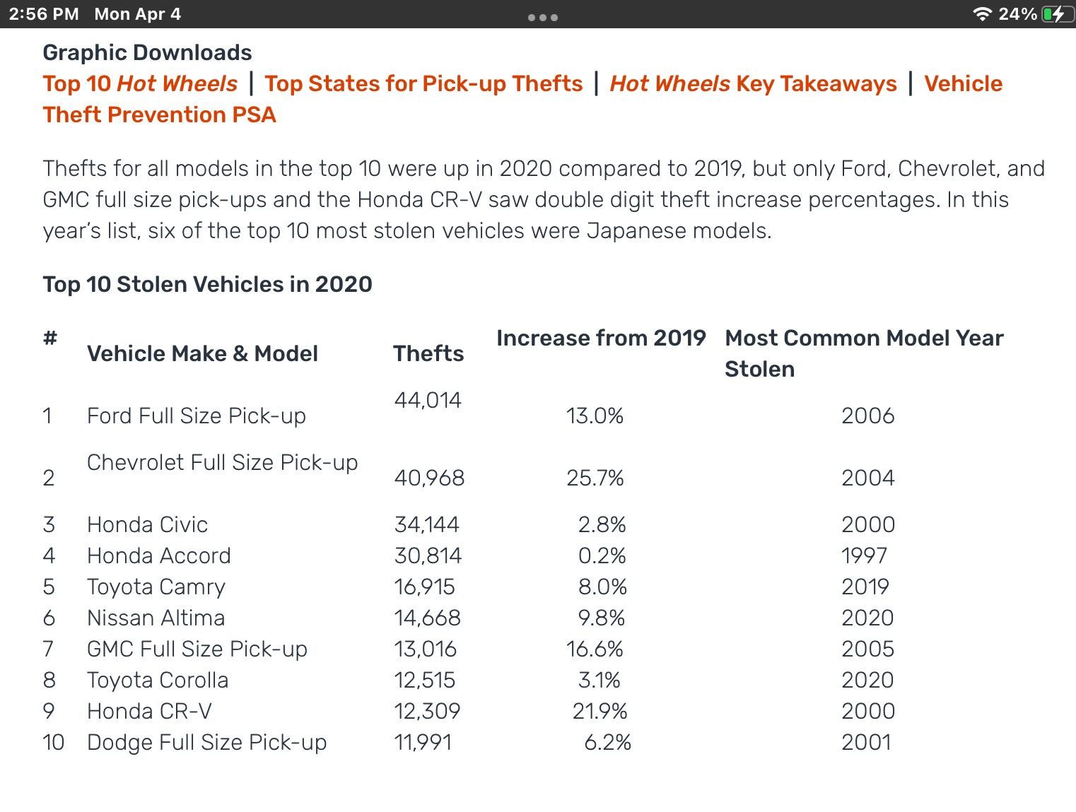

Good Day Rob,
More recent data. 2020 Thefts.
