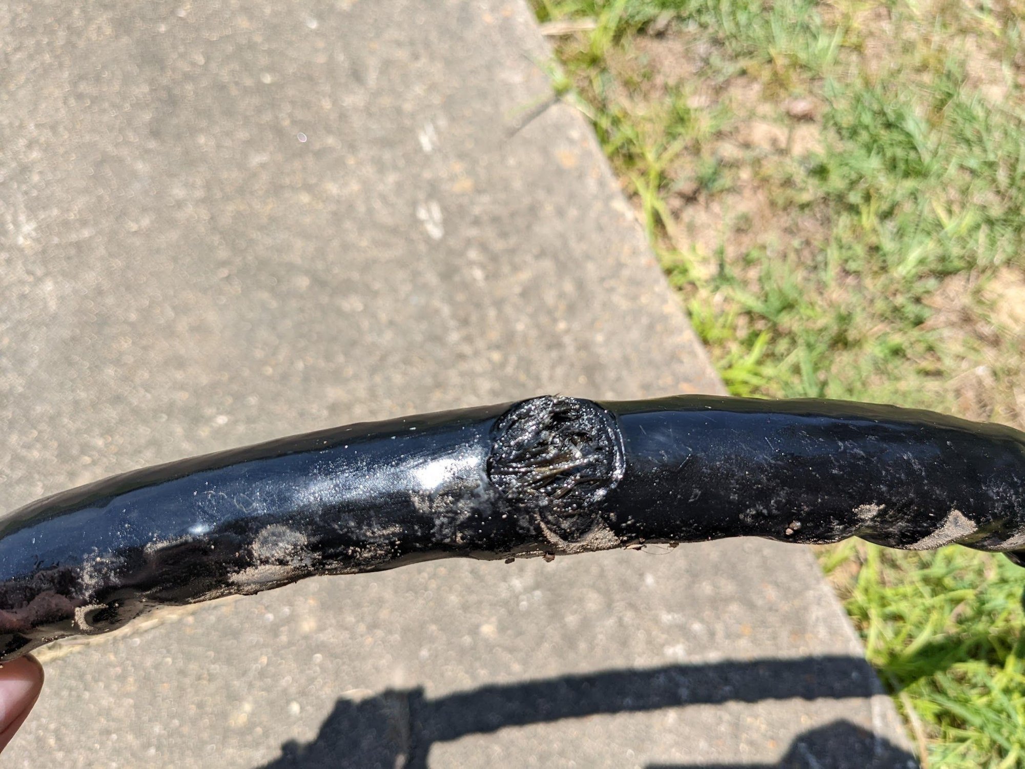

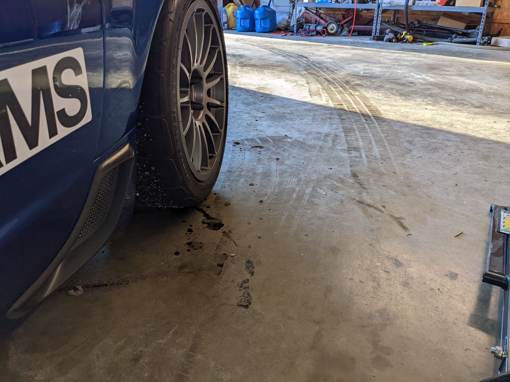

So I took my newly repaired Z06 out to an autocross this weekend. After 6 runs it started leaking oil EVERWHERE. I opened the hood and it was a colossal ******* mess.
Well, I cleaned it up and found that one of my oil cooler lines had shifted and come in contact with my power steering pump pulley. I'm not sure if it happened as a result of the crash, or from hitting a cone, or just kinda wiggled its way there. Either way, the pulley ate a hole in the line and it was spraying oil out onto the pulley and belt, which flung it all over the engine bay.. With how much got on the headers I guess I should be grateful it didn't catch on fire.
I got it back to the driveway and cleaned everything up and found the problem. After briefly considering capping the lines I remembered that it would stop oil flow to the rest of the engine and decided against it.
So now I needed to move it into the shop. I had hoped to not cause a colossal ******* mess (again) so I wrapped the bad line in paper towels for the 10 foot journey to the shop. I learned an important lesson--- oil at 40psi comes out at a greater rate than the absorption rate of paper towels. It made a colossal ******* mess.
So now I get to replace the line while elbow deep in an oily engine bay. Parts won't be here until Wednesday, so I have three whole days to dread this job. I can't wait.
