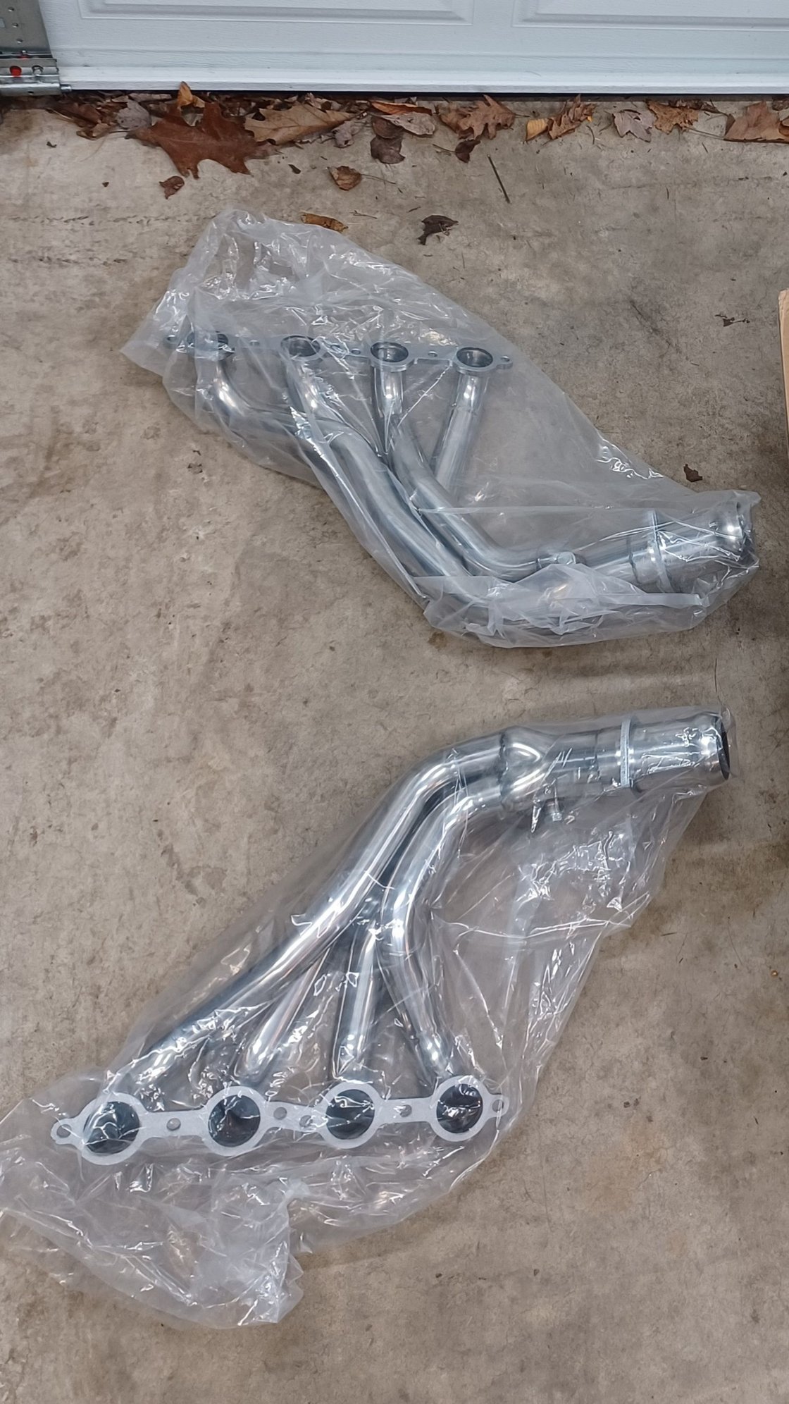

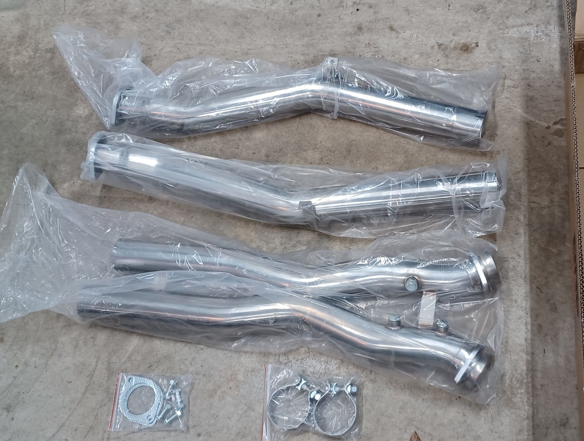

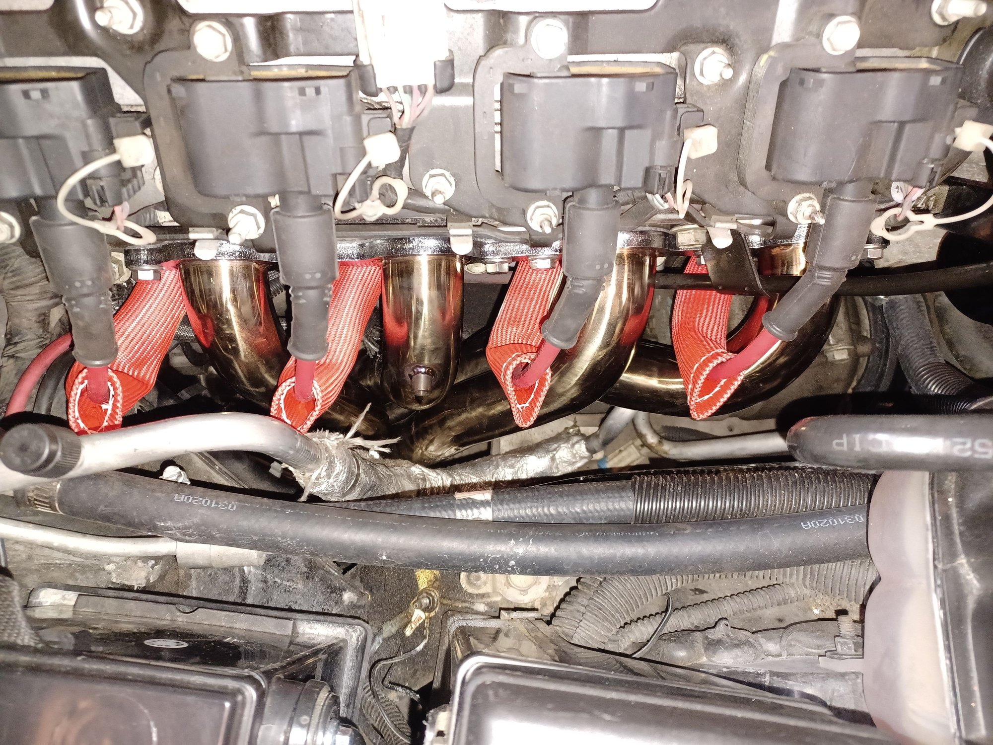

An old thread, I know... just wanted to update everyone, I made the leap and bought these. Paid $381 for the set (after I sold my catalytic converters for $464), and I got to say I'm pretty impressed, they fit well, went right on from underneath. All I did was jack up the engine, pull the plugs, undid a couple ground wires, and they were in. Still working on the install and will update this post as I go...

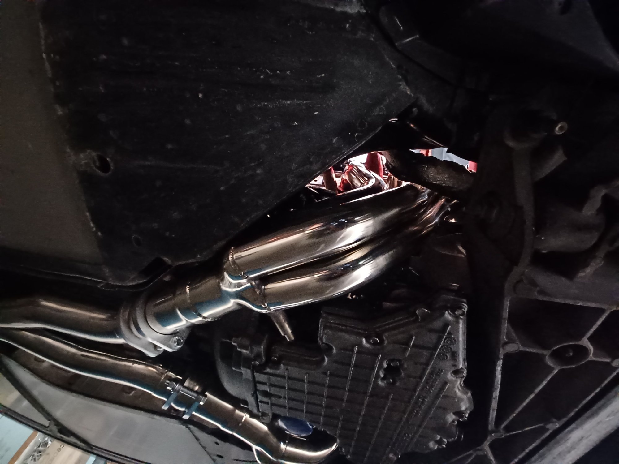

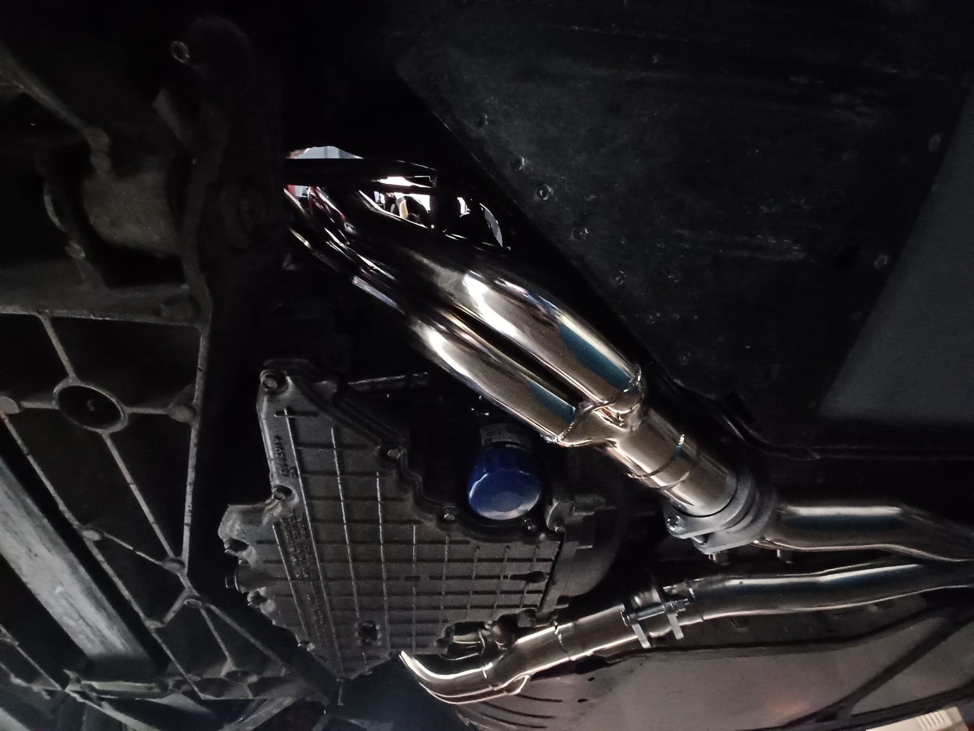

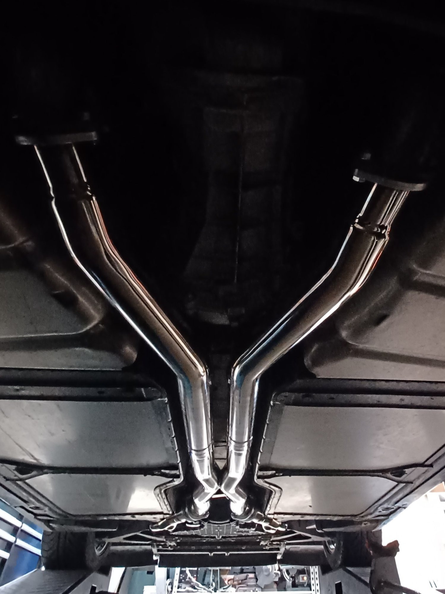

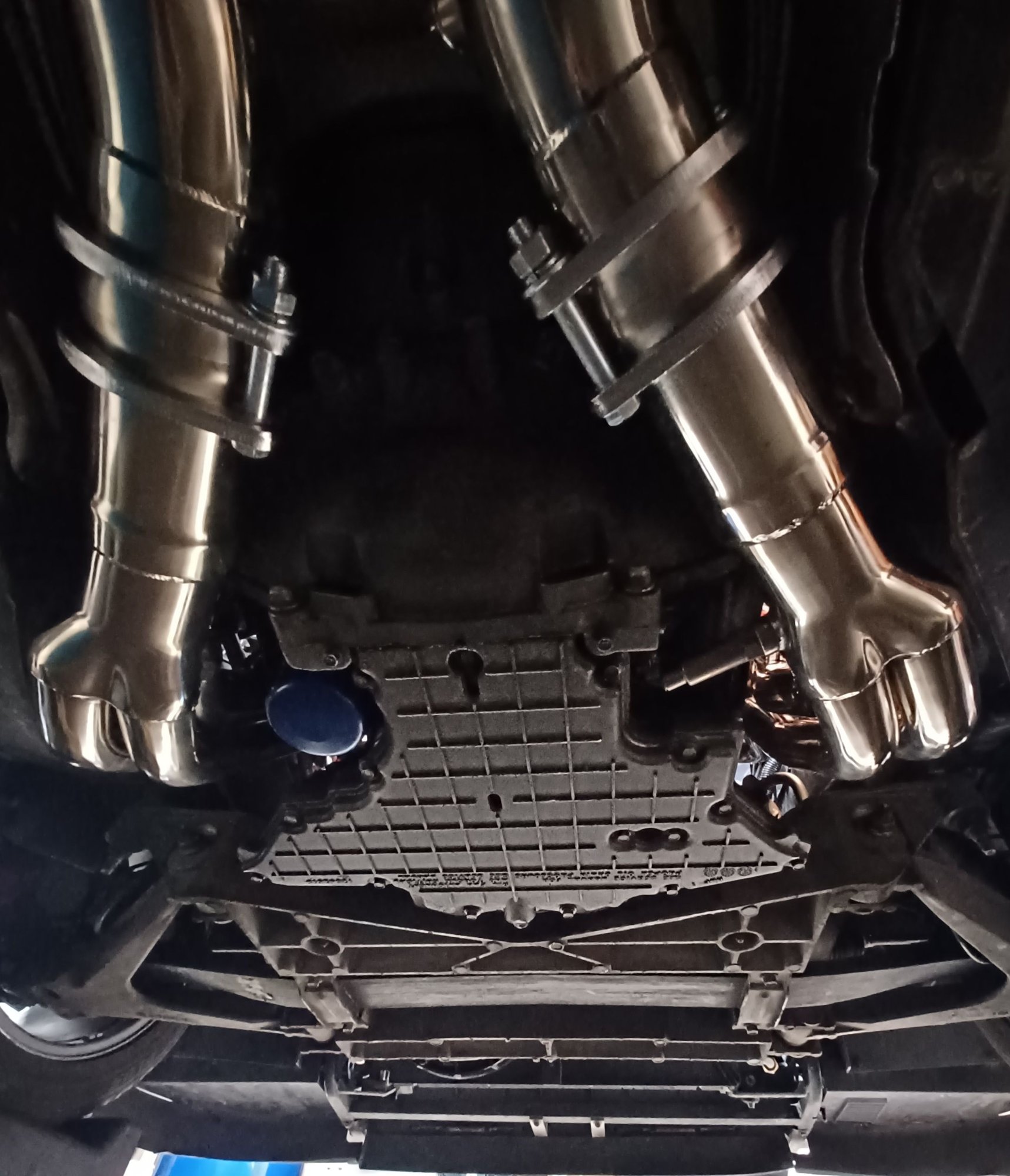

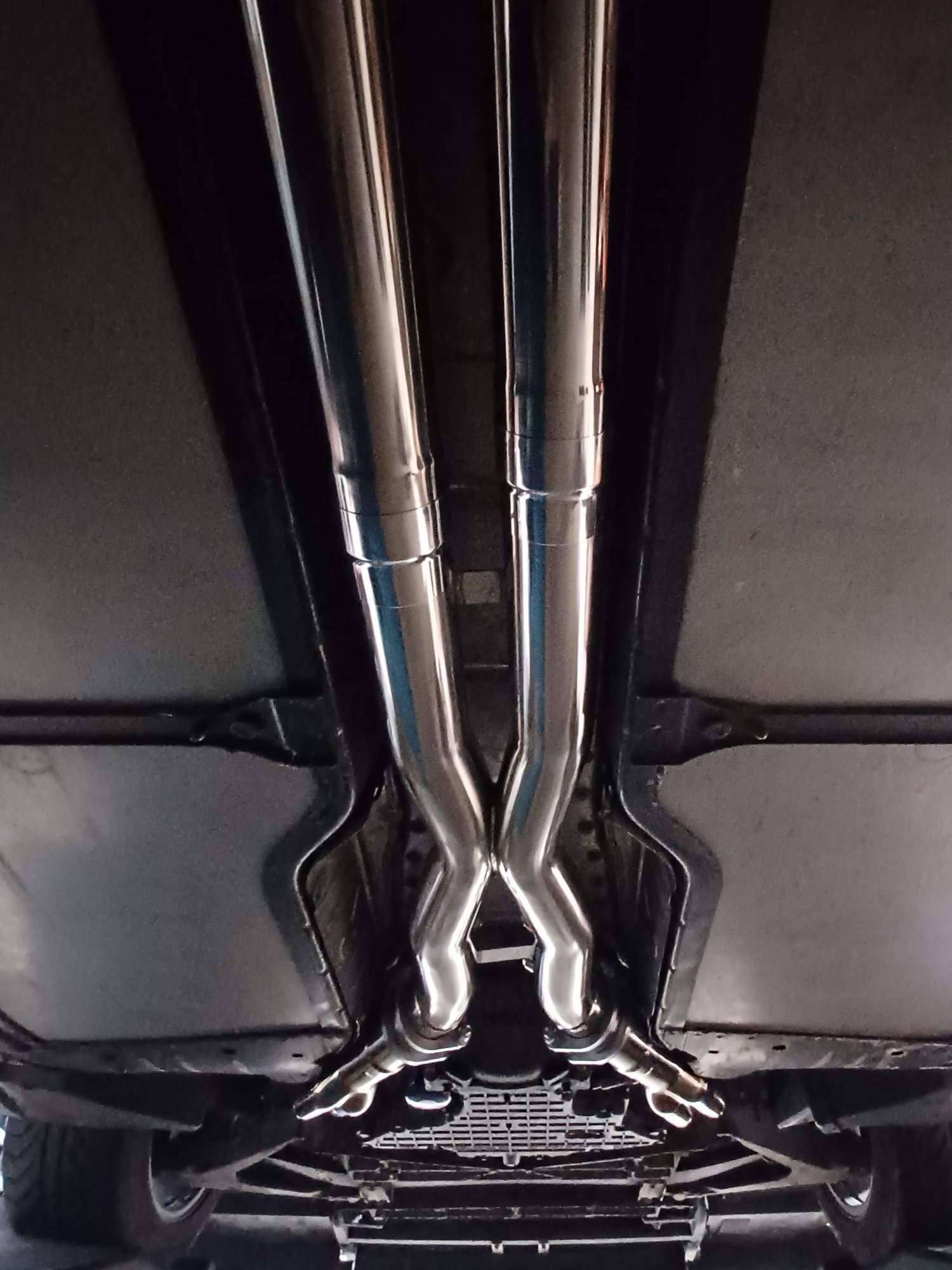

UPDATE WITH PICS...
Headers are in, they fix really well. The x-pipe wouldn't line up exactly with the headers, so I did have to use a ratchet strap and pull them a little closer together, but that was the only issue. For basically a "free" exhaust I'm very pleased!!!
Old Jan 25, 2023 | 08:42 PM
  #40
C5Mat's Avatar
C5Mat
Joined: Oct 2020
Posts: 140
Likes: 45
Those look like they fit really well. Good to see their are some good budget options out there.
