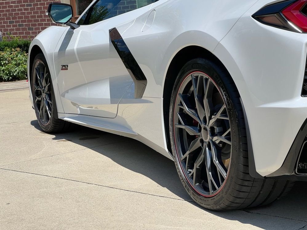

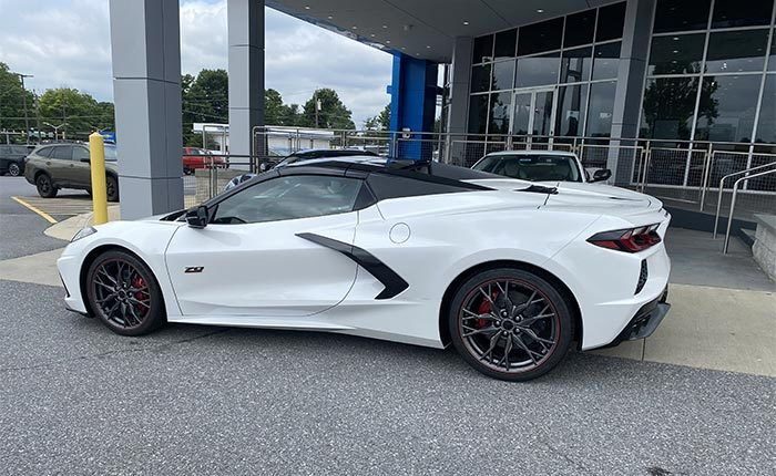

I think the base wheels are ugly but the anniversary c8 wheels look great

^ To each their own I guess. Looks like an Infiniti rim. Never have been a black, dark wheel fan
