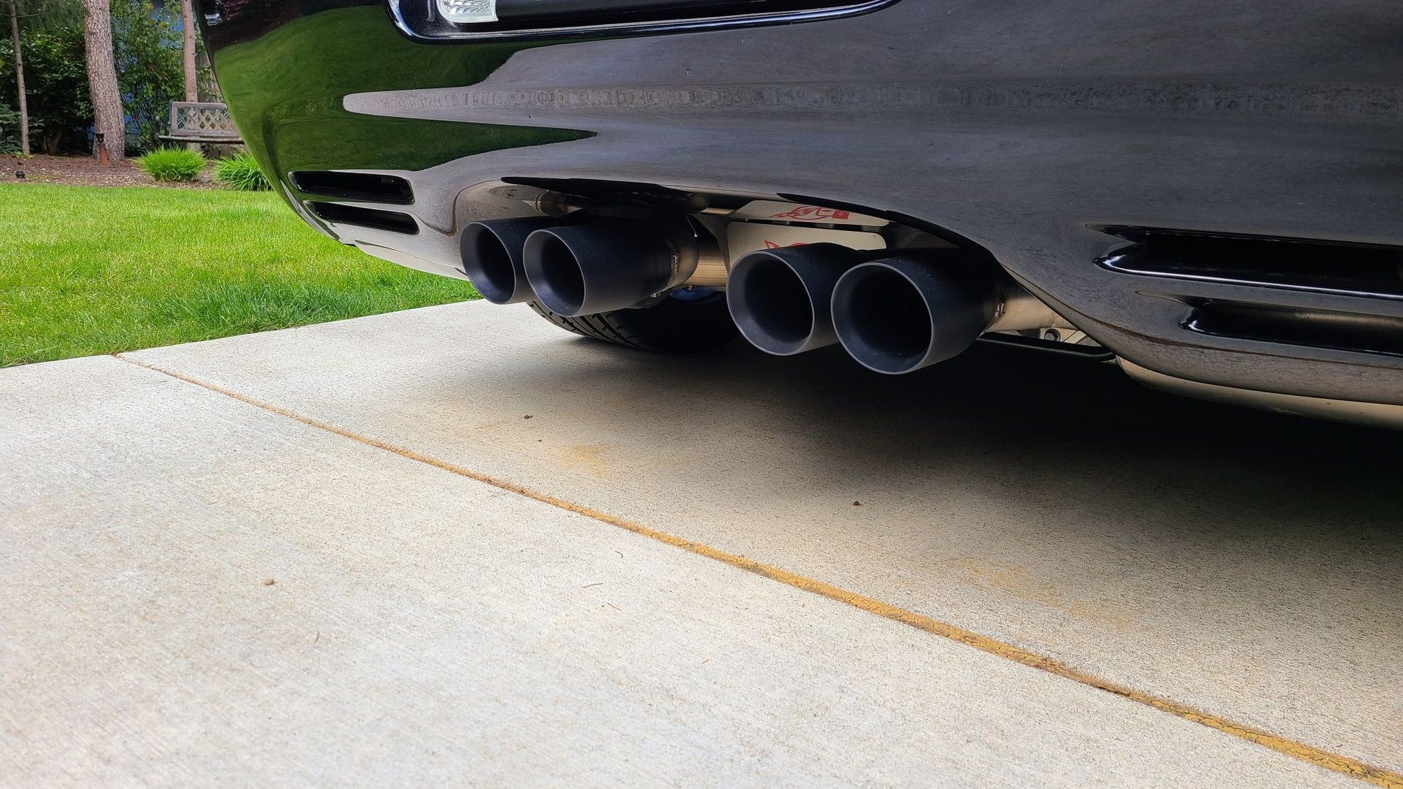

Here's a setup that's not common, rectangle exhaust tips, pretty unique because I've never seen anyone run this kind of setup, what do you guys think?

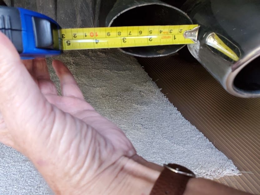

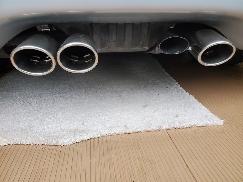

In the photo the very tip of my STOCK exhaust for 1998, second from the right without a tip, is 3 3/4' wide. If trimmed they would probably be 1 3/4" or maybe 2 1/2" but these are the way they came from Bowling Green... And I had previously purchased a set that fit over the 3 3/4" tip but lost one.

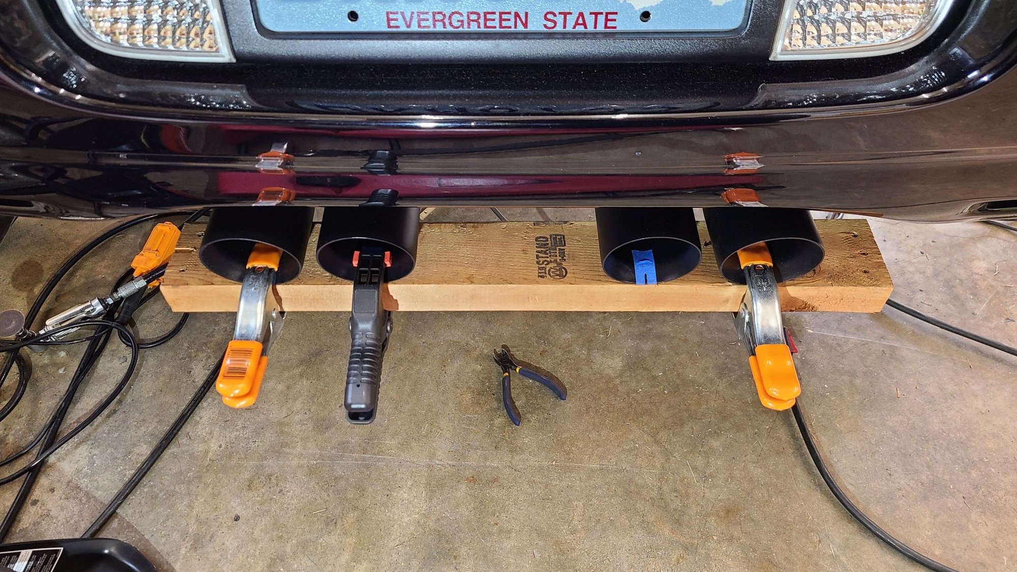

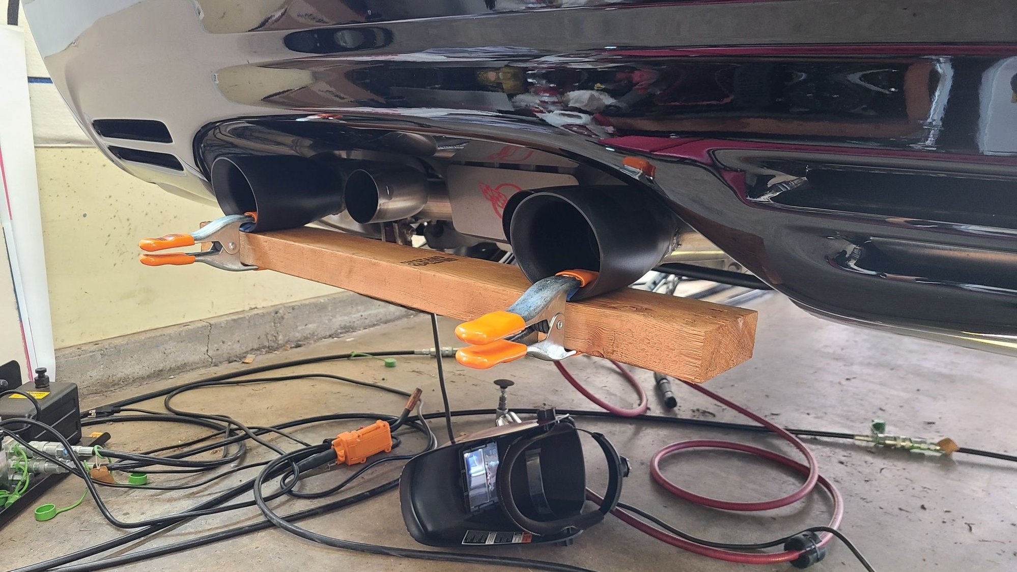

If I'm understanding you correctly I think you are saying that the existing factory tip is 3 3/4 wide? You need to cut the factory tips off and mount new tips to the actual exhaust tubing. You don't want to add a tip to a tip. If that's not what you mean than I am totally lost which isn't saying much lol.
I have a very early Corsa Sport axle back on my car and I didn't like the tips that were on there. Looked very dated.
Ended up cutting those off and putting on something more modern looking. It was a pain but worth the effort.
Process will look like this. Even though I am not using stock mufflers.

The pipe that is shown in the photo is the piece that comes out of the stock muffler. It is not a tip itself. I found a set of round tips previously that fit - obviously - but lost one.
I'll find another set one day and be done with it. I don't want to cut the stock exhaust pipes. Thanks to all of you for the suggestions...
