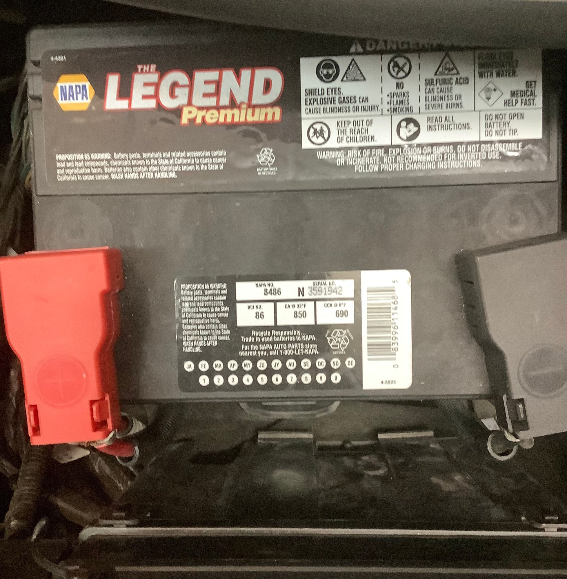

I checked all the usual parts stores and have not found a single AGM battery to fit my 2004, other than Optima. And then, they only show the red model.
Ive checked Napa, O’Reilly, Advanced, Auto Zone…. Some have AGM batteries, but not for the Vette.
Is there another size I need to ask for?
This is the Napa Legend I have:
Old Dec 12, 2022 | 06:28 AM
JHrinsin's Avatar
JHrinsin
Joined: Sep 2017
Posts: 1,967
Likes: 696
From: Avon Lake OH
https://www.corvetteforum.com/forums/c5-tech/4688104-battery-group-78-a.html#post1605926331
If the factory sized Group 86 top post AGM battery is hard to find, look for the slightly larger Group 34 size top post AGM battery and yes it will fit in the factory battery tray.

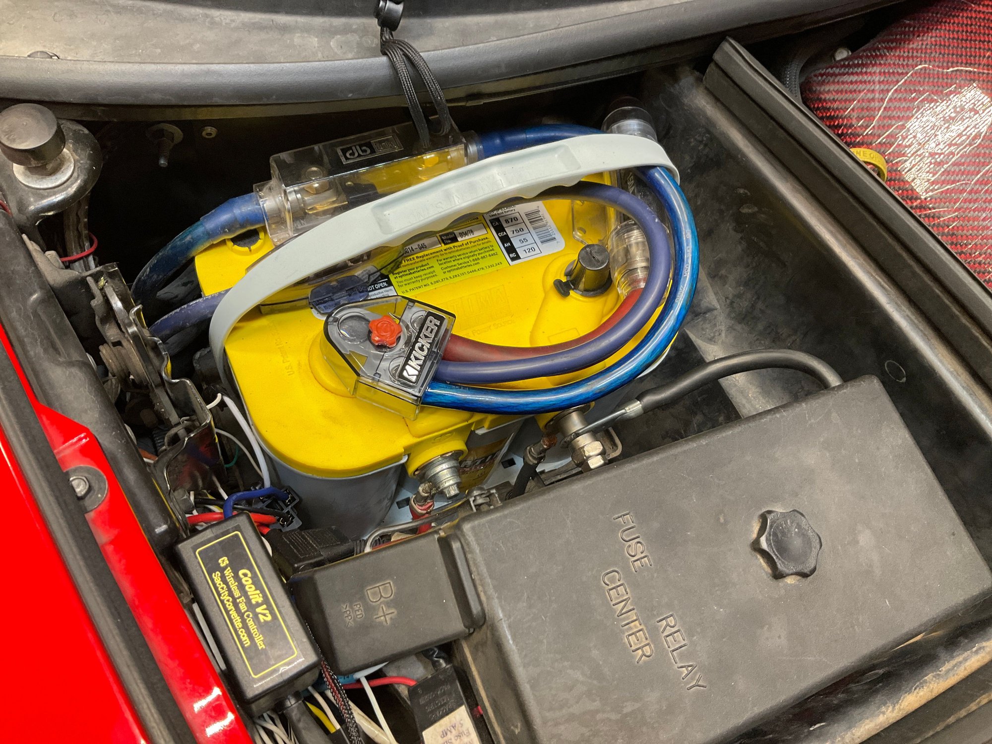

Optima yellow top working great in my car

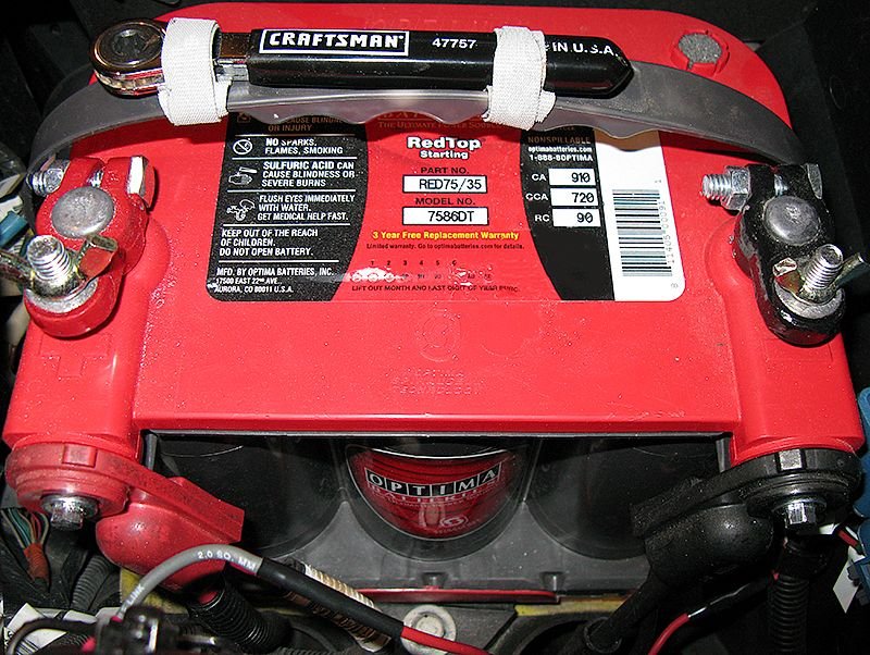

The following is NOT going to be received well by the users of the Optima Red top battery, so I will be reaching for my flame suit as soon as I hit the post reply.
Please be aware that the Optima Red top batteries (Group 34, 78 and 34/78) are all under rated for use in the C5 Corvette. The battery requirements for the C5 Corvette include a 120 minute reserve capacity rating and you can get away with a 115 minute reserve capacity rating, but the Optima Red Top only has a 100 minute reserve capacity rating. (Please note that the Optima Yellow top has a 120 minute reserve capacity).
So what does that mean? I am quoting here;
"Commonly referred to as RC, reserve capacity is the amount of time, in minutes, that a fully charged 12V battery can run before dropping to 10.5V. It is measured in reserve minutes. For example, if a battery has a reserve capacity of 120, that means it can supply 25 amps for 120 minutes before the voltage drops to 10.5V." Basically this tells you how long you can run your; lights, stereo or other electrical items on the car and still have enough cranking amps left over to start the engine. It can also tell you things like say, how long your C5 can stay parked in the garage with the alarm activated without a battery tender attached and still have enough power to start the engine.
So the question is; Can you get away with using an Optima Red top in my C5? (which by the way some Torch Red C5 owners seem to love the under hood color coordinated effect) The answer is... well, sort of yes. But just understand that its not recommended and the limitations involved (like the need to keep the battery tender handy) nor is it the "optimal" choice (pun intended). I will get off my soap box now.

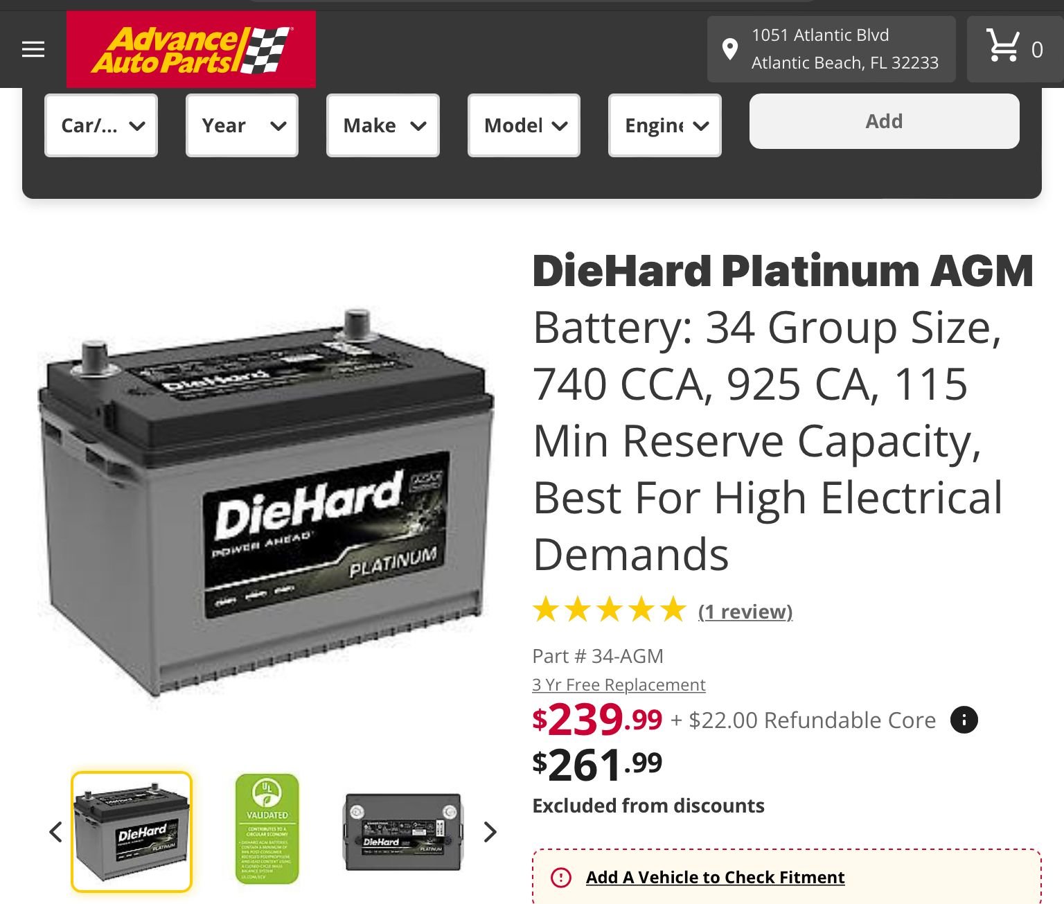

Is this a good alternative to the Gold DieHard and Optima Yellow top?
Seems like the Optima reviews are 50/50 on lifespan

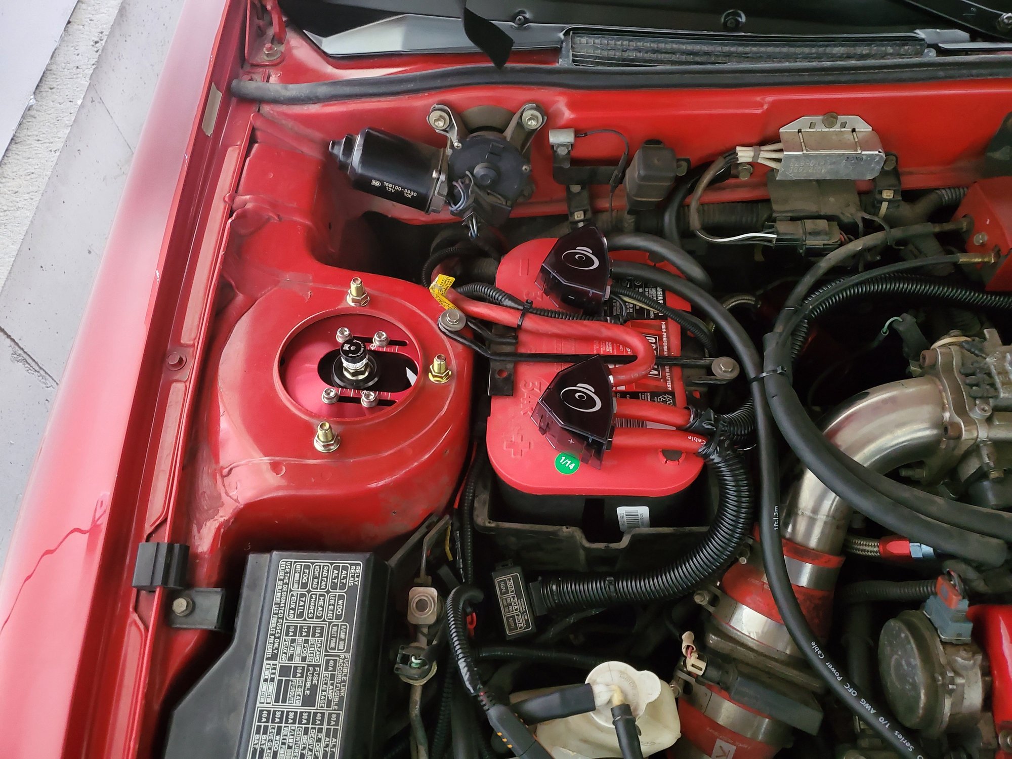

I've had absolutely no problems with the current two Red Tops I'm using, one in my red 99 and the other in my 1991 Eagle Talon TsiAWD. Is the Red Top my first choice, no, the Yellow Top is. The red 99 already had the Red Top in it when I purchased the car and it's preformed flawlessly. The Red Top in my Talon is because the car is red but it it too has preformed flawlessly for 8 years now and my demands for battery power exists in that car

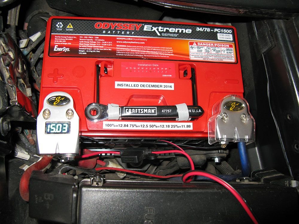

My truck has a 10 year old Walmart Maxx group 78 battery. A non-AGM being OK since there is nothing expensive underneath it. When it gives up, it will be replaced with another one. At $120, they are a good buy
The C5 however has an Odyssey Extreme in it, which recently replaced a 2008 era Sears Platinum - which was a re-badged Odyssey sold by Sears at the time. The current Diehard Platinum is not related - except by name!

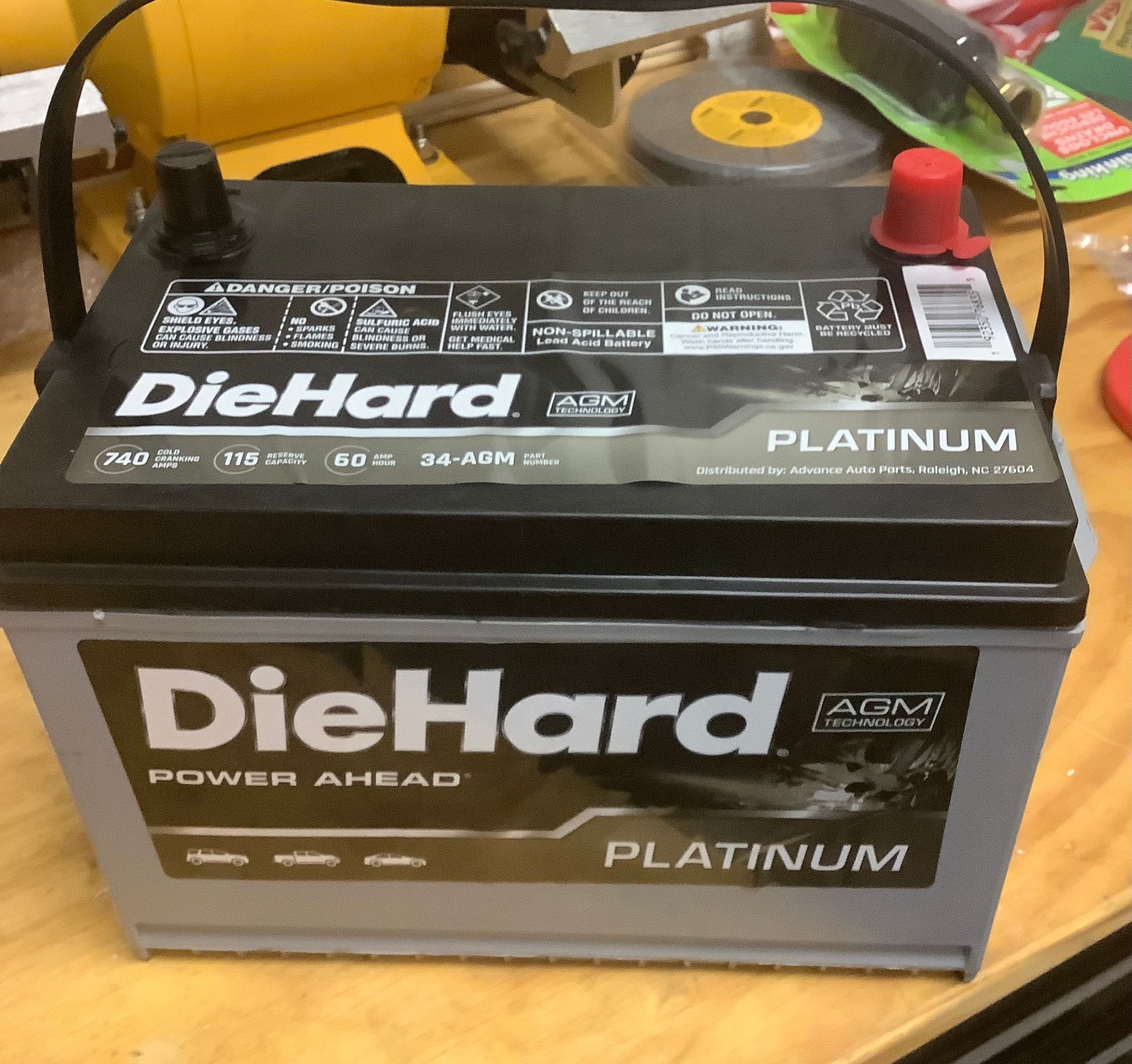

Bellied up to the the parts counter and picked up a DieHard AGM at Advance Auto Parts. Advance bought the brand so they carry them all over.
