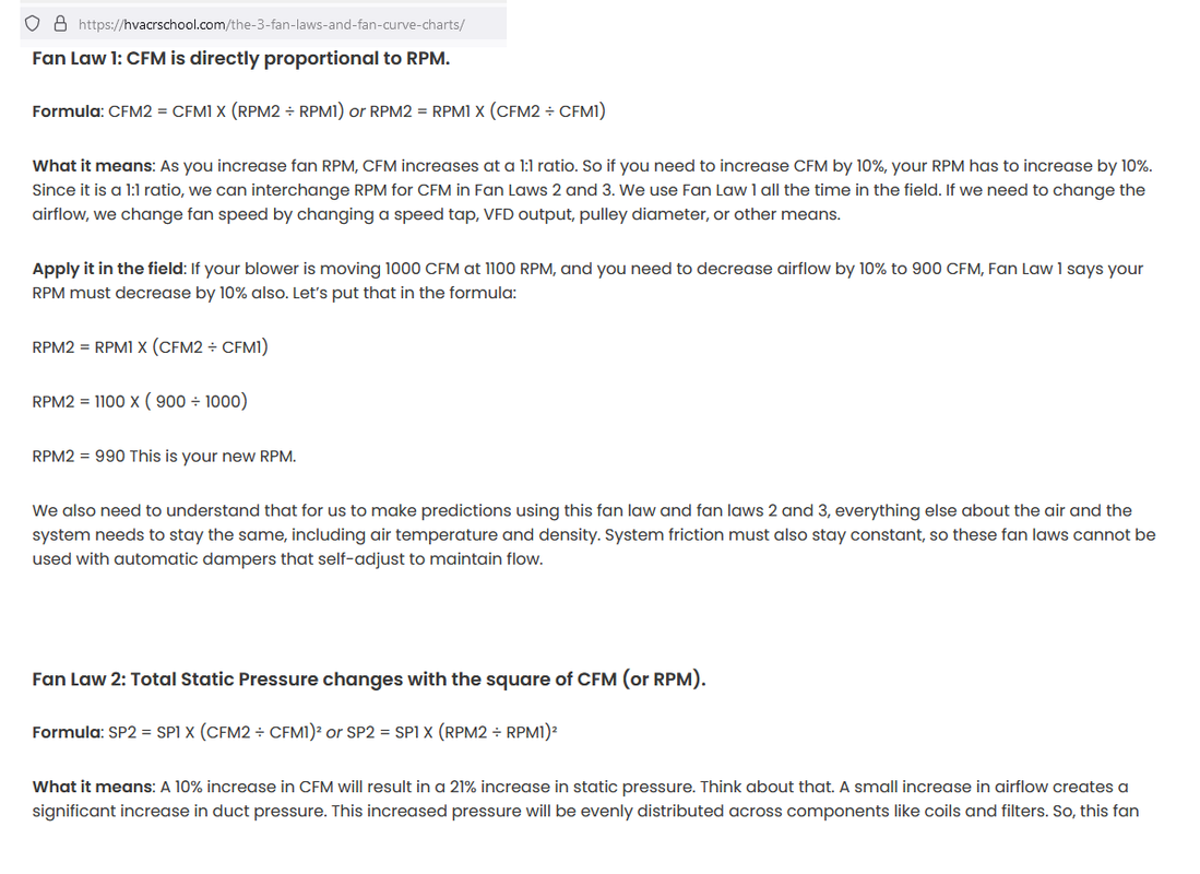

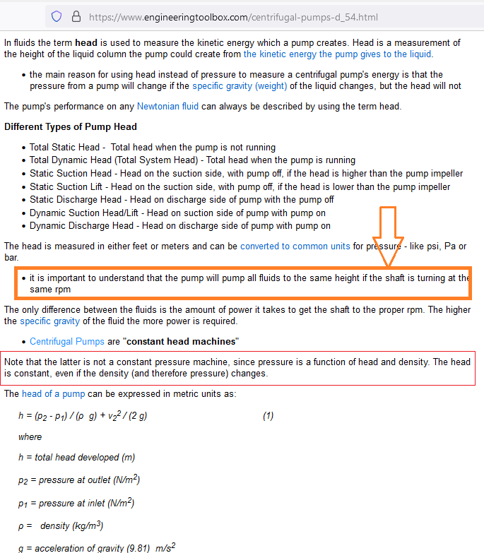

Originally Posted by zeevette
Dazzle us with your BS. Love the graphics.
My BS? If by BS You mean the entire worlds premise for engineering compressor systems , back to school
Its called a law for a reason

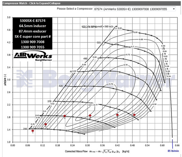

Go on what? Thats it. lrn2play.
Recap: Use engineering toolbox to calculate flow rate of centrifugal compressors and learn gas law.
https://www.engineeringtoolbox.com/g...tems-t_22.html
Do research on how compressor maps may be generated.
https://digitalcommons.calpoly.edu/c...context=aerosp
Use matchbot to relate mathematics to compressor & engine combinations
Theres my compressor mated to my 5.3L using matchbot as an example, I know exactly how much power the engine is capable of producing no matter what is done to the engine, no matter what I do to the heads or cam or intake systems, thus I used the most cost effective and original-like parts possible, OEM LS1 intake, original lifters, low lift cam, weak springs, OEM guides & pushrods, etc... the engine is free and built from garbage, the blower does all the work, The blower doesn't care and is capable of making the same power no matter what is done to the engine.
Adjust parameters such as volumetric efficiency and displacement to get a feel for the results. You don't need to admit anything to me or here, I don't care. Do it for yourself.
