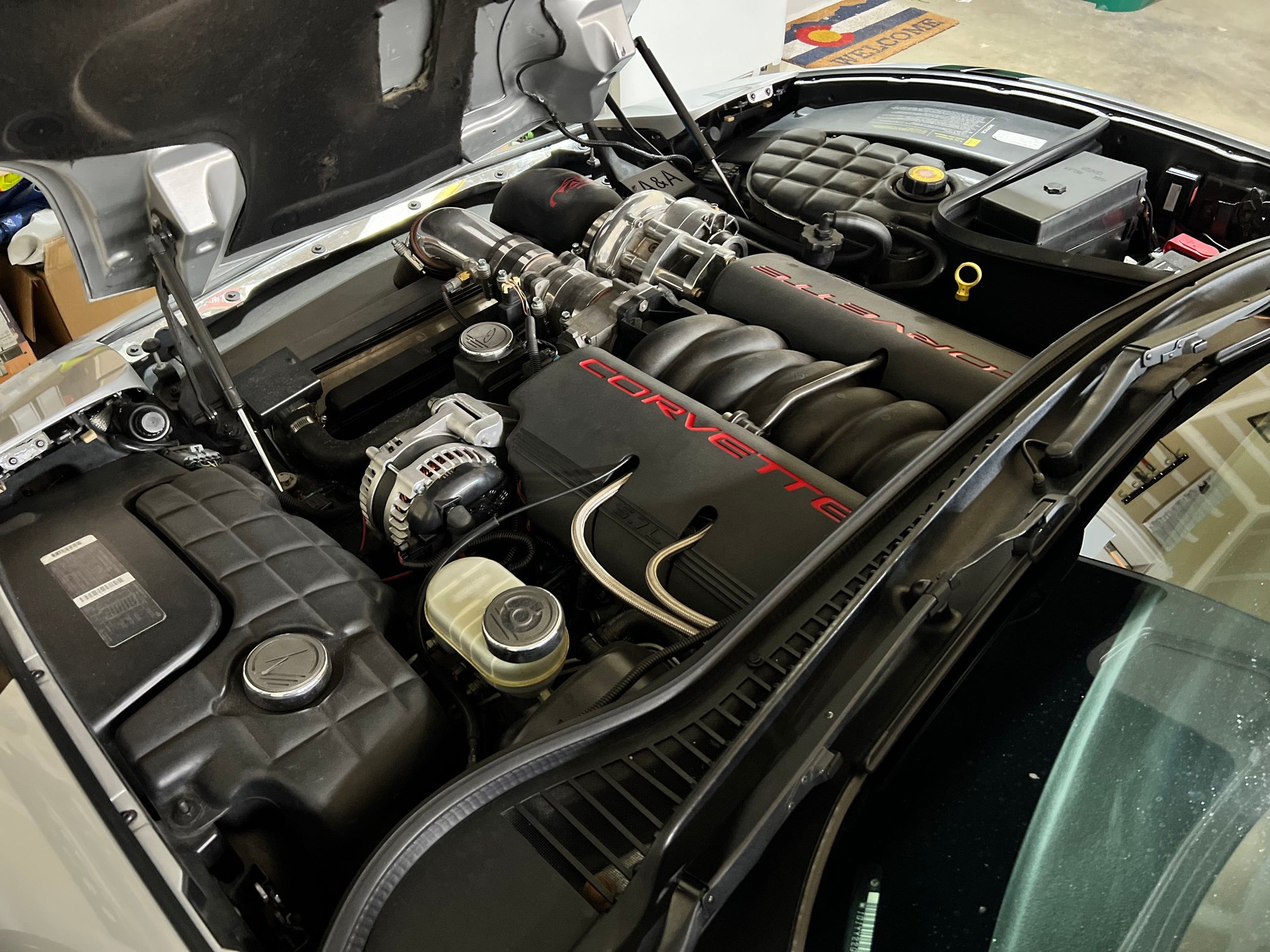

I have the ECS kit and I highly recommend it. I have had it on for 6 years and 30,000 miles. The kit comes with everything that you need, including fuel, and will make 500 whp on an otherwise stock set up. I had headers, full exhaust, an MSD Air Force intake manifold, and a LS3 silver blade 90mm throttle body and made 561whp/560wtq. I have a Dewitt's radiator/dual fans on the front end and MCCleod RST clutch on the back end. I added a Texas Speed blower cam and went up to 633whp/597wtq. At this point I started having engine temp issues (I live in Charlotte, so 90+ degree days are common) so I added a Meziere electric water pump and that solved that. The power is extremely controllable, more so than a roots type blower in my opinion, with a significantly lower gas mileage penalty. I haven't broken anything, but I don't do digs at the drag strip. I'm running 325/30/19's on the rear, it's easy to break the tires loose, but it's also easy to get a good launch.

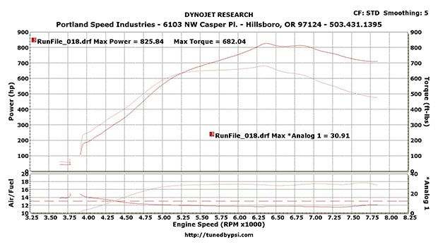

Forced induction is the most reliable means of adding power to any combustion engine.
The key to maintaining reliability is first, you absolutely must know how to tune the engine and have a plan for tuning before a single change.
Next, don't modify the motor much.
Use a low lift cam with a slow ramp rate to maintain valvetrain reliability and high RPM stability.
Do not port or modify heads. Use factory parts wherever possible. Keep the compression as low as possible for safety.
Blowers can supply a given HP worth of airflow- power is limited by the blower, not the engine. Modifying the engine does not increase power significantly, it only adds risk.
How much power can a 2L engine make with a 500hp turbo?
How much power can a 4L engine make with a 500hp turbo?
How much power can a 6L engine make with a 500hp turbo?
They are all capped to 500hp by the forced induction they chose. Modifying the engine by stroking, boring, displacment, head mods, flow mods, large lift cams, etc... only will reduce reliability.

There is a big difference between what I recommend to people asking about forced induction for the first time, and what will I use for myself. With decades of tuning experience one would use a higher compression personally for street vehicles. However, novices asking about their first supercharger intending to utilize pump gasoline fuels asking for basic advice of how they can maintain reliability of their already-high compression natural aspirated V8 engine, the answer is simple: do not raise the compression unless you know what you are doing and getting into. Reiterate, if the engine already has a too-high compression at perhaps 10:1 being originally N/A so there is no way no how you will want to raise that regardless of benefits. To review this concept we should look at OEM forced induction engines. The average compression ratio of forced induction 2L and 3L range engines is roughly 8.5:1 compression. Those power vehicles with 25-30mpg (Silvia, Skyline, Supra) that do fine at 2L to 3L OEM forced induction 300-600rwhp applications with stock engines. If somebody will think a novice will need higher than 8.5:1 compression with two or three times the displacement to make roughly the same power to weight ratio is an idiopathic or spontaneous response. Factory engines from the 90's function well in 3000lbs daily drivers with 122 to 183 cubic inches of displacement at 300rwhp to 600rwhp using 8.5:1 compression then there is some serious oversight or lack of experience with what 122-183 cubic inches can do when setting up 300-400 cube displacement engines with higher compression in similar weight vehicles that people complain idiopathically are sluggish or irresponsive. I would suggest that the tuning efforts be reviewed and seeking help with fundamentals of setting up a drivetrain for particular applications as street or strip.
it's true that stock LS top ends are pretty decent out of the box, but there are worlds of gain to be had by pairing the right combination of heads and cam with your blower goals.
There is nothing to gain. It has never happened and will never happen and you cannot prove it has ever happened no matter what you post or think because thermodynamics is quite clear about the rules of mass in must equal mass out and the turbo or supercharger is a pump which is pumping some particular mass and whatever mass is pumped in must also exit the engine exhaust no matter what you've done to the engine will not change that fact.
that's because much more so than a turbo, a supercharger is kinda like cocaine in that it simply amplifies the power curve of whatever the engine does naturally aspirated.

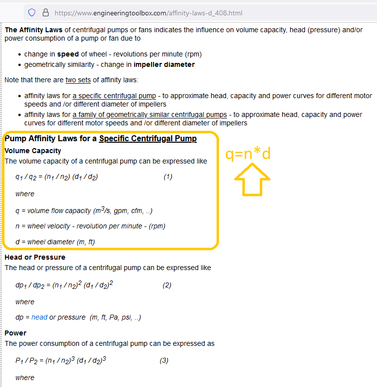

Superchargers do the same thing as turbochargers. This is showing your inexperience and making me sad. I had higher regard for you than this. I am not picking on you but what did you actually think a turbo was if not a supercharger attached to an exhaust stream? They are both the same devices. The only difference is one parasitically drains kinetic energy from rotating angular velocity of the engine thereby reducing its overall power potential and the other is moved by kinetic energy of exhaust gas- making it a far superior choice as it conserves angular momentum of the rotating engine allowing it to produce more power. Superchargers are easy to install that is their only upside. Turbochargers are superior for high boost and high output conditions, superior in every other way.
that said, if you have a specific power goal: you can use blower A to make that on a stock engine or smaller blower B on a modified engine... or blower A turning slower on the modified engine... or blower A on the modified engine surpassing your goal.
You have it backwards. If we modify the engine, boost will be lower at a specific output, but that does not mean you need a smaller blower. The size of the blower "big" and "small" has nothing to do with boost. Your statement reveals a distinct weakness in knowledge how blowers function and all I can say is please read more,
Also, matchbot provides some useful exercise in establishing rules of larger vs smaller compressors, I think if you play with matchbot for a couple hours you will have a deeper understanding
https://www.borgwarner.com/matchbot/
I'm not picking on you, I want you to replace me. But to do that you must be willing to work and come up to the level.
turbos are a different story when it comes to weighing the pros:cons of top end work.
No its the same compressor wheel on a turbo. They follow the same rules. Top end work drops the boost down making turbos and many superchargers less efficient if the boost is falling below roughly 15psi. Look at practically any compressor map and find the 2:1 pressure ratio line and consider the flow of the axial compressor below that pressure ratio while keeping in mind pressure ratio is a ratio of pressure between the inlet and outlet, NOT a specific boost pressure. For example I can make a pressure ratio of 2.0 by using an air filter that gives me 2.5psi of pressure drop making the intake manifold pressure of 10psi become 2:1 pressure ratio, when the compressor outlet is roughly 12psi and there is 2.5psi lost by the filter and 2psi to friction in the plumbing and intercooler.
as for the 2L, 4L, and 6L engines all using the same turbo (which this is a supercharger discussion): the 2L would be as gutless as a thanksgiving turkey until it gets wound up, while the 6L would barely be asking it to work at all & therefore much more tame with a broader powerband but tapering off earlier... but that's beside the point and more-appropriate for a different turbo thread - though i do see the point you're making about the head unit can only move so much air regardless of what it's on.
Gutless huh
2.0L
2.5L
3.0L
These are ancient engines from the 90's and all have broad usable powerbands, 2L 2.5L and 3L engines work well in the 450-800rwhp bracket at 8.5:1 compression ratio and knock down 25-30mpg at 3000lbs vehicle weight. Once you understand what 3L is capable of you will question everything you ever learned about V8 engines and re-think the entire game.
Its like you want to train to become faster, so you add weight to your body. You get used to the weight, adapt to carrying an extra 100lbs everywhere you run and live. Then, remove the weight and see the results. If somebody hands you a V8 its like you never had to work with the extra 100lbs and you are missing out training and knowledge and experience from true training of the mind and body which needs to come first before you can understand how to utilize such a large displacement to its fullest potential
To Supercharging
