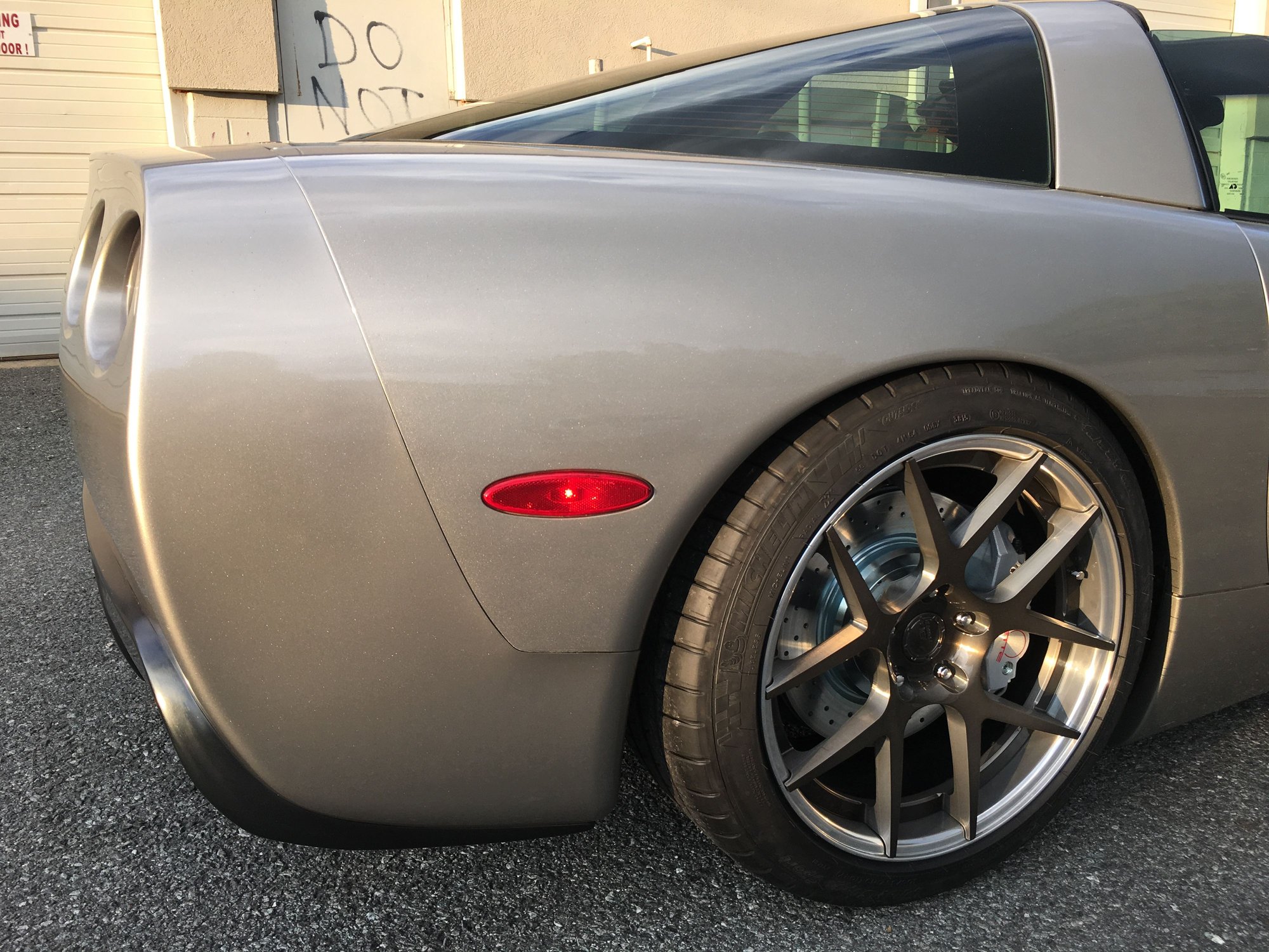

With the 325s, are those inside stock fenders or under some flares? What is the wheel fitment? I have 305s here and figure that's about the best I could fit inside oem body panels.
Any vids of the car on YouTube? Love to hear it with that combo. What pulley size and boost restriction are you seeing with it currently at that power number?
Thanks!
- Numbers are on standard 3.8" pulley that comes with the kit.
- The accessory bracket is powder coated, thanks for noticing. Did you note that I got rid of the ugly yellow dipstick too? ;-)

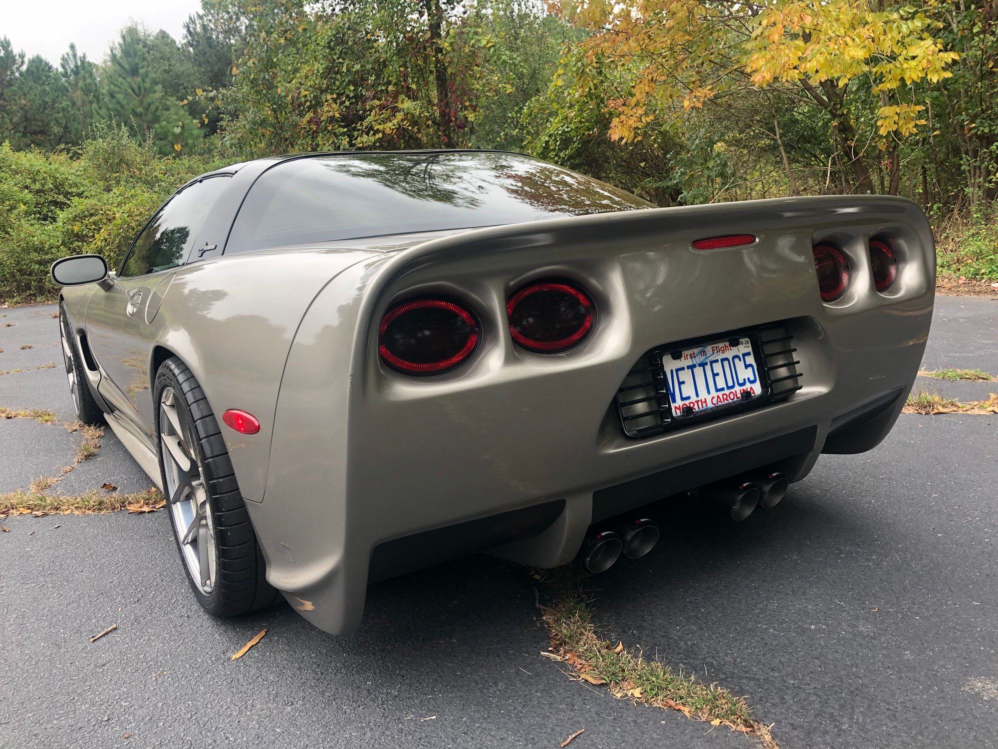

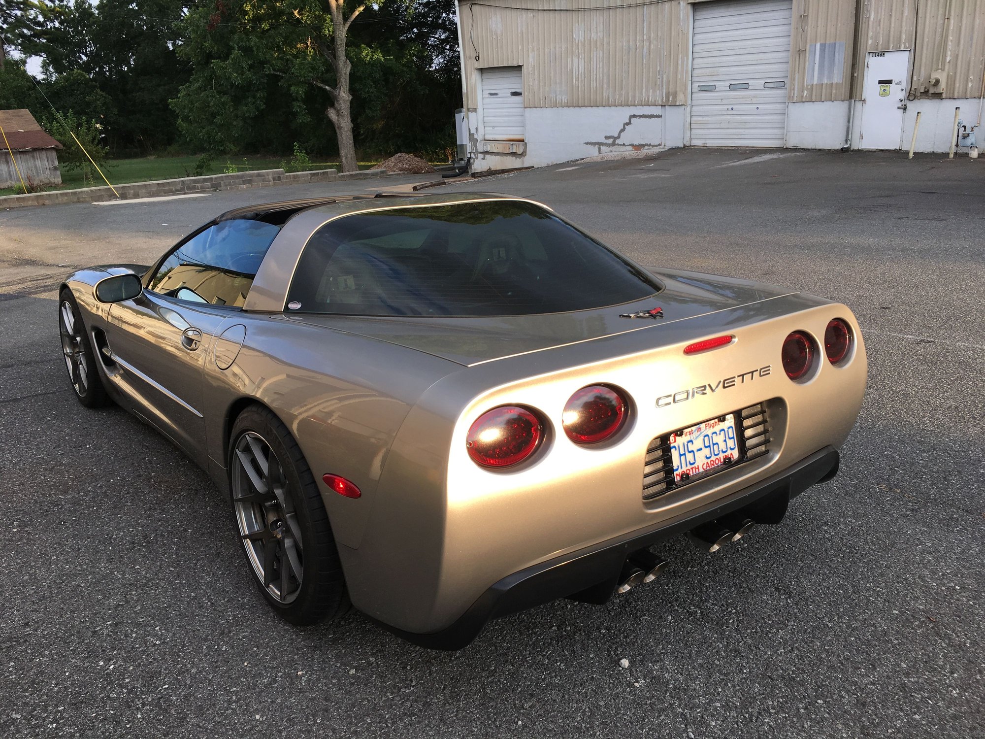

- You are correct, 305's are the biggest that will fit under stock fenders without poke. I have 1" flared fenders from Vette Nuts which cover them perfectly. Wheel specs are 19x11 +60, which, with the 305's fit under the fenders.
305's stock fenders:
325's with 1" flare:
