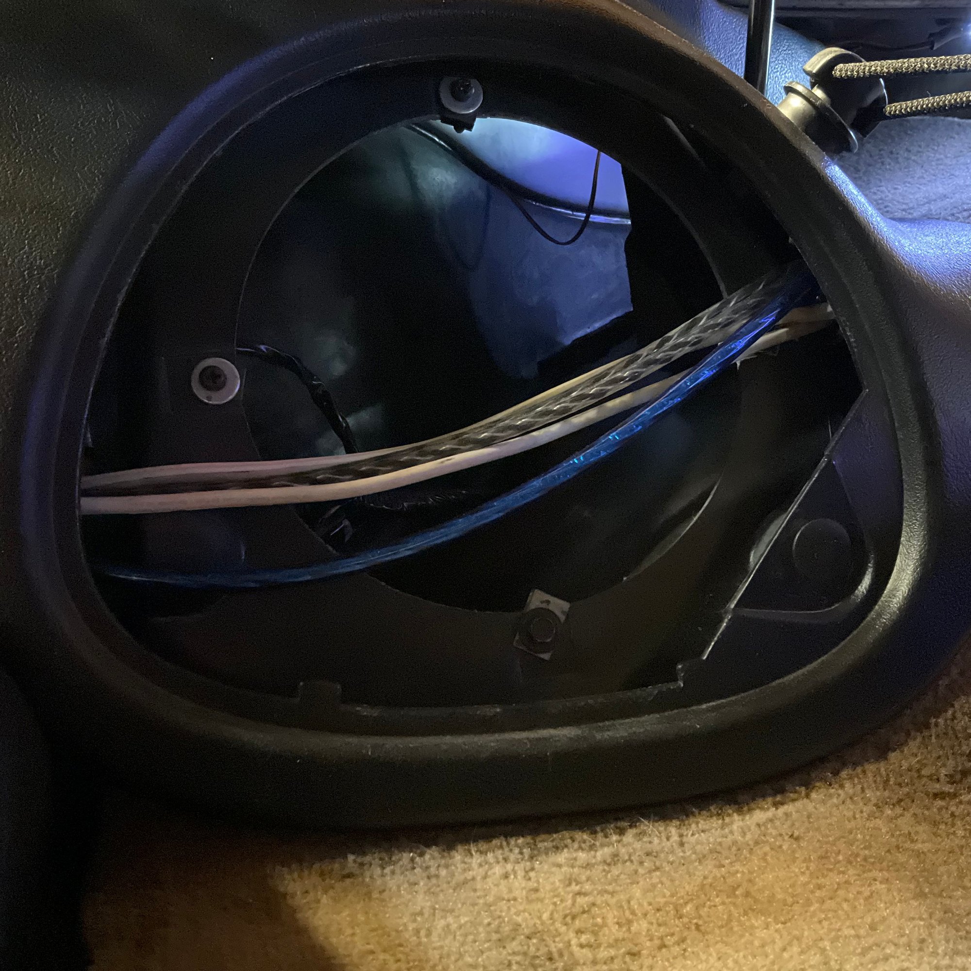

I used the Metra door adaptors that allow you to use 6.5" speakers. Amazon:
Amazon.com: Metra 82-3013 Speaker Adapters for 1997-2004 Chevrolet Corvette : Automotive Amazon.com: Metra 82-3013 Speaker Adapters for 1997-2004 Chevrolet Corvette : Automotive
I used JBL speakers all the way around. Front and back: On sale now on Amazon for a ridiculous price.
Amazon.com: JBL GTO629 Premium 6.5-Inch Co-Axial Speaker - Set of 2 : Electronics Amazon.com: JBL GTO629 Premium 6.5-Inch Co-Axial Speaker - Set of 2 : Electronics
Changing the rear speakers will be the easiest part you will do. The top screw would be a bit challenging if you do not remove the plastic trim and just go through the cover.
I just popped off the mesh covers and once I was able to remove the top screw, I installed the replacement speaker with just 3 screws and re- installed the mesh.

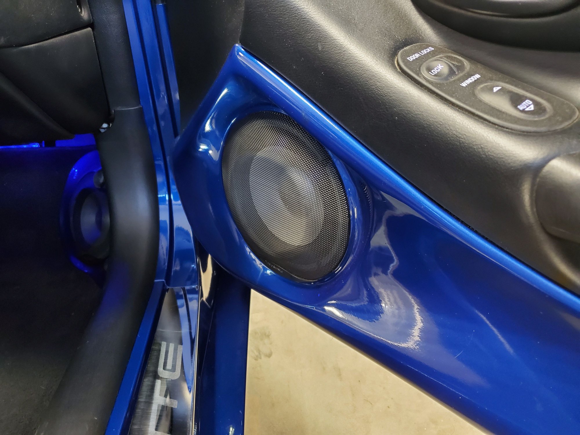

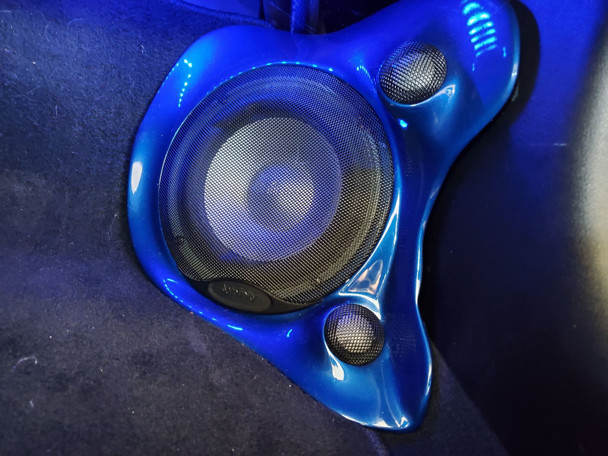

yes -- get a really good set of 3.5" for highs.. I use audio frog 3.5"s but they are expensive, but crystal clear and handle a ton of power for their size:
Audiofrog GS25 GS Series 2-1/2" midrange car speakers at Crutchfield
Get a set of 6.5" woofers (not SUB woofers) in the door for mids / high range base. I use Morel 6.5" -- again they're expensive, but the sound quality is insane:
Morel Elate Carbon MW6 Elate Carbon Series 6-1/2" woofers at Crutchfield
(morel also makes a different set that's cheaper and almost as good as the carbons -- Morel Hybrid MW6 MKII Hybrid Series 6-1/2" woofers at Crutchfield)
The 3.5" and 6.5" fit perfectly in the stock opening in the door, with a metra adapter
Metra 82-3013 Corvette Speaker Mounting Brackets Install 6-1/2" or 6-3/4" speakers in 1997-2004 Chevrolet Corvette vehicles at Crutchfield
For the rears (I have a convertible) I use Hertz. I think they're 5.25s, but frankly you really don't need them, they don't do much other than some spatial imaging. I barely notice the sound with or without them.
with a setup like this -- not necessarily the audio frogs/morels, but getting a really decent set of 3.5"'s and 6.5", you'll get really good, full lows and crystal clear highs.
To really fill out the bass, most people throw a 10 or 12" subwoffer in the center cargo area -- there are tons of enclosures out there you can buy that fit in the stock opening.

I am quite surprised at the posters that say the rears don't matter.
Going to a 5 channel amp with a dedicated sub was not that much more than a 3 channel amp.
The 2 rear speakers are less than a $100 a pair for 6.5" JBLs.
Then they will make a world of difference if you push your fader on the head unit a step or two back towards the rears.
If you don't want to do that, you can balance the 4 channels on the amplifier.
I hear my sound loud and clear from all 4 channels.
MHO anyway.

My rear speakers

Because they don't. But to each their own, if you like them then use them.
For my purposes, it's tough to find high quality speakers with range that complements the front. I've tried over a dozen sets, and the best I've been able to find overemphasize the mid frequencies, and while add some imaging, muddies the tones. I hardly notice them when they're gone. In the convertible at least, they're also horribly located, and give terribly listening angles.
I guess maybe adding some tweeters in that spot for imaging may be better, but with the options out there combined with the terrible placement, they really do ****.

Originally Posted by JMG2
you keep the door speaker grill and the rear grill.
Frankly you really don't even need the rear speakers, they really don't do much.
I have to agree on this one.....both ways.
When you go to a concert, where are the speakers? Of course, they are in front of you. I've never been to a concert (and I've been to a LOT of concerts) and have never seen rear speakers.
That being said, I only run front speakers in my 02. Two sets of Infinity Perfects 6.1s. Tweeters are angled for best sound quality. Frickin' sounds AWESOME!
But, I can seen the reason for having rear speakers too. Once there was dedicated 5.1 systems but I don't think it ever caught on much. I do run rear speakers in my 99s but I have the fader adjusted towards the front. In both 99s I just use the head unit's amplifier to power the rear speakers. I have two 12" subwoofers in my black 99 so I need all the mids and highs I can get.
