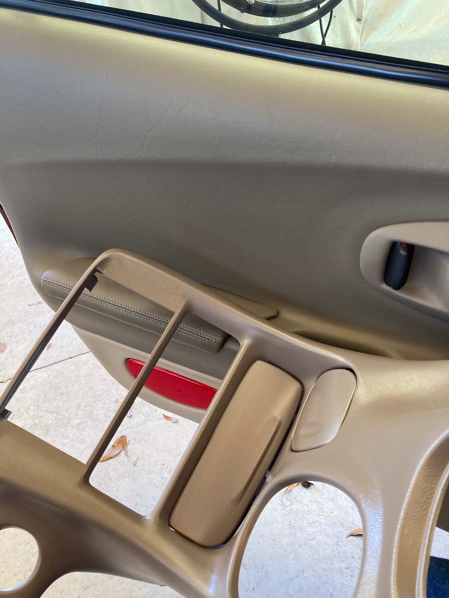

So just ordered the 2 din bezel (in Shale) from VetteNuts which gives you the ashtray door & cup holder door; installing a Kenwood DMX958XR and 4 cameras (F&R separate dashcams, BU and front bumper curb-cam (cutting a trimmed-out hole in license plate cover & painting the camera housing); 6.5" Focal coax in back, will do amps, subs & doors maybe later. The Kenwood's can switch in ur graphic with a usb AND controls their cameras. Just attached photos of the bezel I got today, not a perfect match but close enough.

I just finished the install, the DMX-958XR is quite a beast, shallow mount, lots of stage & cross-over settings, perfect CarPlay and installed 6 cameras, 4 of which are controlled by the DMX. The front one sticking thru the license-tag cover shows me exactly where a curb is. Still fidgeting with getting the AXXESS & RAP to work right, and always modding something else. I repainted the VetteNuts 2-din (they aren't using the right paint) and it was a huge effort to get the bezel & HU aligned, had to drill and tap specific mounting holes, but turned out super.
