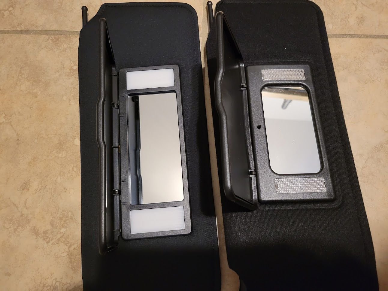

Just got mine in. Look great and seem to be built very well and they are even black. However I'm sending them back. The passenger mirror lid doesn't open all the way and the LED light won't come on unless you push it up just a hair. Wife won't stand for that!

i had the same problem. i had to shave down the tang a bit to get the mirror to open up to a wider degree. i'll post some pics to show the issue.
you can also just force it up wider...it won't break. i did that on the passenger mirror instead of shaving it and it worked too.

I looked for what was hanging it up and couldn’t see anything. I also tried to push it up, but I was afraid to break it. My other set will be delivered today. Please post pics of yours. Thank you

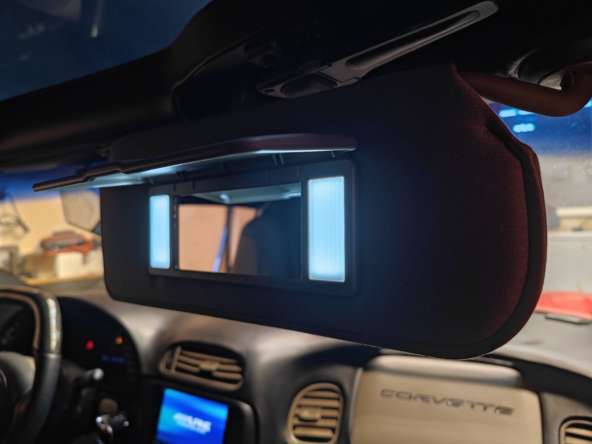

I got them from about 45° to around 90° which was enough.
My old black ones opened further to about 110° which was nice

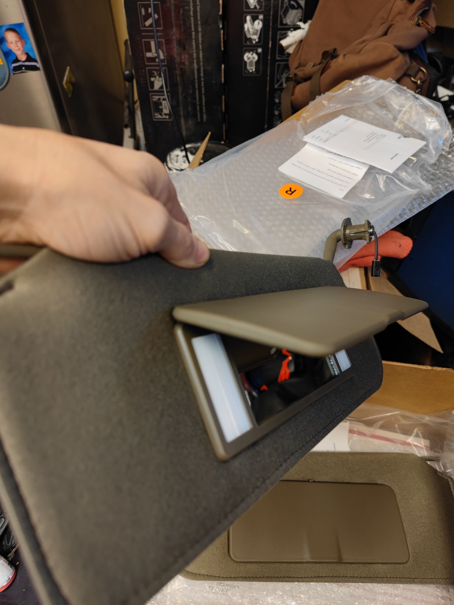

Glad I found this thread! My driver's side sunvisor failed in a spectacular fashion a few weeks ago (fell down into my light of sight while driving). Ordered the Nakuuly brand ones off Amazon 2 days ago. Color is close enough for me. Quality seems fine. Gotta fix the mirror cover opening issue.
