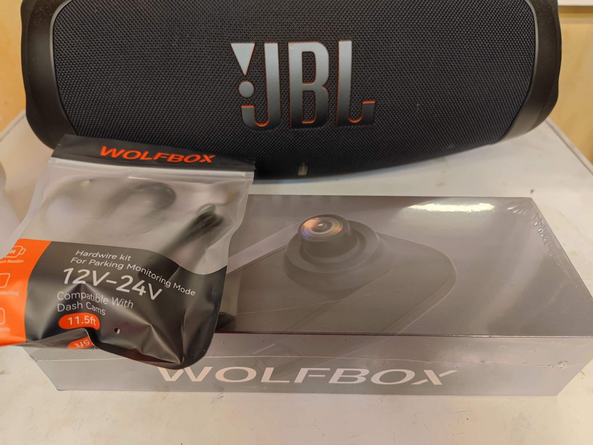

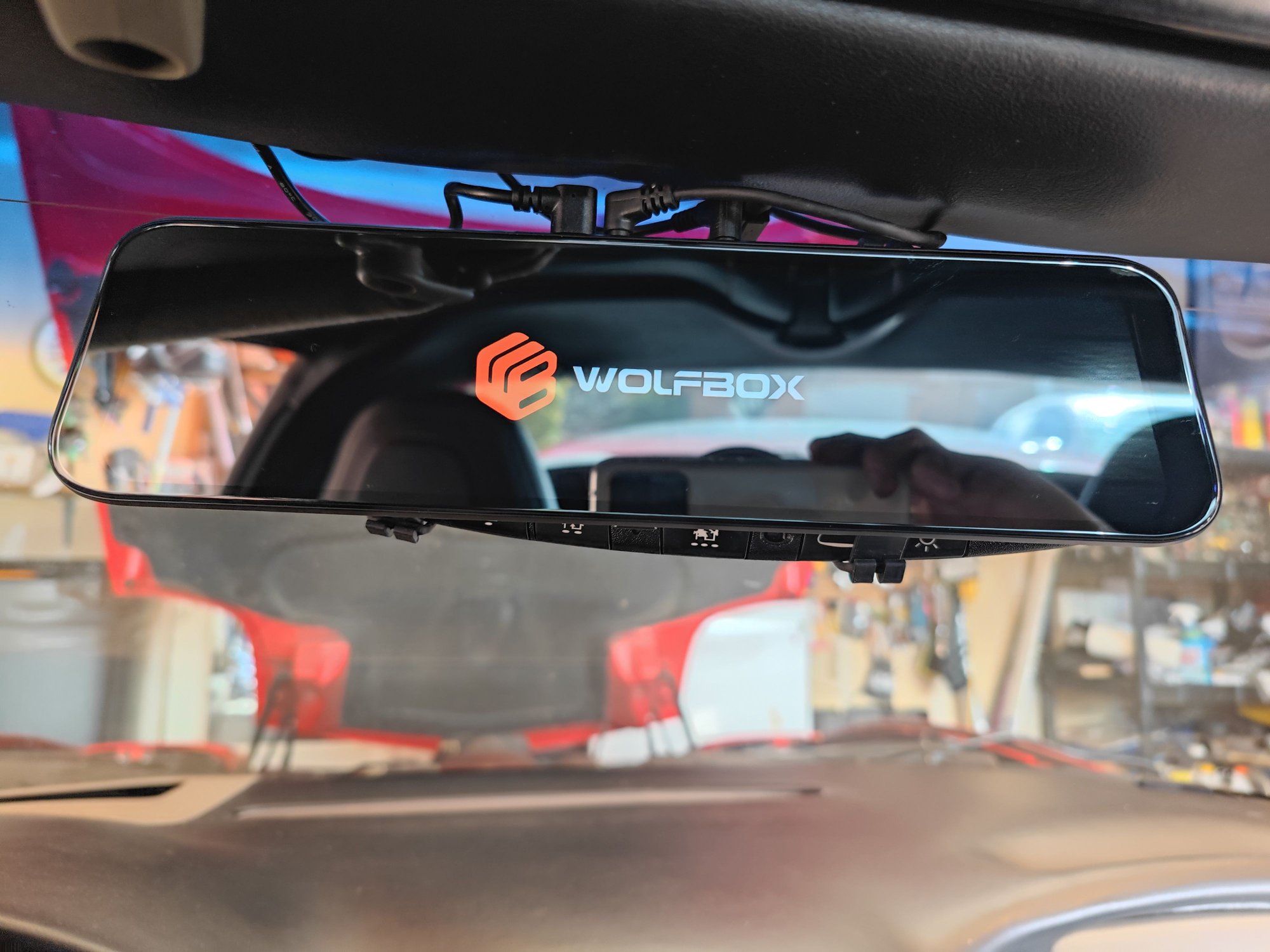

So..... @Yesterdayz I took my own advice and upgraded to the 4k super capacitor camera today.
Brand is "Wolfbox", model is G900 and it comes with a 4k front and 2.5k rear shooter. It also comes with a cigarette lighter power adapter but that's a no go since the cig power point is always hot on our cars...so I also bought the hardwire power kit.

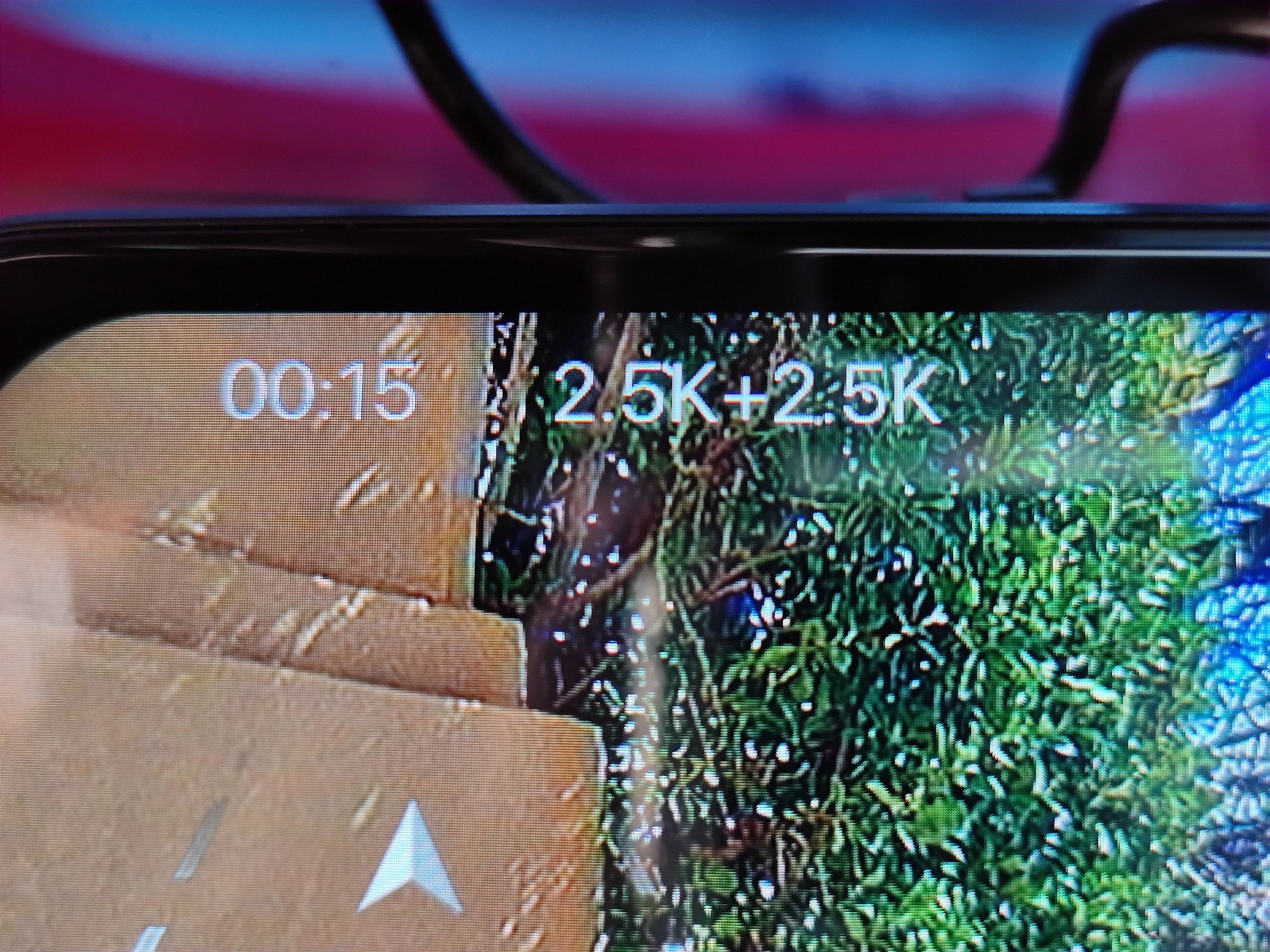

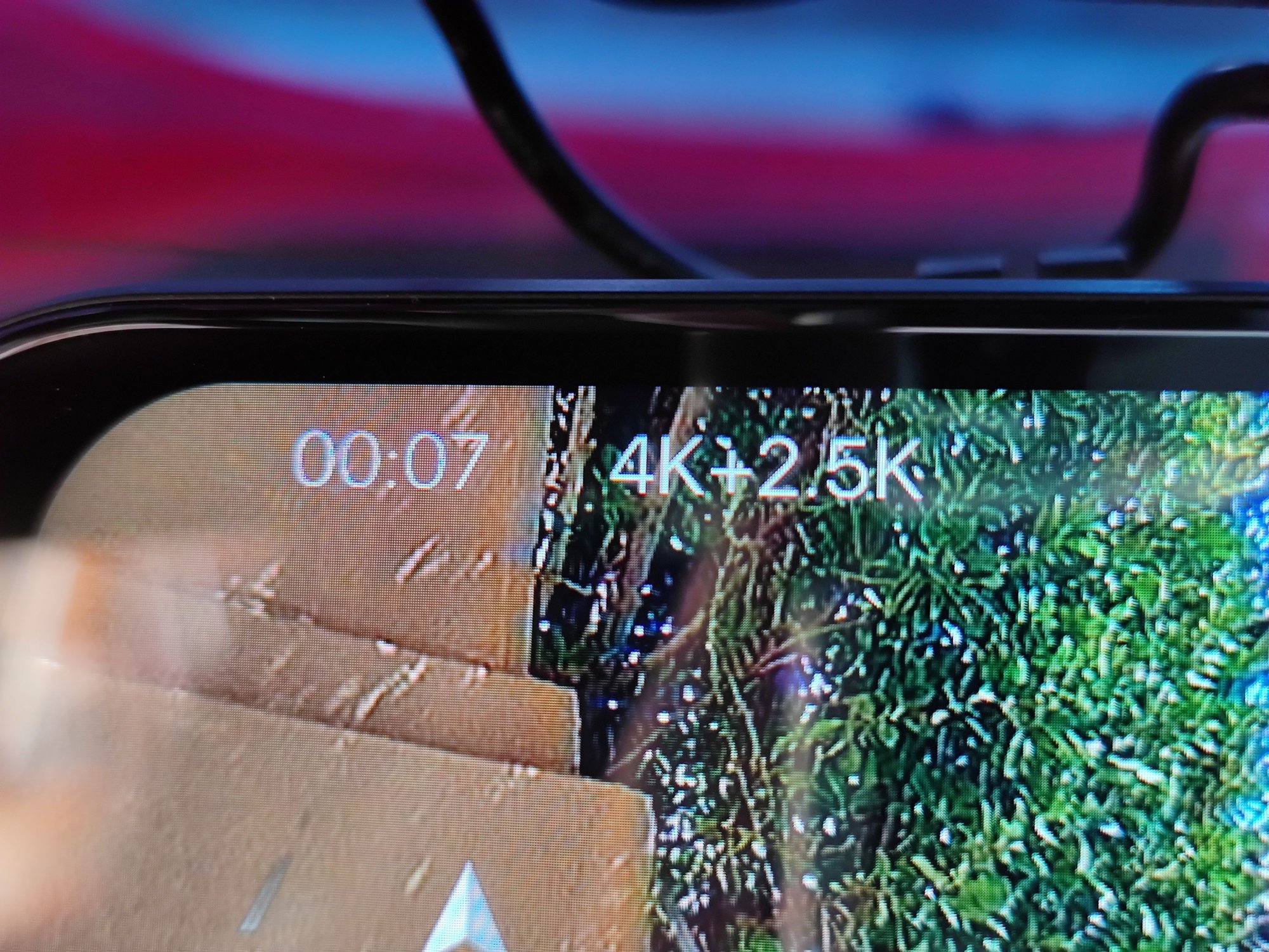

You can do 2.5/2.5k to save file size but I threw in a 256g micro SD so I put it to 4k/2.5k. The mirror formated the SD card itself so setup continued to be a breeze.
Some misc viewing options but I'll be keeping it as a straight up rearview mirror.

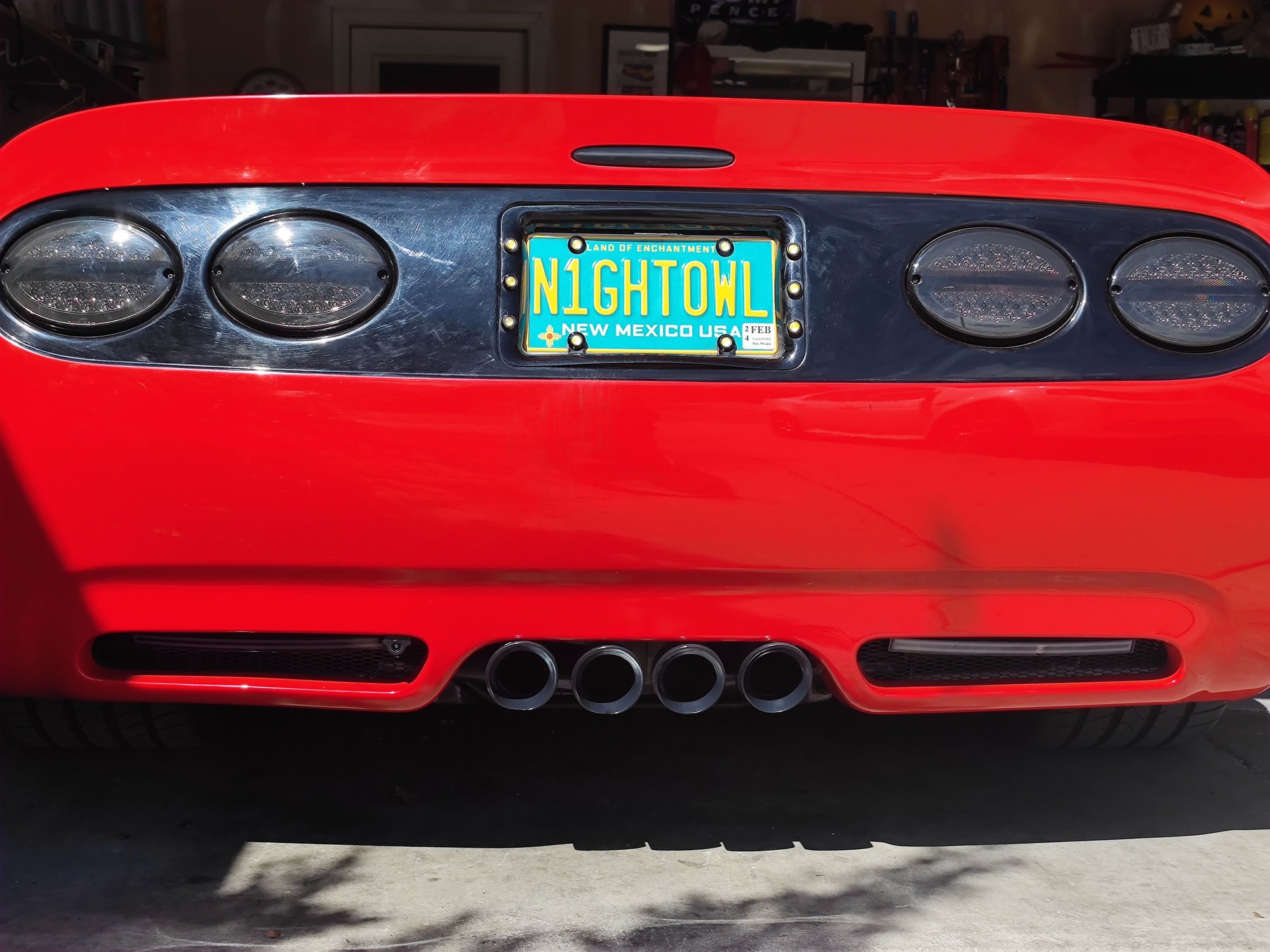

​​​​​​My old rear camera module was large and rectangular but had a small mounting footprint. Was able to set the old one up right on top of the license plate. This new camera has a very bulky body and a large mounting footprint so I had to come up with a new mounting location as it could not fit above the license plate...
Rear area looks much cleaner without the old camera...can you spot the new one?
The great news is that both rear external cameras use the same 4pin quick connect cables so I didn't need to run any additional wiring to get the new rear camera up and running. The system even used the same method for triggering the reverse camera function so it was nearly plug and play.
I absolutely love this type of rear view camera system over one in a double din head unit. These are always showing what's behind you, not switching to music or only showing what's behind when you're in reverse. The image on screen is super clear and has a huge field of view by being outside the car vs your standard mirror looking through the back glass.
This new mirror marks my 3rd iteration of this type of camera system with each being a bit better than the predecessor. (OG was 10" and 1080p, 2nd was wider 12" 1080p screen, latest is 12" 4k+2.5k and has super capacitor instead of a battery)
It's quite clear to me why so many of today's modern cars are now doing this type of digital rear view mirror camera setup
