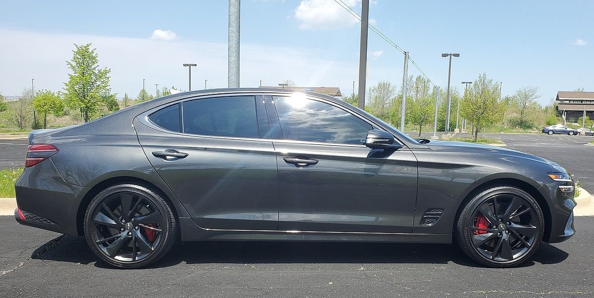

3D Speed is a good AIO product, but will only correct mild defects. 3D One is a dedicated compound/polish with much more cutting ability. The 3D One will finish down better than Speed on hard clear coat, too. I would likely just use medium foam polishing pads on hard paint with 3D Speed.
My daily driver has soft to medium-hardness paint, and I used 3D Speed to give it an after-winter polish. It did a nice job, and I only used Lake Country black microfiber polishing pads. Since 3D Speed has montan wax in it, I gave the car a coat of 3D Poxy montan wax/sealant afterwards.
