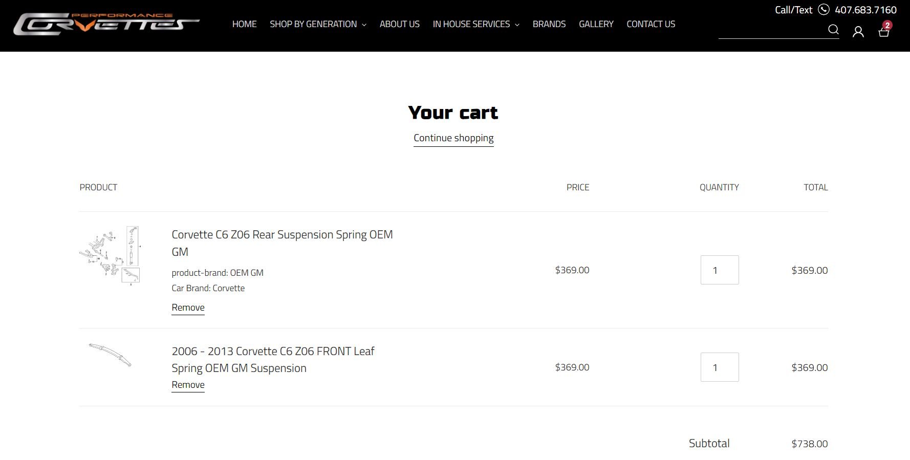

Really don't want to go out and buy another used set and possibly inherit someone else's problem. I can get a new pair of OEM for about $700 whereas the Hyperco are about $700ea. Not too excited about splurging on coilovers.

Your cart shows C6Z leafs...not C5Z
If you are ever considering Hyperco leafs at $700 each...you might as well go coilovers at which point you also gain adjustable shocks.
I wouldn't question buying some used leafs from a low mile car. How many miles on your car? I don't hear of these leaf springs going weak over time very much.

I think I read that front C5/C6 springs are interchangeable but the rear c6 spring is not compatible with a C5...please be certain before you pull the trigger
