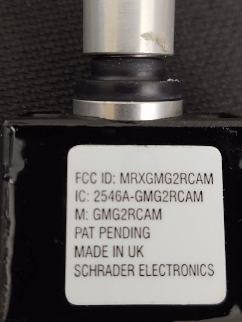

Originally Posted by Vader_C5
I would recommend going with GM Genuine, that is what I am installing in my 2003.
FWIW, Schrader is the supplier to GM..................
This is a picture of the original sensor that came out of my '01 C-5.
