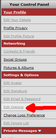

Is there a control panel setting that hides sigs or something?
Yes
Control Panel, then click "Edit Options"
Scroll down to Thread Display Options, there is a checkbox to show or hide Signatures.
