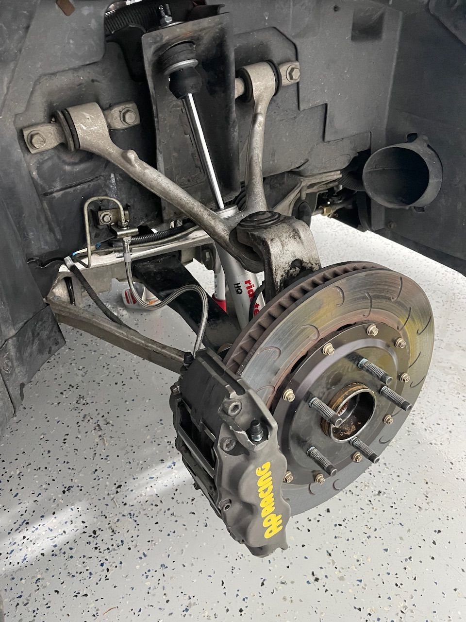

I got the RT/Fox shocks from Strano. Enough people (with all different kind of cars) told me "I'm never buying non-adjustable shocks again" for convincing. Very nice parts (certainly LOOK high quality, I guess) and easy to install and adjust. I started at 9 clicks thought it was a bit stiff and went to 11 clicks which is perfect for rough local roads and still very sharp handling. Adjustments already paying off and I can't wait to get the loose rear on corner entry dialed out of my car. I still have the FE1 spring and bar.
