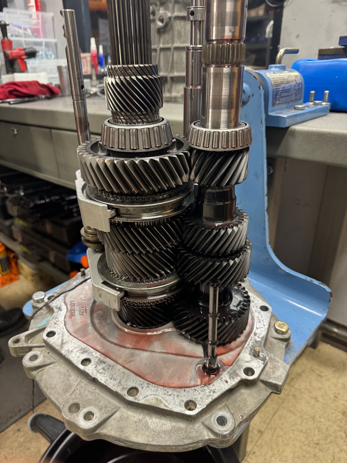

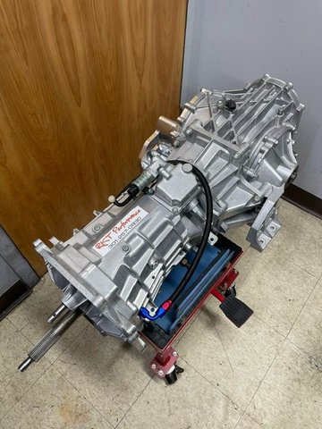

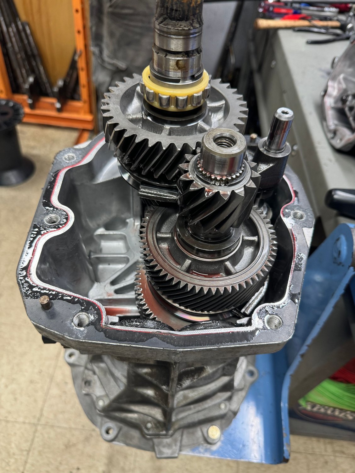

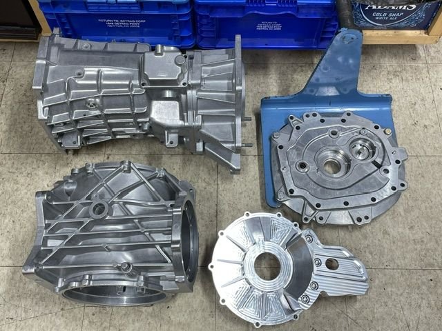

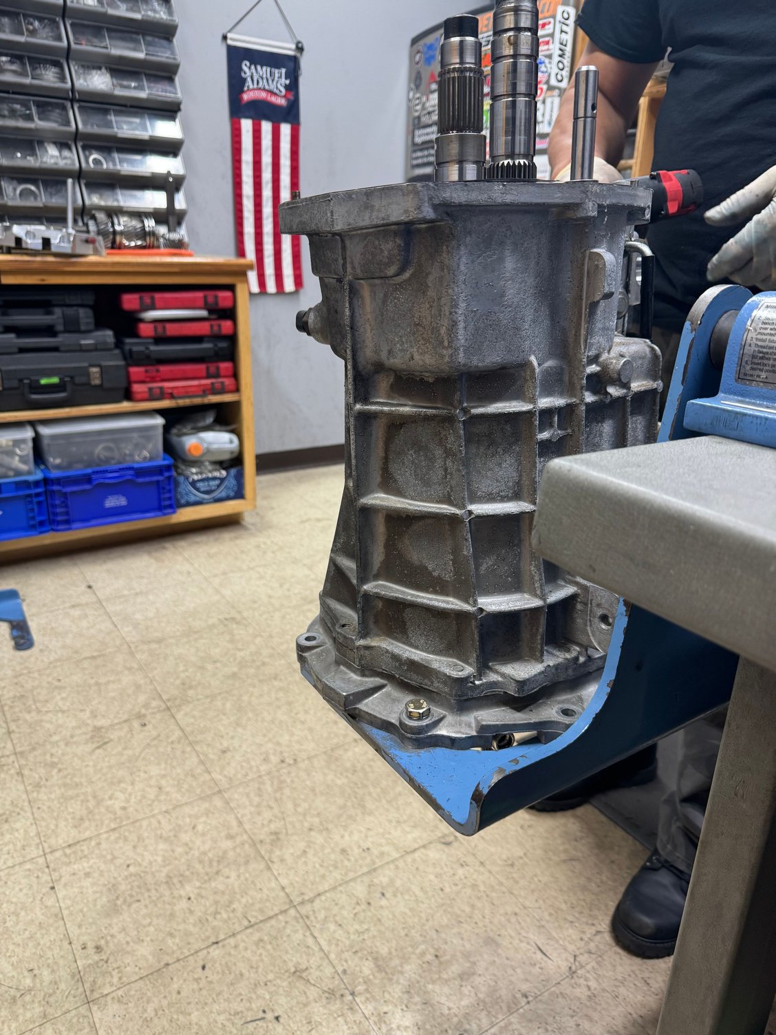

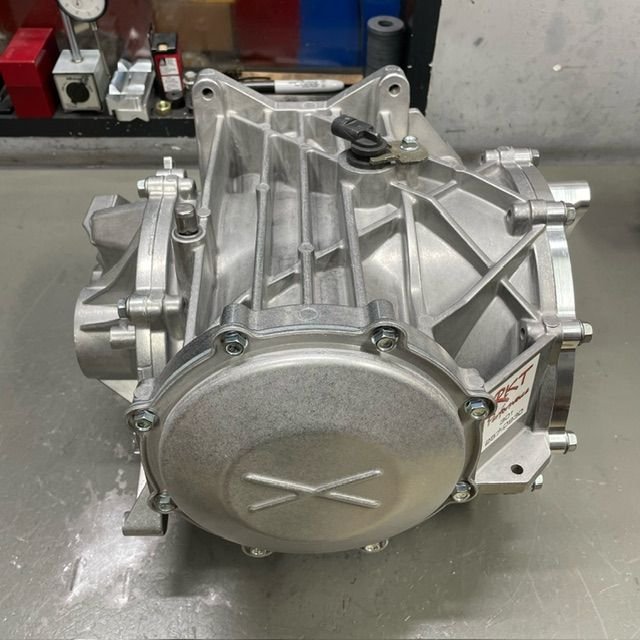

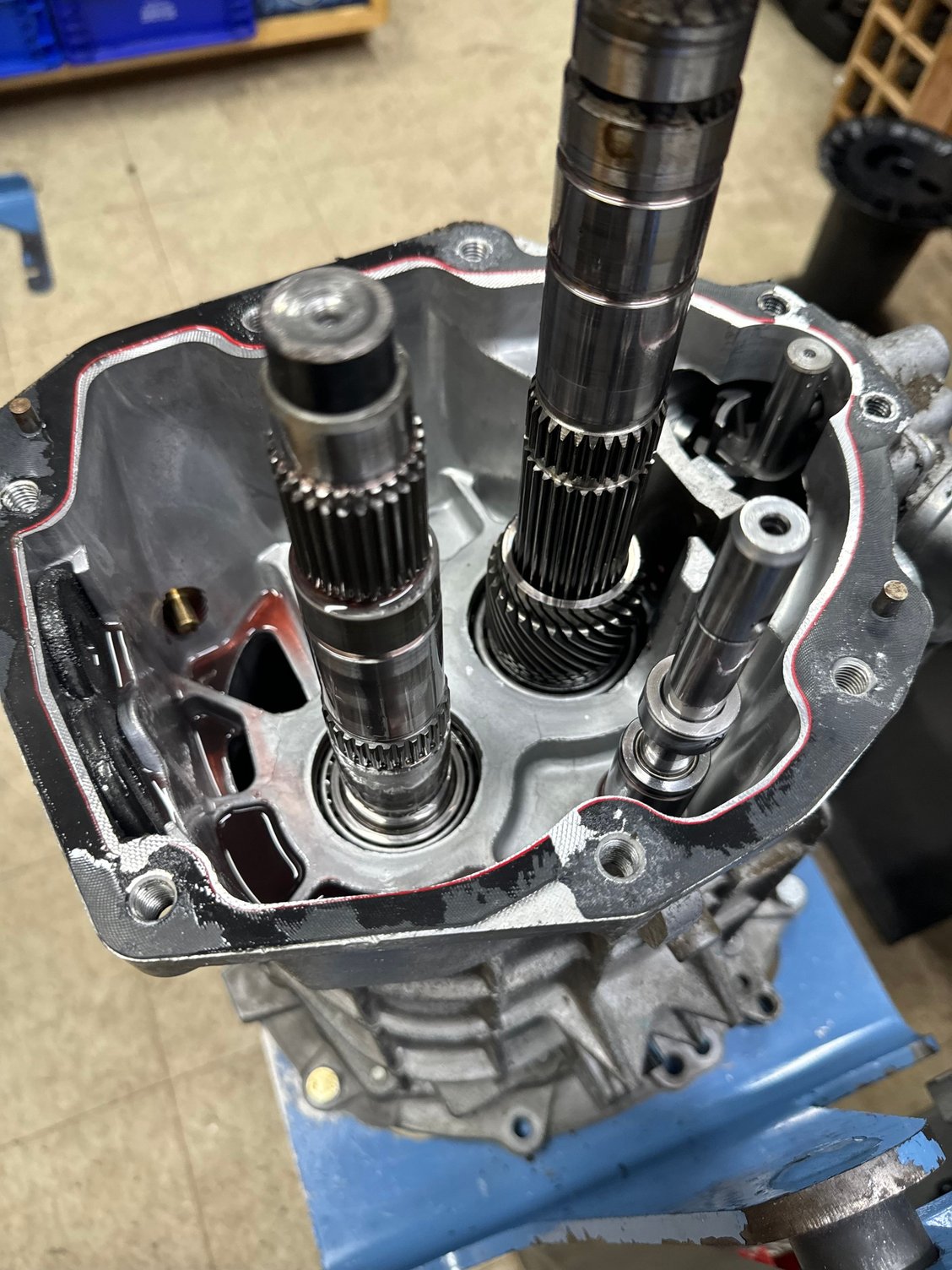

Hi everyone!
Big shoutout to @Rick@RKT Performance . He does incredible work!
I bought a C6Z trans and diff from the C6 section here and finally got them up to Rick for upgrades.
He disassembled it right in front of me, so he was able to show me the couple of issues that needed to be addressed. Absolutely amazing boost in confidence even for someone with a reputation as good as Rick’s.
On to the fun stuff:

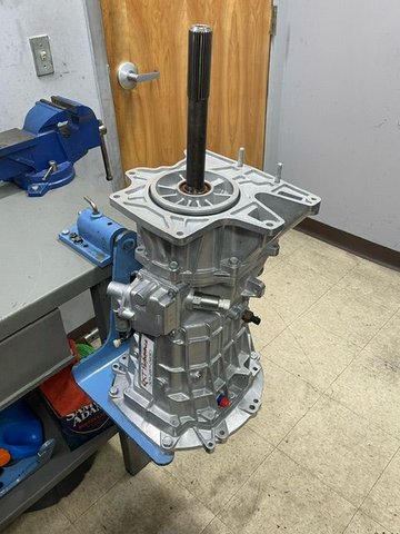

RKT Performance Upgrade Package for TR6060
2nd/3rd gear replaced
1-2/3-4 synchronizer replaced
Trans AN -6 fittings/fluid line

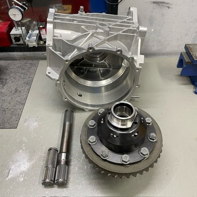

C6Z Diff upgrades
Disassemble/inspect/clean/assemble differential w/ DSS 500M shafts/new seals
Wavetrac
Diff pump delete
Billet side cover (found a crack in the stock cover)
BEFORE
AFTER

These are much stronger units than the T56. The base C6Z differential alone, on factory parts, is considered good to about 900. The hardened output shafts and spider gears are extra security. I have opted to keep base C5 half shafts in place to act as weak links in the chain. I prefer the chance to pop those than 9k worth of drivetrain. They can also be had very affordably on ebay. I have two MINT spare sets I grabbed for 150 each.
Did you get a dss couplerless shaft yet? =) I even spot welded the bolts on so they don't walk. That's how much I don't want to service the torque tube unless necessary.

One more pic before it gets palletized. 😍

Out of curiosity, what was wrong with 2nd and 3rd? Or are they a common upgrade in the tr6060?
Old Apr 4, 2024 | 10:18 AM
99FRC Newb's Avatar
99FRC Newb
Joined: Aug 2007
Posts: 2,583
Likes: 415
From: Erwin, NC
They had a good bit of wear compared to the other gears and synchros. I'm guessing the original owner did some spirited driving with hard shifts into 2nd and 3rd. That would have gotten him into the 100-120 mph range. I didn't buy it from @jamie furman or @Ranger , so I am guessing they weren't shifting into 4th at the drag strip (assuming this came out of a stock C6Z.)
Old Apr 4, 2024 | 11:57 PM
Posts: 368,320
Likes: 24,777
In the after shots, those parts look brand new. Congrats on a great upgrade to your car.
Old Apr 5, 2024 | 11:41 AM
99FRC Newb's Avatar
99FRC Newb
Joined: Aug 2007
Posts: 2,583
Likes: 415
From: Erwin, NC
I agree! I didn't expect them to look so good! Its a shame they'll be hidden under the car.
Although, the car they are going in has the rear tub cut out. I'll be able to peak in at the trans and diff LOL
