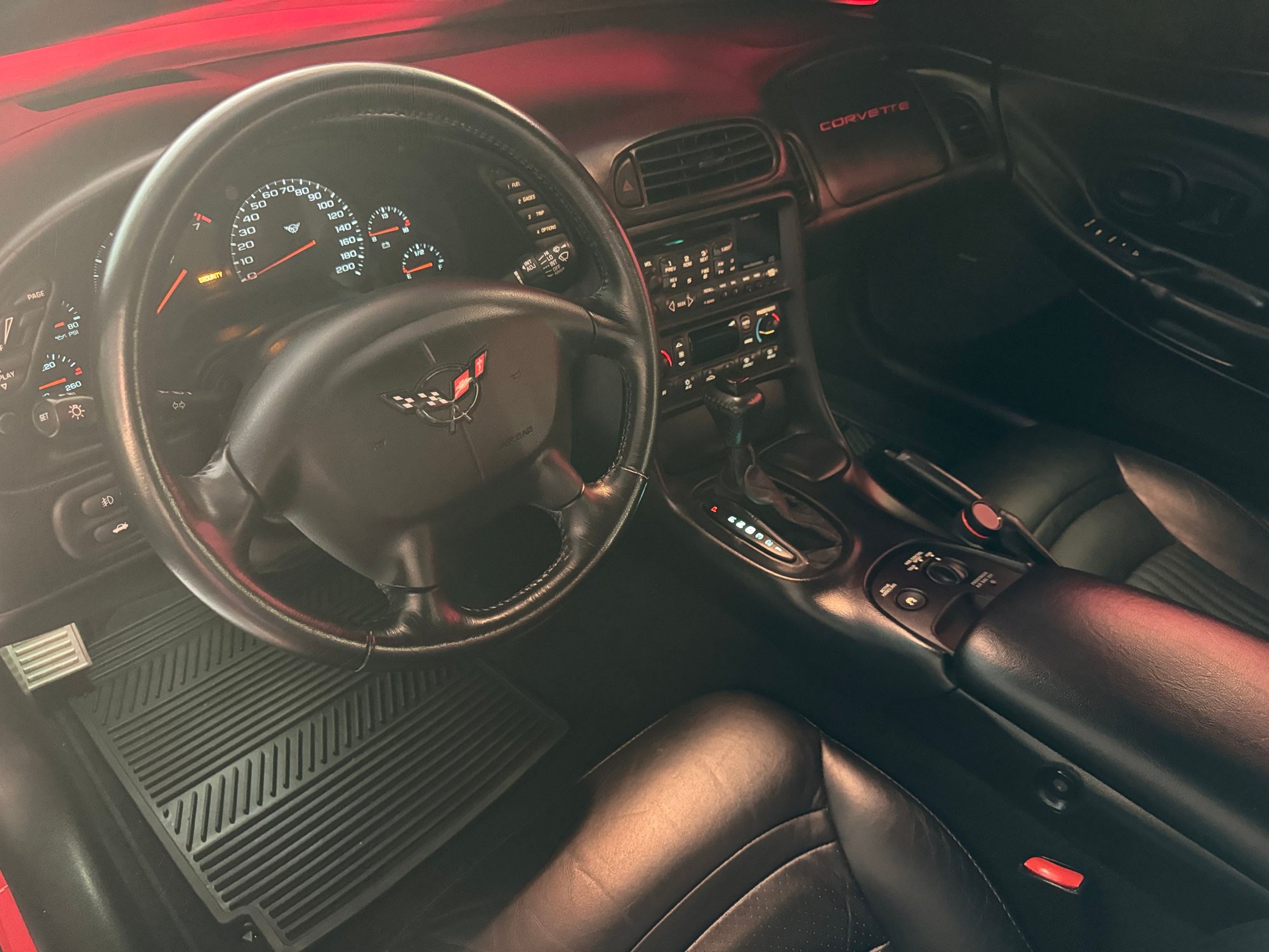

This is my review of the Discount Car Audio Blu-C5 Bluetooth adapter.
This is the new version that does not require a six disc changer. You can get several versions. One plugs into the changer harness in the trunk. You can get one that plugs directly into the radio behind the dash.
I went with the trunk as it was easier to install and should I want to use my changer I can just plug it in. They do mske a harness that you can keep the charger hooked up but if the changer breaks no MP3s.
I just had to plug the module into the rear harness and run one power wire to the fuse panel on the passenger side floor. They give you a quick connect fuse wire that plugs the fuse and wire in together. They recommend fuse 22 or 11. I recommend 11 as it will work on accessory .
I also opted for a USBc port to charge. I used 22 for it as there was no power once the key is out of ignition.
They have another option for a wireless remote. It works well. You get a mount with it to hook it on the steering wheel spoke. I put it just below the shift **** on the shifter. I also saw if you remove your active suspension the hoke for the adjuster **** is the same size.
Everything links when you start the car and this did not take long to hook up and no wires cut and nothing to modify. Plug and play.
This is all that is exposed. The Bluetooth is on the Aux button and will say disc 6 track one.
So if you want a stock system with factory sound and Bluetooth this is a good and reasonable option.

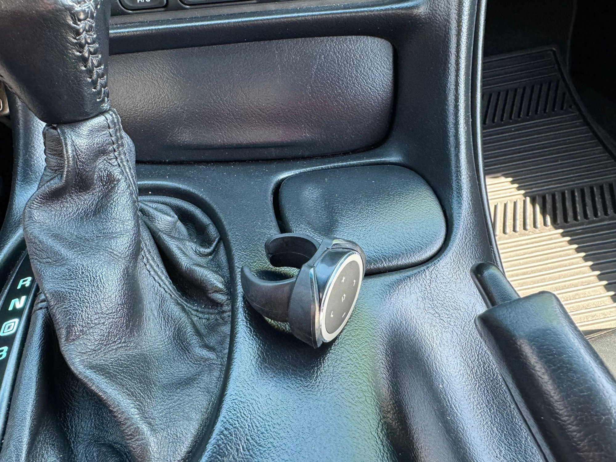

I did make one upgrade. The wireless control I went to a JBL Click. to is mo
re expensive but it works much better and made much better. I put it on the E brake handle. It is at hand and still let the E brake work.
It is one click to play or pause. two clicks to advance track and three clicks to reverse. The outer ring also does phone volume.
It just has a rubber strap that fits over the handle. I think they are discontinuing them as most places have them on sale.
