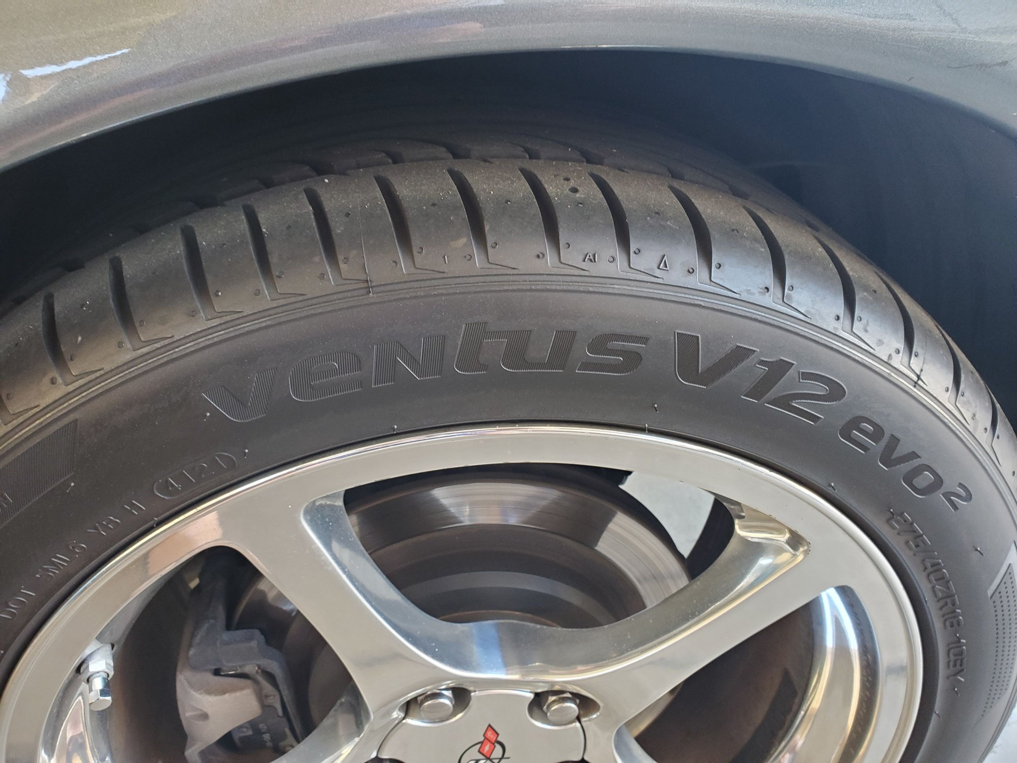

I just replaced the 16yr old Goodyear Eagle run-flats on my 2001 roadster with Hankook Velous Evo V12's, in a 18/19 combo. Not a run-crap fan.

i've got the same hankook evo v12's in 17/18 on my '04 c5!!

Best bang for the buck tires, IMO. I've always been a big Michelin fan until I bought new tires for my C5 Z06. Vetteman Jack suggested I try a set of the Hankooks. He was right.
Both my former 02 Z06 and current 01 roadster have Hankook 265/35/18 fronts and 325/30/19 rears. Just didn't see the value in paying $400 more for Pilot Sports.
