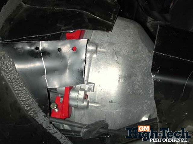

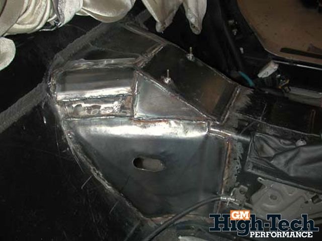

The MT site semi works now. Still not all photos showing up.
So really it is custom
Custom Parts Purchases:
Adapter plates fore and aft
Bellhouse for the front plate
Shaft
Custom Labor:
Cut/weld TT housing for new shaft
And then cut the back half of the arm rest tunnel cover to fit
This should be sold as a pre-priced kit basically knowing the parts needed up front for the adaptation. The rest is a cutting wheel and borrow a welder to get the floor and TT done. Not impossible at all. I mean.... it is actually really EASY because all you're doing is buying the right parts to fit. The only part needing focus is how you choose to replace the tunnel plating on the interior and refinish the arm rest area depending on if you want it to be a presentable street car or a race whip.
Not bad. Definitely looks expensive up front though.
