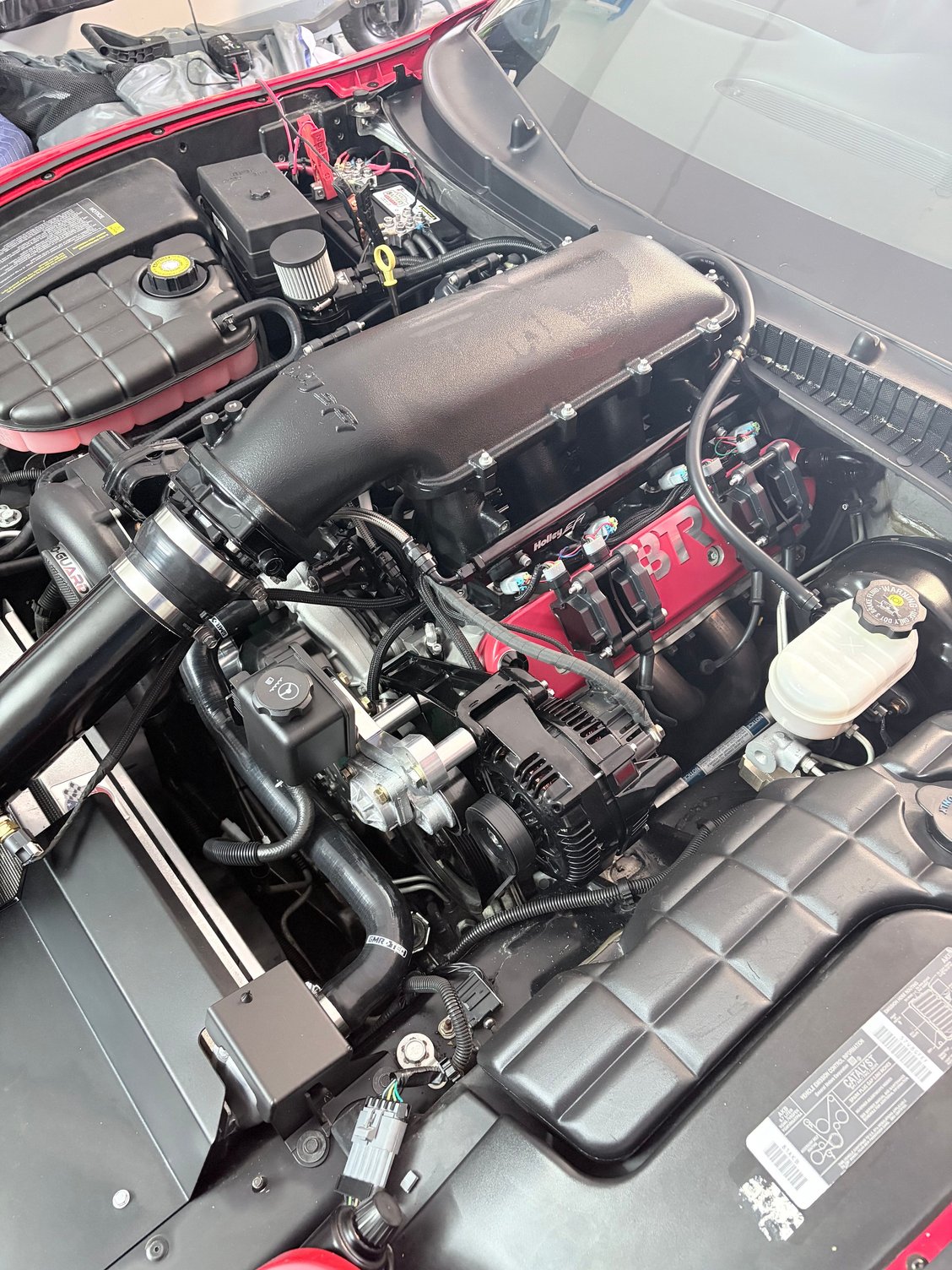

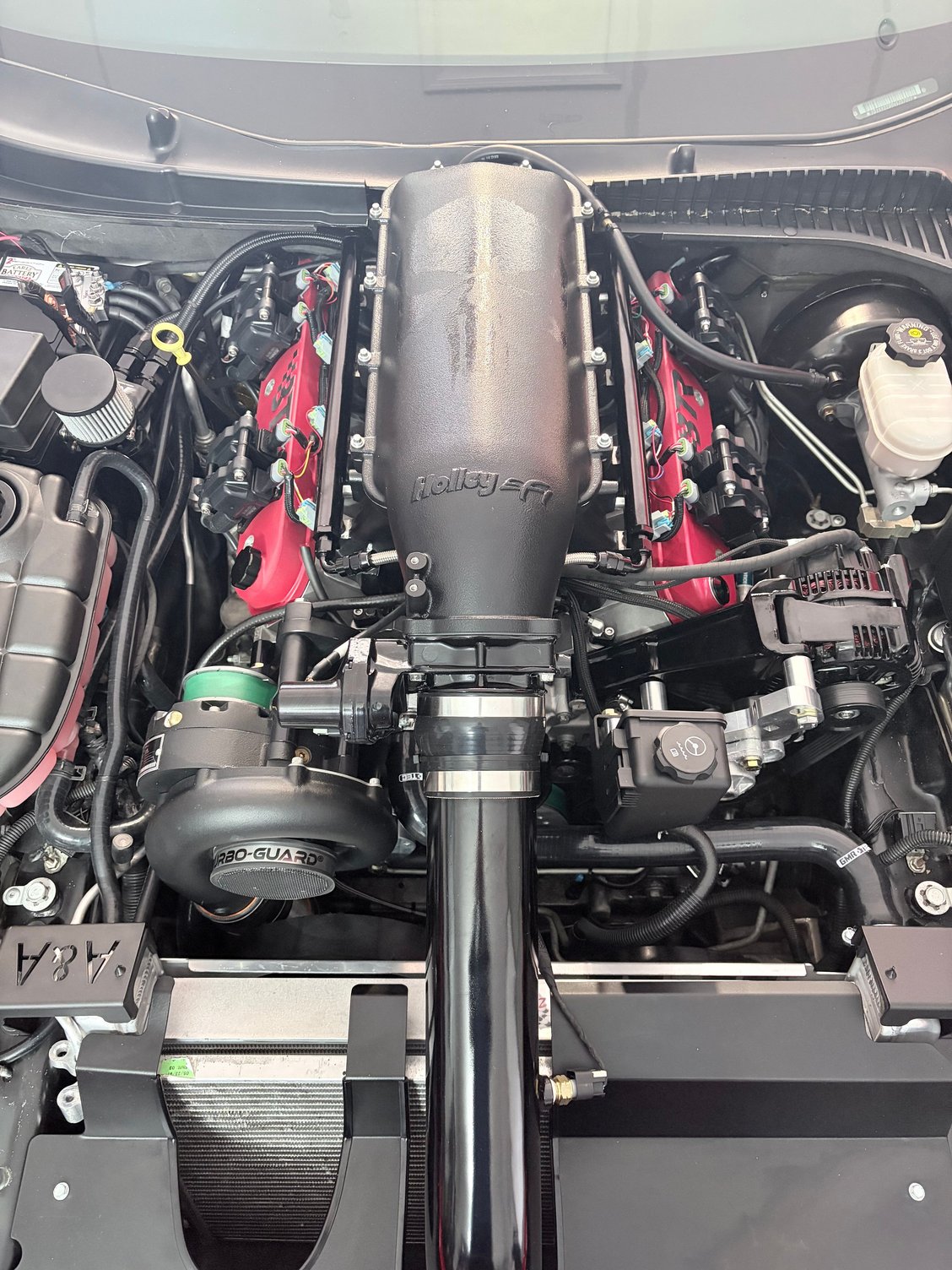

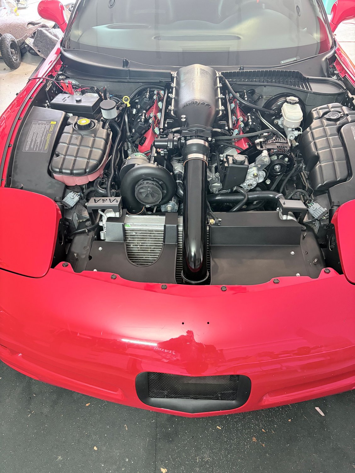

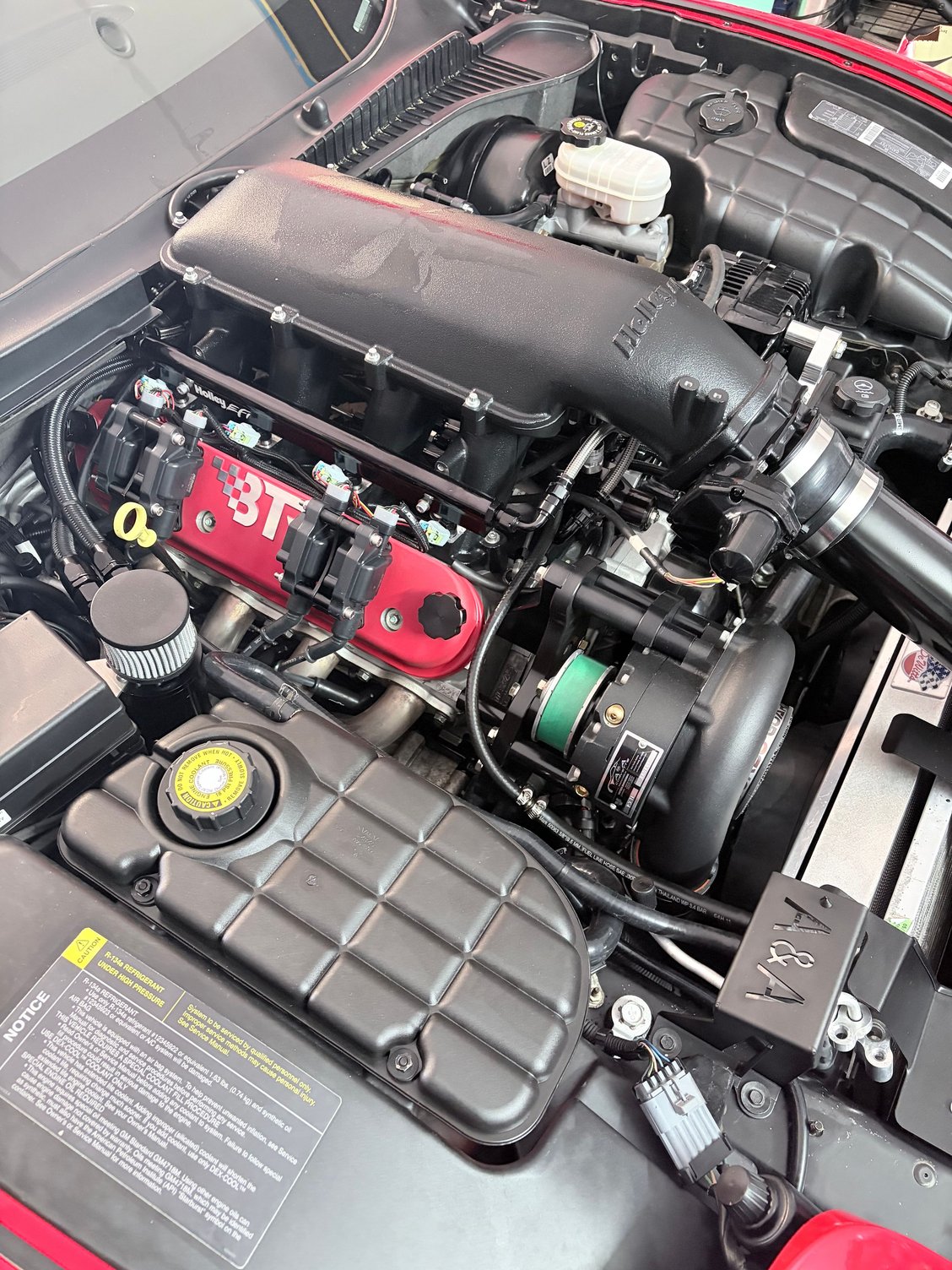

Hey all, I need some advice on what you would do in the situation I am currently in with my C5. I have roughly 45k into my car overall from wheels up, and yet another broken 4l60 transmission on the very first drive on the dyno, which is the second time this has happened. My car has a setup that should be able to make 1200-1500 on E85, but I'm currently running premium and a conservative tune around 700. The trans is about to be rebuilt again for the 3rd time by performabuilt, and I have yet to be able to drive the car in 3 years.
I am really out of options when it comes to transmissions unless I go to a TH400, which will cost almost 20k in conversion, or an ECS Powerglide for around 9k. The Powerglide seems like my best solution, but I'm worried about being able to cruise around in it. I am told that if I use the right converter with a loose stall, this should help, but I am curious if anyone has gone this route and what rpms they are seeing when driving on the freeway at around 70mph for no longer than an hour. I would also like to mention that I do not care to take the car to the drag strip.
My other option is parting it out and selling everything, and then selling it as a roller. I am looking for some advice on what you all would do in this situation. I have attached a few pics of the car as well for reference.
