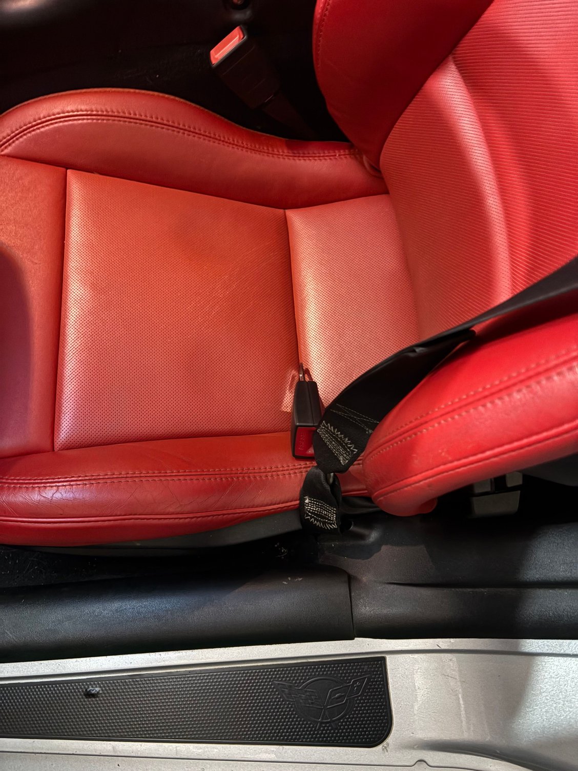

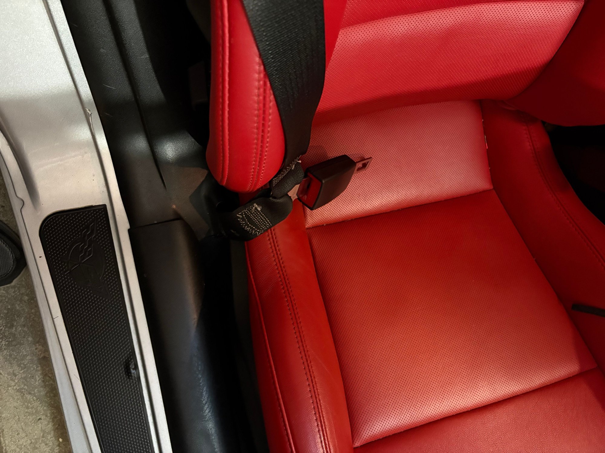

Installed 2017, Z06 seats in my 2001 C5 convertible.
no cutting required used my C5 seatbelts
Drivers side all I did was break off the metal tab
Pass side, same only broke off metal tab
love the seats!
though really does look like the sides and airbag covers are hitting the plastic trim -- funny that it was hitting so bad on my car I lost about an inch of back travel.
