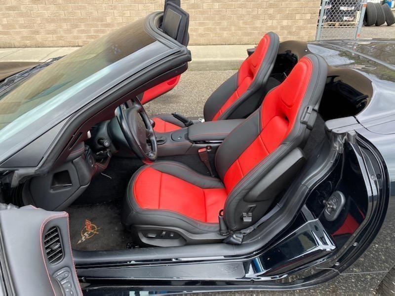

highly recommend it. They look fantastic in the c5 cockpit, they feel great, and they drop right in.
The only issue you may have is if you have telescoping steering, you need to retain the c5 seat control module and wire that into the c7 seat (three wires, piece of cake).
Also, the c7 is slightly wider. The c5 seatbelts have a retractor at top and bottom, they will interfere with the seats and you'll lose an inch of rear travel. You can either modify the seats slightly be removing the airbag cover or (what most people do) replace the c5 seatbelts with c6 seatbelts, which do not have the bottom retractor and drop right in.
here's my c7 seats in my '00 :

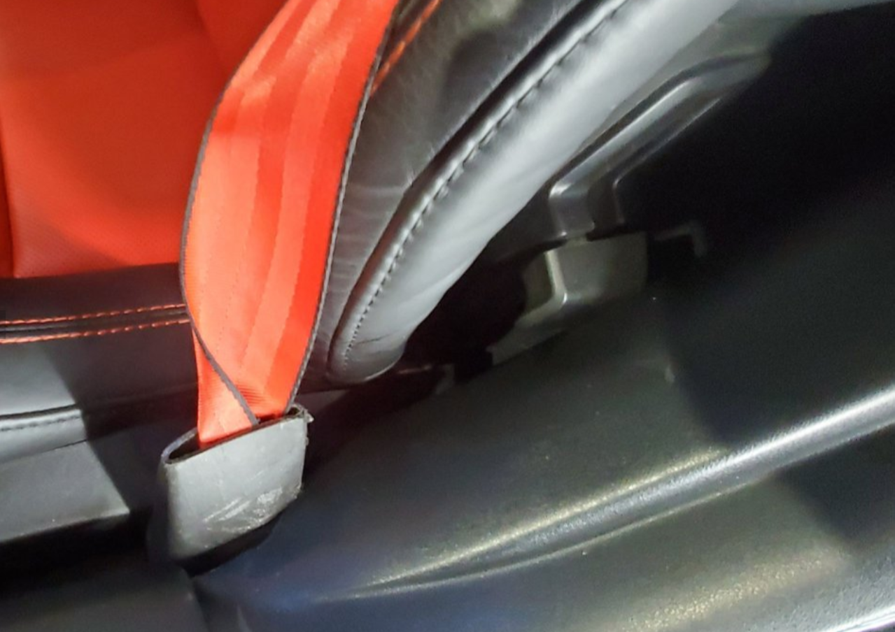

Originally Posted by Ltngdrvr
Lever for the seat back tilt forward, sticks out and when you slide the seat back it smashes into the pillar.
interesting, I've had mine for a few years, and it's perfectly straight. Maybe because I swapped the c5 seatbelts out and modified the plastic covering in the car
Old Oct 23, 2025 | 06:06 PM
jdmvette's Avatar
jdmvette
Night Owl for life
Joined: Nov 2003
Posts: 24,725
Likes: 4,564
Originally Posted by JMG2
Potato phone took that pic
Old Oct 23, 2025 | 06:19 PM
JMG2's Avatar
JMG2
Moderator
Joined: Apr 2002
Posts: 11,775
Likes: 1,376
From: US
very zoomed in picture that was originally about 5 feet away.
