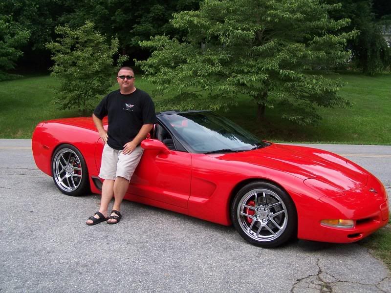

lowered looks like this.

I guess I'm JUVENILE!
