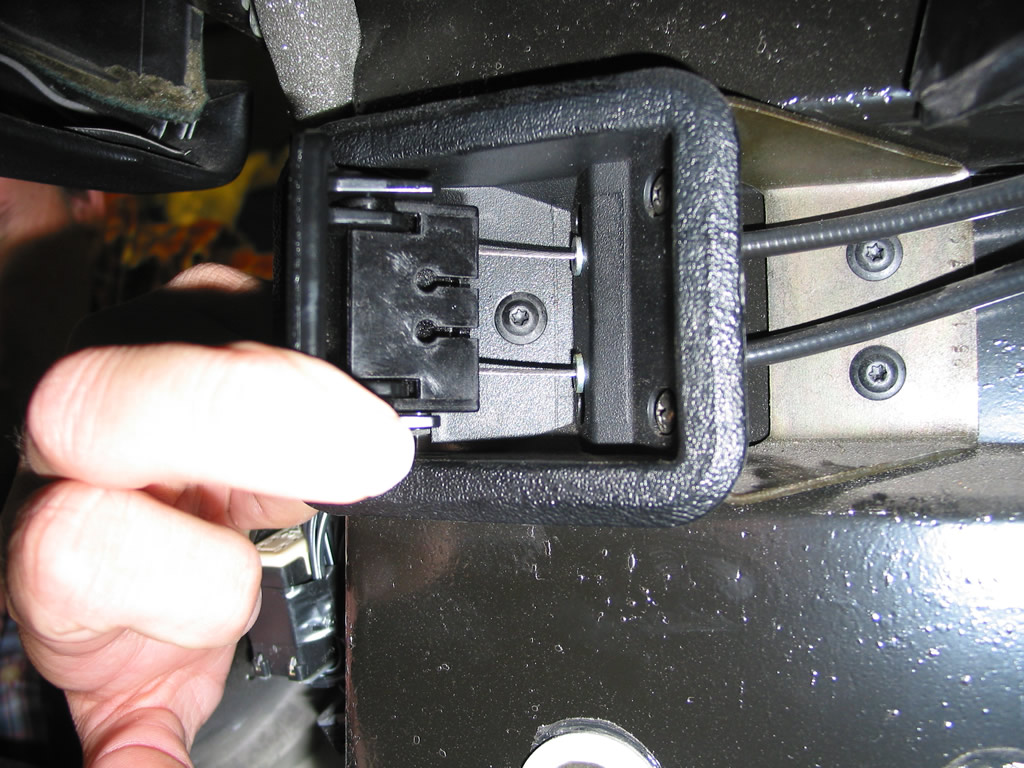

First thing to check is feel the cables in the hood release inside the car. In the photo below you can see the brake pedal's view of the hood release. You can see the two cables in the release. You can pull the release and feel the cables with your fingers. They should both be kind of tight when you try to push on them. If one is broken it should feel looser than the other. It's possible the cable popped loose or the release broke, it's only plastic. To remove the release you remove the three screws, one in the middle of the release (under the handle). The the two all the way to the right, not the two in the plastic. It's easy to see the ones in the plastic looking under the dash but the two you need to remove is the one in front of the release, harder to see. If you remove the release you should be able to see how the cables are released. But you probably have to release the cable on the latch before you can release them for the release end.

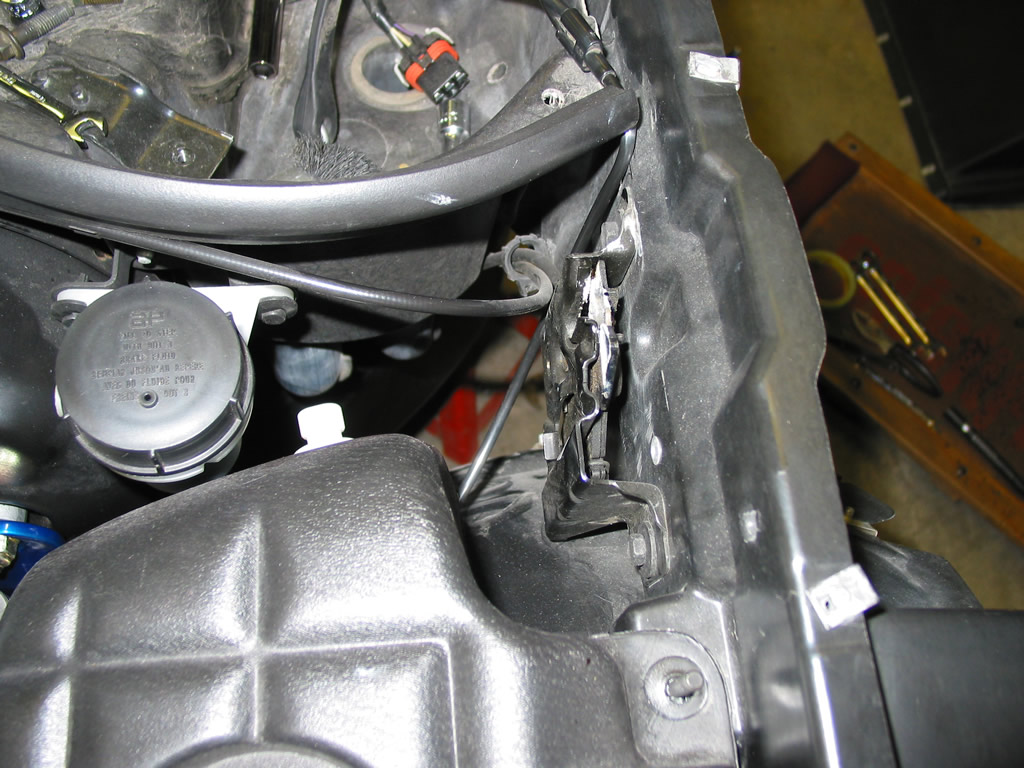

If all looks good with the release then do like Bill said and remove the rear inner fender. Pretty easy to do, just a bunch of screws, you will need a 7MM socket. Once off it will open up a hole you can see up in and reach the latch. Looking at this photo you can see the red jack stand that the car is sitting on, this is the hole you need to reach up into.

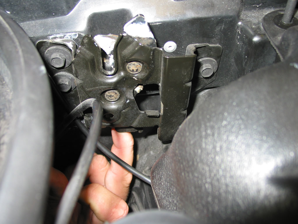

The photo below shows where you need to reach into the latch. The release lever is the lowest thing in the latch. Just stick your finger in the bottom of the latch towards the front and push the lever backwards and the hood should release. I don't see anything that will get your finger when you do this.
If you can push the leaver back and the hood still don't come up, get someone to pull up while you push the leaver. You should be able to see the latch looking up in the hole with a light. It's possible they closed the hood with a rag over the latch and it got crammed down into the latch binding the latch. The latch is held in place with 3 bolts and it looks like it would be very hard to remove them through the hole. If you could remove the bolts then you could raise the hood an inch or two with the cable still attached to the latch which should give enough room to access the latch.
