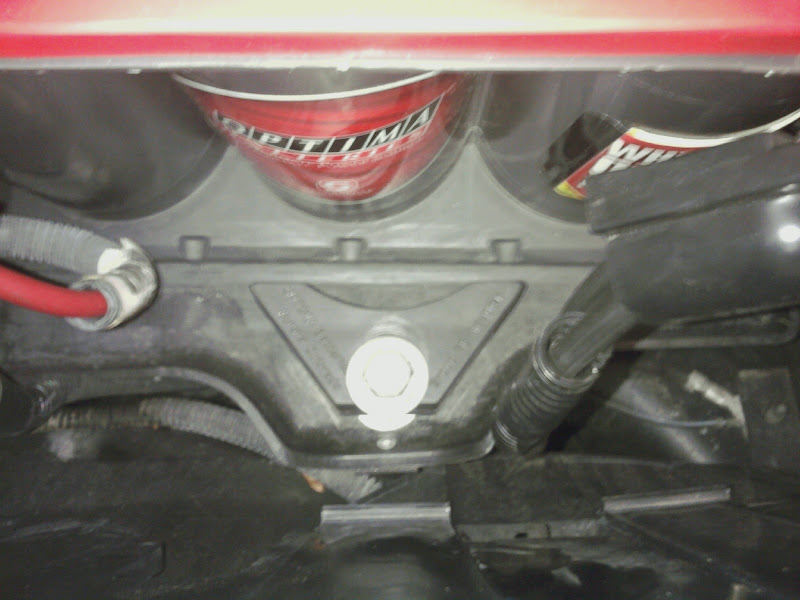

Here's the way my tie down looks w/ the battery pushed all the way back towards the firewall. Maybe it's because I have a diff model battery? (I go the one w/ the side and top posts)
As you can see, the tie down just misses the bottom lip of the battery.
So.... Any suggestions??

Are you sure the back of the battery is seated in the holder and not sitting on top?
I have the one with top and front connections and have had no trouble.

I'm an idiot! That was it! I thought it was seated all the way down in the tray but you were right- it was on top of the back!
Thank you VERY much for the help!!
