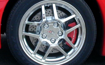

The Folia-Tec two-part paint you can get here on the Forum and elsewhere is the way go. Eventually Rustoleum and other high-temp paint is going to burn off. Frankly, it's easier to brush on without taking the calipers off, than trying to spray paint them.
more pics: http://www.mattwolf.com/vette1.html
