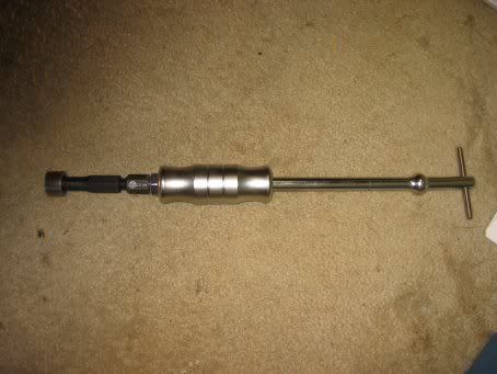

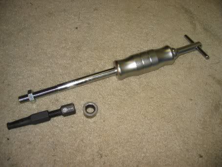

I have 6500 miles on my CF DF. Should have went with the 12 inch but didn't Oddly the 12 inch is cheaper. Bought mine on Amazon, cheapest I found. I installed a Lite weight Chromoly flywheel from the auction site for like 180. or less. I replaced all hydraulics, the pilot bearing, and a remote bleeder from LAPD. I also used Wilwoods 600EXP fluid. I had to buy the alignment tool from Summit for under 8 bucks.
If you do the job yourself post up or read up on tips from those who went before you. I'll tell you now removing the factory pilot bearing is gonna be the most fun of the whole job. If you consider fun as using every four letter word you can think of. However if you have the right tool it's a breeze. Just ask and you'll get all the advice you need.

Thanks for the advice guys. I can just "borrow or rent" a pilot bearing removing tool from like a local autozone or something right.
Thanks
Old Dec 23, 2008 | 08:27 AM
vettenuts's Avatar
vettenuts
Joined: Mar 1999
Posts: 22,025
Likes: 192
From: At the beach in little Rhody
Thanks
Yes.
