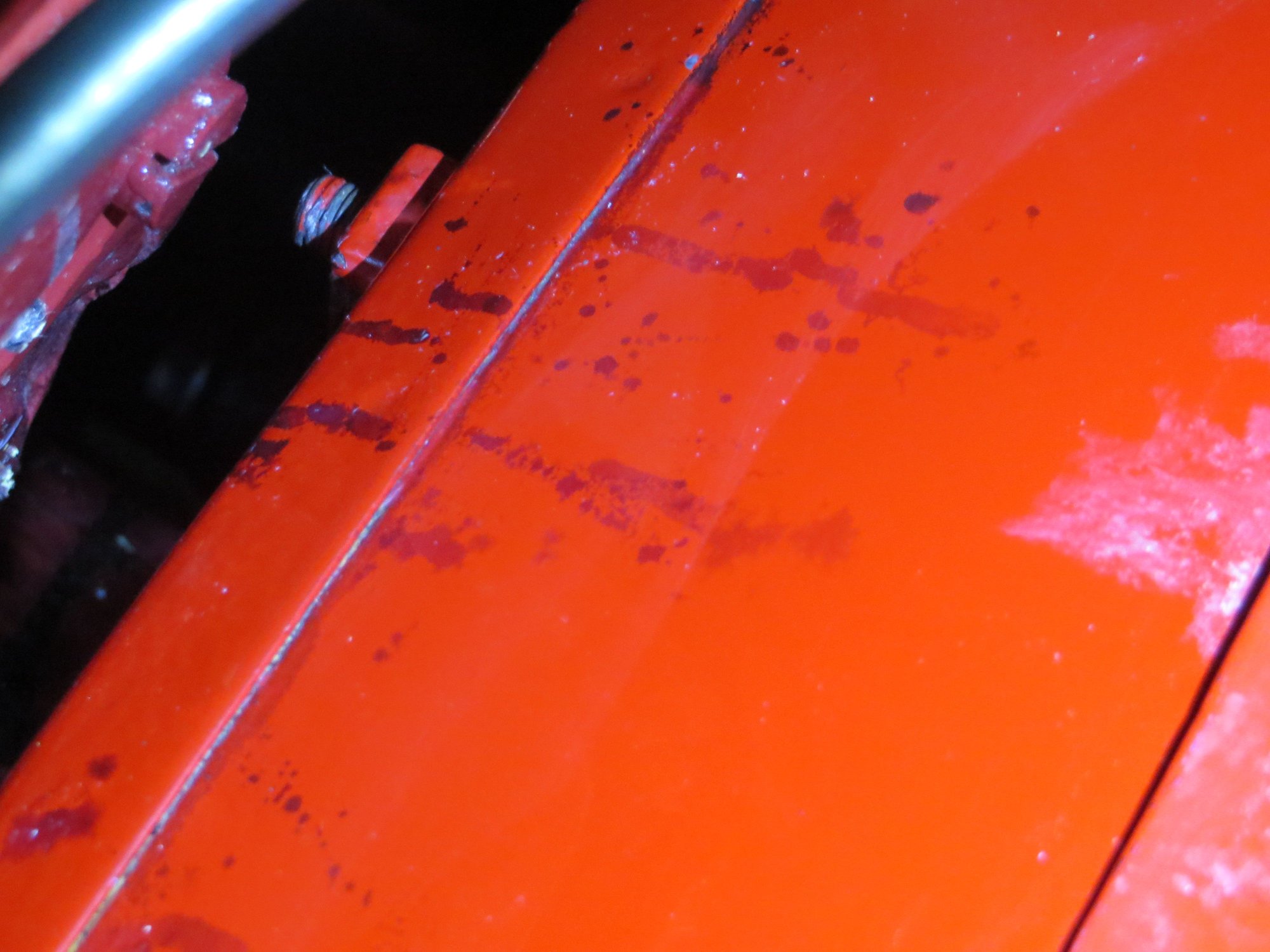

I had exactly, exactly the same issue! Battery was 6 yrs old so I had to buy a new one. But the leak, Sulphuric acid, created black drip marks on the painted engine compartment,. Any advice for a cleaning agent?

I used baking soda to neutralize the acid and then clean water. I'm left with the black drips. I tried acetone, paint thinner, and other relatively paint-friendly solvents with limited success, I'm trying to avoid repainting the areas if possible...
Post a pic of the areas.....I can't visualize what you mean by "black drips"

Ok. I honestly do not know what I'm looking at here...at least in the engine compartment. Obviously the acid has attacked the paint, but I have no idea what type of paint, how many coats there are, if there was a clear coat, etc. Most likely will have to use some sort of abrasive like rubbing compound and see what happens.
ACETONE????! Acetone is NOT a paint friendly chemical!!! It is used in paint stripping!!
