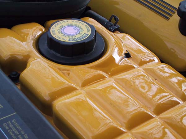

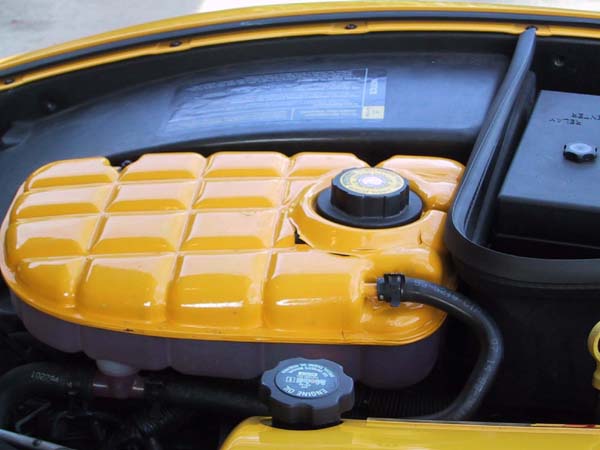

I got the Autobuffs Engine Dress Kit. With my car being in the shop it sat around and I finally got to install it this weekend. After one day of driving I noticed the coolant surge tank started to crack :eek:
I contact Noel about this and he says "due to expansion and contraction of the tank we can not control what happens to the paint on the Surge tank".
So, I'm wondering what other member's experiences are with this tank? Do you guys with the painted tank just not drive your cars cause I don't recall seeing cracks in anyone else's tanks. Please lemme know your experience with this piece if you have it.
Other than that, I'm very happy with the quality of this kit...
Thanks for any input on this...
Adam

I am not sure if this is the problem or not. That yellow is probably a "low hiding " color. To get it to cover the black tank you would need lots more coats than say a pewter mettalic or normal hiding color. The more coats you put on, the more trouble can happen. Or some contamination around the filler neck not removed prior to painting would mean lack of adhesion, which means lifting or cracking paint. the heat factor, I don't think that would be it. (In this case anyways) :cheers:

I had mine painted two years and 20,000 miles ago and everything looks fine. A local guy that does alot of custom paint work on motorcycles did the work. I asked him at the time he did the work if the paint will stick ok to all the plastic and he said no problem, he just has to prep it right and put something in the paint so it remains flexible.

Is flex additive used in the paint mixture?
Kenny

Yes on the flex additive. I just got off the phone with the guy that did mine . He would not tell me alot . He says he uses a mixture that he has come up with that stands up to the heet and flex. THe same mixture he uses on the bikes he does. I guess its his little secret and I can respect that. What ever it is it works.

Here are the emails that were exchanged...
My original email
"I have your Engine Package on my Millennium Yellow C5. I noticed that the coolant bottle's paint is cracking! I have attached some pictures to show you what is happening and I'm wondering what we can do to resolve this."
His Response
"Unfortunately Due to Expansion and contraction of the tank peeling can
happen... When was this purchased? Was it purchased under a different
name, I can not find any records."
My Next Email
"So you are saying that all these other C5s with your engine kit just don't drive their cars? I've seen pictures of many cars with this kit and I've never seen any peeling occur. It was purchased under the name *******."
His Final Response
"Honestly I don't know how much other folks drive... It's what we
recommend, It does not mean that there not daily drivers.
What I was saying is that due to expansion and contraction of the tank
we can not control what happens to the paint on the Surge tank, We
explain this to all of our customers.
Sorry if you mis-understood something."
I was rather shocked that he wasn't going to stand behind his work so, at this point I decided to turn to the rest of you to see if anyone else was having this problem before going back to Noel for some type of resolution.
Adam
