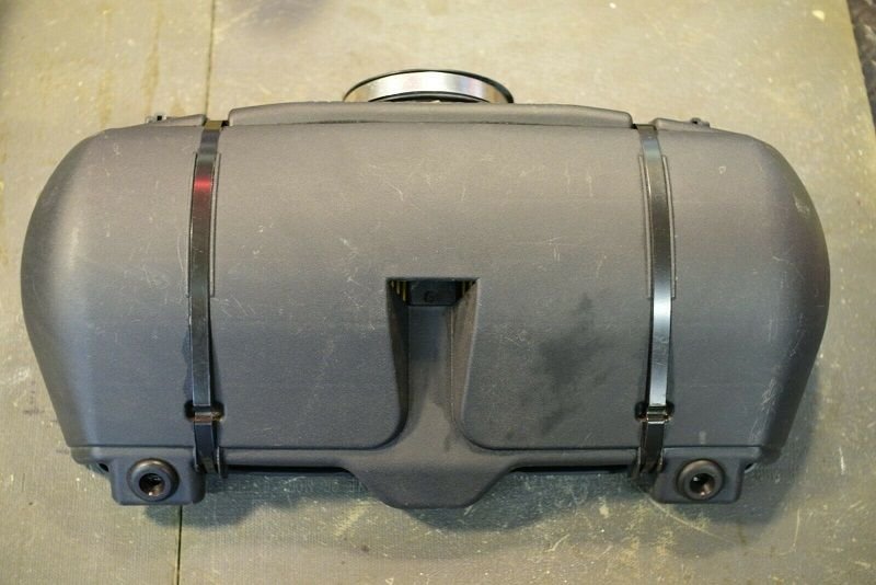

can anyone tell me how to mod a stock air box on a stock c5. i have heard that the mod can pick up some hp.
Old May 23, 2010 | 12:58 PM
hotwheels57's Avatar
hotwheels57
Posts: 10,554
Likes: 33
From: Not on either liberal coast.
There's several ways to do it. Which one? You can get more air and air intake noise, but appreciable horsepower/torque improvements may be hard to determine w/o base and dyno testing.
The sound of an increase of incoming air is what most equate to more horsepower. The computer can make minor adjustments to compensate for the change.
In C5 Tech, use search or search this forum (in the red banner). Use keywords "zip tie" or "flip tie".
Some prefer to use the top cover from a Z06 to allow in more air. The oem C5 coupe/convertible top cover didn't have an opening on the top cover as did the Z06.

The mod done by Hotwheels57 is by far one of the nicest jobs I've seen. I just took a dremel and opened up several slots between the stiffening ribs to let more air in. No screen, but mine is a track car that won't see much debri other than marbles.

I did what hotwheels57 did...except way less nice I am not so sure it did much but I doubt it hurts

I have watched/read many mods for the C5 Vette air intake system. Mine is different. I have a 2000 base model vert. I don't have a small triangular hole anywhere on my airbox (top or bottom). I have 2 tubes on each side that are molded into the top of the filter cover where the metal straps go that follow the curvature of the top cover and face down. Does anyone else have this type? I read about adding the front gasket for the hood but see no reason with the way my airbox is made. Had I thought I would have taken a pic as an example.

Go to "YouTube" and in the search box write.....C5 Corvette zip tie MOD. Its about six minutes and it will explain what it should look like and why it works.

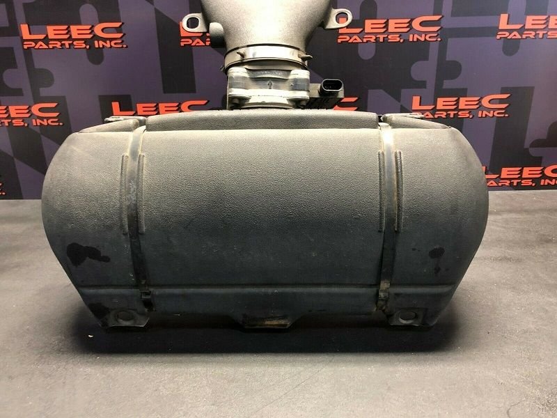

Later air boxes ('01-'04 IIRC) looked like this:

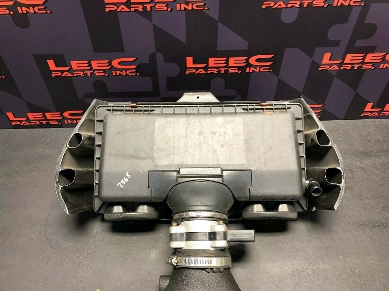

And the LS6 (Z06) air boxes looked like this:
Not sure if the lids are interchangeable from old design to new, but it looks like they could be. Either way, the complete airbox should be interchangeable. If you're not into aftermarket CAI's, or modifying the OEM...you could always swap in an LS6 airbox, if you can find one reasonably priced.

yep thats the one I have, the early airbox. I don't know if it's better/worse than the other versions but it's good enough for me.
Thanks for the pics and info.
