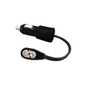

Also resets HUD to default. Search 9V battery, there is a plug that goes in the lighter with a 9V battery that is suposed to save your stuff. Probably still lose the emission settings though, not sure. I think the middle setting on the charger might be enough, just make sure to insulate the + side well.

I have seen the 9 volt cigarette lighter plug in at Walmart.

If you're that worried, invest in one of the "memory saver" devices that plugs into the power socket as suggested.
You'll lose the DIC settings and memory settings but they are easily reset. The issue with the radio is that if the security feature is turned on, you'll have to input the security code on start up.

Less than $10 at most automotive supply sources. Just make sure you use a fresh 9v battery with use. I used mine when I changed my battery. There was no other power supplied for approx. one hour and I lost none of the settings...

His original question, which I answered, was will it hold enough amps to keep the memory. The answer is yes. So will the small device from any auto store pictured above. So will a 9v battery used in smoke detectors. The car will only draw enough current to hold the memory from any source attached. He didn't ask if it was the best way. He has heard enough now to make his decision and probably has long since moved on, and we haven't.
This would be my choice.....

The only draw back to the 9 volt battery back up is if you leave a door open for a minute, the 9 volt will go dead real quick.. It just can't handle that big of a draw..
